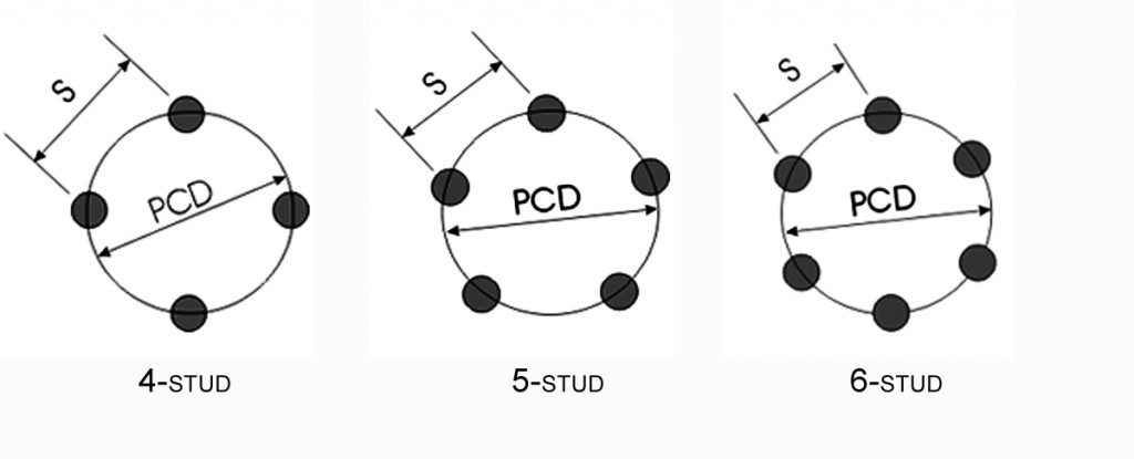

brain has gone west, 3 holes centers at 35mm what is the circumference ?
help an how did you get the answer.
Re: my build from the start
219.91148575128552669238503682957mm ish :)
2 x pi x r
unless iv got the wrong end of the stick
3 holes around a circle 35mm apart if that helps what is the circumference ?
Erm, surely that's just 35*3 = 105mm? I've probably got a different end of the stick...

I get a radius of 20.207.
I'd explain fully, but I'd need to do a drawing.
It involves the constant that all the angles within a triangle add up to 180deg, and a bit trigonometry.
ahh... i get it now, im with m_c on this one 20.07mm radius will intersect 3 points 35mm apart
took me ages to work that out
i can find the formula for 4,5,6 but not for 3 :confused:
Attachment 3529
PCD Calculation Formula
3 stud PCD = S / 0.866
4 Stud PCD = S / 0.7071
5 Stud PCD = S / 0.5278
6 Stud PCD = S / 0.5

3 stud PCD= S/0.866
peter
thanks peter star man, added it to the post :-)

Ahh, now I understand the question! You wanted *diameter* not circumference at stated in your post.
It's just cos(30)...
Let x be side length of the triangle the three points form (i.e 35mm).
(see diagram)
Draw in lines on triangle that bisect the angles. So we've now got a smaller triangle with one side length x/2, and we know the angle indicated is 30 degrees, since it's an equilateral triangle and we've bisected the corner angle.
cos(30)=(X/2)/r
r=X/2/cos(30)
r=17.5/cos(30) = 20.2072594...
(since d=2r, d=X/cos(30))
Incidentally to help remember it cos(30) is just sqrt(3)/2 = 0.866025...
Hope that helps. You can get the other PCDs using similar methods. 4 is half root 2.

Ahh just realised. My method can easily be extended to the general case for n bolts. You just need to know half the angle interior angle of the particular polygon. Then do cosine of that to get the factor...
3 = Triangle, 60/2 = 30, so cos(30)
4 = Square, 90/2 = 45, so cos(45)
5 = pentagon, 108/2 = 54, so cos(54) = 0.5878 (!)
6 = hexagon, 120/2 = 60, so cos(60) = 0.5
The formula to find the interior angle is 180(n-2)/n.
So that means, given n bolts with spacing x.
r=x/(cos(90(n-2)/n))
PCD = x/(2*cos(90(n-2)/n))
enjoy!

like the formulae but...
er where is x used??
x=bolt spacing(centre to centre)
Peter

my question is - none of these formulae use x - I'm sure they should somewhere?!?
r= x/(cos(90(n-2)/n))
should be x/cos(whatever), as you're working out the hypotenuse from the adjacent.

fair do's
I've updated by guesswork...
m_c
Yes it is, sorry ... was rushing and missed that :redface:

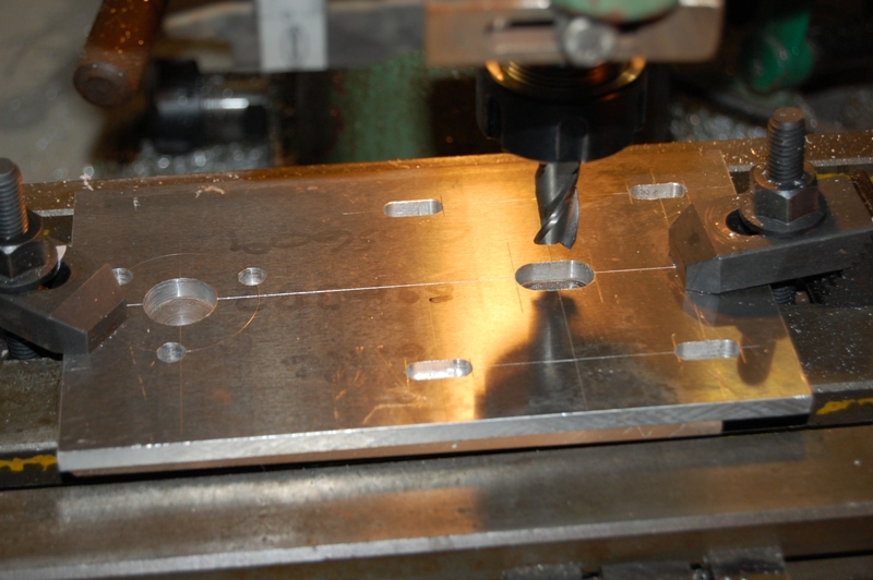

well my ally turned up so made a start on the z motor plate :smile:
all i could think of when making it was, if the mill was finished i would just be watching it being cut.
Attachment 3552 Attachment 3551
Similar to how I did it except I mounted the motor plate 90 degrees clockwise to yours, and lathed a bit of 3" aluminum bar to act as a spacer and give a bit more surface area for the motor plate to bolt on to. Doing it that way enables me to use the handle for manual drilling without removing the stepper - I think yours would collide?
good point jonathan, i will wait till it's all working then make a new one.
