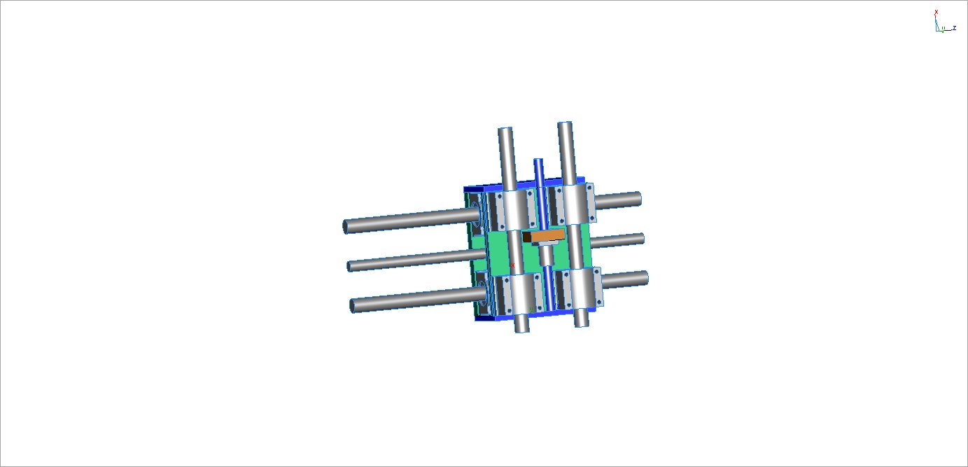

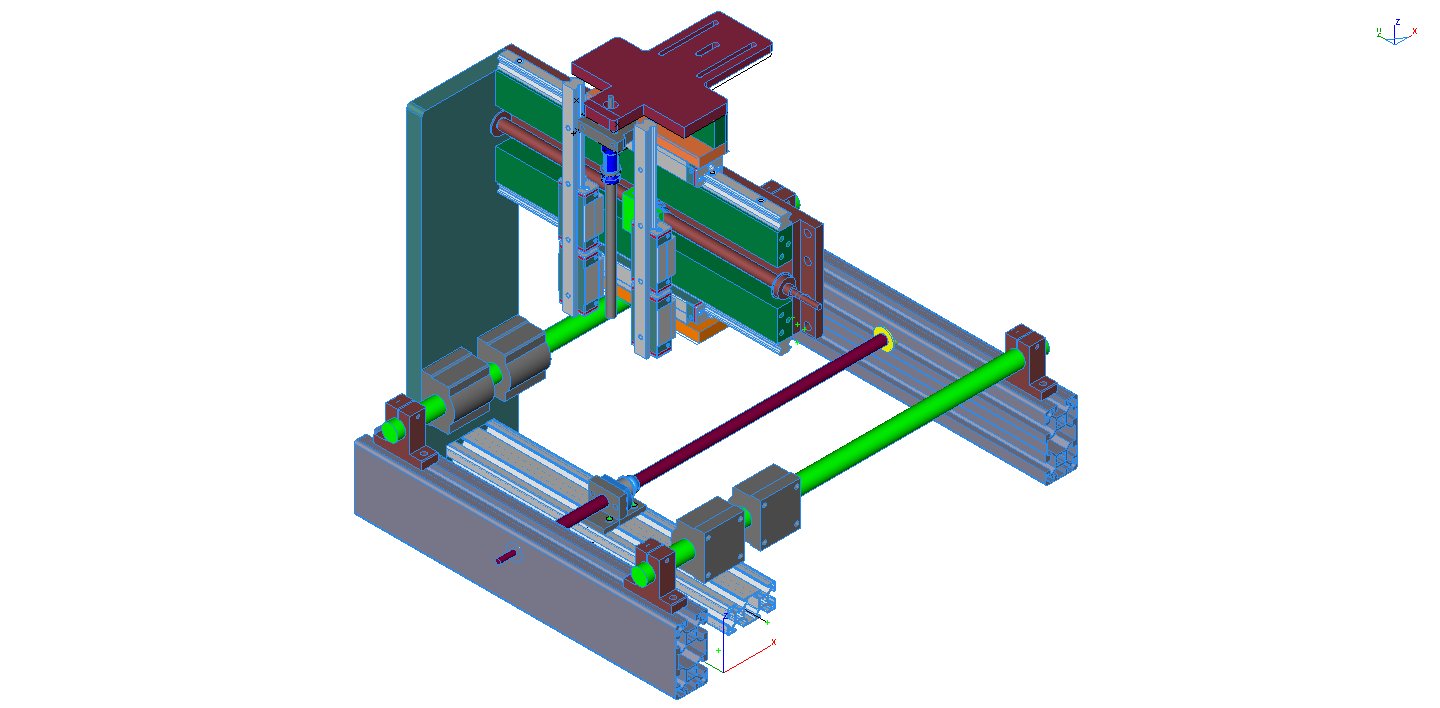

3 Attachment(s)
Re: 1st Build, Second machine
Well,
Thomas is settling in just fine and I have been working on the model like a mad man to try to get things done and production back on line. As such you will find attached three jpegs that show the current design with leadscrews and anti-backlash nuts from DumpsterCNC. Stepper motors are not mounted nor are their mounts in the X or Y axis. Not all bolt holes have been put in yet for take apart for piece generation but getting there.
The 1st (a) is the full model minus the above and the gears and belt for Z; 2nd (b) is with table plate removed and Spindle plate of Z removed; 3rd (c) is with the close leg ofthe Gantry removed & the under plate of the Y/Z section. The extrusion you see I already own and they are simply migrating from the old machine to the new. I have not finished the holes for the Bearsing as of yet even though their models are in place, excluding the exterior bearing forthe Y axis (still debating whether to go that route or stick with just the one, leaning heavily on adding the second bearing).
Well with all that said, please constructive opinions please.
I do have to give thanks to Jonathan for a lot of input and also Jazz for some very usefull ideas.
Attachment 4736Attachment 4738Attachment 4737
Again thanks for all the knowledge and support in this I have received.
Michael
Michael but if I've read your post's right to are going to have a X-axis between 750 cm to 1500 cm on a unsupported rail
I would think you are asking for trouble??
I am no expert and have not completed a machine yet but I know how little force is required to bend ( make the ball screw arc) and your asking it to support around 25kg with out any movement
sorry but I think you will have to rethink it
James
James this is the rebuild of the current machine and if it was that long you would be completely correct. That rail is only 500mm of 20mm dia. So should support it over the 250mm of travel it has.
Thanks for the input though and the build from ground up is still in progress.
Michael
Well folks,
work and payment recieved have come together to allow me to get the pieces together to buil the model I have below. Support round rails ordered (Thanks Jonathan for challenging my idea and sorry JAZZ for not contacting you first). The rails and 2 of the carriages will be coming from Jonathan. The other 4 carriages and two rails for Y axis JAZZ has helped with me getting. DumpsterCNC anti-backlash nuts ordered and in route via post. Just need to get a hold of JAZZ on cutting and where to have the metal sent to. Also need to get a hold of m_c for the modification on the pieces that are here.
JAZZ or Jonathan (Heck anyone with more experience then me) please speak up on anything you might see wrong with the design. NO, not all bolt holes have been put into the model yet. Yo uwould be surpirsed how much time doingthat and making sure that there is no conflicts and enough Metal to grab. No the motor mounts are not all present and the gear i put in the top of Z keeps vanishing.
Attachment 4740
Thanks for all the advice and will get pic's up when all the pieces go together.
Michael

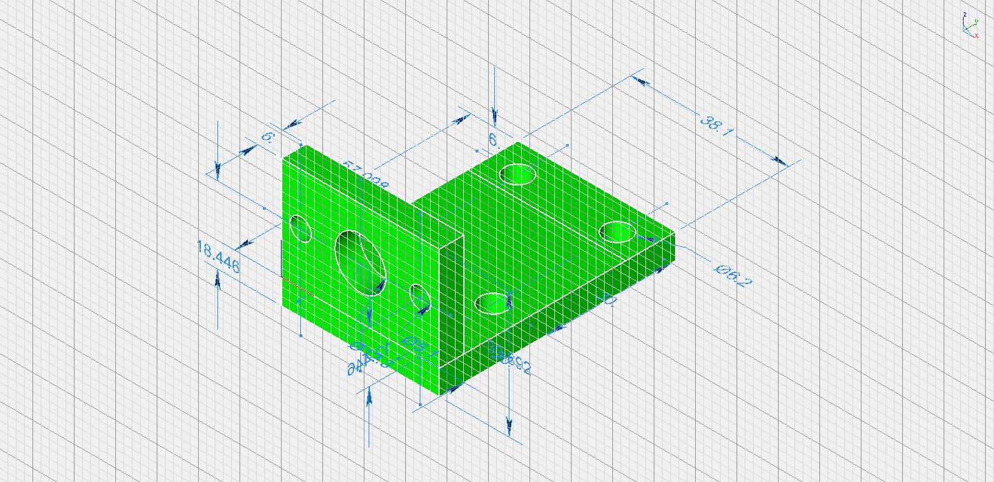

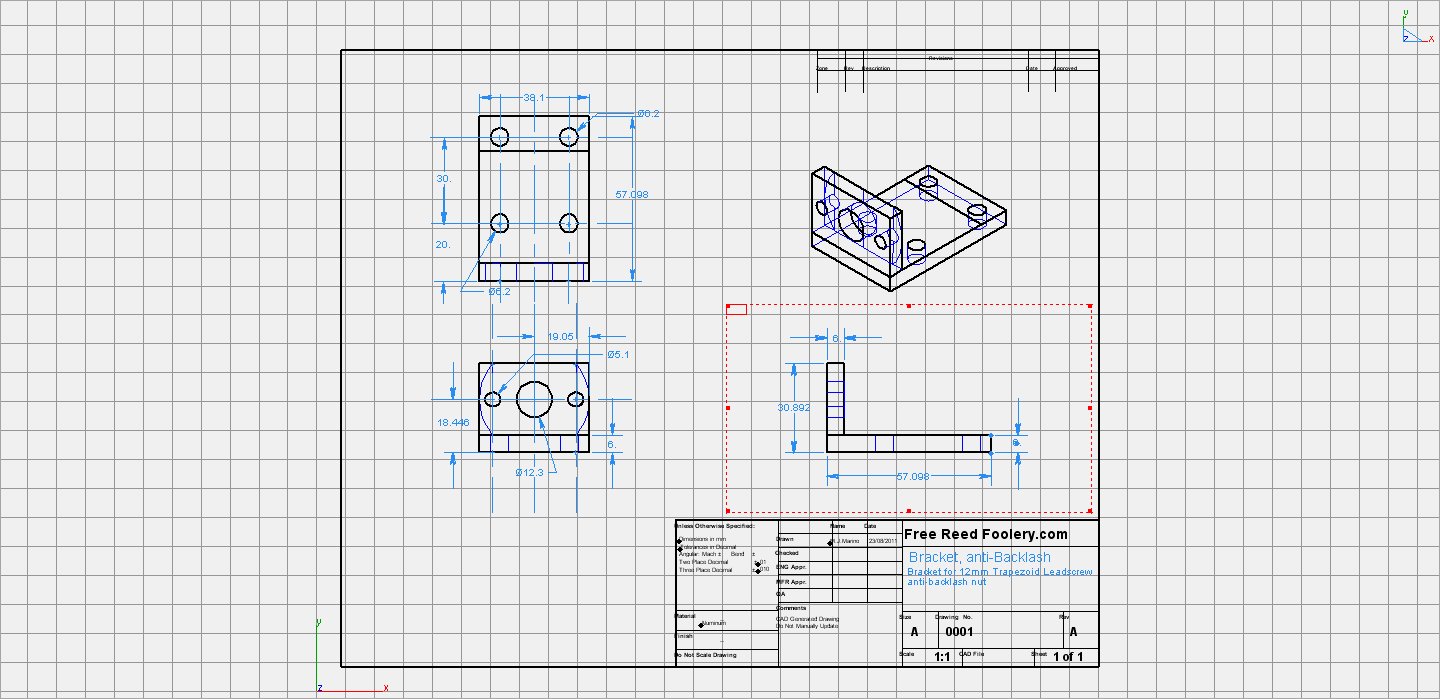

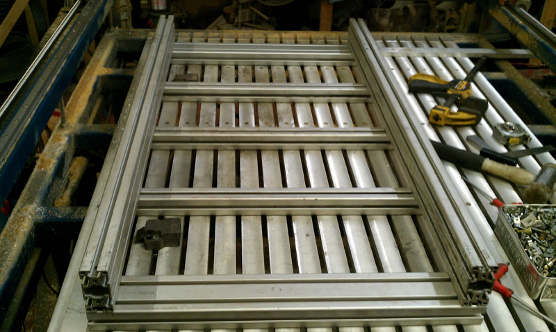

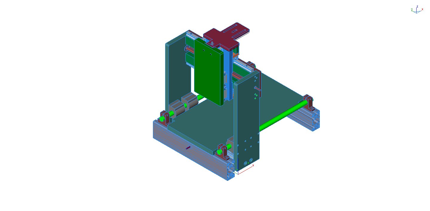

2 Attachment(s)
Well,
I said that i was going to get a jpeg of the model up.:whistling:
Well here is something a bit more useful as things are now moving forward. This is the base.. I will be adding more as I or Jazz have them to put up.
Attachment 4889Attachment 4890
On top of the 80 x 40 on edge profile is going index plates for the rails and on the ends will be the stepper mount plates on one end and a buffer plate on the other that will also lock the ends tighter together.
Watch this thread for more as things develop. A very big thanks to Jazz in this and as well as a thank you to Luke and James.
Michael

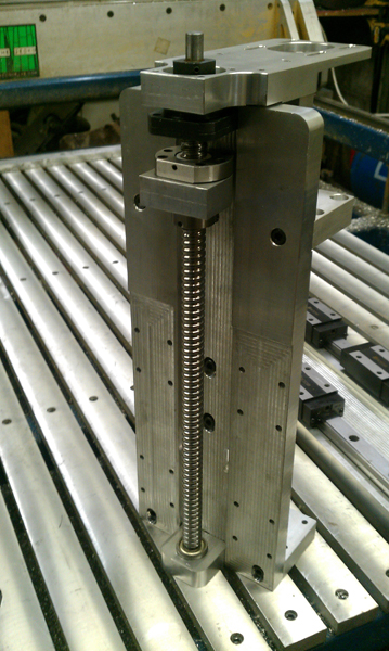

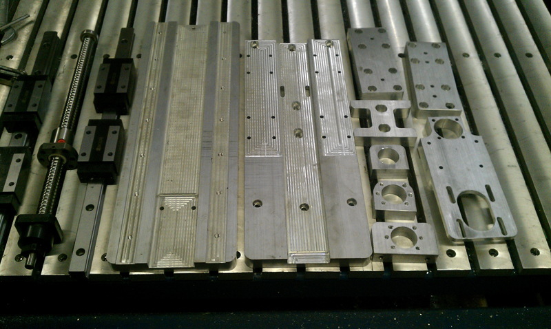

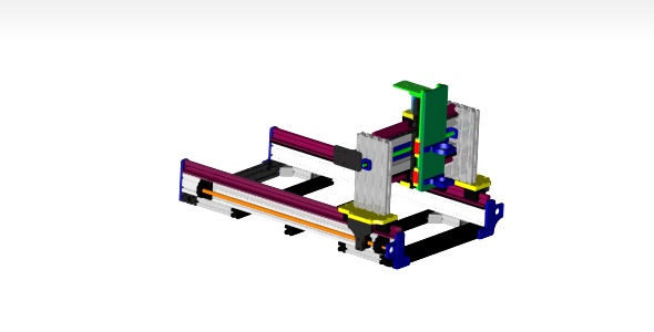

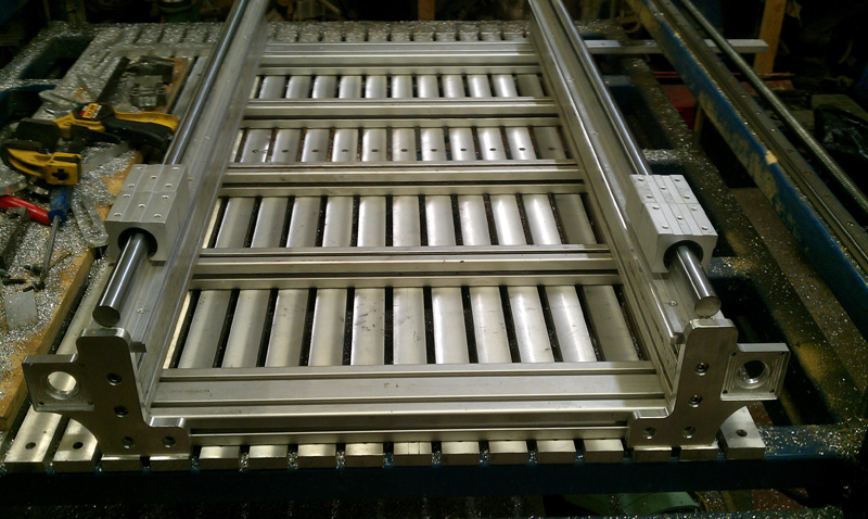

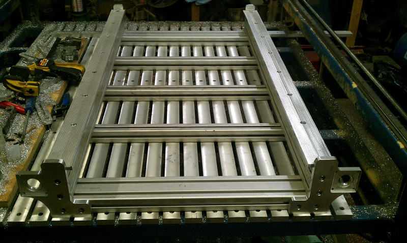

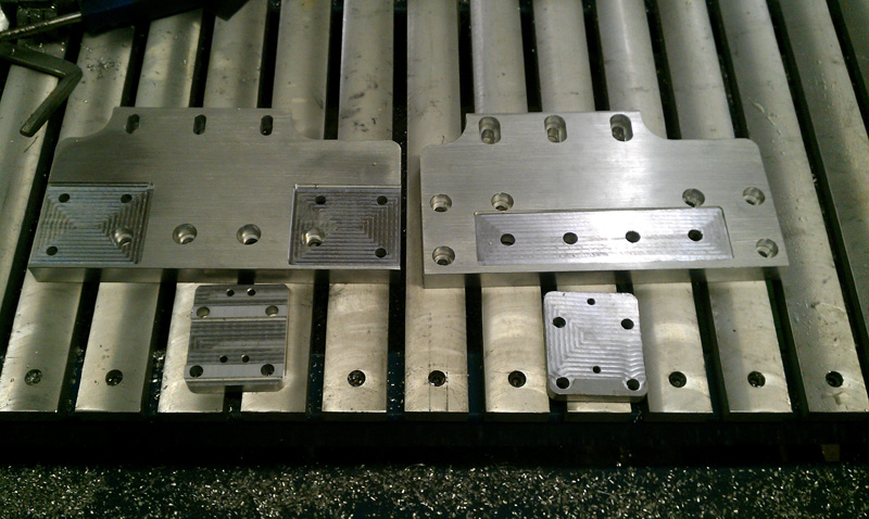

3 Attachment(s)
A few more pic's as things progress.
Attachment 4977
Attachment 4978
Attachment 4979
Will attach an image of what the finished gantry router is going to look like minus bolts as have not taken the time to put all th bolt holes in yet nor put bolts where they belong.
A Big thanks to Jazz for sending these pic's as he is progressing with the build. Should be getting the ballscrews arriving soon and also finally saved up enough to get the extra stepper motor and a few other items that needs covered.
Michael

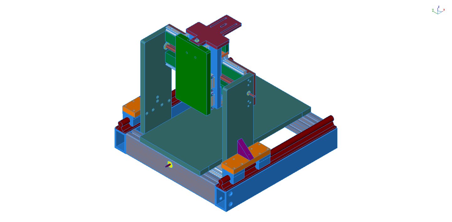

As promised a jpeg of the model working from:
Attachment 4980
Will see how close the finished item is as things always go through changes.
Michael

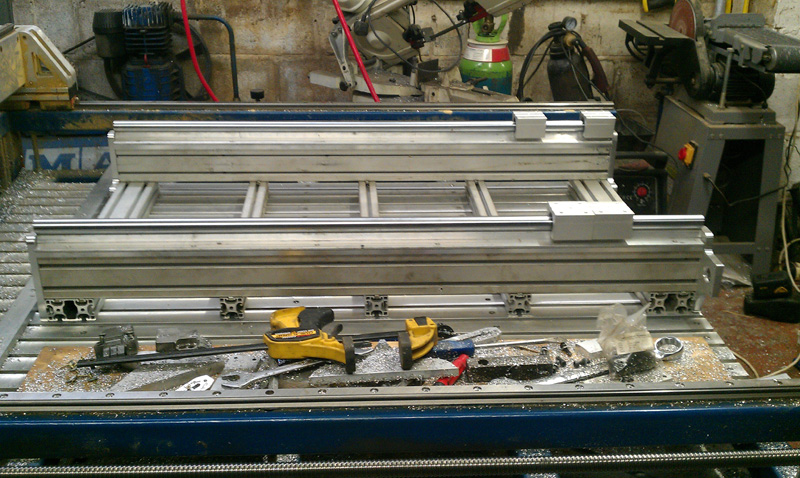

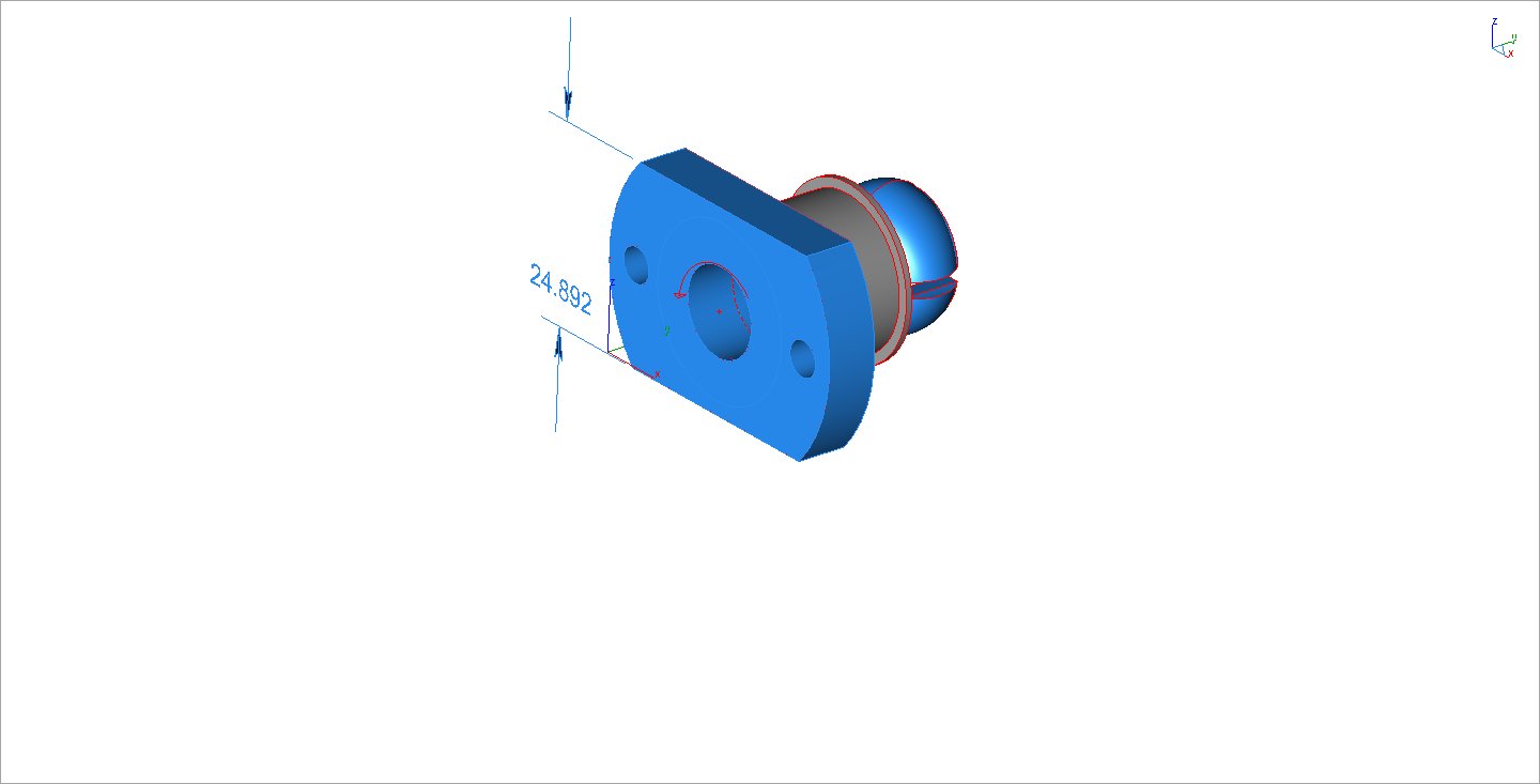

2 Attachment(s)
Well more is happening and still waiting for the replacement ballscrews but it is only a week so not really worried.:whistling: Here are a few update pic's that Jazz has sent to me, showing some of the progress and how nice it is starting to come together.
Attachment 5039
Attachment 5040
Hope you folks enjoy and will post some more photo's as able.
I really have to say thanks again to Jazz for the work he is doing it is looking great and coming together very well.:toot:
Michael

hello, i was just wondering how you connect the ali profile together? i cant work it out from the photos. im building something similar to this design and need to mount the pieces the best i can
Probably best if I answer this question.!
There are numerous ways but Micheals frame is bolted together using a combination of Profile manufactures specific fasteners, T-nuts etc and ordinery bolts which go into drilled and tapped holes in the profile.
I've attached some pics may help show better.

Well folks here are some more pic's and thing are progressing well. Just waiting on th replacement ball screws to arrive and Jazz has a bit more cutting drilling and tapping to do. Other then that I am getting the shop ready for the machine, getting g-code ready and need to get the micro switches for the home/limit switches and looking into energy chain and the pattern on the forum to decide whether to buy or build it and how I am going to be mounting this onto the machine.
Now the real reason you are looking at this post is to see the new pic's so here they are:
Attachment 5057Attachment 5058Attachment 5059
The ball screw in the pictures is one of Jazz's as the Y and Z axis screws are still in route due to the problem mentioned earlier in this log. Really happy to se it this far.:toot:
Jazz is doing wonderful work and really helping get this done. I have got a bunch of g-code waiting and working on more as need to get production back up as soon as the mill is in place and had the set up, test runs and final tweaking done.
Michael
