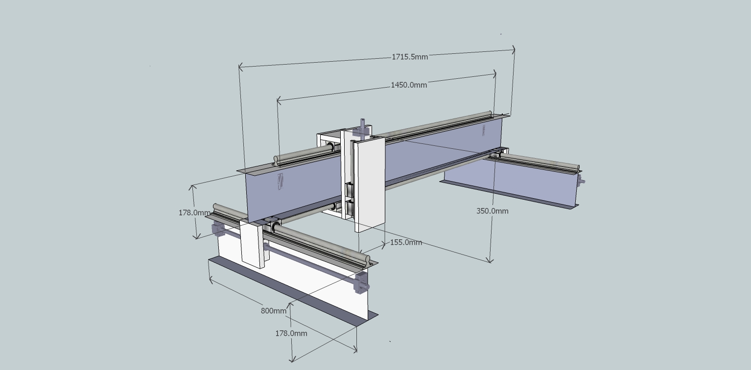

Ok, still struggling a little with sketchup. This is my latest attempt and i have put the ballscrew on top of the i-beam. Would this work, i'm struggling with ideas on this.
Ignore this

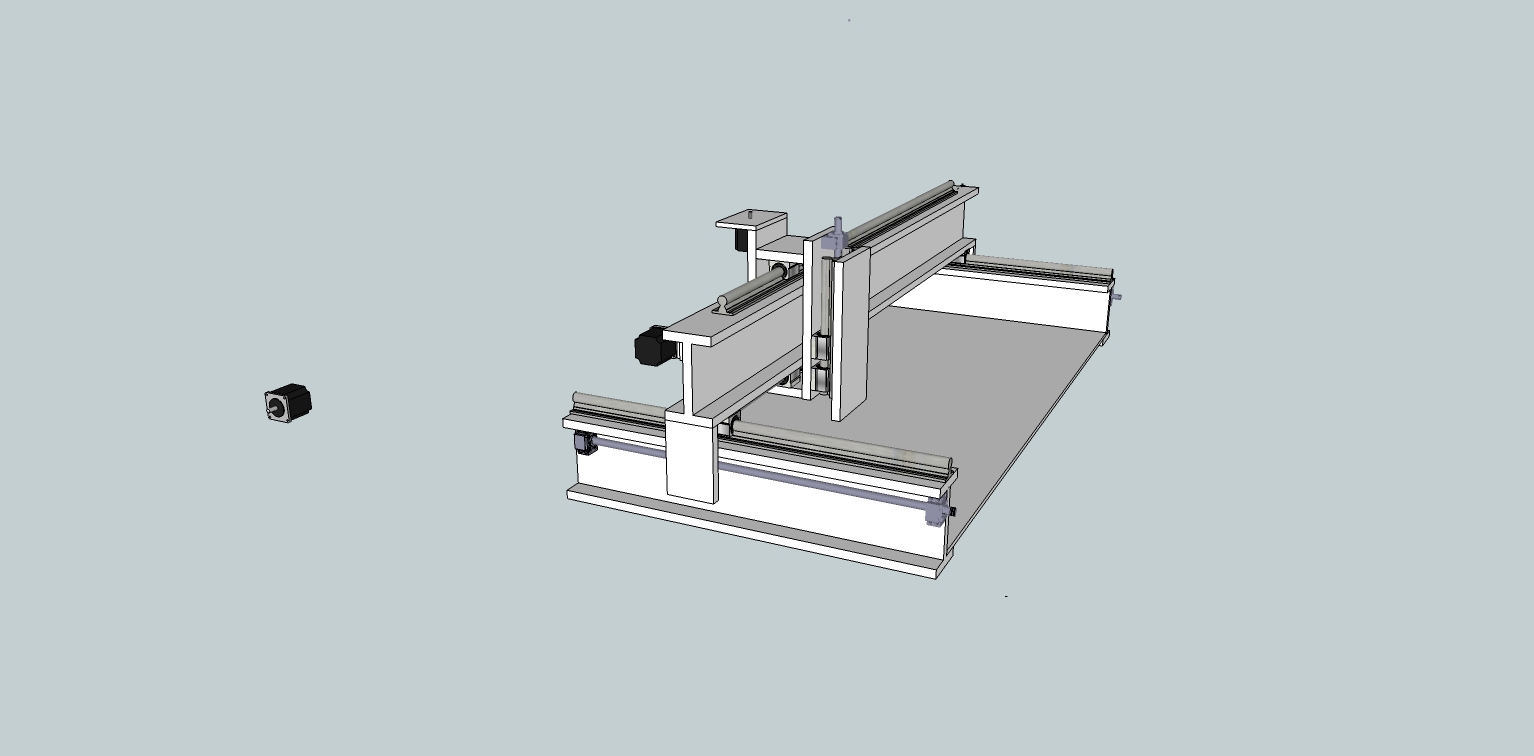

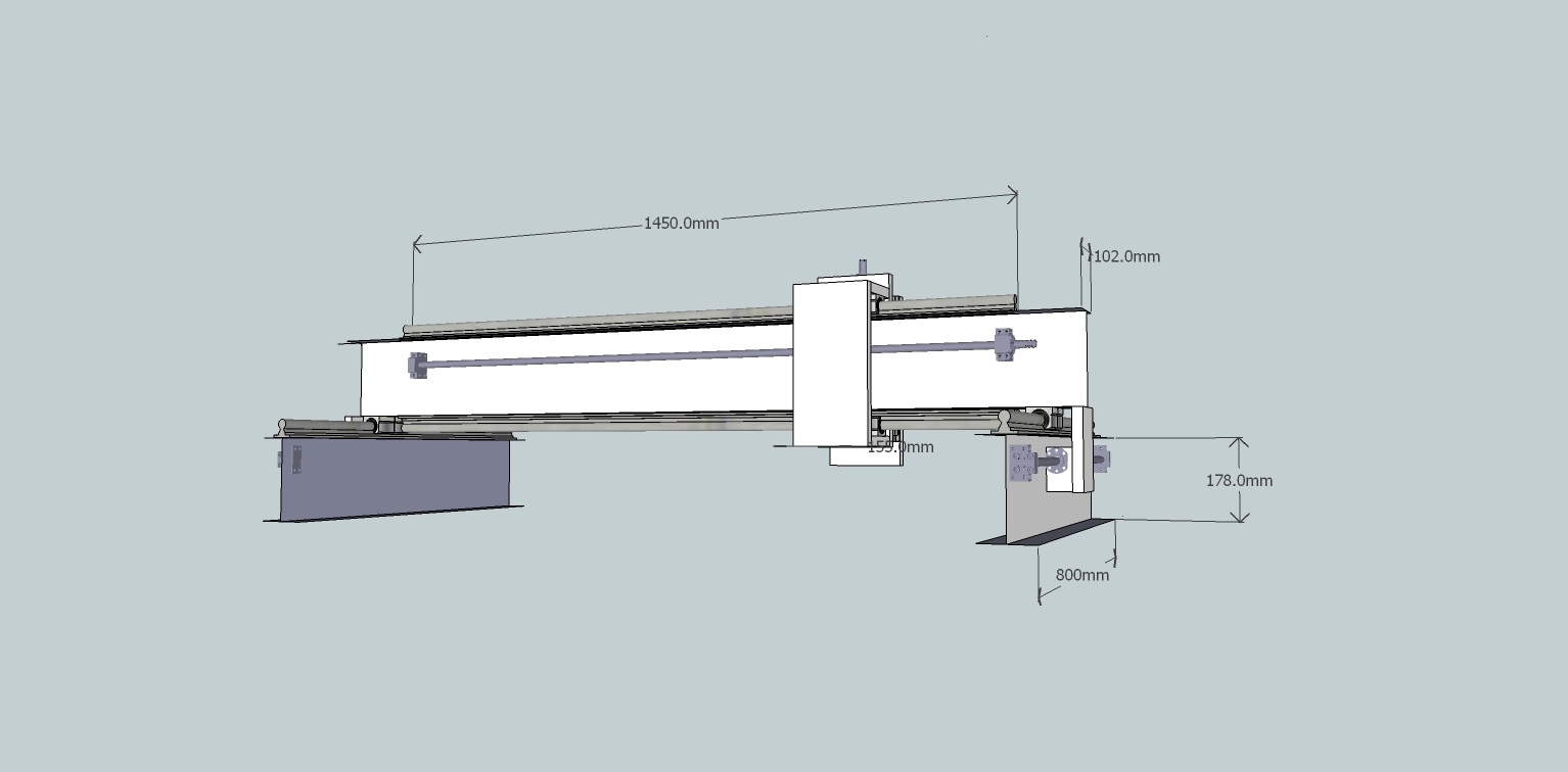

Ok, i think i'm finally getting there. All plate is 20mm thick ali and also using I-beams. I'm not sure if the screw mounts are ok doing it this way. Would the bearing blocks need spreading out more. All the rails are 20mm with 1610 screws. Some pictures to show my progress and please tell me where i have gone wrong and where improvement can be madeAttachment 6471Attachment 6472Attachment 6473Attachment 6474Attachment 6475
I will have the ballscrew end machining increased from 15 to 30mm as i want to use belts and pulleys.
The RSJ's are 178x102x19mm, would it be better to use a smaller size on the gantry, 127x76x13mm.
Also just realised i haven't taken into account the thickness of the beams

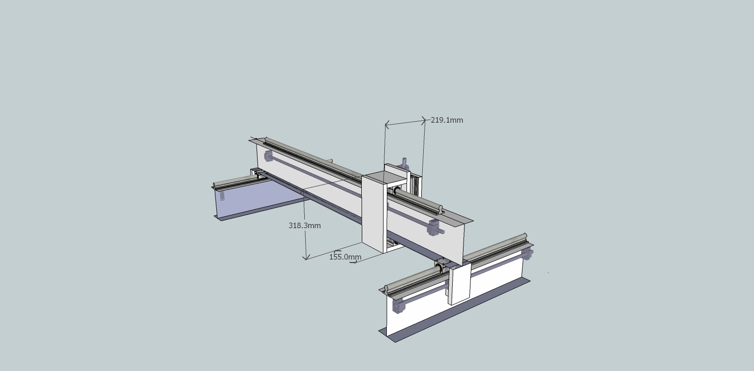

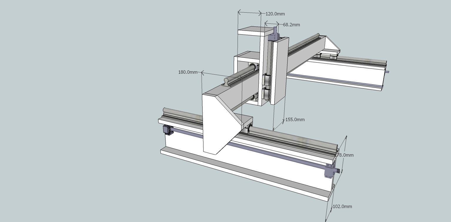

Ok have redone the RSJ's and added steppers.Attachment 6482Attachment 6483Attachment 6484
Although it's convenient to use RSJ on X and Y, you'd be better off using a different cross section. The torsional stiffness of RSJ is pathetic, hardly much better than a sheet, so especially on the gantry where the cutting forces will tend to twist the beam you would get a lot of deflection. Similarly RSJ is poor under shear stress, which is the case on the X-axis. To an extent you have compensated for that by using a large thickness, but with less material you could use box section and get much greater stiffness.
One reason not to use smaller RSJ is it reduces the vertical spacing of the Y-axis bearings, which is something you want to maximise.
What you've drawn is still fairly strong, so it would work - but that is purely because of the large thickness.
Try folding an RSJ cross section and a box section out of card then try and twist them and you will see how big the difference is. This spreadsheet lets you compare them.

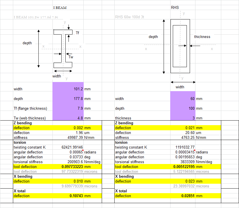

a) 1.7m of RSJ @ 19kg/m = 32kg, whereas 1.7m box section @ 7kg/m will weigh 11.9kg, thats nearly 2/3 less to move around...
b) RSJ will deflect .004mm in centre under its own weight plus 0.0004mm per kg load (i.e. negligible), Box section will deflect 0.018mm under its own weight, plus .004mm per kg load. So a 10Kg z-axis will deflect the rsj gantry .008mm and the box section gantry .058mm. In the scheme of things this is negligible.
so even though both are negligible as you put it.. you would still steer him clear of the easier/cheaper option of an rsj that needs little work over him welding box section and possibly leaving room for him to create errors...
or have i mis-understood... i'm watching this thread as the thought of rsj being an easy way compared to welding box section appeals to me
Not sure i understand your logic... given a lump of i-beam or a lump of box section, you're still going to have to drill holes to mount rails etc. He was suggesting the rsj for the y-axis element of the gantry... not sure what welding is needed???
Also he says he can get a section for a tenner... the cheapest 178x102x19 rsj on ebay is £19.50/m min order 4m.. plus carriage...
ok maybe i've mis-understood the whole thing... i was under the impression that if he used box section then he would have to do some welding or atleast joining 2-3 pieces where as the rsj was a solution that didnt need any work other than attaching other parts?
my thought are that he is using 2 pieces of box to make what would be the top and bottom of the beam... but i can now see you are talking about one big piece of box the same size of the rsj... sorry my bad
Once you include torsional stiffness in the calculation the single box section is much better than RSJ:
Attachment 6517
The problem with either of these options is mounting the rails with sufficient accuracy. I doubt either steel RHS or RSJ will we sufficently accurate to mount the two rails on opposite faces, since the variation in the 'height' of the section will change the spacing of the rails leading to binding. Seems a bit risky... could fix it with shims I guess but you don't want to go there.
Instead I'd use two pieces of the 100x60 box section with one rail on each as that will be far stronger than just one and solves the problem of maintaining rail spacing.

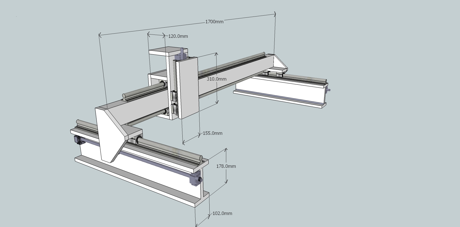

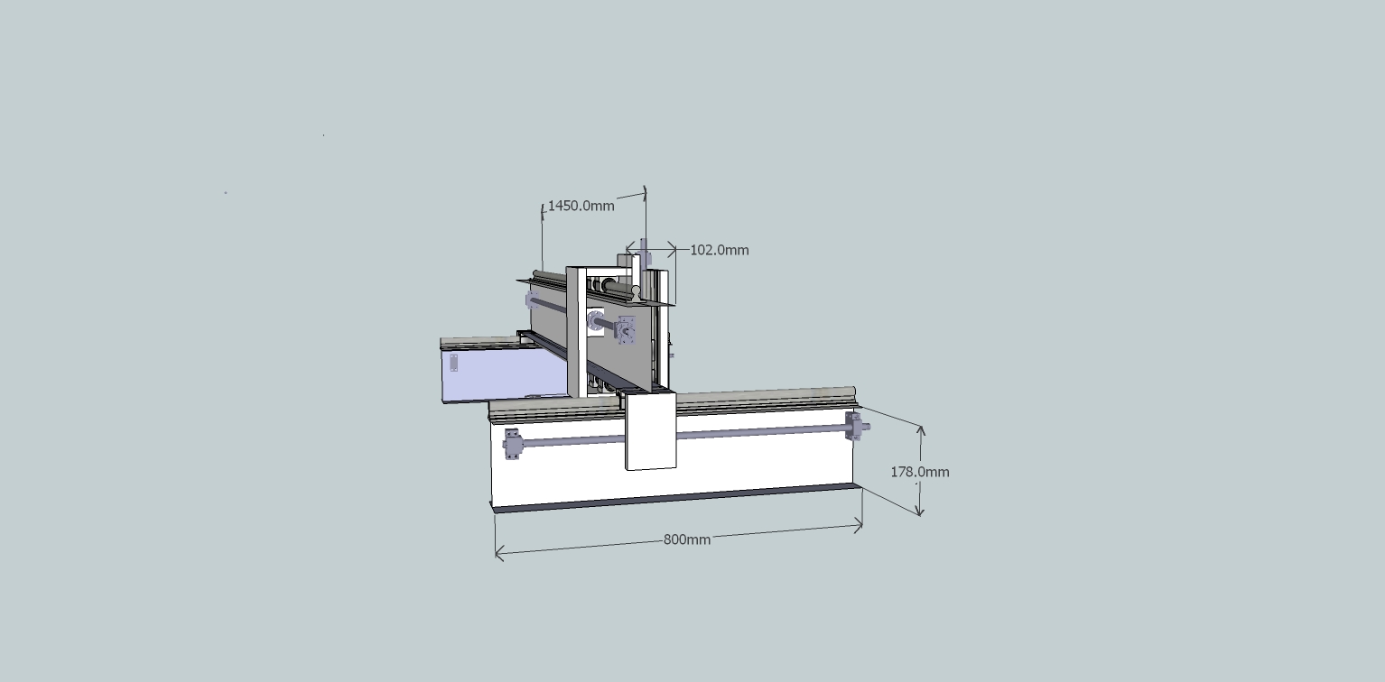

Ok, here is my latest attempt, trying to incorporate every thing that has been suggested. So i will be using 20mm supported rails on every axis and 1610 ballscrews on every axis, along with belts and pulleys. The 2 rsj's will be 178mmx102mmx19mm and the gantry is 100mmx60mmx3mm steel box section. The gantry end plates and bearing plates are 20mm steel. The Z axis will be using 20mm ali plate. I have spread the gantry bearings out as been advised. Hopefully the drawings with dimensions will help.
Attachment 6528Attachment 6529Attachment 6530Attachment 6531Attachment 6532
The rails are 300mm,800mm and 1400mm. The screws are 350mm,800mm and 1450mm long

Ok thats good but bring the screw to the front, will be much stronger having the ball-nut close the Z Axis back plate.
Have you got the 20mm steel plate.? If not I think you'll maybe change your mind when you see the price.!! It's not really needed either and I'd use ali for easy working.
Ok, thats no problem, i will do that. Is this to prevent racking etcQuote:
No i haven't got any steel plate and a quick google has made me change my mind, but if i use ali how would I join this to the steel gantry?Quote:
Dean don't worry about it your only cutting wood the box section will easily handle it. The box can resonate but cutting wood it won't really matter or show.
There are also ways around this if it does by filling with sand. So long has the resonance doesn't affect the motors then you won't have problem and because your using belts then this won't happen and why it's good idea to use belts.
Excellent, an easy solution i didn't even think of.Quote:
Bolt or weld Angle brackets to box then bolt thru Ali plate into brackets.

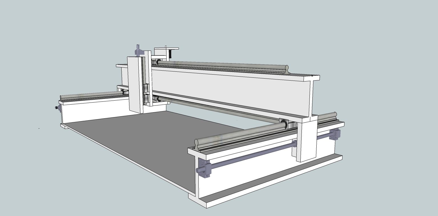

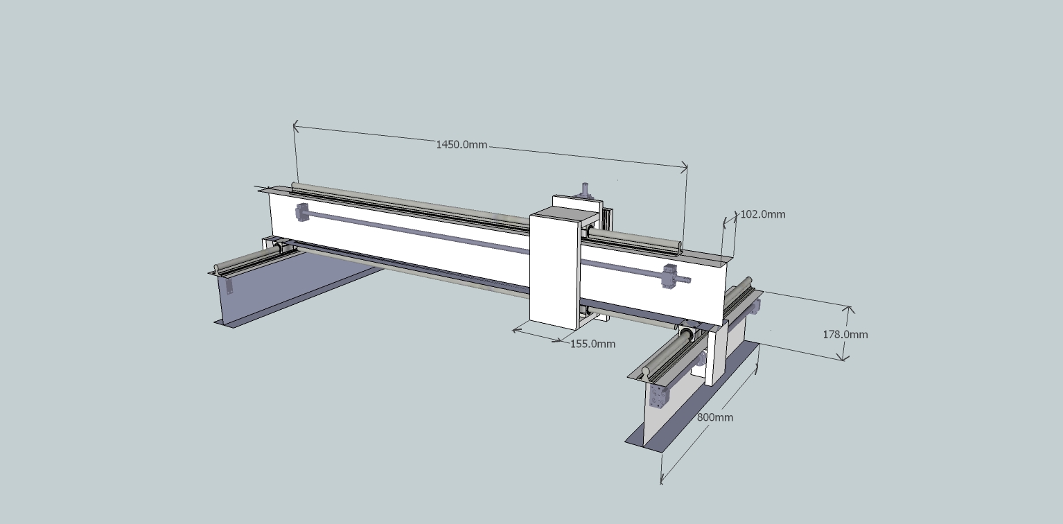

I have moved the ballscrew to the front of the gantry and will be using 20mm ali instead of steel plate, too costly. Have added some steel angle to corners to connect gantry to end plates.Attachment 6533Attachment 6534
Would this design be ok, i thought i would use some 100x60 box section as bearing plates. I would have some left over from the gantry and it saves on the Ali plate. The extra height would help with the bed, bit more room to play with. This box section is only 3mm thick, is that ok. I have used 300mm, 2 x 800mm and 1400 SBR20mm rails. The ball screws are 350mm, 2 x 800mm and a 1450mm length.
Attachment 6582Attachment 6583
2 questions for me that dont mean much to your build sorry :D firstly is that still an RSJ you got across the Y if so your second picture doesnt make it look like that... petty i know..
EDIT: oh scrap that i just read it's box section... my misunderastanding eek... either way second question applies
secondly how do you plan on fixing the box section to what i think is the RSJ?
The gantry is box section and this will be bolted/welded to the bearing plates. I have put some steel angle holding the Gantry ends to the end plates as well, but the plates will also be bolted to the bearing plates. Rsj is only used on the base "X"Quote:
