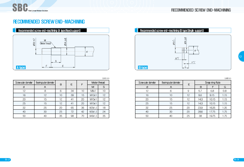

Quick question Kingcreaky regarding the machining of the leadscrews I was considering doing the same think about having both ends machined but using the fk bearing supports the only problem I have is that I cannot work out from chais drawings when assembled does the leadscrew actually make contact with the face of the bearing within the housing or does it butt up against the seal outside? or is the seal wide enough to accomodate the machined portion of the screw through it ?
I figure a drawing may help here to explain what I mean if I get a load of ?????? coming back :)

Sounds like the very same question I spent best part of a day trying to work out, then Jonathon helped me :D
this is what you are looking for (I think)
Attachment 7902
So, for me I wanted both ends machined to fit the BK style block. I wanted 1500mm of actual screw. First off, I required type A machining at both ends and I also wanted to drive the screw via a pulley so required dimension F to be slightly longer. so I order 2 of these for the X
** (1603mm Total length) I need (1500mm) of screw, so 1500mm PLUS one end machined to type A (except dimension F to be 25mm instead of 15, and the other end machined again to type A, but without any F
when they actually arrived they are more like 1606mm. (I think this is because in china they have more space for each mm :stupid: or their tape measures are backwards or something. perhaps the marks on the tape measure have to be slightly further apart to faciliate for the funny letters they use? PMSL

So am I right in thinking that where the screw ends and the machining begins is where it butts up against the bearing inside the housing?
Or put simpler if I ordered 1200mm of screwthread (plus the machining) with the bk attached at both ends I would have 1200mm of screw between the faces of the bk blocks?

right ignore the last bit I think I have figured it out, is there a small spacer that goes in the bearing block?

Quick question that I was trying to get answered earlier in the year but never got a definative so I thought I would get "paint" involved.
I was wondering if the BK12 bearing units have a rubber seal in them before the 2 bearings in the houseing and if so does the machined end of the ballscrew stop at this seal or the black part at the back of the unit or doe it fit right up to the bearings inside the unit. Picture attached is it A or B or even C and I am way off!

If I am not mistaken it is more like B but there is a little spacer at each end of the bearing so that the ball screw does not squash the rubber seals. Be in mind that you will have a bit of free movement at the BF end as the bearing can float in it, say about 3mm. ..Clive

You're not mistaken :)

Thanks for the replies, I also had one from Chai and confirmed the same thing I am actually planning on using the bk12 on both ends so wanted to make sure where the ball screw ended in relation to the placement of the bearing blocks.
