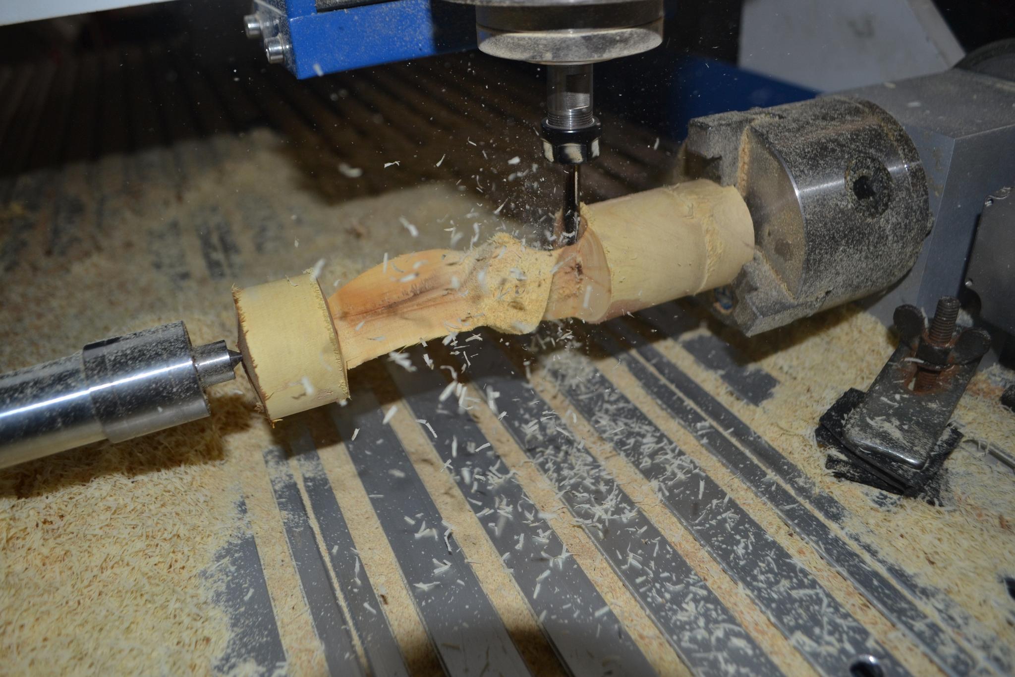

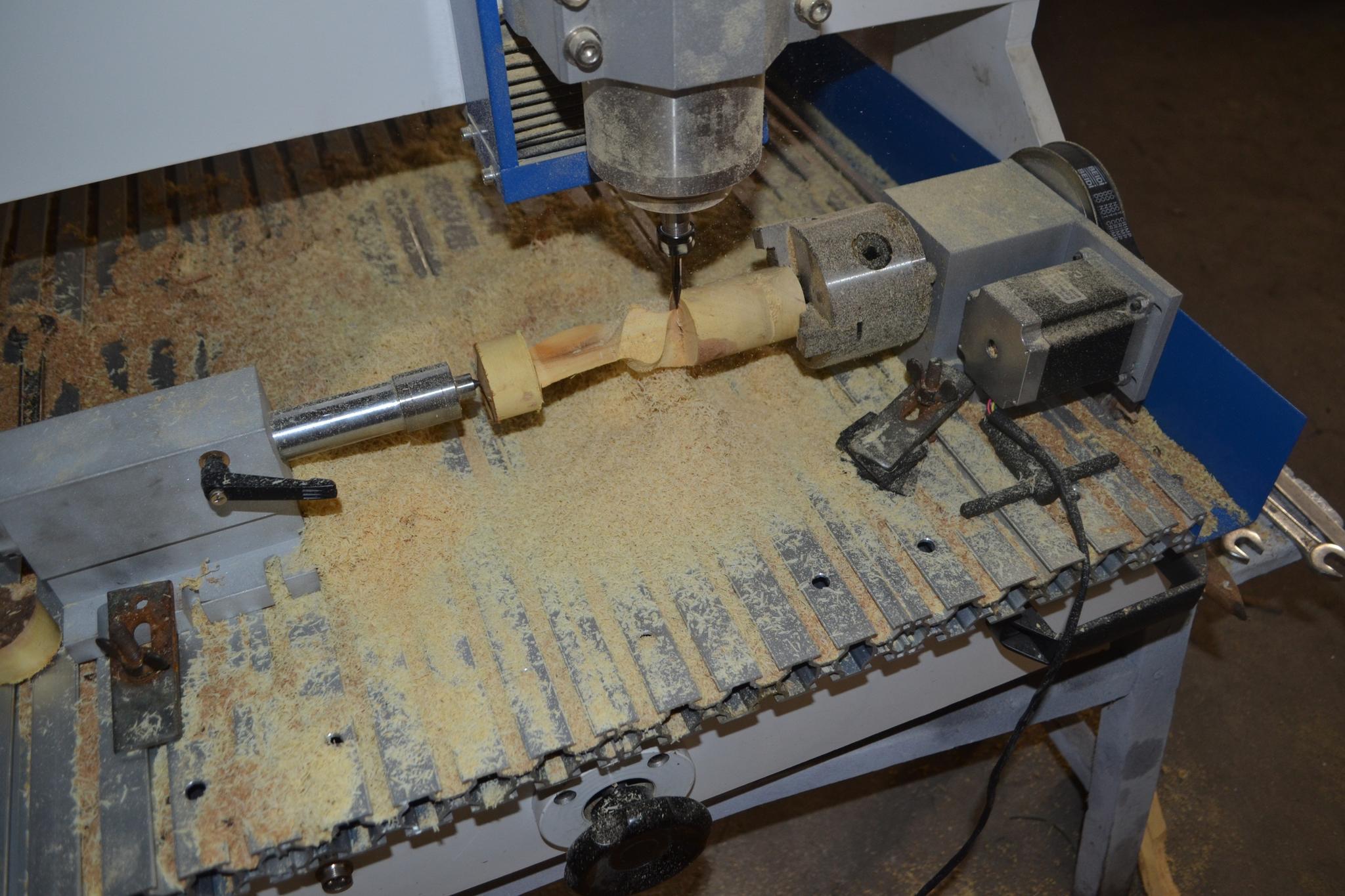

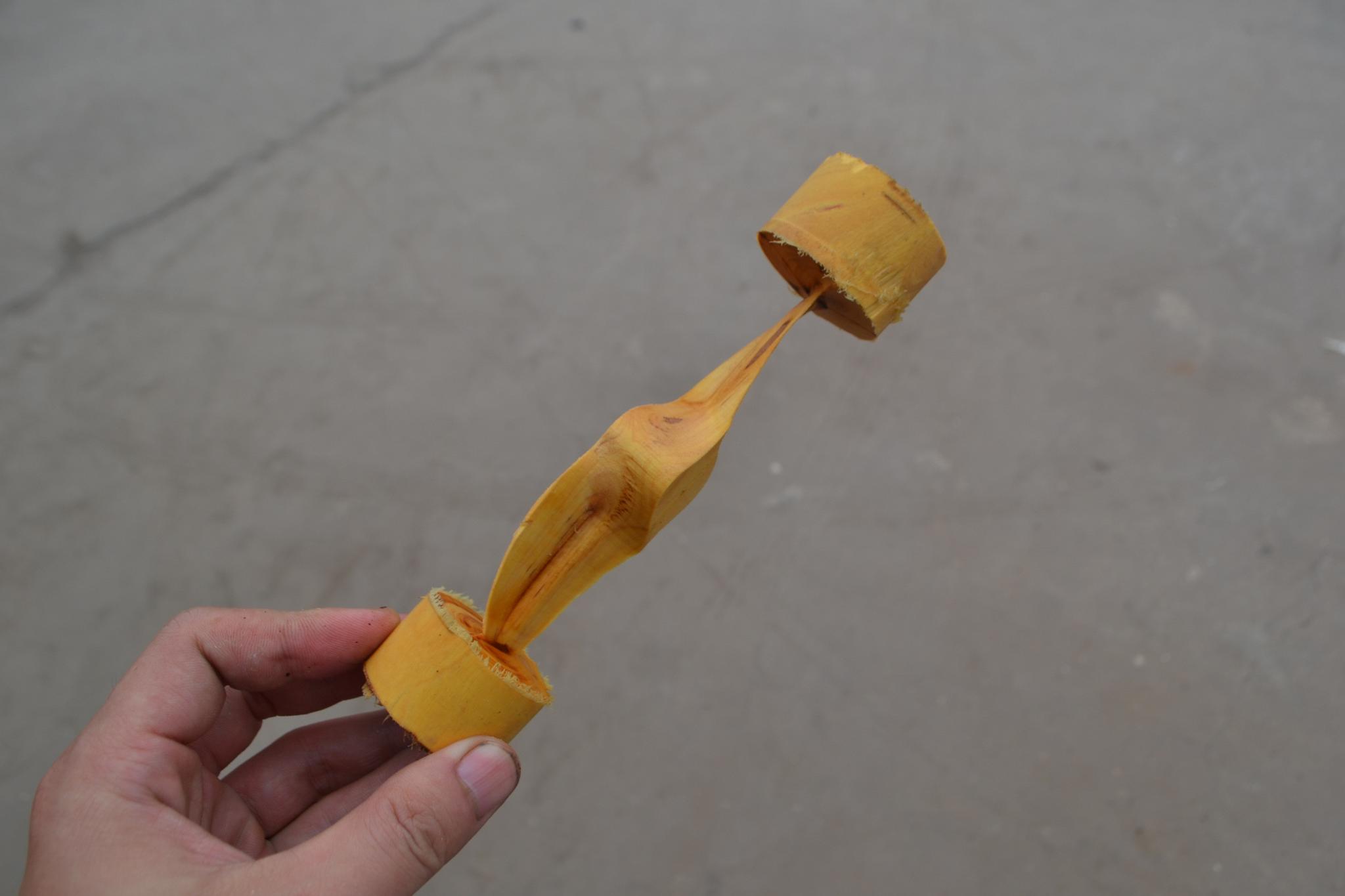

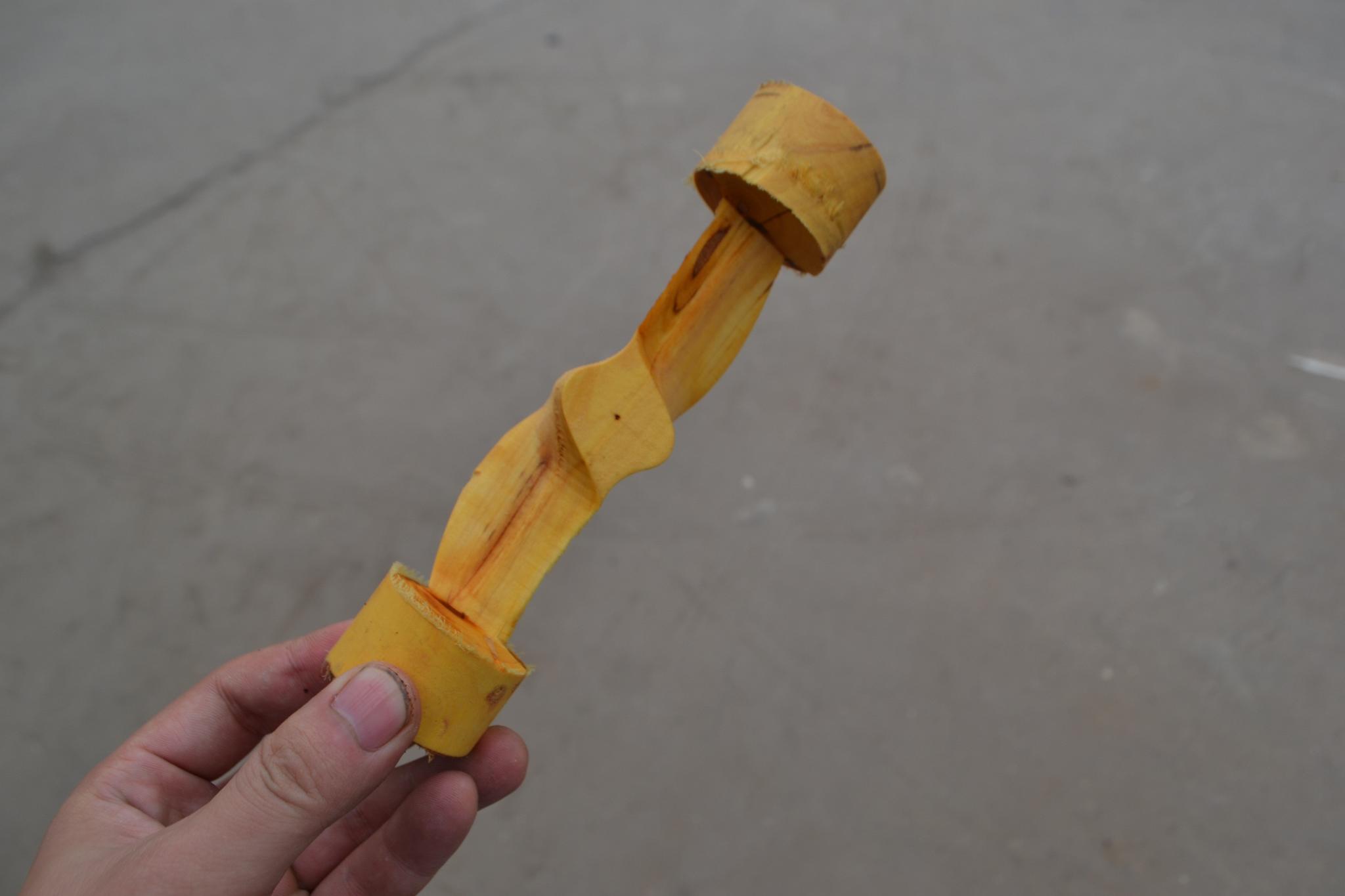

hi guys. how much do you know 4axis machine ? do you know what kind of work will this kind of machine do ? sometime. we , as maker of machine, really dont know if our machine will do this or that . we are supprise when our customers did some work with our machine. so i always keep learning how to make design and work with our machine. recently. i make one sample. it is one piece of wooden propeller. it is really fansanating and exciting. 4axis machine is really amazing. i think i can make some toys to my son when i am free. :hurt:
there is the pictures , i use powermill to do it. it is much more easy. dont know if any other good software can do it in easy way ? it will be excellent if it is free. haha, and of course, this can be done by 3axis. one axis can be replaced by rotary. but it will loose time to make rough milling.

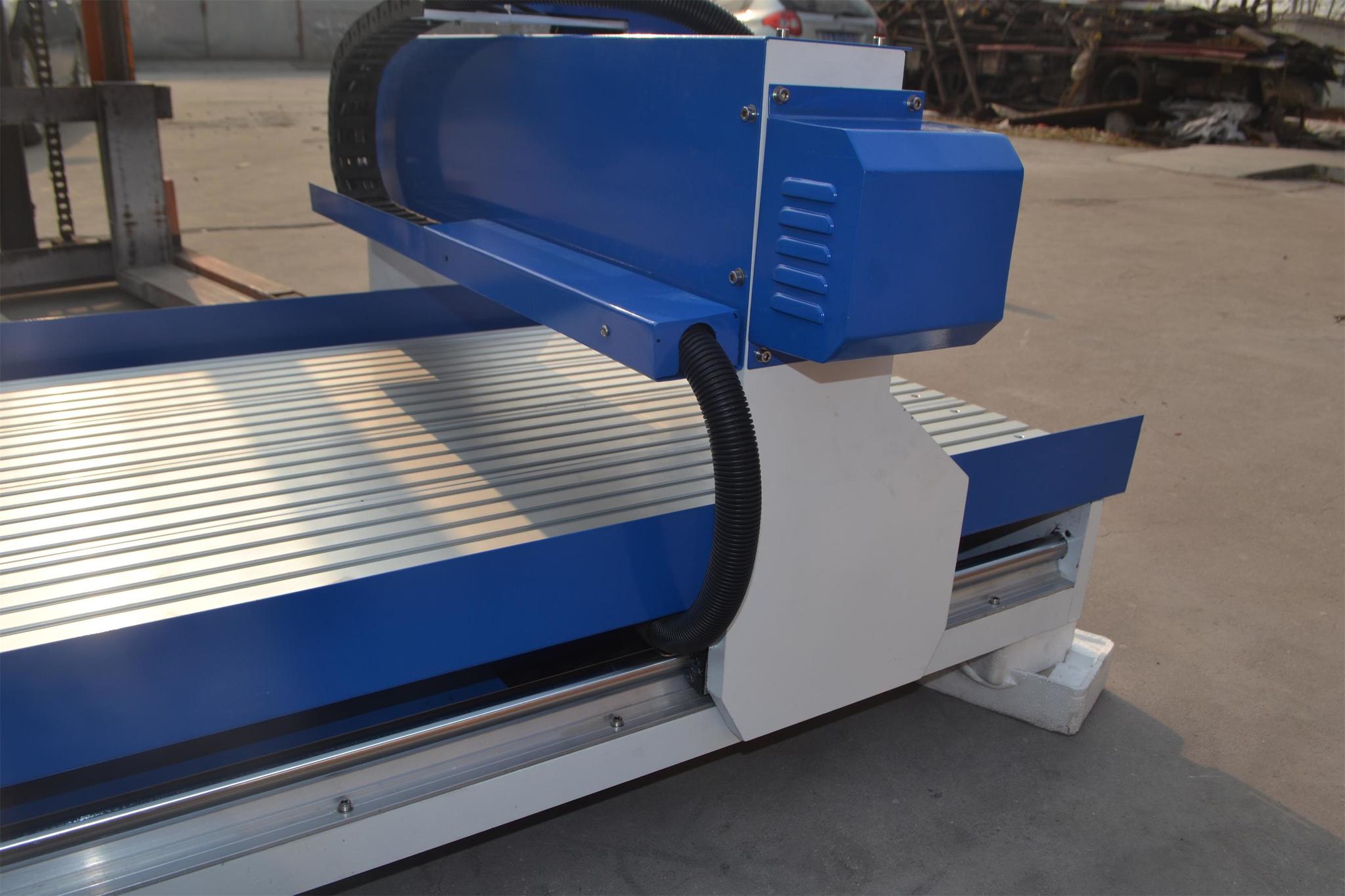

Eric said that now he puts SBR20 on Y axis in 3040m machines.
Do you still think that the 75 mm axis will be flexible anyway after this change?
