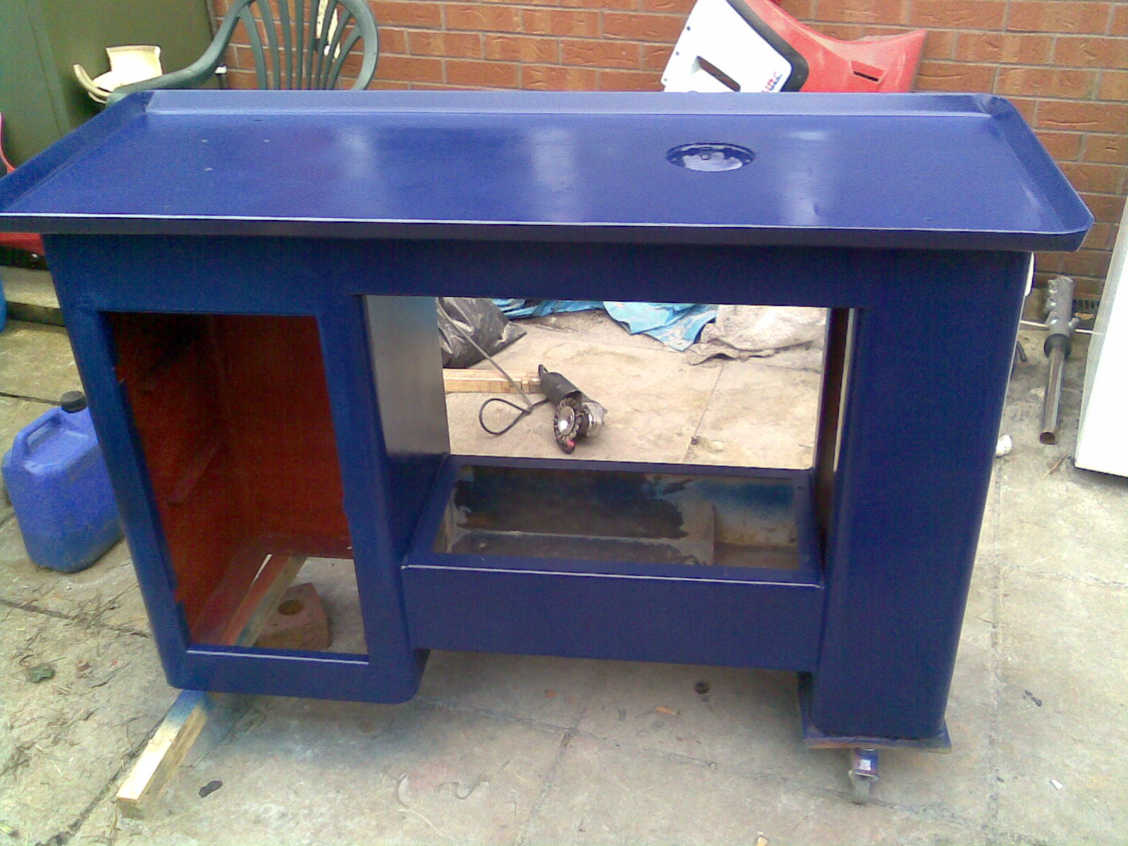

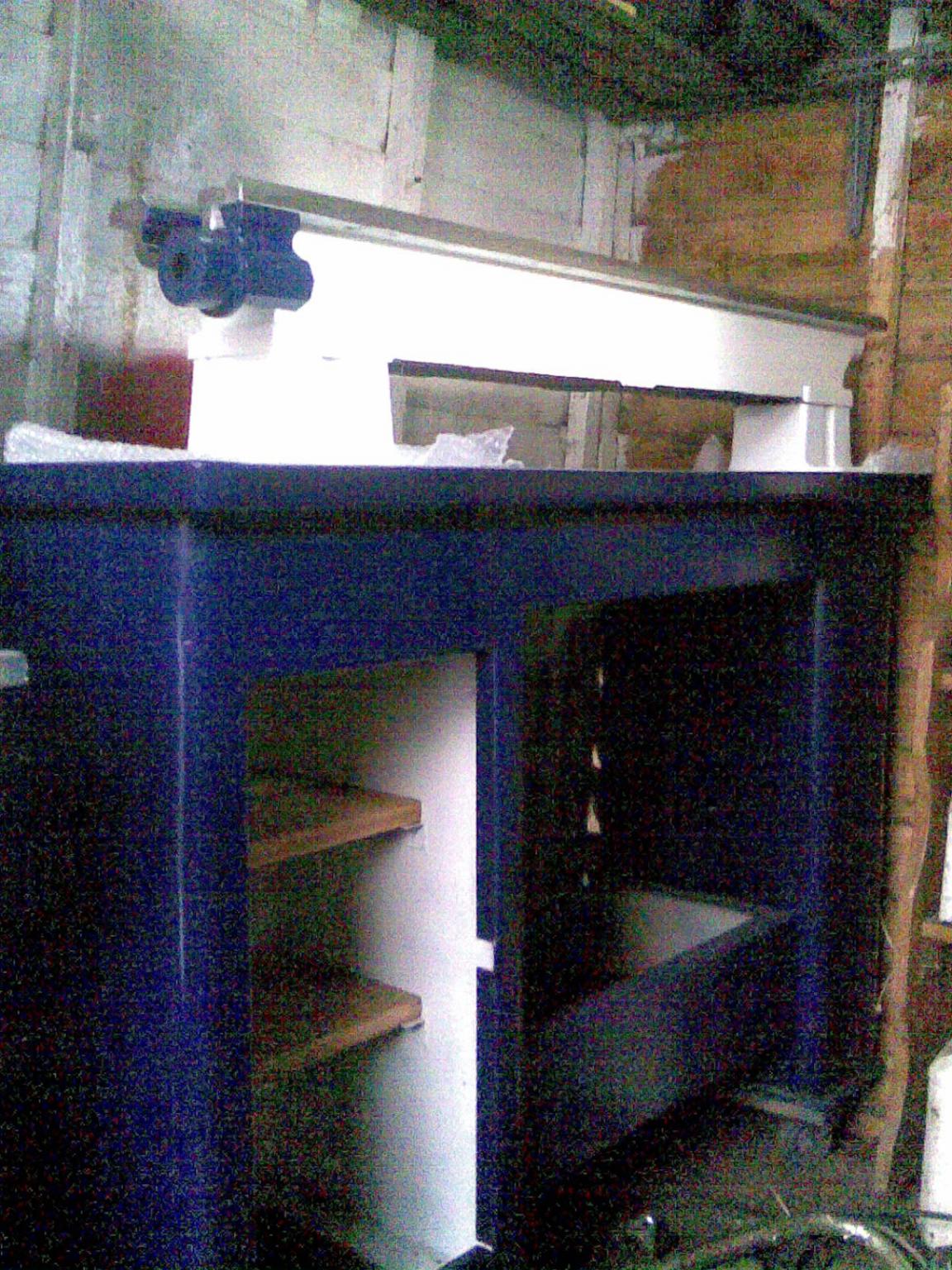

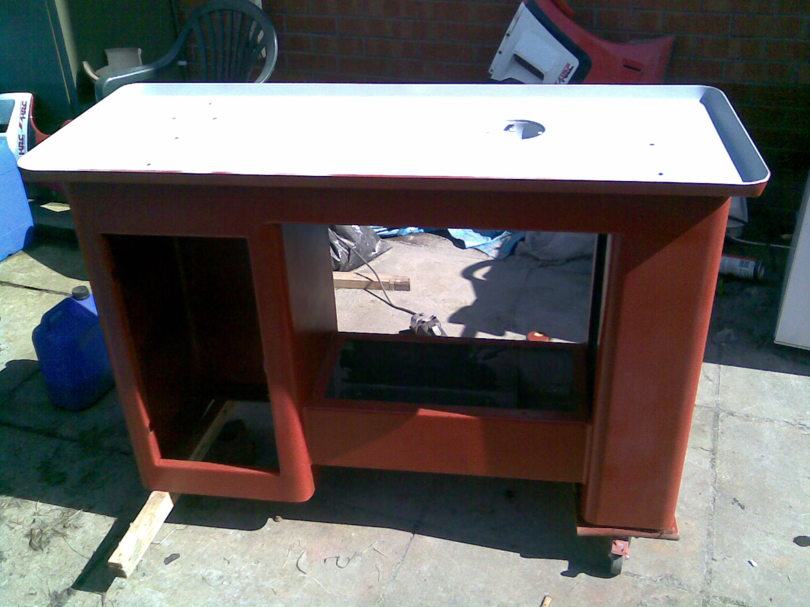

made a bit of progress today, finished striping the cabinet, sanded it back and then gave it a proper coat of red oxide primer. then i used the high build primer.
at that point i had a thought, is it really such a good idea to do it mainly white? it'd just end up grubby and quite horrible in no time!
Attachment 6233
the original idea was to do the top blue and the bottom in white but since the blue came out so well (pictures don't do it justice) i decided to go for the blue and use the white for the interior of the cupboard and the door.
first coat done, one more then lacquer should do it
Attachment 6234

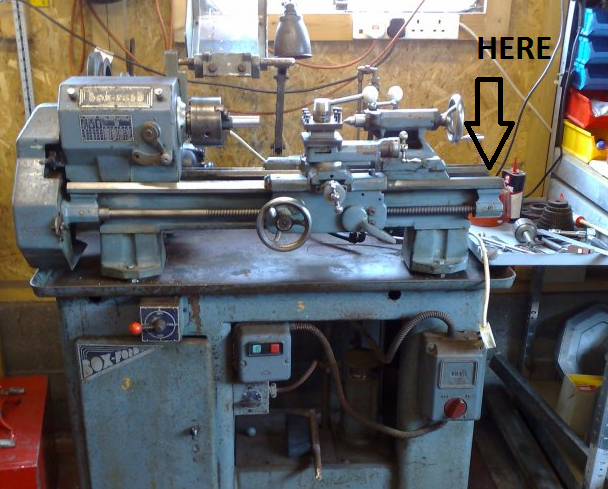

found these pictures today.
these are the first 3 i took of the lathe just before i bought it, back when i didn't have a clue :p
Attachment 6698Attachment 6699Attachment 6700
and for comparison...
this is the latest photo (note the bubble wrap method of paint protection)
Attachment 6701
sorry again about the disgraceful photo quality but its my only camera/phone

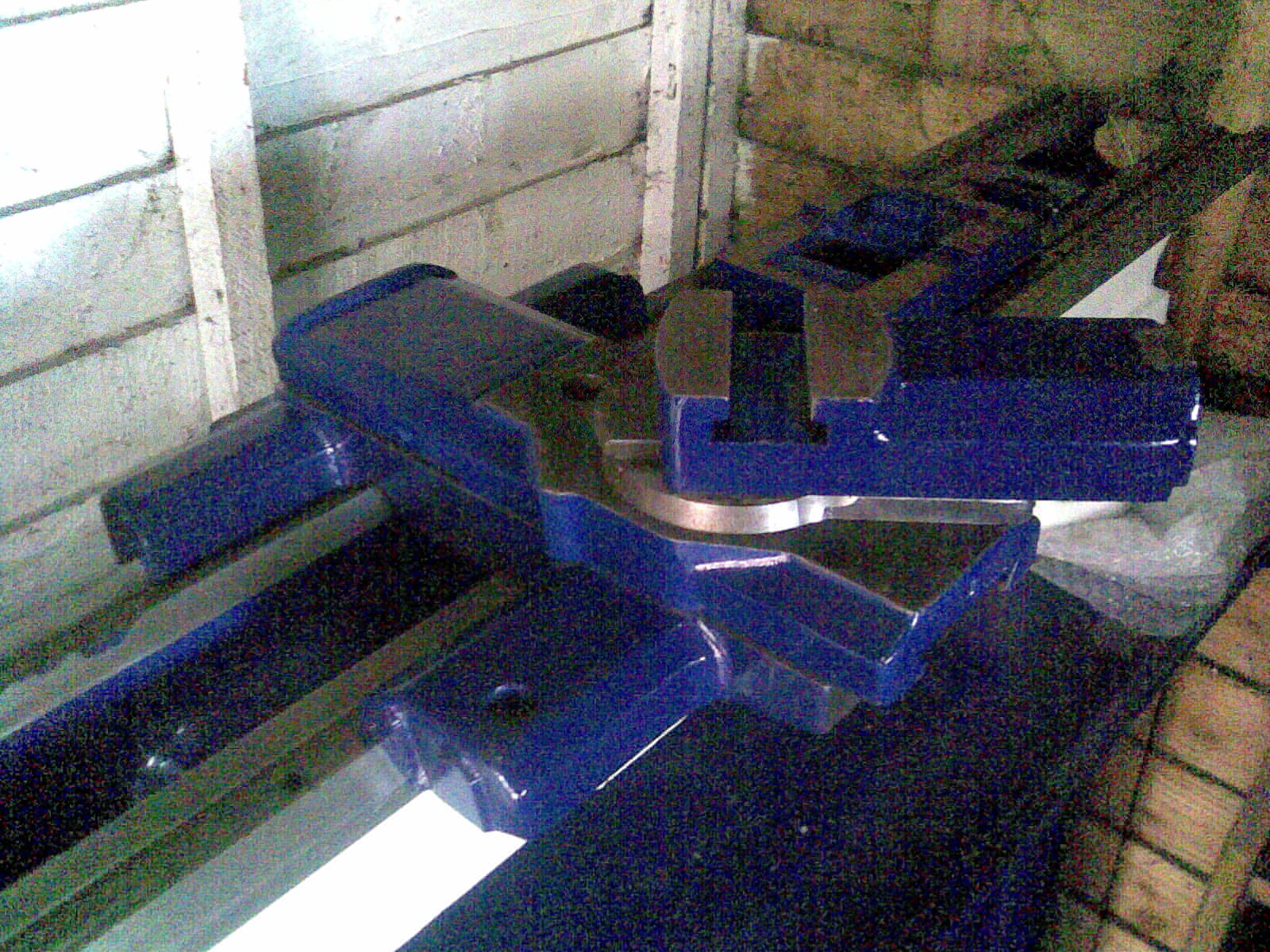

the carriage is looking well with the cross slide and compound loosely fitted for the photo
notice in the background the tailstock base casting sporting the same colour
Attachment 6843

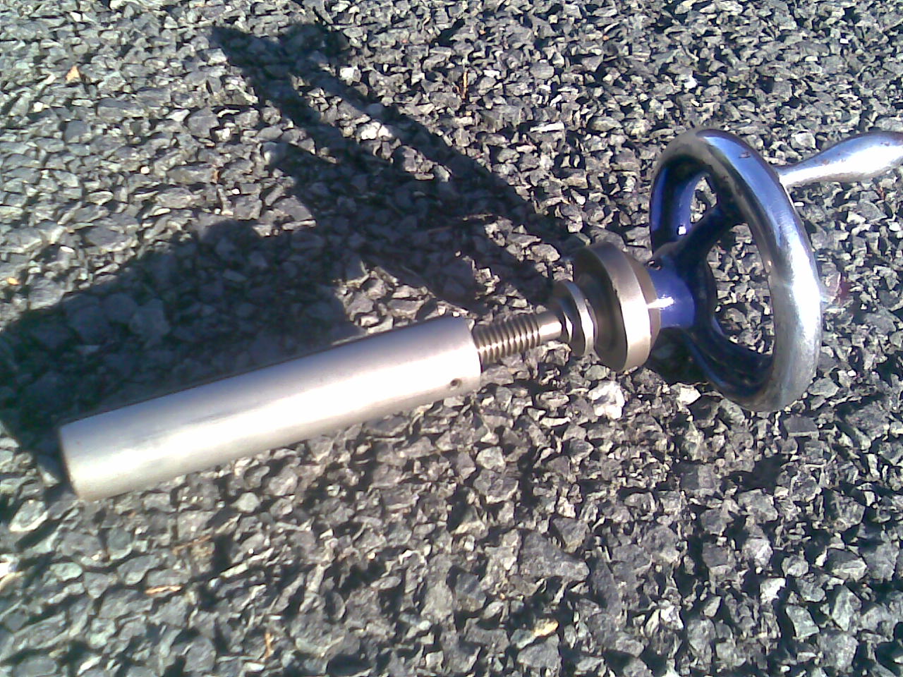

here we have the tailstock ram, screw and handle already cleaned and handle painted ready for assembly
Attachment 6847
all the paintwork done in this thread has been with cans, from primer to lacquer the technique i find works best is to be very patient and take things slowly. i found out a long time ago that if i try to apply a full coat in one go that i am guarantee'd serious runs so light coats with a few minutes in between works well
its also good to make sure the nozzle is 100% clear and the can has been well shaken!
