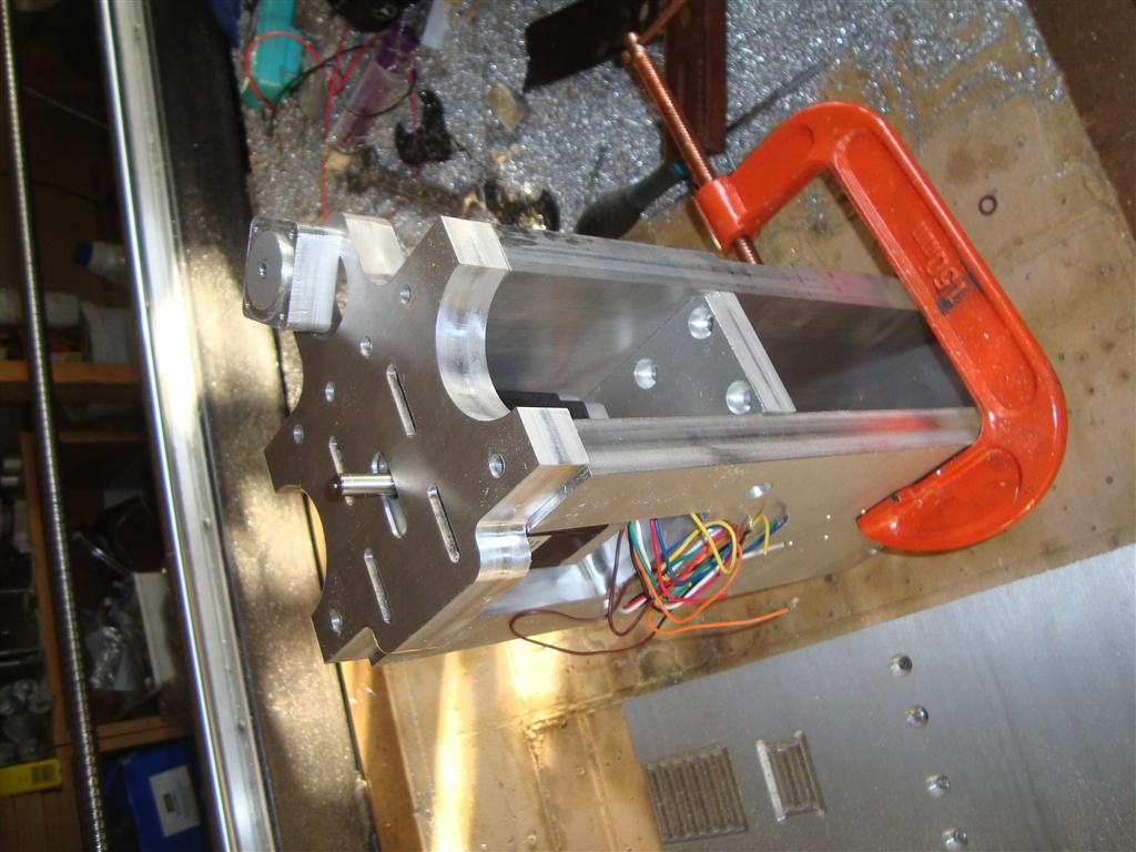

Since I've decided to go with dual x axis drive, my PC case control cabinet is looking too small to squeeze another am882 driver in, and also the recent decision to go with an ethernet SS and PDMX 126 BOB. So another part on my shopping list was a PROPER control cabinet, which as of today, am the proud owner of a used 600mm x 400mm x 200mm electric enclosure with slotted cable trunking, on/off switch and safety locks. Bargain at £40 shipped. Everything should fit now considering its twice the size of my PC case.
Attachment 8271Attachment 8272
As for advice, DON'T buy any electrical components till your machine is built. Mine are just sitting there, eating up their warranties.

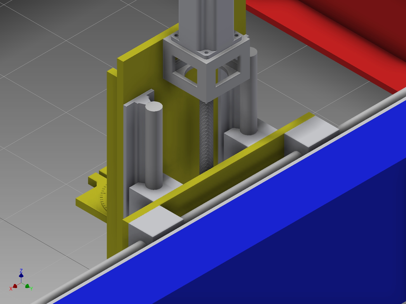

I don't want to hijack this post but i have a similar design and I'd like to use your experience.
I've designed the frame etc. in inventor and from the simulation i get deflections smaller than 0,015 mm with the force of 500N excreted on a tip of an end mill. Thus, the design seems to be sturdy and good enough but I'm waiting for any suggestions.
My questions...
1. Chinese spindle - which one to chose
There is plenty of different looking spindles on ebay and even more sellers so I'm not sure where to buy and more importantly which model. Which one do you have or which one you know is safe to buy.
2. how to avoid two motors.
I tried couple designs of frames to hold one ballnut for one ballscrew in the center under the table but it's hard to get small deflection without making it very heavy. Do you have some ideas how to solve it without 2 ballscrews and motors on each side?
How is the solution, with line that winds up on a rotating drum, called?
3. what's the free play on a linear rail's open bearings?
Is there any free play on them, how much do they flex?
Also I saw couple times that max speed for linear rail bearings is 5 m/s. What happens above that speed and how does it affect service life.
4. whats the advantage of linear guidways over supported rails?
They would cost me at least 2 times more. I've read the spec and according to it they don't deflect almost at all. What are the other advantages and are there any disadvantaged besides the price?
5. End supports for ballscrew.
I saw a design where instead of end supports fixed to the gantry or frame there where bearings directly fixed to gantry/frame. It seams that it might be stiffer and cheaper. What do you think of it?
Attachment 9324Attachment 9325
Kind Regards
Bart
#1: This guy is ok. Most of them are the same spindle and probably out the same factory.?
2.2KW WATER-COOLED MILLING AND GRINDING SPINDLE MOTOR WITH 2.2KW INVERTER VFD q3 | eBay
#2: Honestly there is no solution to match driving from both sides whether twin ballscrews, R&P or belt drive it's by far the best and easiest way to get accurate stiff machine. The wire/drum is just a bodge and best doing it correctly first time.?. . You'll only end back there in the end.!!
Unless your machine is narrow format, which it doesn't look, then single screw just won't work good. Making gantry wide helps but there's a limit before it gets unusable or feasible.
#3 Can't answer that question without knowing which make and what size linear rails. What I can tell you is even the lower quality units are capable of handling forces far beyond what you throw at them or what your machine design will handle, so it will fail long before they do.!!
#4: No contest here linear rails win hands down in every department by a very big margin. They can't be compared really in accuracy and performance terms.
The other advantages are longevity, they will easily last several years longer than supported rails, even in very harsh conditions. Hassle free usage, fit grease occasionally and forget.
Disadvantages over linear rails is they don't tolerate poor workmanship and misalignment.
#5: Show us and will comment but until then not sure what you mean.?
Now your design.?? . . . You have a problem Houston (several actually).!!! . . . . but this one Is a common mistake easily missed.!
The linear bearings on the Y axis can't possibly be fastened like you have them drawn.? Chicken and egg problem.!! Fasten plate on one set and you can't access the bolts for the other bearings.!!
I'd also consider using different thickness material for the Z axis.? Those thin plates, even with the bracing will resonate while cutting which will affect quality of finish. Don't rely to heavily on the Cad simulation, without inputting all the variables and cutting forces then it won't show this. I know from experience that if you plan on cutting hard woods or hard material like aluminium then your Z axis just isn't strong enough.
Just remember no matter how well built or how strong or accurate the rest of the machine is it's the Z axis that takes all the cutting forces
and if this flex's or resonates the rest don't matter a jot.!! . . . The machine is only has good has it's weakest link, this Z design is weak.!
( Also Don't rely on the Linear rail adding strength they don't really add much.!)

Thank you for your interest in my design
I guess I should have started with some spec of the design.
Frame dimensions
W x L: 1400mm x 1800mm
Red and Blue is steel
Yellow is aluminium 10mm thick
Linear rails
X: 1800mm x 25mm
Y: 1350mm x 20mm
Z: 380mm x 20mm
Motors:Four Sanyo Denki 103H7823-1730@$80 each - 4A, 2,2 mH, 0,65R, ~2 Nm up to 600 RPM
http://www.plccenter.com/en-US/Buy/
any suggestion of better value for the money?
Driver :TB6600
Gantry
Steel square profile 80x200x (4 or 5)mm
Z axis aluminium plate is all 10 mm
That's what I'm hoping for but almost every seller has a picture of slightly different design so I was wondering if any of them is better or more reliable then other.
I've just google wire/drum and it's called cable drive and it's not as easy and cheap as it seams - if it is to be precise.Quote:
Belt drive is ok but it has a disadvantage of not reducing the moment of inertia of ballscrews. Right now, one ballscrew
has an equivalent mass of 60 kg, that is as mach as moving mass for X axis and same moment of inertia as motor.
Yes, I've seen the spec for the linear rails and linear guideways and bot of them are pretty strong for the size.Quote:
So for the X axis, moving mass is 60 kg and max force when cutting would probably be around 500N which gives (simplifying) 125N per linear bearing.
However, when i asked about flexing of open bearing, what I had in mind was an order of magnitude. Is it 1 um, 10 um or 100 um of flex.

Absolutely right :) - I've noticed it some time ago but i was too lazy to change all the constraints :)Quote:
here is an updated photo
Attachment 9364
It's 10 mm aluminium plate - what do you think it should be?Quote:
I was thinking about making a sandwich of wood and aluminium to dampen vibrations. What do you think?
