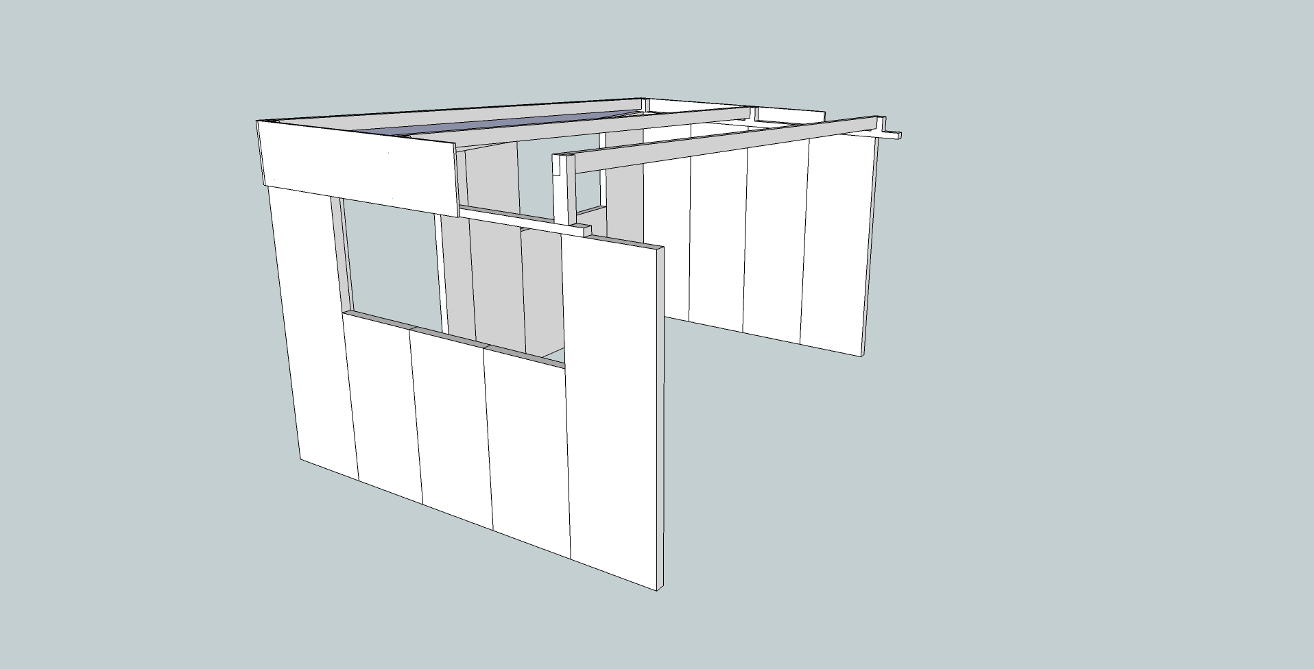

Well after a long chat with one of the suppliers about how these are constructed and being advised that "it's not rocket science and you'll save about £2,500 doing it yourself", I've being playing with Sketchup, as you do lol....
This is based on the 6'6" panels so there's a few lumps of wood to provide a wall bar and purlins with OSB cladding. Might put some T&G over the cladding to prettify it so SWMBO doesnt get too upset... she wasn't too impressed with the idea of concrete though what she thought it was going to look like I still have no idea...

Irving, what do you propose for the roof.
I for one would go for the plastic coated steel sheeting as its really upto the job.
Used it last year when I enlarged my concrete garage by 4' 2" wide and 1' in length and still couldnt get the car in it!!
Peter
Roof will be Plastisol coated steel box-corrugated sheet over 18mm treated osb on top of the purlins, 100mm poly insulation between them, and 18mm OSB inside... all sealed with expanding foam... snug and dry :) All sourced off eBay very cheaply :) Whole 6m x 4.2m approx roof will cost about £400
