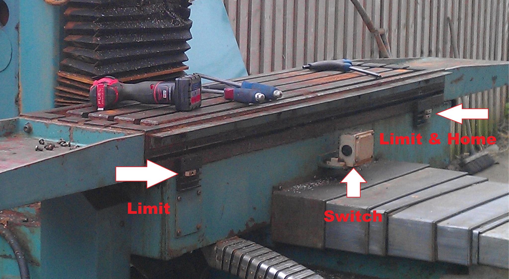

Changing the subject a little, I read somewhere else in this forum that Dean's sensors are floating - that way it minimises cable runs.I didn't quite know what he means by floating and I'd like to know, maybe from the man himself, if he's reading, please.
I just saw a video by him talking about the repeatability of the cheapo proximity sensors and I think the trigger was the metal of the ballnut flange, or in any case, something that moved past the sensor to trigger it- sideways, rather than front on. So there was no possibility of trigger and sensor crashing into each other. I quite like this and maybe it's common practice to do it this way, although I have seen videos where the machine would crash into the sensor if it overrran a little.
Mind you, if the machine overruns, a crashed sensor is probably the least of the problems:)
Edward
He means that he (and I) have one home (or/and) switch for each axis and it travels on the axis with two triggers each end for it to see. Less wiring....
Thank you, Neil, I'm with you. Though in my head I am initially thinking that it may not be so easy to implement on a vertical mill, say, the X axis, sensor somewhere in the middle, hitting targets at either extreme...
I can see the opposite working, i.e. sensor stationary in the middle and triggers at the extreme ends moving.

Neil answered for me but no difference if sensor moves or Target moves. Infact it's common on mills for the Switch to be stationery and the targets or Ramps if mechaincal type Switch to move with table or saddle. See pic.
Attachment 20385

Thank you, Dean. The picture says it all. Not only do you save on wiring, but you save on sensors too! I think I will implement something like this.
