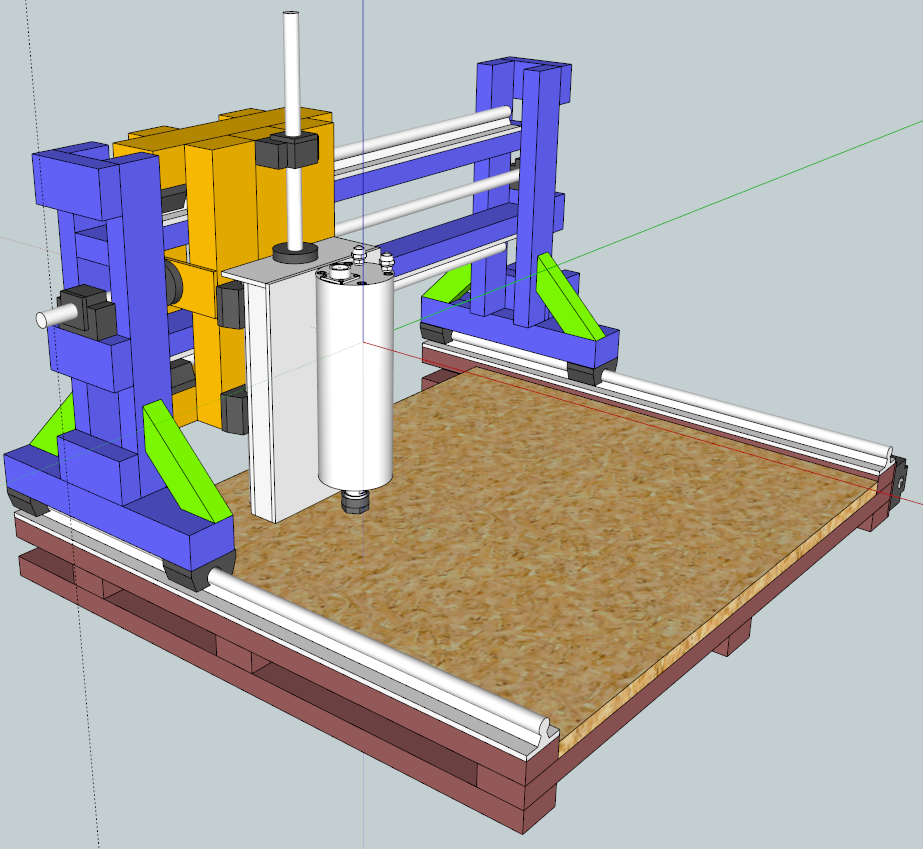

anyone willing to look this over and let me know if anything is drasticaly wrong?
total width of machine is 800mm so i'm wondering what the chances are of using a single screw??
and also is there any advice on what size motors to use on each axis? as everything is steel am i best just going for 3nm on all??

It's hard to give a definitive answer as it depends on so many factors, what you need to cut and how often, how fast, required accuracy, personal preference... etc
It's borderline, you'd probably get away with one screw as the distance between the bearing blocks is fairly small, but if you're going to be cutting metals at all regularly or just generally want to be able to cut at a good material removal rate accurately then get two ball-screws. You certainly wont regret it.

I forgot to answer the motor question...
You could use less than 3Nm motors in places without reducing the performance, but 3Nm motors are by far the best price per Nm so it's hardly worth getting anything smaller, especially since the 3Nm motors would be good for the 4'x4' machine if you decide to make it. Currently the cheapest place I know of to get them is here:
Nema23 3.1Nm
Remember to ask Chai to make the end portion of the screw longer (25mm is good) to make it easier to fit and align the pulleys. This will of course mean adding a little to the length of the screws you buy.
The gantry is currently quite tall so it look like it could bend 'backwards' (parallel to X) relatively easily. It would be a good idea to add in some diagonal pieces as you said to combat that.

hmm been doing some thinking tonight dangerous i know..
looking at the size of the moving parts it now feels when i look at it that everything i've designed i should have a bigger work space.. what i mean is the foot print of the machine is 792 x 700 and yet this produces a cutting area of 385x385 and i'm starting to wonder should i bump up the length of the rails and screws to gain some cutting area... the only down side in this is extra cost which i might be able to come to terms with.
i suppose the biggest decider is at what point do i need to move away from 16mm screws and rails as this will be the limits of the machine for me
Attachment 7328

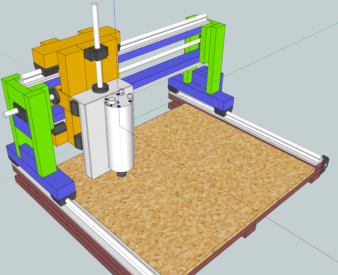

i've also added in the green bits for stability... with the above thoughts i'm also thinking of changing the 50 x 25 that supports the y rails to something wide enough so that the whole yellow section can slot in to the blue as at the moment it feels like wasted space that could be better used to shorten the ballscrew and the steel
Re: My baby 15" x 15" machine
infact just a quick look at getting the yellow section to tuck in to the blue i could gain 100mm workable width for the same size screw in just 100mm longer rails so i'm going to consider a slight redesign to make this happen
Edit: i've done it so it's the above with 100mm shorter rails or this one below with 100mm longer rails screw is the same length

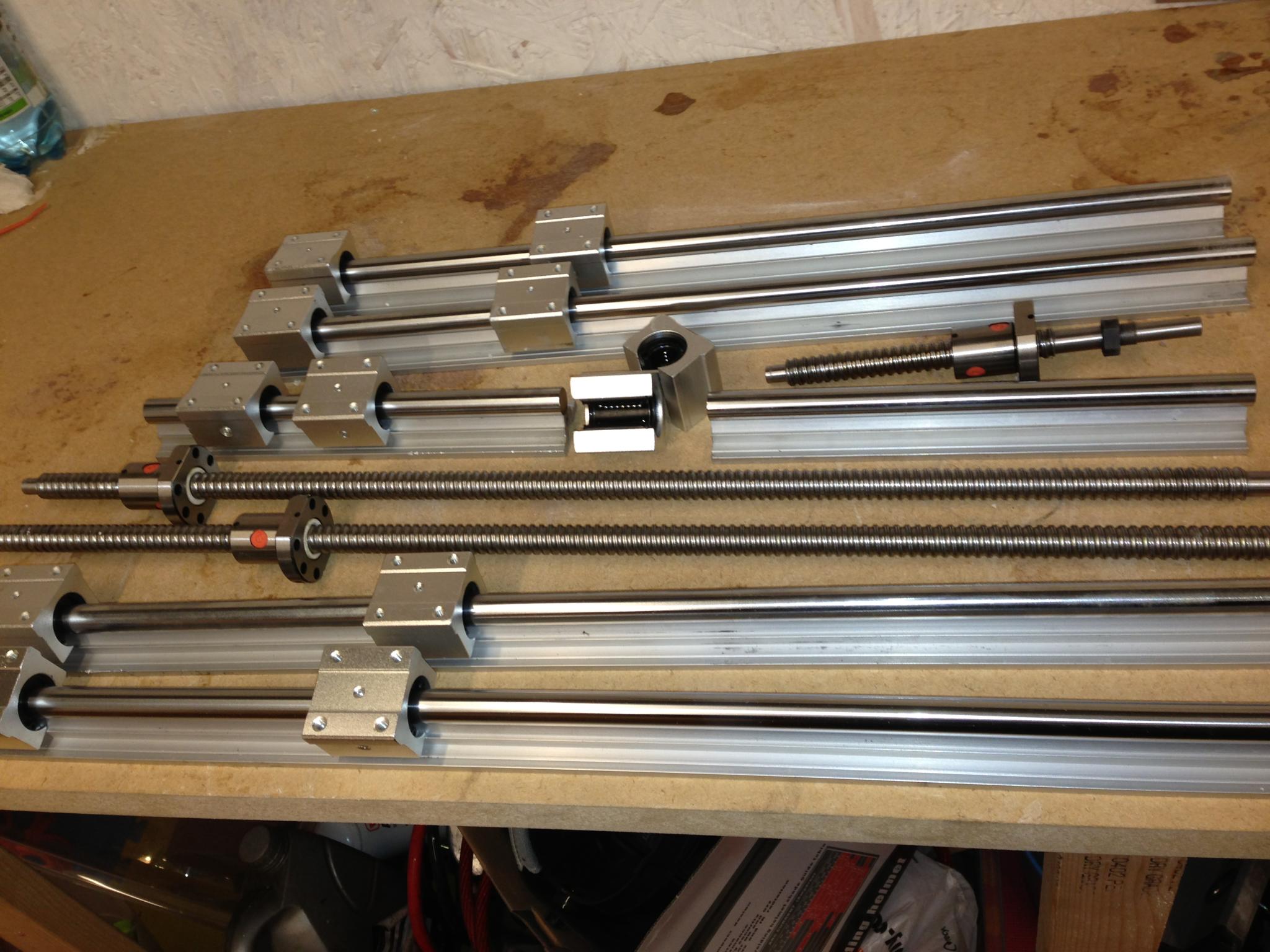

christmas come early for me today... too bloody early infact i didnt expect this lot to turn up till after crimbo.
Attachment 7581
is it normal for stuff from chai.. or infact anyone in china to come in 2 deliveries? i'm missing the bk/bf blocks and also the spindle and vfd.
also i've noticed a stupidly huge cock up today whilst re-looking over my design, i've really done myself short on the rails for the x axis, looking at the size of the screw i've drawn and ordered i could have got at least another 100mm out of it.
i'm now tempted to re-order my x rails as thats the only thing i'd need and gain the extra length

it certainly says 1 of 2 on the package i have, but i too thought the bf/bk's would have come with the rails.. i was tempted to wait and see if the other package comes 2moro.
So what have you signed for.? The package may say 1 of 2 but did you sign for 2 packages.?
I'd still email Chai asking has it won't hurt and is unusual in my experience for the blocks not to be with the screws Etc.!!
i didnt sign for it my missus did, i didnt even know it was coming, it's only been 10 days since i ordered it
I've bought stuff from China and there ahave arrived from 3 diffirent places on the same order, sometimes stuff is either wharehoused or built in different factories,, hopefully its wasnt those tards UPS .. they suck big style !
it was fedex that delivered it thats all i know, i've emailed chai see what he says.. have to say though 1st dec i paid which was a weekend.. and the rails and screws are here on the 10th.. thats some turn around if you think about the shipping involved
I,ve had stuff in 7 days and been ordered on a weekend and 9-12 days is quite normal for Chai.. . . No matter how large or small the order.!! That's why I don't mess around trying to save £10 or £20 buying else where.
