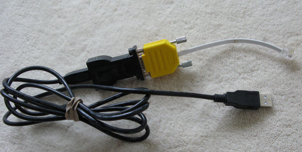

I have 'the cable' (DB9 to Rj12), also a USB to RS232 cable with seperate driver (CH41?) and so far 4 different PC's trying to get stable comms to the 882.
I ditched the USB to RS232 lead completely and cut off the DB9 connector from 'the cable' checking in the pinouts from RJ12 connector (using the data sheet from the Leadshine site) so as to re attach it from new, I didnt find any misaligned pins in the DB9. I've used 4 PC's to connect and generally I'm not getting anywhere.

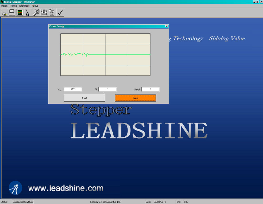

This is my cable, it's a USB to serial converter then a short length of cable cut from an old phone with the correct plug already fitted.
I used default settings for everything else.
Pinout details for cable http://www.leadshine.com/UploadFile/...munication.pdf
Attachment 12133

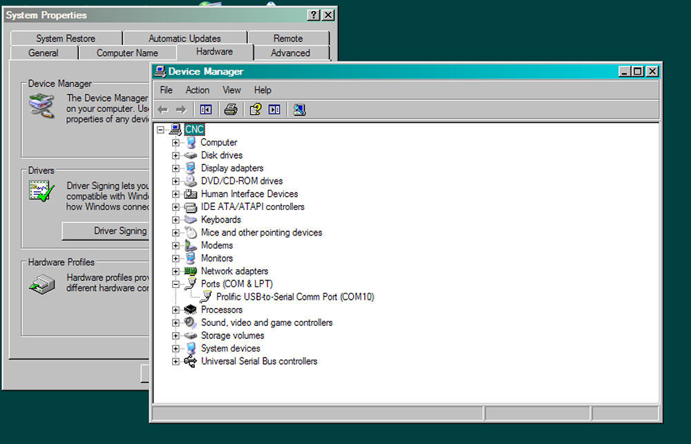

If you plug it all in then on your PC go to, Settings - System - Device Manager, you will see if it's connected and which COM port number it has. In my case it's showing the USB to serial converter on COM10
Attachment 12134
As you can see I get an error when trying to read from the drive, this has always been the case with my system ( Windows XP ) and I've never followed it up, but I might now.
Attachment 12135Attachment 12136Attachment 12137Attachment 12138

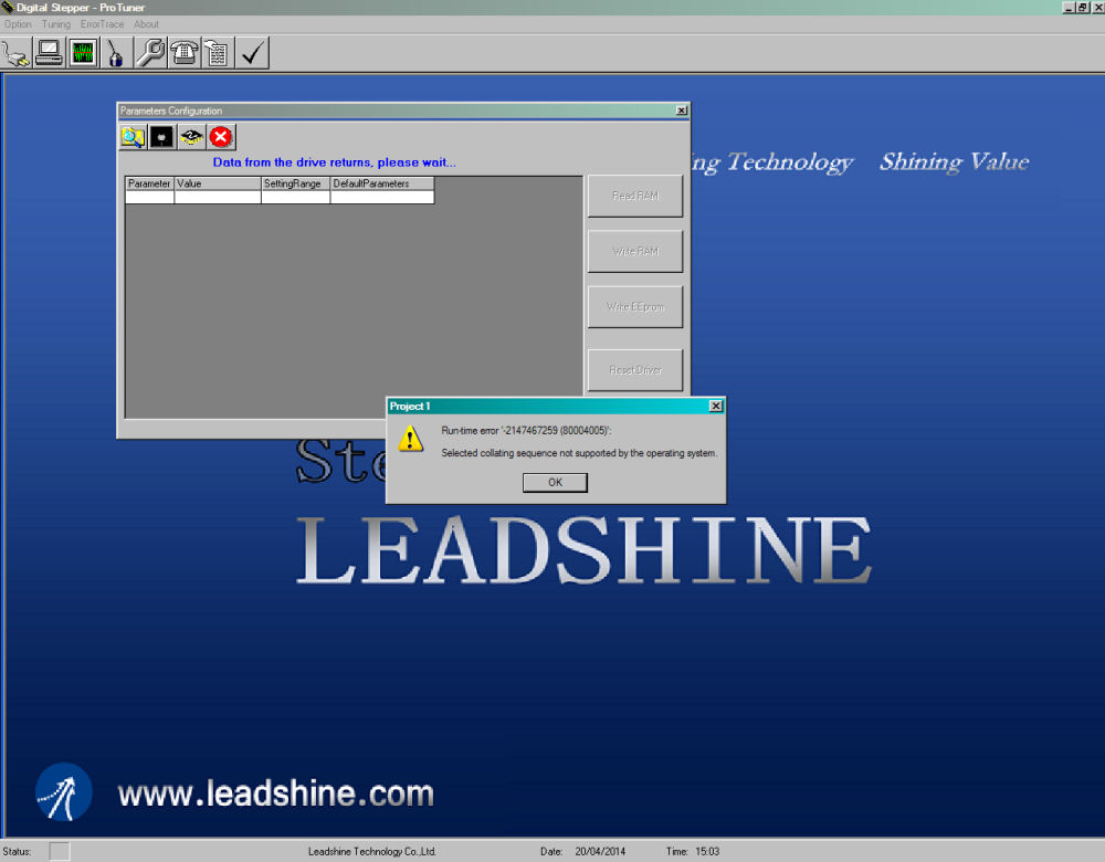

Eddy, I've been playing with Protune on my XP machine today. I kept getting the error that you show. After a bit of research it turns out that it is due to the file stored in RAM on the drive being generated in a different language (probably from a Chinese machine).
If you go to Control Panel - Regional and Language Options then click the Languages tab and tick 'Install files for East Asian Languages', once it is applied you won't get the error message anymore.

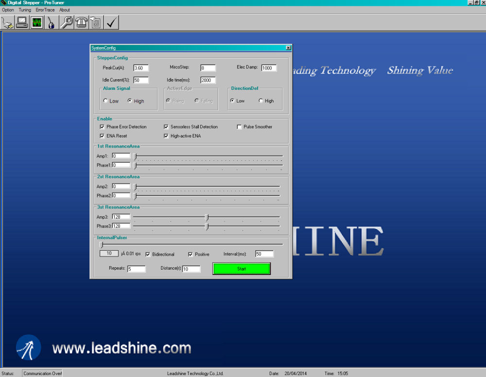

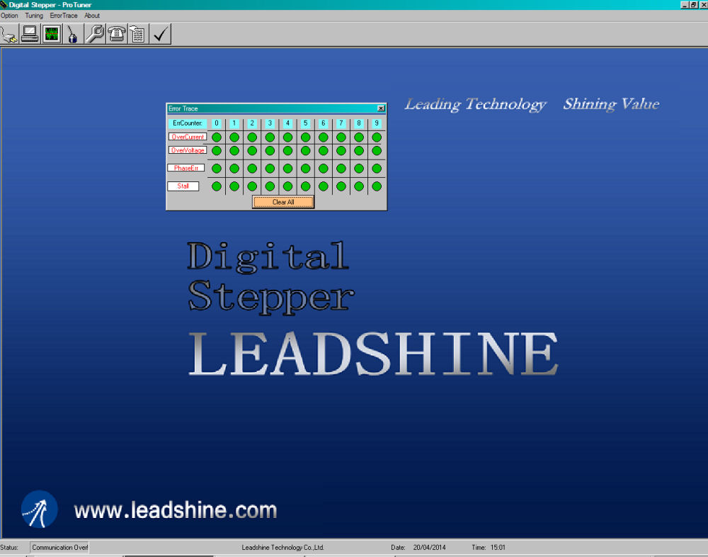

4 Attachment(s)
Re: ProTune hates me. What on earth am I doing wrong?
Here is an example of what I am seeing. The four error screens should be read right to left.
1.Start ProTune, Select Com1 all ok so far.
2.Select 2nd icon from left, Read/Write drive parameter. OK So far.
3.Immediately I get error message 1, please check if the communication cable or drive is OK.
4.I click OK and I get the message Read finish successfully.
5.I see Screen 2. The parameters Configuration screen.
6.I leave this open or closed, dosent matter, I want to do something interesting and Select 4th icon from left, System Config.
7.Immediately I see Com Error! message, Please check connection and restart!
8.I click OK and immediately I see screen 3, the SystemConfig screen, clicking Start does nothing.I cant close this screen top right.
9.So I decide to close the whole application, restart and go straight to System Config, I see error message 4, Com Error, Fail in reveiving monitor data.
Thats about it, I have to click OK 4-5 times to close the dialogue and the protune app essentially does nothing for me.

I'm still not convinved I have the cable wired correctly, can anyone confirm the pinouts above please? They are as per the leashine data sheet but I just want to be sure.
Tony, it looks like a problem with the cable to me. I bought mine from Gary @ Zapp so i'm not sure of the wiring. There is a little thread on Zapp's forum which talks about the cables : Zapp Automation Ltd

It was the Cable! Thanks all for the advice and support. :)
