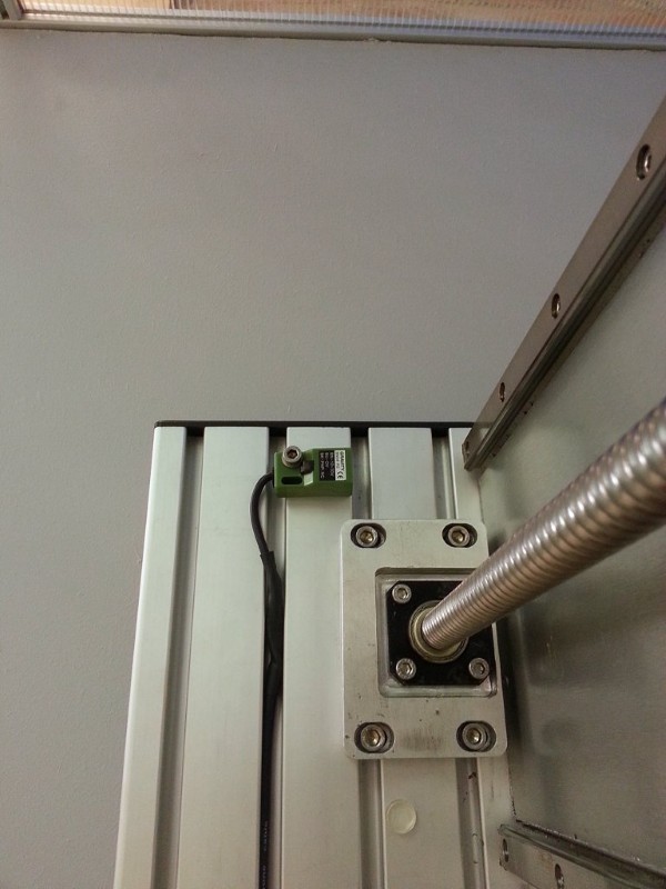

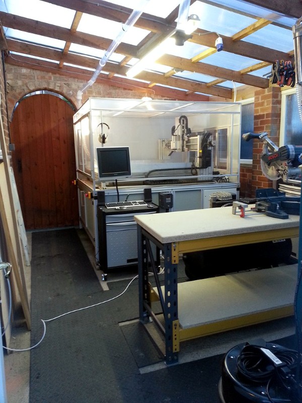

Now there's some hours on the machine and things are bedding in I decided to spend the day stripping down and removing all the ballscrews and nuts carefully putting them back together getting everything tight and aligned as possible. There's virtually no bind anywhere now and it shows in the speeds and acceleration it can achieve. Those Leadshine AM882 are awesome! I could have gone past 16.5m/min but Mach was limited by my max 45k PP speed so I went and whacked the acceleration all the way up to 4000mm/sec^2 instead lol
Ps. Don't run at these speeds or accel as its overkill but its nice to see the effort from careful setup confirmed with a speed increase. I run at 10m rapids and 5m on the Z. That's more than enough for me but its nice to know there's lots of head room there.

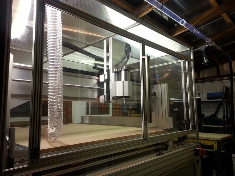

Had another go at making a dust shoe and after picking up some cast acrylic this attempt came out much better. A week or so ago I did try to cut the same parts out of extruded acrylic and that stuff melted no matter what I did. Lesson learned - go with cast if the finish quality matters.
Thanks to M.Marino for the advice on feeds and speeds. 3.5m/min with 3mm DOC and 14000rpm worked a treat.
Looks good :) I've been struggling to get a good finish on cut acrylic for a little while and although I'm doing pretty well with it now I wonder if I also have extruded sheet. I'll have to check!
What vacuum do you have? I made my dust shoe suck up directly around the spindle rather than just to one side. It works nicely no matter what direction I'm cutting, but I do wish I could get a stronger suck!

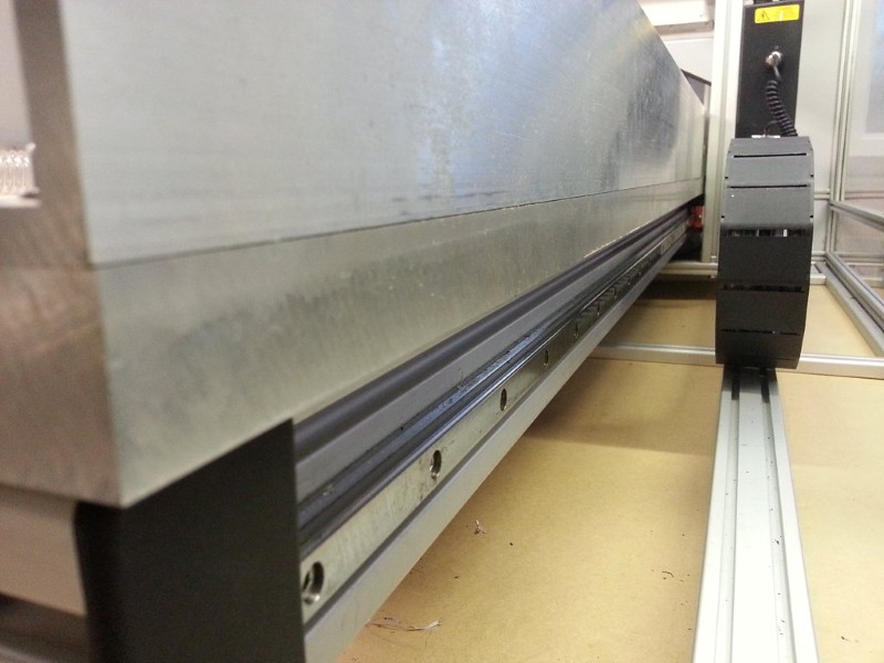

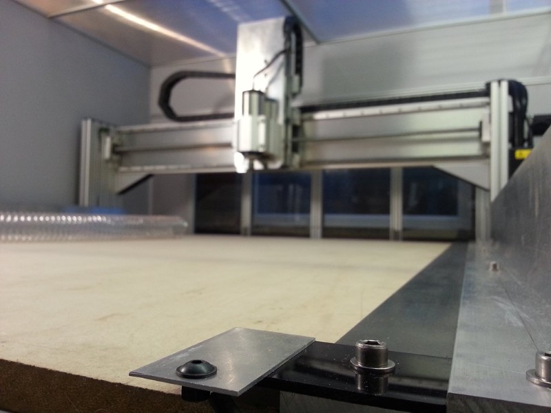

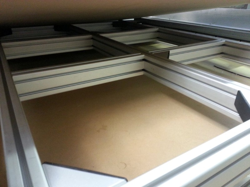

Not normally worth posting about replacing the bed but I picked up a sheet of Trespa Athlon from a friend and have to say this is makes a great bed. Plenty of mass, well damped against vibration, dimensionally stable, tough and still easy to drill and set up fixtures. The construction is a fibre reinforced resin with a laminated finish. I've had a quick go with an offcut made when sizing the sheet to fit the bed and it machines really nicely.
I got this sheet for nothing and I'm not sure on pricing but Performance Panels : Home stock it.

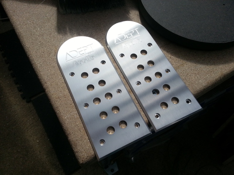

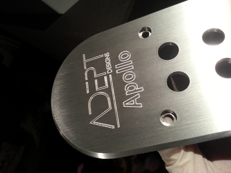

OK here we have my first go at cutting aluminium. I had so much fun with these. Wood seems boring in comparison and you've got to be so much more mindful with how you go about cutting it. Oh and the engraving was an absolute frigtastic nightmare as well. Broke 3 cutters before I finally hit the g spot. Admittedly the cutters are uber fragile since they're pretty much needles sticking out of a 3hp spindle spinning them round at 24000 rpm. Even getting it slightly wrong would break them. There's a strong chance I'll end up getting a laser cutter/engraver at some point because its a painfully slow this way. Looks cool though and that's what counts.
I finished them up with fine brushed effect and then sealed with a couple of coats of clear because without either that, etching or anodising then natural aluminium is a finger print magnet.
As an experiment I'm going to have a go at filling the text with black spray on the One.10 plates. Once the excess paint is sanded back to the aluminium leaving only the lettering black it should look alternatively awesome. I choose not to do it for the Apollo as I really like the way they're looking straight out.

Bloody hell so posh now you got to ware gloves hey? Nice job :beer:
Try drag engraving, next to impossible to break a cutter.
http://www.stevenson-engineers.co.uk...engraving1.jpg
Circle is 50mm diameter, small letters near the bottom are 1/2 a mm
Laser will only engrave alloy if it's been anodised and the letters are always white, so just using anodised alloy looks a bit like an Italian flag, white cross on white background.
You need a colour that compliments it like red, blue or black.
http://www.stevenson-engineers.co.uk...ed%20plate.jpg
If you want it the opposite way, black letters on alloy then you need a product called Thermark which is a ceramic slurry made from 3rd dynasty Chinese Ming vases as it's £100 an aerosol [ no typo ] but does last a long while
Because you never asked dickhead.
I've had success with plaster of paris. Same effect and cost me nothing because I robbed it off the kids :)
Sorry, was referring to laser engraving :P
Wow, they look stunning, excellent work. How did you do the brushed effect? Can't wait to see the Apollo's completed.
