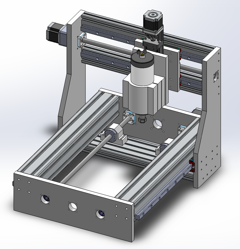

Just my 2p worth... I'd say you have a lot of designing still to do. My guess is that you will replace some of that extrusion with plate and you'll probably add more (machined) plate into the design. Any guess at a machining cost at this stage would be unrealistic I think. You might also like to consider whether your design will require machining on both sides of any plate as that will increase the cost due to the set up time needed to machine one side, flip the plate and align it accurately for machining on the other side. If you have a look at my design I've specifically made it so that it can all be machined from one side with the exception of some counterbores that I'll do myself. Lets put it this way, I spent a lot more on parts than I did / will on machining costs.

Attachment 12733
Now I've mounted the FF blocks on the outside of the plates I don't think I'll get an off-the-shelf motor mount which will fit over them? So I might need to use pulleys?
Pulleys are the way forward, they give you flexibility in the final machine and generally make the design simpler. It's slightly more expensive to use pulleys rather than a direct connection and there are more moving parts which means more points of failure but I think that's a small price to pay.
One thing I would say about your design is start pricing it up. I'm guessing those corner connection blocks are the 90x90 ones - they are quite expensive if you need a load of them and they don't result in a machine that is all that stiff (they are great for display stands, not so great for machines). Once you start getting into the nitty gritty of placing components and pricing up I think you'll begin to consider using aluminium plate and box section more.

You are very right. I have been keeping an eye on the cost and realising that it soon adds up. The reasons why I am not leaning towards a steel box section frame; the first is I don't have a MIG welder! The second is that even if I could justify purchasing one then I cannot see how people manage to weld everything so that it is all square and flat? In my mind that would be quite a hard thing to achieve?
I was meaning aluminium box section, you can get some really large sizes if you shop around. It's more expensive than a frame made from steel box sections but it's easy to work with and the supplier will cut it to length normally (I used aluminium warehouse iirc).
My first CNC design included a steel frame and I actually rushed out and bought a halfway decent MIG welder. I never actually built the frame in the end though, doh! Anyway, you don't need a fancy MIG to weld the steel frame together - a cheap and nasty stick welder from ebay will do the job, there's one up for £26 at the moment. The trouble with MIG is unless you go for one with some grunt it won't handle the 4mm thick box you'd want to build the frame from. As for keeping it square and level if you look around you'd be amazed what can be done with epoxy resin. Basically you weld up the frame as square as you can (lots of small welds + clamps) and then pour very thin epoxy over where you'll mount the x-axis rails. The epoxy will self level and should leave you with two sides that are in exactly the same plane. Check out this thread as Neil will be doing another epoxy pour any time soon (actually the technique in the first pour was fine he just fluffed the mixture).
Dave don't be fooled into thinking profile is flat or level because it often isn't and to make this worse your design makes it so your pretty much guaranteed you'll have issues with the rails binding.? . . .Your relying completely on the quality of cut on those uprights to keep the rails aligned and 90deg to the base. The 90Deg brackets are not accurate enough or strong enough to hold everything square. The fact your using 45x90 orientated in it's narrow section when the Y axis forces will be trying to rock the profile doesn't help and this is compounded by the fact the 90deg brackets don't hold it in that direction either.
Sorry to say this but while you think the frame is strong it's actually weaker than you think because it's not braced or held the directions that matter and your under sizing the profile. To make profile work for this design you'll need 90x90 for all the base and much more bracing in correct locations using plates not those poxy 90deg brackets.
For this reason Steel is much cheaper, stronger and more accurate if used with the epoxy method.

I don't want to go OTT with the design but obviously it needs to be useful. What are you opinions on the gantry design as it stands so far? Are there any other alternatives to a steel box section base?

Dave don't get me wrong I'm not saying profile won't work because it works great and I use it all the time but it does need to be supported and braced correctly and by this I mean not using in the normal manner profile is used IE: using corner brackets etc. I'm also not saying your design is flimsy or weak just not has strong as you may be thinking. It will certainly have some chatter in harder materials as the frame vibrates.
For this high side design to work best with profile, esp when on it's thin edge you need to brace the hell out of it using plates.
Your gantry is ok-ish but I would have a bit more strength in the bottom profile as this takes the most the cutting forces. To be honest I'd have the L shape layout of the profile at the bottom but with lower profile laid flat.

Yes, still a bit of work to do on the gantry (motor mounting etc). The profile is 80x40. If I can mount the motor on the outside of the gantry end plates then I was going to put another piece of horizontal profile in to enclose the back completely.

Dave,
See screen shot, i had 5 mins spare. The red and green sections would fix to your side plates and then to each other, the profile is 80x80, the plate is 20mm, note the datum for the rails on the front plate.

How did you manage to edit that, Lee? Thank you! My only concern with that design is that I thought the rails were better off not being on there side?
Hi mate, I pulled your image into the software I use for Web Dev then did some cut and paste magic with what was already there :).
For these rails it's not as important, open round type bearings, then yes that would be correct. You could still mount them at the top and bottom, the choice is yours really but the objective is to get and keep the bearing units as close to the cutter as you can, that being said the the difference here would probably be negligible. I did a few version's of the mock up and one had the rails as suggested, if you prefer that design add plates to the top and bottom, as well as the back, I forgot to say that the back plate didn't need to be 20 mil though, also going with the top/bottom arrangement also means that the spindle plate/assembly stands further away from the bearings due to the lead screw interference with the ali profile.
Dave slapped this together for you quickly so you can see approximately what you may end up with, without needing to get down and dirty in CAD.
Nothing is to scale obviously as it is just a drawing, note the X Axis screw mount position and that it would probably need moving back (away from spindle) to allow for clearance of the nut and mount (at the spindle plate), side plates would need to be bigger and other plates also bigger, bigger side plates are not a bad thing outside of additional cost because you really don’t want to go any less then 2-250mm centres for your rail bearings, both designs pretty much force you in that direction anyway so I didn’t mention it before but I thought that was a little bit ignorant of me, so here it is.
You could close things up with datum’s and pockets for the rails and bearings and so on, keep an eye on the proportions as well, if you look at the original image I’m working from, the gantry looks small next to the spindle, if something looks small, it probably is...resize to match the proportions if you can.
Also, others will probably say it’s not as important as getting other things right, and they are right but try and keep everything lined up and parallel, so your rails, lead screw and nuts. On the Y Axis (bed) the nut could be moved back towards the spindle in my previous image, vertically aligning it with the rails and lead screw, the middle of that plate “looks” nice but would it be better for the loads, if they are all inline?, they all come together to work as one.

No need for that box design around gantry it add's very little but expense and more potential for binding. Also with this design the ballnut won't fit between the Z axis backplate and gantry. Those wide top n bottom plates with rails sat back just make long levers acting upon the bearings which will could cause binding.!! . . . . Not a design I'd go for.!
Your design in post #67 will be ok. Don't waste money or time on the box around gantry setup no point or bennifit IMO unless bracing sides.!
The significant advantage from putting the rails one the top and front of the top and bottom beams respectively (as Jazz suggested earlier), is that you can make the rails a bit longer and thus increase the spacing of the bearing blocks a bit without widening the machine or loosing travel. I'd certainly recommend that since the stiffness due to the bearings is proportional to the bearing spacing squared (assuming what they're mounted to is rigid etc), so every little helps.
Not much progress but changed the "L" shape on the gantry as JAZZ suggested. I'm now using 2 pieces of 80x120 and 2 pieces of 40x40 (mainly for filling the gap). This used to be 60x30 but thought I better bulk it up. Also the height (total height 350mm) and width (now 175mm) of the gantry side plates has increased a little to accommodate. Still undecided with what to do at the back of the gantry... I need to leave enough room to mount the motor on the inside (using pulleys).
Attachment 12764
Ahhhh! really not sure which direction to go with the gantry design. It just does't look right now. Maybe I should mount the motor on the outside of the plate and the fixed (FK12) ballscrew mount on the inside of the gantry plate? (I.e. direct connection, no pulley).

Here are some options for the gantry..really don't know which route to go down now...Option A would allow an internally mounted motor (without increasing the side plate width). However I am also leaning towards option B. No matter which option I go with I still need to do something about the big gap where swarf could get to the ballscrew.
Attachment 12769
Option A isn't going to be very strong, it has almost no vertical bracing. Essentially all the stiffness would come from the bolts through the side plates into the profile.
Option B is ok but Option C is going to be a bit stronger. If you want the space internally to mount the stepper then you could go with option A but put a 10 or 15mm plate across the back (I assume the sloped side is the front). You should really have a look through some of Jazz's threads if you want to see a good design that keeps everything internal, the design I'm thinking of has a 20mm plate a the front of the gantry with a slot machined out of it for the screw connection. It served as inspiration for my design.
If you want to do a quick experiment get a couple of lengths of 2x4 timber and nail them to some ply in roughly the design of option A, it'll take 5 minutes to build and you'll immediately see why it won't work as a gantry as it'll wobble around like a jelly. Grab yourself a bit of hardboard and nail it across the back, you could probably stand on it them.
If you want a simple design that works is strong and neat then try this setup. This machine design with higher sides is just for cutting woods and soft materials but you can use the same "L" arrangement without the high sides. Before anyone says it the ballscrew at the rear makes no noticable difference to cutting and the advantages of keeping chips away from screw are clear to see has is the neatness.
If you want stronger than this then look at the All aluminium gantry but it's much more expensive, thou it is very strong and again neat with good protection to components.
Thanks Jazz! I had thought of something similar but was afraid monting the ballscrew like that would cause problems. Is the general idea of the gantry sides to keep them as short as possible? Well not the sides, but the distance between the top and bottom profile carriages on the X axis?
