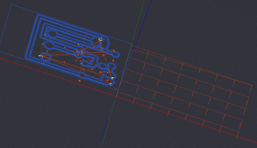

OK so I have done a bit of testing and fixing.
First of all I opened the levelled file in cambam. This is what I got:
Attachment 9140
The red lines are the probing routine. The probe points need to cover the design for levelling to take place. So, in the image, the design is on the negative side of X, whereas the probes are on the positive side. The probe values should be something like:
X = -37
Y = 0
X length = 37
Y length = 20
Then the probes should cover the design. As I said, this is done automatically in the new version so you dont need to worry about the probe settings.
However... This will not fix the divide by zero error because version 0.5 seems to struggle with negative coordinates. I have generated and attached the levelled file generated with version 0.7 (not yet released) if you want to try it.

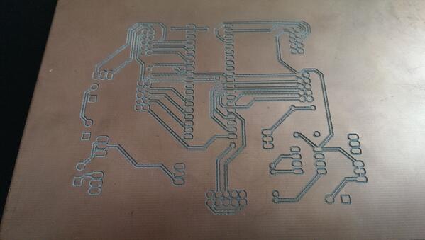

Sorry I haven't been on here for a while, been a tad busy of late.
The latest version of AutoLeveller is 0.8.2 and as of 0.8 you can log your probe points to a file then feed that log file back into AutoLeveller to perform calculations within the software itself rather than in the GCode file. This means you only have to do a full probe one time and if your tool bit breaks for example you can just replace the tool, reset your Z and resume etching where you left off.
Here is an image of a board made using this technique with 0.8...
Attachment 12593
0.8.2 fully supports LinuxCNC, Mach3 and TurboCNC
