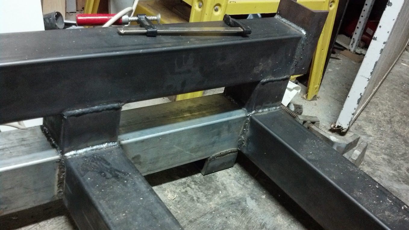

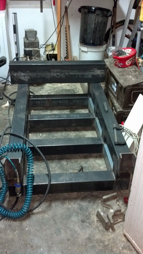

The frame looks good.
The welds look fine considering you've not ground the mill scale of before hand. Although MIG welding will burn through the scale, it can lead to weld contamination as standard MIG welding can only burn of a limited amount of contamination.
2 Attachment(s)
Re: Sturdy and Fast all Steel CNC , my first build
m_c

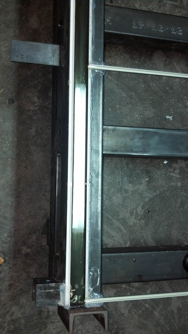

Thanks for the heads up. next time will not only grind 1mm the corners but as you say.

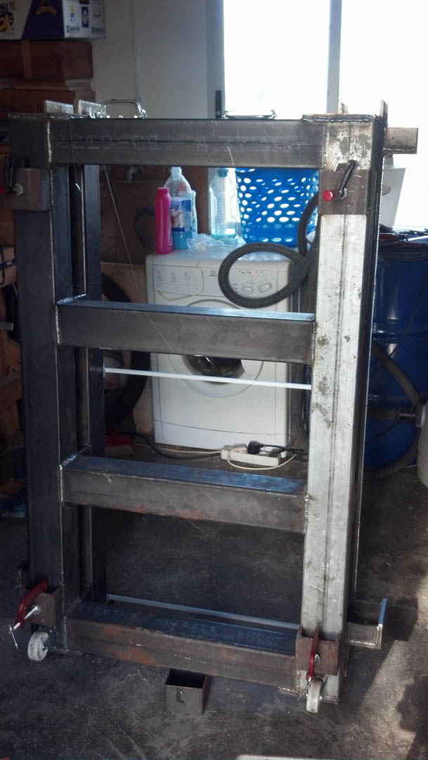

Here are 2 recent pictures. Just soldered the hardstops for the gantry from 100 UPN profile. My friend insisted on soldering 4 short legs, again from UPN100 profile. Strengthwise i would have soldered 6 legs instead of 4, or none at all and lay the machine and thin layer cement the machine on place but i was very curious of the deflection of my design.
Now just measured it so here is the result:
1. Applying 100kg static force/me/ on any one of the bead beams leads to 0.045 mm deflection in the middle
2. Applying the same 100kg to middle of the raised sides supported only at both sides by 9 cm legs from 100UPN profile leads to 0.03mm deflection on that side.
Conclusion: With gantry and bead mounted in real working conditions the overall vertical deflection of the machine will be unmeasurable or less than 0.01mm which is irrelevant especially with 0.8kw spindle. So first impressions are perfect.
Anyways, i will most possibly insert pads in the middle of the machine when placing it on its place, so it will stay rigid and quiet
PS. In fact using the excel file for calculating deflection on gantry and gantry side, i guess the real final value of deflection in all directions of this particular design of the finished machine will be 0.0035mm. Which i believe is great.
Attachment 10414Attachment 10415
silyavski
Your test shows that the deflection due to the frame will be very small (<0.01mm), but remember the linear guides and Z-axis especially will all lower the stiffness, so overall your deflection will be greater. Still, your gantry design looks reasonably strong so I expect it will be fine.
Jonathan
Thanks. I am aware of that. For me this build is a preliminary build to my real machine. A kind of experiment. Something like how far i could go at every step.
As the machine we all know is a sum of its components.I constantly meditate on "the machine is strong as its weakest part". The Hiwin blocks are with A preload, the deflection calculator tells me the gantry sides deflection cutting aluminum will be lower than 0.01mm, so i guess the weakest part will be the Chinese spindle bearings and the bit. I will be extremely happy if i succeed in making a precise machine, just for the sake of it.

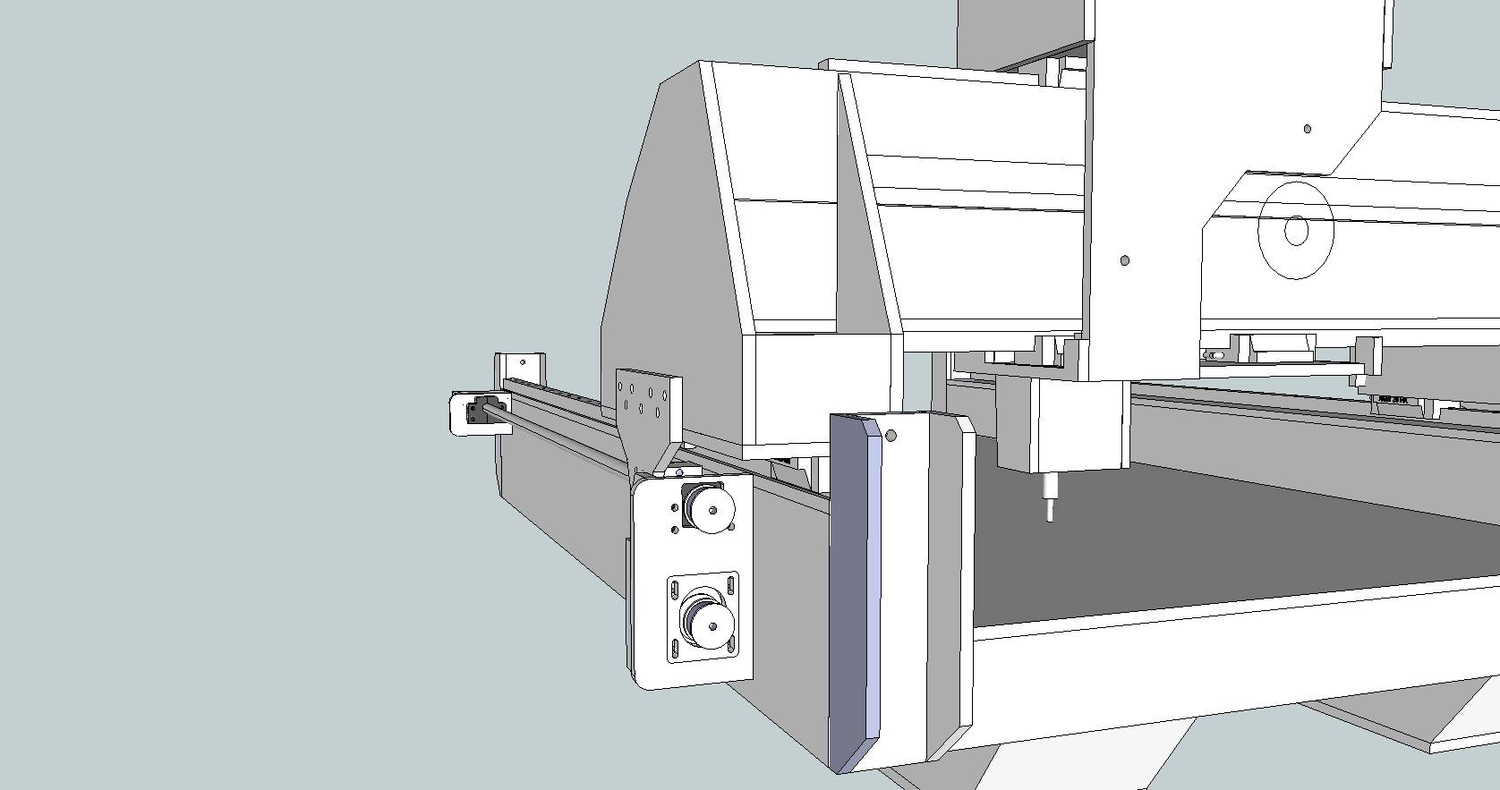

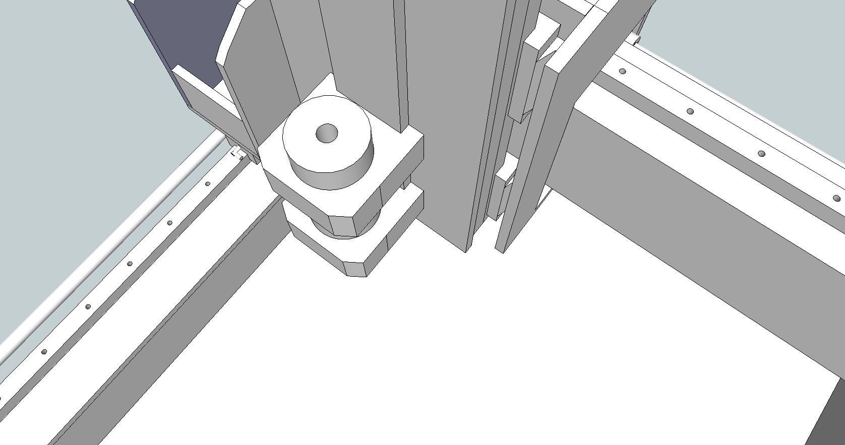

Hi guys,
thanks to all for the valuable inputs.
For now i have to wait until they cut with laser the pieces, so i can proceed further.

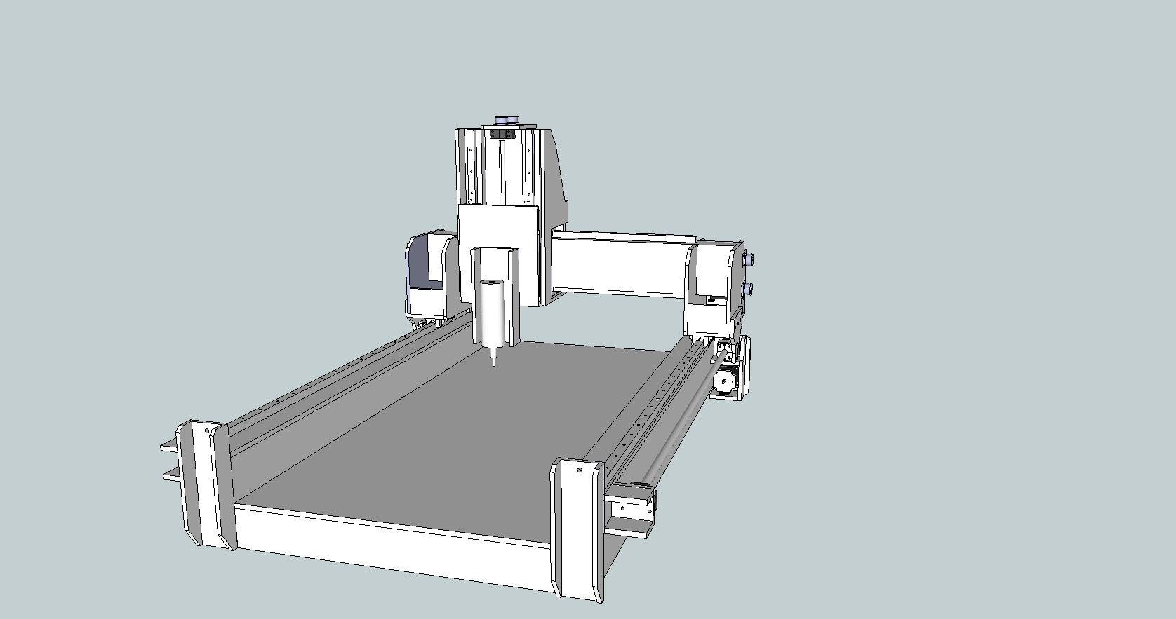

Meanwhile as a thanks to all for the help :encouragement:, here is the Sketchup file/its in winrar format for easier transfer/. So anyone who wants can use it as it is, use parts of it or just use the components or table drawings. Before ordering the laser cut parts i revised it piece by piece and against the ballscrews, housings, etc. So all small errors are fixed. It cost me a whole day to rework it precisely. The empty spaces are for epoxy, there are some clearances where necessary. The machine has work area of 400x1000x200 . Any questions are welcome if you have something that is not clear. The main point being here is that the machine is completely scaleable up to the limit of the ballscrews or with minor adjustments even up to 4x8 , this without changing the type or thickness of the profile. Other main point is that the drawing is final drawing, no need for correction before real assembly, however there are some steps to be followed, but easy to figure when playing and simulating the actual assembly. If by channce there is a small error i will fix it right away in the future.
Attachment 10608
So enjoy it and thanks again. Will update when i have more to show.

I dont understand something
The cncrouter will have legs down to ground or the cnc on the left of your scetchup will be put on the white table
Hi there,
The table on the right is if sb wants to upscale it to 1000x1500 or similar,with small adjustments, using the gantry from the left. On the left is the complete machine 400x1000 which i am building now.
Furthermore have in mind the gantry can be simplified removing the raise sides if intended mainly for aluminum.

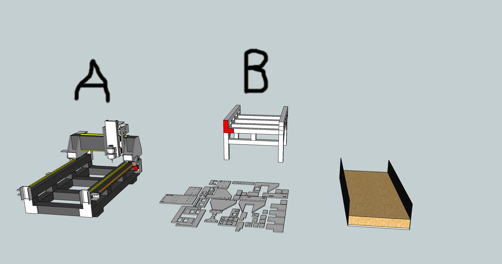

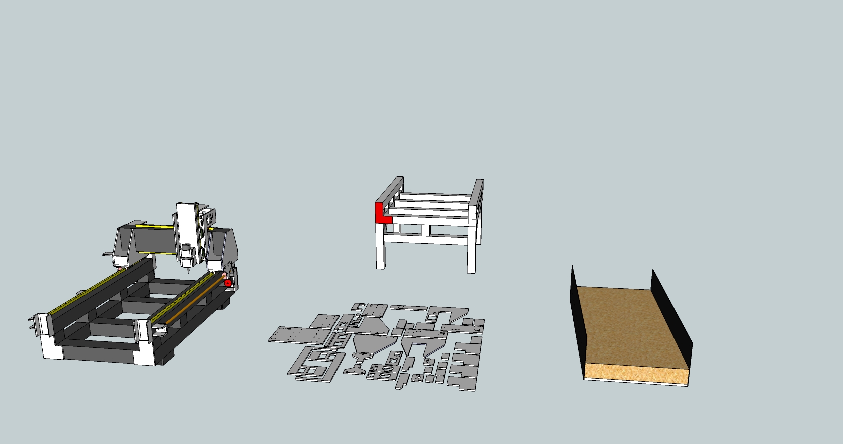

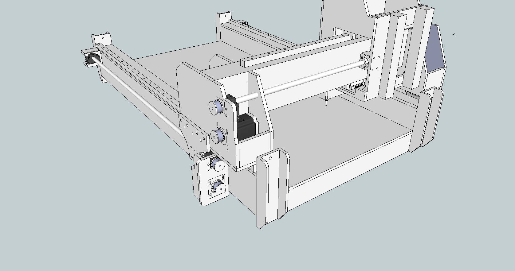

It is possible i didnt make my self clear beacause of my english
Syliavski i will use your photo to explain
When i say cnc i mean the element A of your picture
and when i say table i mean the element B of your picture and not the cutting table
So the question is
Will i have any stiffness issues if make two different construction A and B and then let A rest on B
Or i must make one construction both A and B together in order to have more stiffness.
The problem is that if i make one unique construction it will be too heavy
Thanks for your time
Attachment 10954
the element A is a benchtop cnc 400x1000x200. The element B is not a table. It is another CNC, 1000x1500x200. It is the same, just scale the gantry.
So A is strong enough even if you put it on a simple table/strong enough/ . There will be no compromise of stiffness. Same with B.
In other words just follow B design if you like it. It would weight 130kg if following the design. Look at this thread also: http://www.mycncuk.com/forums/router...ddy-cnc-2.html to see it in real life

Silyavski i know that element b is not only a table.
I just use it as an example of table in order to give you understand what i mean
So you tell me that if i make a benchtop cnc 1000X1500 and bolt it on a table ( whatever strong table that can handle such weight ) i wont have any problems right?
ba99297
Ok, I get it. If you use the same design and make a simple rectangular frame with the legs and diagonals on the legs, it would be rigid enough. If you use profile smaller than 80x80 you should use other design.

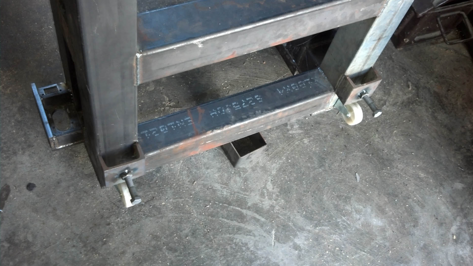

5 Attachment(s)

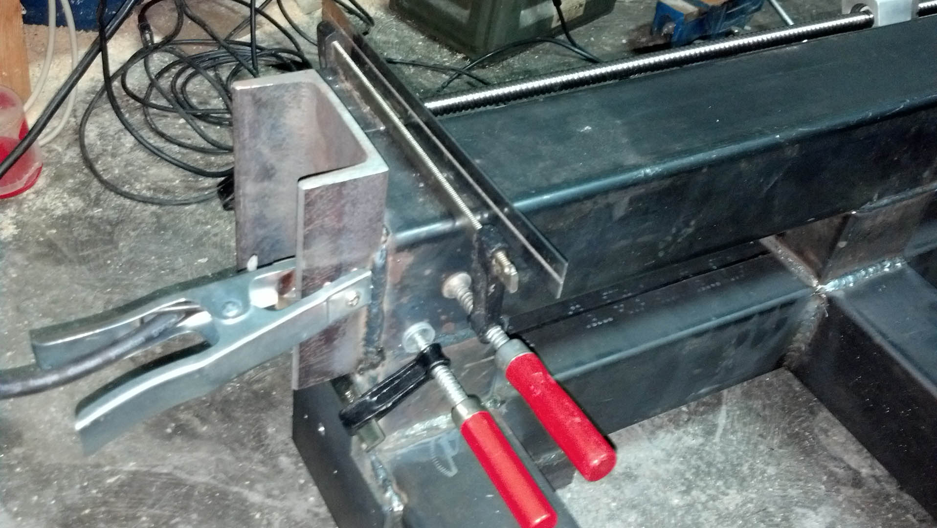

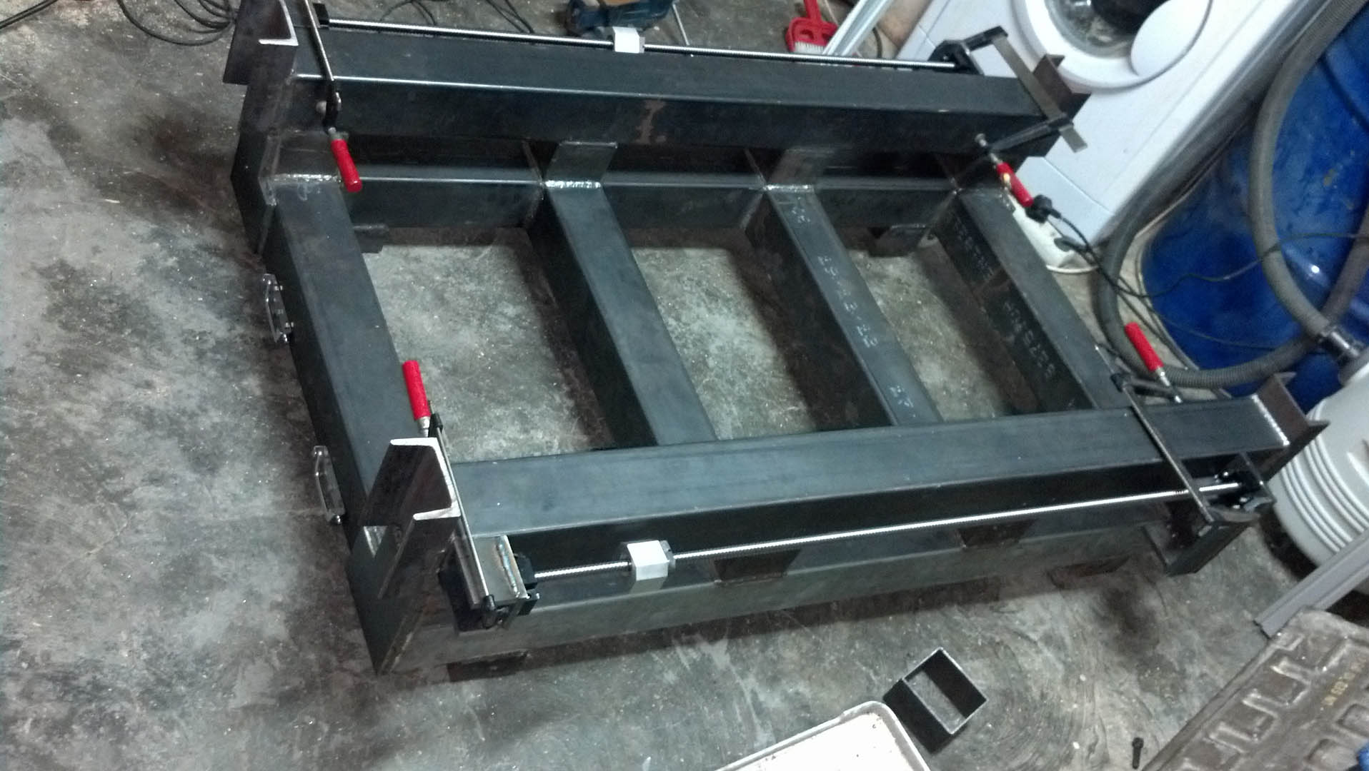

Well, the laser cut parts came. So, i finished soldering the parts to the frame. That includes the ball screw mounts. What i did was mount the ballscrews to the supports/in the middle so there is place left for adjustmennt/ and that greatly helped the correct placing. Carefully made some tacks with the Mig and waited all to cool, so checked again if the screws move smoothly. Have to note that the machine was welded with precision <1mm greatly helped.
Attachment 11369
Attachment 11370

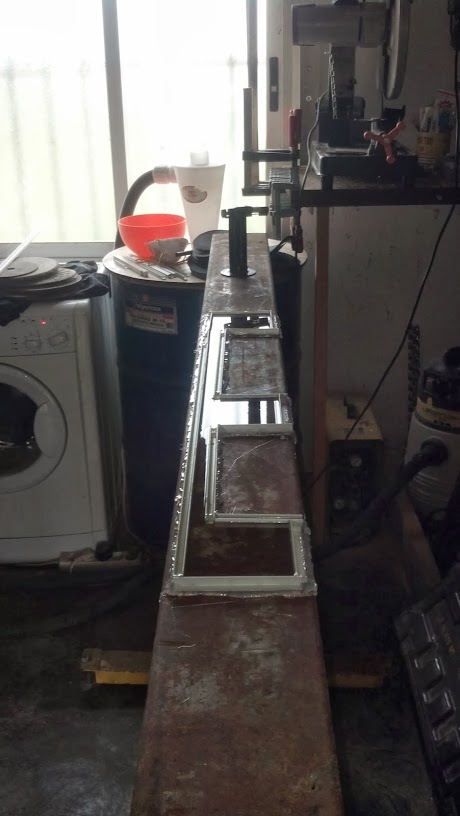

Now its epoxy time. Several mistakes here. Just to fulfill my worries.
I used some aluminum angles, hot glue from outside, instant glue below, silicone at the angle inside.
the mistakes:
-the channels connecting both sides should be wider, say at least 3cm, not like mine-8mm :-). Epoxy has difficulty to flow in so narrow channels
-i am epoxy greedy, calculated the just amount. had to mix second time to fill the channels
-scratched the base below the epoxy, with the idea of better contact. Now i can see the scratches. nevertheless i would paint the machine, but is good to know that the epoxy is quite transparent yellowish color
The clever stuff:
-the epoxy sides will be 40mm wide, works great for leveling.
-it seems the way i fixed the channels holds pretty well , cust came from the garage, no pour for now, one hour later we will see.
-used bolts on the legs to level the machine perfectly
-as i wanted 5mm epoxy thickness, i found some magnets which together made 4.5mm and put then at the corners. This was extremely clever as right from the beginning i could see how much epoxy and where to pour. In fact i believe i poured it perfectly and did not need the channels, as there was a moment when the epoxy just covered the magnets.
-used small torch to help leveling and take away the bubbles.
Attachment 11371
Attachment 11372
Attachment 11373
Other clever stuff was that i welded 2 wheels at the back and fixed 2 handles at the front. That helps me greatly maneuver the 100kg around.
Very neat. Keep the piccies coming. G.
Good job! Thanks for taking photos, sometimes I find it hard to visualise what people have done. The epoxy looks very neat, I would love to see some pictures of it when it's cured. How do you pour it? Just on one side and let it flow down the channel to the other, or fill both sides at the same time?
Did you weld the frame yourself? Looks very good.
Jim
Thanks!
I filled both sides at the same time. The magnets at the corners helped as they were 4.25mm thick, as i could clearly see how much i should pour to achieve 5mm thickness.
As the channels that connect the sides were very thin and i have not mixed enough epoxy, had to mix second time and pour in the channels.
if i was to turn back time, i would have used the same aluminum angle profiles, fix them with scotch only from outside and use cheap epoxy with a brush to make a kind of base, which would close the distance from the channel to the profile against spill. When dry and so secured, pour over the expensive epoxy :-)
Yes, i welded the frame , the process is described at post #43. My second welding job in fact. Good that i was careful there, now things are much more easier that could have been with not so careful welding. used a cheap 250A Mig which i obtained from ebay+C02, hence the not so smooth welds.
Yes the magnets seem a good idea. If I was doing the epoxy I think I would have also used the thin channels, so I am sorry it didn't work out as well as you intended but I am pleased you shared the results so others (me!) can learn from it.
Sorry i thought I had seen all of the posts but I guess I have missed a lot!
As Jim says, the epoxy looks very good and there's no way that frame is going to move.
cncJim
If using the self-leveling epoxy method, then the only way worth pursuing is to have a channel between the two rails (sides) and ensure sufficient depth of epoxy to flow between them. If they were poured separately, then the sides would end up at different heights, potentially resulting in significant stress on the bearings when the gantry is attached, unless shims are placed under the gantry on one side.
