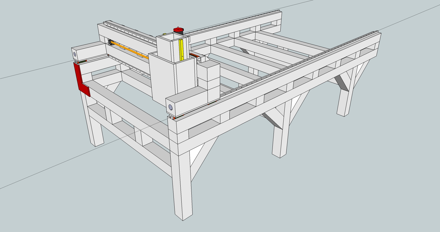

Hi, long time i put this off, but now that successfully finished my first build i am back on the track with my machine build.
Now i have all the electronics, motors and major part/linear rails and ball screws/ sleeping at my garage. This time i will build it much faster.
Having learned a lot from the first build, i reconsidered many things and am trying to finalize the drawing stage, so i can buy the steel profiles next week.
Many changes were done, simplifying, strengthening and all this having in mind the common materials here in Spain.
1. Decided that the machine will be on no long legs. It will rest on the floor.
the benefits:
-I work alone so lifting heavy materials will be a problem in the future. As it will be multi functional, there will be removable plasma torch and 1000x1000x100mm removable water bed also, for the not so rare cases i need some parts from steel done until i make my self proper plasma table.
This is how it will look:

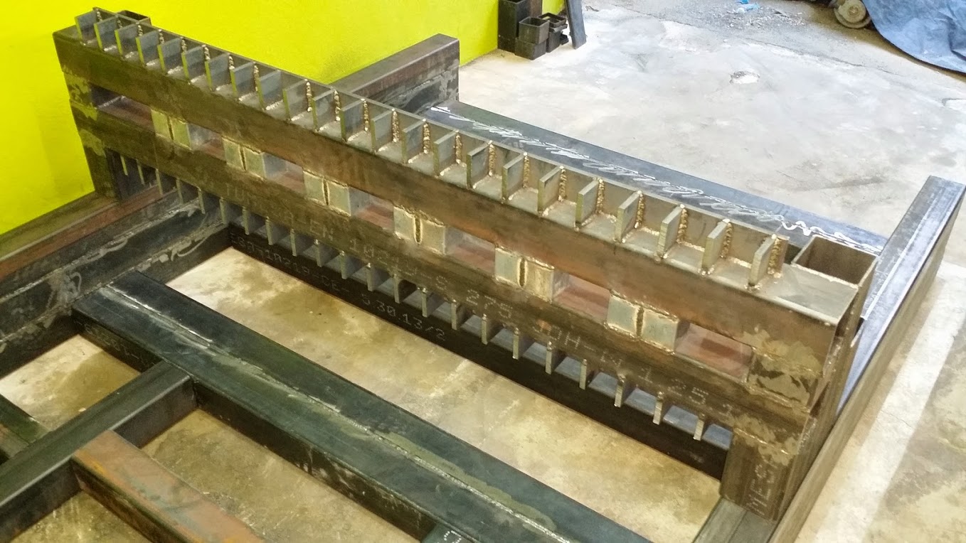

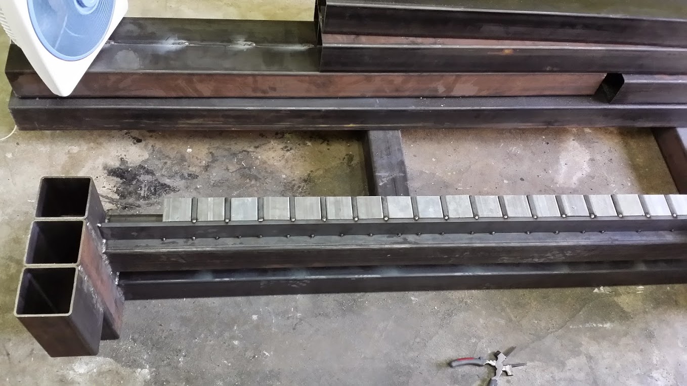

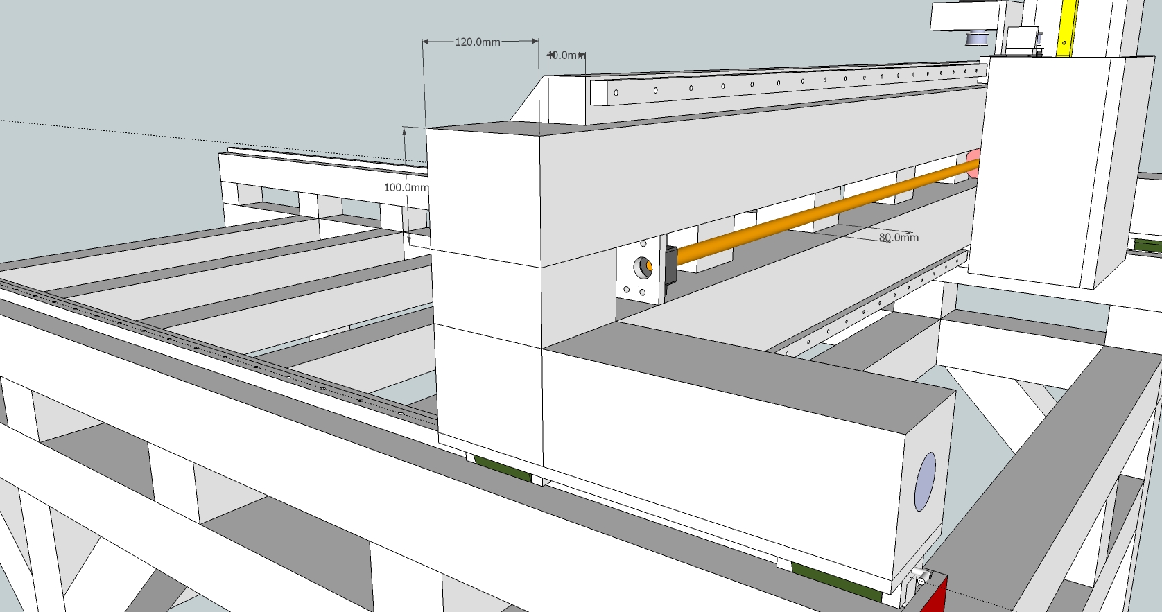

2. I wanted to avoid as much as possible laser cut pieces/$$$/ and use instead the profiles themselves as i would do the cutting at home which saves me quite a lot in fact. Only 3 types of steel will be used-100x100x4/the darker ones/, 100x100x3/ the lighter gray/ and 60x60x4/ the gantry verticals and reinforcement pieces/
The gantry support legs from 100x100x4 / so i can reach and screw the HIWIN blocks to the plate/:
Attachment 12894 Attachment 12895
The ball screw end supports from 2 pieces of UPN100 soldered together. I have the believe that this part is very important to be extremely sturdy in all directions as there wil be very heavy pull there, starting from the tightening and later when the gantry accelerates and so. Additional 2 100mm thick plates for reinforcement,one bellow and one for the face of the beam, so there will be no further doubt there :-).
Attachment 12896

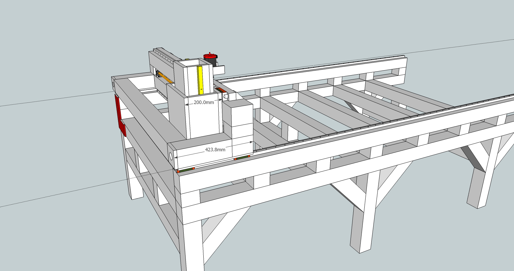

4. Back to the gantry. In a way i am proud of it :joker:
Now the gantry is where i took liberties with the design, hopefully for good. As i said before there is extremely small overhang. Unluckily there was no 120x100 profile available, though when i started the drawing they said that there is . So i redesigned it again. 100x100x4 and 60x60x4. As i started the gantry from scratch and put a lot of thought in there, i believe it will not only be very successful but in the future will serve as an inspiration to all that want the benefit of closed aluminum gantry but don't have the means or money and go with steel. I mean - take away half of the reinforcements and vertical reinforcements /remember-i will mount impact hammer/ , and it still will be heavy duty normal gantry, couple this with the gantry sides like i did them, and you will have cheap very nice gantry that you need a way to cut the profile and solder +2 plates for the HIwins.
In short I believe that's the ideal High Heavy Duty DIY gantry. I hope you will like the design idea. Hidden and short screw, motor inside, all cut from profiles including the sides. In a normal HD variant, there will be less vertical profiles, less support triangles and one less profile each side of the gantry sides.
Attachment 12898 Attachment 12899
FYI : On this picture bellow you can see that the distance i left from front to the vertical supports is 100x100 -60x60/inside verticall supports/ = 40mm. But if the ball screw supports have to be mounted on the vertical bars, no additional plates as i made them, then the distance must be 43mm. Even so the vertical supports will protrude at the back only 3mm which can be masked by soldering, so 100x100 and 60x60 is ideal combination for HD Gantry
Attachment 12900
This is how i envision a normal HD gantry, that will be comparatively very light for what it is and no need to go in the servo territory. I would like to hear critics or opinions on this :-):
Attachment 12901 Attachment 12902 Attachment 12903

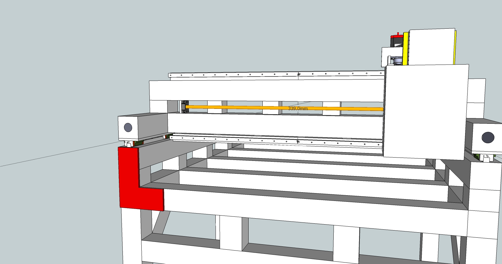

5. The Z
This is on what i am checking and working today. have to check again if the cheese holes are right on spot.
As i said above, with servos i can not design a plate with more than 3mm of movement in both directions to tighten the belt. So i had to do something i dont like and split the Z motor plate to be able to additionally adjust the belt. Still have to calculate again the exact length. And so the days go by...
Will update the Z pictures, when i finish counting cheese holes :-)
Attachment 12905

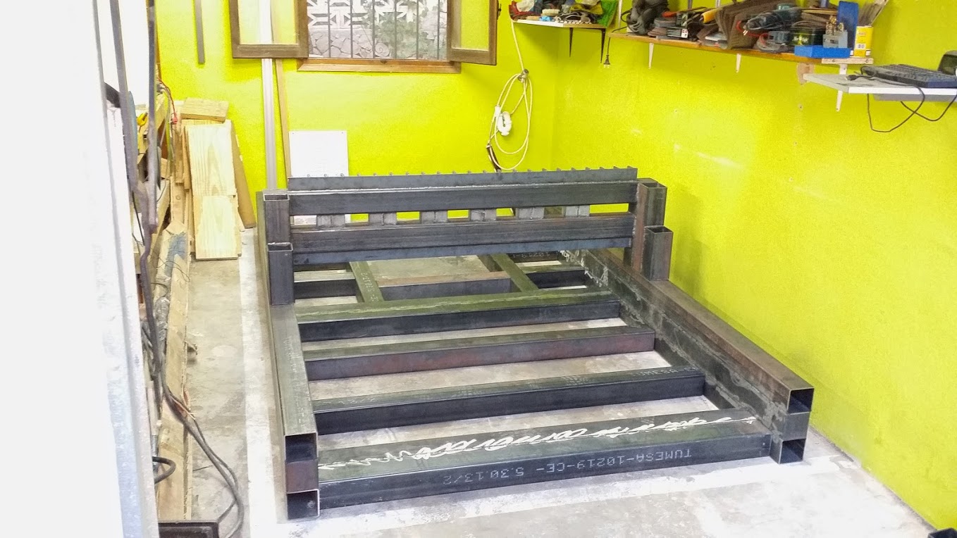

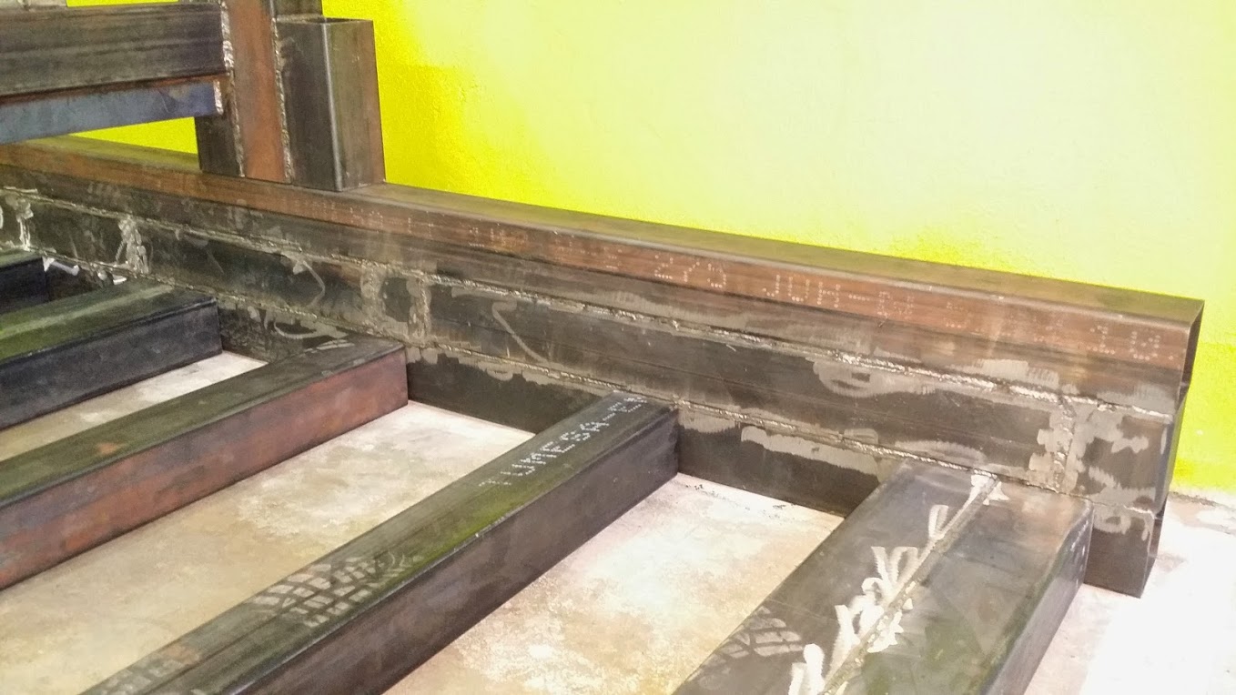

6. The machine bed
Some changes here. Instead of vertically soldering 3 x 2 /100x100x3/ profiles i decided to lay them all in one plane, so the distances between them are very small-200mm. So the bed is really strong, even using cheap bed material.
Attachment 12906

Hi Silyavaski
You have been busy with CAD, nice drawings, what cad package are you using?.
And great to see you have assembled the parts and drives....
How do you intend to join all the steel sections and the vertical bracing? By welding?
From memory you are going to use this machine with an impact hammer to make musical instruments.
Will it be an air operated hammer similar to one of these? https://www.google.com.au/search?q=a...w=1215&bih=817
I was using a small one hand one last week to break up some concrete. they cam deliver quite a blow, You can turn them down by using both a pressure and flow regulator. the settings will depend on what sort of material you are acting upon. even at a low setting the energy released is significant.
Tubular steel is very strong no doubt, however it can vibrate, particularly if the hammer is set to oscillate near the resonant frequency of the frame. Without very sophisticated FEA software it is hard to conceptualise just how a structure will behave. however you may find it advantages to consider the issues involved in advance and if vibration turns out to be a problem have a means of increasing the mass of the structure and what sort of damping measures you take to reduce the amplitude to an acceptable level.
Here is a link to an excellent paper on concrete filled steel structures used in machine design. http://www.mech.utah.edu/~bamberg/re...e%20Design.pdf
John

I see no point in having 2 ballscrews to drive the Z axis.? Whats the thinking behind this.
Your just making the motors work harder and increasing costs for no practicle gain.? You'd be much better spending the money on a second ballnut and creating Zero backlash.!!
Hi Dean,
Yeah, what i was thinking, you got me there . I started the design half an year ago, and learned a lot during this time.The thing is that i wanted not only to have 2 ball nuts but also 2 extra ball screw supports, " 4 is better than 2 " to resist the vibration. Thats why the double ball screw. Also the double ball screw saves on the total Z length.
Now i am not so sure. Still its not too late. Now i see that i could have made the ball screw machined so that it accepts double support at the ends. I have an extra ball screw at home, longer, i mean. Then the only thing that needs changed will be to buy 2 longer Hiwin rails to compensate. Have to rethink that. There is still time.
Now going this way of thinking i start doubting if i should not make the whole z axis 100mm longer and have travel of 300mm instead of the 200mm as its now. Could just raise the vertical bars on the sides of the base with 100mm without compromising any integrity. They are ~80mm high right now. the thing is would i really need that extra 100mm and for what?
For The Z or any other axis you cannot rely on a ballscrew to take any lateral load (at all) only a pure as possible long axis load is permissible.
You will need a pair of rails to carry the load. One ballscrew is fine sized according to the long axis load carrying capacity you will find on the manufacturers specification. Bear in mind the impact hammer will apply a large dynamic load to the ballscrew, You may need to use a higher rated screw to cope with this. I would contact the screw manufacturer and ask for advice.
When setting the rails and ballscrew up they must be perfectly collinear or you will be applying a forbidden lateral load as the paths interfere with each other.
John
How does 2 screws same length give extra travel.? Edit: Ok re -read under stand now 2 ballnuts in parallel is less length than 2 nuts in series.! But still bad idea as it will be quite hard to ensure preload is correct to give zero backlash.
Unless your spinning the ballscrew at very very high speed then at this length vibration shouldn't be problem if supported at both end. If your really bothered then use fixed bearings at both ends and tension the screw.

The design as its now and i have the elements already at home, implements that the both screws have fixed bearing supports at both end.
So you say there will be no sense to make the design as you suggest with one ball screw, 2 nuts and 2 and 2 fixed bearing supports at both ends? I mean only one fixed end will be enough? The bearings doesn't seem very big to me.
I know about the ball deformation. It doesn't bother me though. The hammer head will be half 10mm diameter circle . The air in the hammer dampens the hit, the material is very stretchy too/1-1.2 mm normalized sheet/ , the whole sheet stretches also, not only at the point of hit. More or less the hit will equal to 1 bearing ball hitting the material. This would be spread to all the bearing balls in 2 ball screw nuts. I am not sure how many are they. means that its not like a hit on hard rigid surface
I was contemplating this belt driven. What i want right now is the following. To finish the machine as faster as possible. To try the hammer thing at least once. to draw conclusions and not break the precision of the machine in that process. To use the machine right away to make a new one, simpler, with homemade ridgid elements, belt driven as you say and most importantly 5-6 axis. I almost have all elements for a new machine, apart of this one.
Dean thanks for your time!
I started already redesigning it to go with one screw and 1 or 2 nuts as you suggested. That will save me for a beer or two. I understood you correctly, but messed with my English.
What i meant is if there would be additional benefit if i fix that screw both ends with double fixed end supports, meaning 2 supports each side chained together and then tightened by the nut at the end.

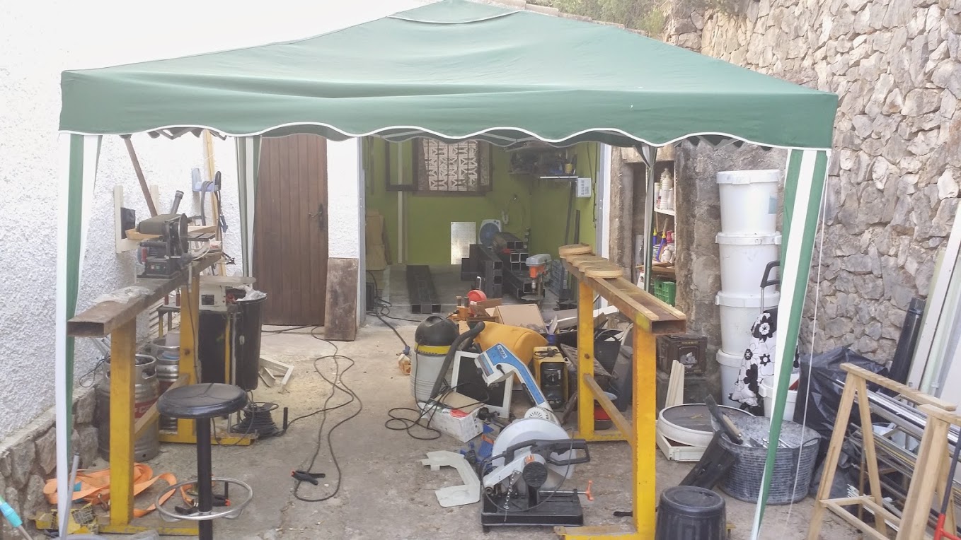

Some updates. 2 very hot weeks, especially if you are working alone in 70% humidity, 40C temperature and soldering all day long +weekends and moving heavy stuff.

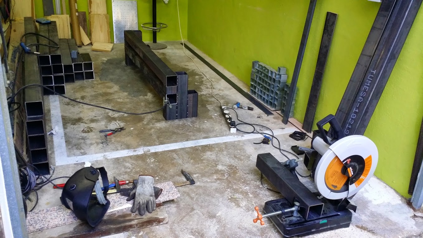

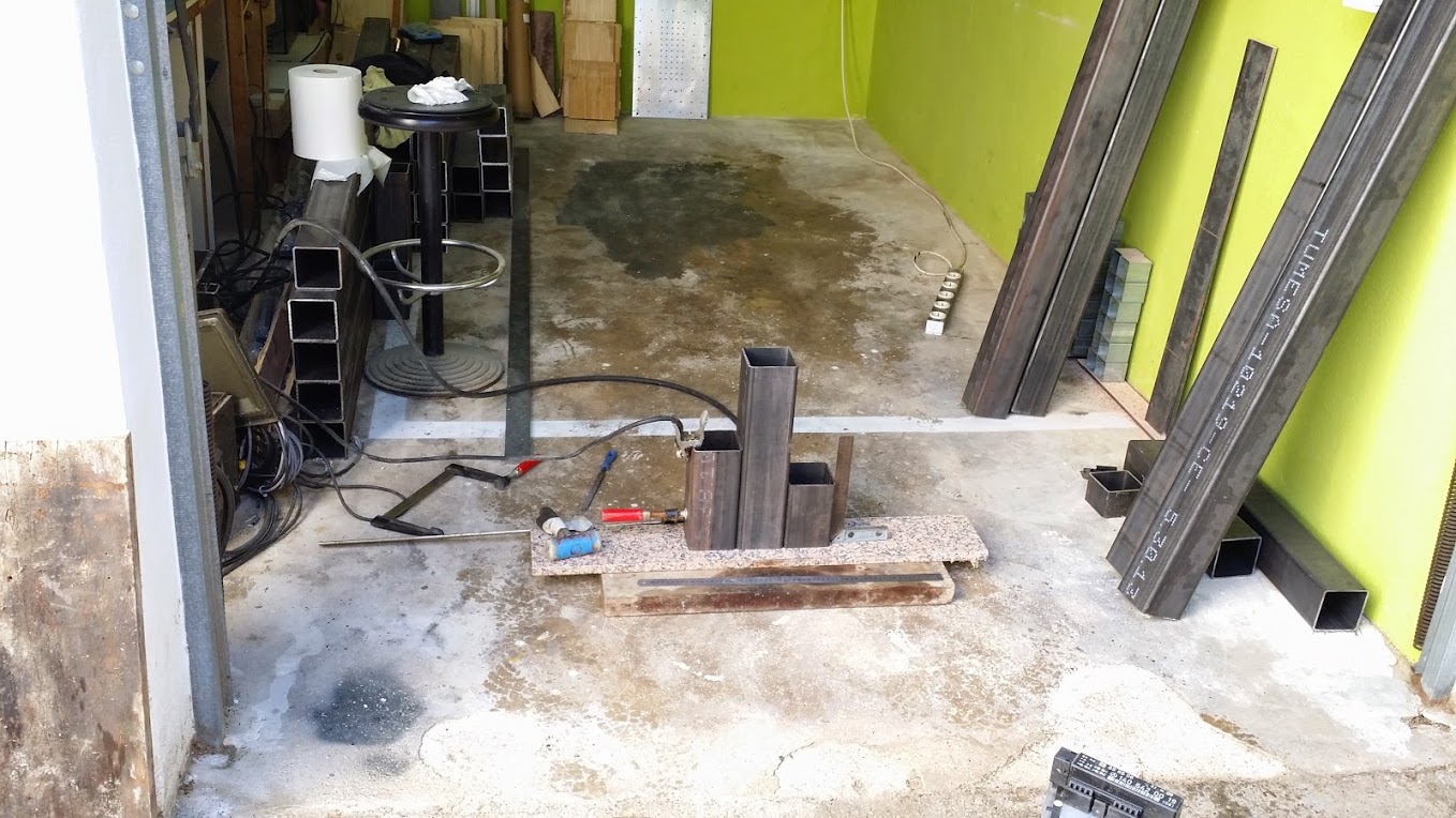

Had to clean all stuff from the garage. Draw white lines for the footprint. This machine will take a lot of space. Of course it rained right after i took everything out, did i tell you it hadn't rained like 11 months.
Attachment 13315

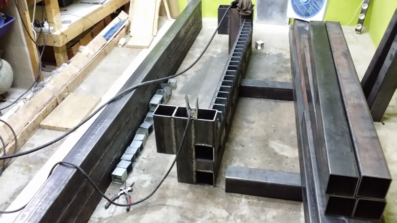

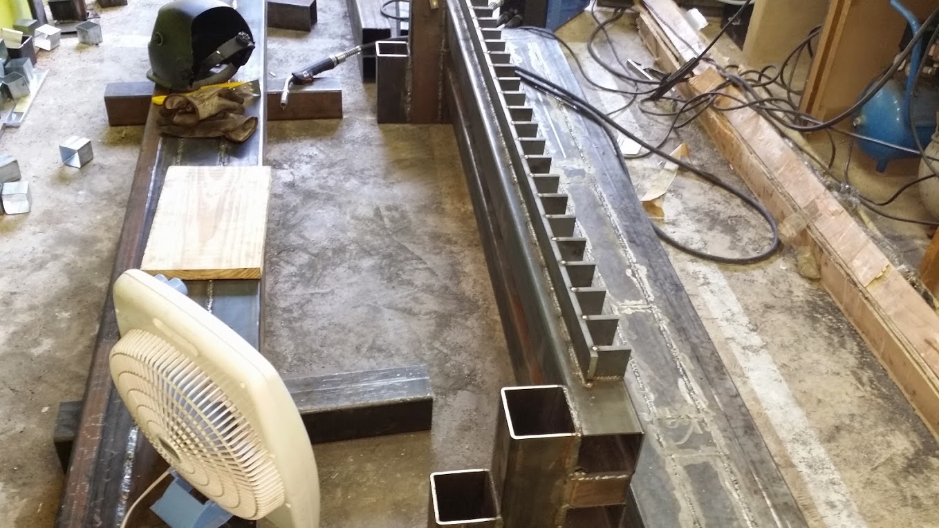

Started with the gantry. decided to keep sides square, so later could flip and support easier the gantry. Do you see the blotch further on the floor. Guess what, just before starting all my boxes with paint fell on the floor and some spilled. A little diversion :-)
Attachment 13316
I have mixed feelings about the Evolution saw. While the motor and blade is great/made in japan/ the saw is very very flimsy. Next project will be to throw away the base and do a new one. I wish i have bought the Makita. It was 100eur more expensive and don't come with blade- another 100, so thats why. Anyway, an essential machine for the project.
Attachment 13317
Ventilator to cool myself and change of plans. The 60x60 profiles cut to size that were meant to support the rails were discarded. There was no way i can solder them from all sides. Instead i cut all of the 60x10 plate/6m in total/ and decided to separate them by the 60mm using at least the profiles i have already cut. Some carefull soldering from here and there. Very rigid result.
Attachment 13318 Attachment 13319 Attachment 13320 Attachment 13321 Attachment 13322

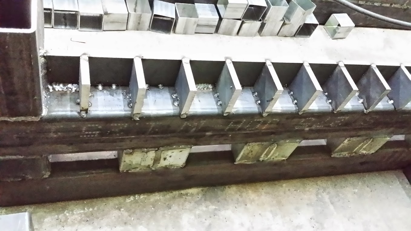

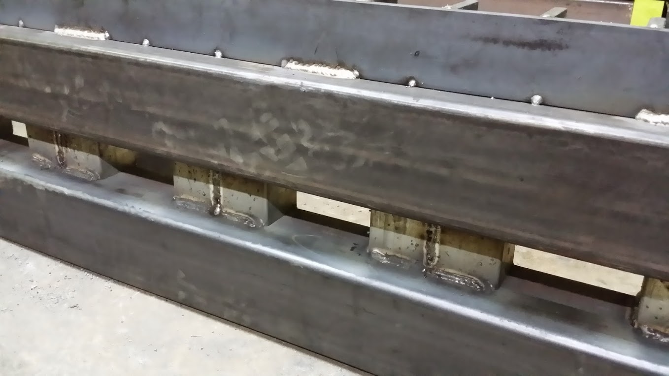

As you see from the pictures above everything is soldered till the end. Now there was another momentary decision. No legs for now untill i decide something clever and the steel from the legs went just inside the sides of the machine. So stair like sides with no holes, there lie the rests of the profiles meant for legs.
Attachment 13323
I cant explain how strong that machine frame feels. Including that bestial gantry. Vertical bend or twist- i did not even bother to measure it with the indicator. Its solid as a rock. starts to look like a Frankenstein thing from movie.
So today i finished working at 20.30 and couldn't help but move all elements with last available effort, as i wanted to see how it would look. I am a strong man, no lift or whatever help, so i am becoming stronger moving all day these pieces around while soldering. Did i tell you that all the soldered pieces weight around 500kg .
So here is my baby. Its huge. I am a bit surprised how big that is. Still has no name but i think it would be something military:

So after ~15kg of wire, 2 CO2 bottles and some crazy days i start to see how will look. Still have no color in mind.

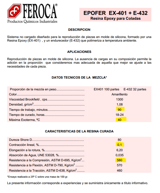

Basically 90 min gel time, max isotherm 40C, compression strength 580kg/cm2, yellowish, contraction 0.1%, density 1.08 gr/cm3 which roughly translates to 6.5l so ~20eur /lit mix, I cross my fingers that it works ok.

1.Seems the biggest unaccounted problem for that purpose is the shrinkage, in other words the purity of the epoxy. Hence the price of good epoxies :-). Otherwise flatness and surface quality is more a result of good mixing and following exact mixture to the gram and temperature when pouring.
2. Judging epoxies from their technical sheets means nothing. It can seem on paper right but poor in reality
3. Epoxies with very high viscosity >700 cps of mixture maybe contain something that will evaporate later
Left on the picture is WS 105+209 at the time of pouring and cured. Also the spanish epoxy untill 4h. Right is the shrinkage when 8h passed

I don't think that you can blame the quality of the epoxy. It did what it was designed to do. I think that epoxies containing solvents are typically used for coating, so that they spread well - which is what your epoxy did! They are definitely not recommended for use as adhesives or fillers, mainly because of the shrinkage as the solvent evaporates. However, I didn't know this either until a couple of days ago when I read an article on the use of epoxies for adhesives and coating! Something to watch out for if anyone is looking for an alternative to the usual named brands.
Hi Neale,
This is specifically a casting epoxy, its not a coating epoxy. It specifically says 0.1% shrinkage in its technical sheet, and by no means its a cheap epoxy , its simply cheaper than imported WS epoxies.
I also read a lot of documents about epoxy and all say the same- 3 types of shrinkage, and exactly this type is due to non reacting solvents. This is not shrinkage due to temperature cause it happens after the initial hardening. From the company started to argue with me, saying this is not possible, it never happened, until the moment they understood that i know a lot of sh^t about epoxy and they agreed that this was because of the cheap solvents. That was the moment they agreed to break their policy of no return, once its opened.
What about adding a filler like ATH ?
