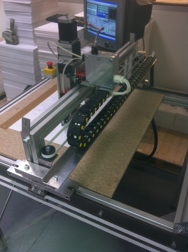

Will do, she's a bit of a mess at the moment as it's just thrown together for testing and I'm fitting cable track and other little bits.

A couple of pictures...
the whole contraption....... :)
http://www.davekearley.co.uk/LinkPics/CNC7.jpg
And one of my first attempt at a floating head that I knocked together today...
http://www.davekearley.co.uk/LinkPics/CNC8.jpg
It's a couple of cut-down ball-bearing drawer runners and a bit of ally plate and a switch :)

Got the panel wired today...
Attachment 11558
Just need to figure out a slat support system and I can start test cutting :)
Tidied things up a bit today,
Attachment 11586
Attachment 11587
Pretty much ready each for the table bed and the torch I think. Can't think of anyway to harden the electronics further, it's got a relay isolated 24v control circuit, decent grounding, steel cabinet, no low level signals outside the box, so on.

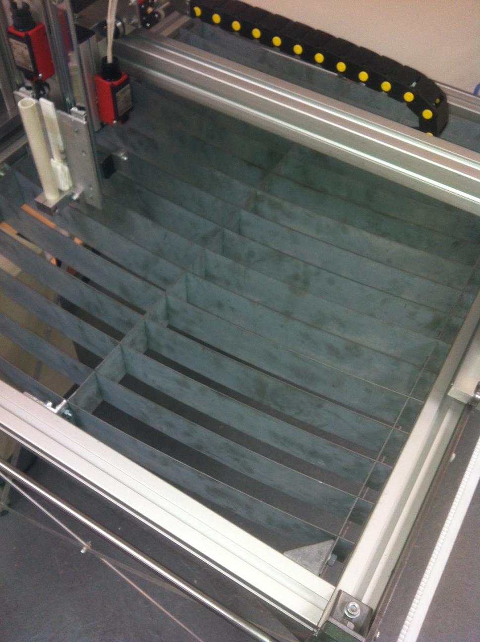

I've got someone cutting some slats for the bed, seemed the easiest way.

Got the slat bed fitted today, looks better than a lump of old chipboard :)
Attachment 11652
