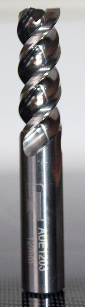

Hi silyavski,
Here I made a picture of AUE1203. Take a look and let me know what do you think.
I will just mention that this tool has polished front and back cutting surfaces. To be honest yes, I am selling these tools, but I can assure you from the user point of view that these cutters are better than many world famous brands, which I will not mention here.
http://www.mycncuk.com/attachment.ph...id=13484&stc=1
These you show are 3 flutes and seem nice. But I believe here people/DIY, forums/ would be more interested in your AET series 2 flutes, cause they can be used also for plastic and wood, or at the long ones .
