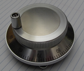

More and more it looks to me that the best approach is a mechanical step-up! Trying to multiply the number of pulses electronically is inherently the wrong way to go.
Fix the mpg down on a board and mount a larger mdf wheel next to it on an improvised pivot. Use a wide rubber band as a belt . Should be relatively easy to get a 5:1 step up.

Ok well let me explain again that ALL i want to do is have the axis move, doesn't matter if it misses steps or stops fast etc just move faster than 1 pulse at a time so I can get from one end of machine to other with cranking the handle 1000's a time.
All I wanting is like Irving says to move the axis while working on machines and for setting up limts switches etc. This is why I would like to have the single pulse detent for when close to limits etc. Before that it won't matter if it gets infront or behind with pulses etc and overruns or misses steps etc as I'm not after any accuracy and when I'm getting close to where want to be I'll drop to single pulse. Sure when used to it I'll know how it's going to react to my turning the handle at differant speeds.?
To those that have suggested mechanical options then YES I know this and I can even push bloody the axis if I wanted but that's not what I want so please don't go there anymore it will only take the thread off at tangents.!
Similar with the arduino and software based options, yes I know they are best or easier option and yes I've done some VB and C++ coding so could after cleaning the rust off gone this route and made it happen.!! . . . But again didn't want to. Just want it rough arse KISS approach and to learn from.
555 timer hasn't been ruled out but I would have to have the single step option like the detent of the MPG.

A possible issue with the mechanical option is potentially the pulse rate the wheel can achieve. One datasheet shows one such wheel has a fixed 800uS pulse per detent, which limits it to 125 steps/sec or 75rpm.

Yes I do this already eddy, I have a test rig setup with BOB, SS and 4 drives VFD etc so can test a machine is fully working while on the bench but some times I need to move an axis SINGLE axis away from the bench or before all wiring is done IE short stepper wires so I want simple portable unit to do this. Also some times I have more than one machine on the go and at differant stages of build so Don't want to have to lug PC and all the stuff to machine if it's not on the main bench.

If you apply 5V across the DIR pins the motor will spin one way, apply 0V (or leave disconnected) and it will spin the other way. You could could do that simply with a switch if you're happy for the machine to go in the direction set by the switch, not follow the direction in which the MPG is spun.
Obviously I know this and thats what I've been doing just with MPG. This is what I've been saying I just want it simple so flicking switch is fine and spinning mpg just for movement. Just I need faster than the single pulse the MPG spins at but still want the abilty to single step when needed.
555 + MPG would work and would probably be simplist but I don't mind playing and want to learn something in the process and so long as Irving or some other kind sole doesn't mind giving directions then I'll wait and see all the options.!
