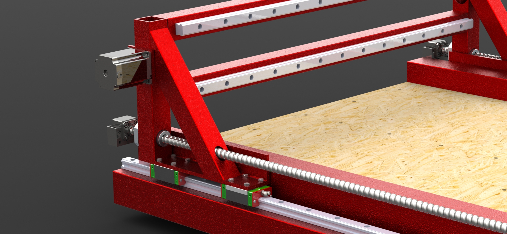

Ideal, Spent most of last night getting the basic design on paper then spent a couple hours on SW going through a few differnt configurations with this one being the easiest and simplest to make :)
What do you think? There is a piece connecting the rail section underneath going across the X axis. Oh and the board would be MDF...SW doesnt seem to have that

That baseboard will bounce and sound like a drum!! That is unless there are lorts of supports underneath it, but I can't see any bolt holes apart from the ones down the outside? Why have you put the rails below the base, all the swarf will drop onto them! How are you going to mount the ballscrews and stepper motors? You're not doing a simgle ballscrew for the X axis are you? What is the gantry going to look like?
Have you looked at the build threads? Most (I do realise that you don't have to go along the same lines as most other people...however there is normally a reason why most of the builds look pretty much the same!!) look like mine below...

there is one support under the table though I could easily add another :) The table is above the rails to give more rigidity which ill show from the underneath. The, so bare in mind that its not at all done..still fiddling with the design. I see your point about crap going onto the rails but that would happen in most machines...yours even...rather than have the stuff been blown onto them after running alone your board mine will do the same but the machines rubbish will blow off the board and possibly land on the rails...but either way..Im going to add 3mm poly between the gap of the table and the rail carrages...so efficiently having a box where the machined rubbish(Any jargon here) will stay and be easily cleaned up afterwards :)
Ahh, I was planning on ussing a single ballscrew down the middle? Is that a big no no?
Also, the rails that the gantry run on...is there a good distance to keep them from eachother? Assuming that the closer they are the more slop you could possibly get?
My gantrry is 1 vertical piece with a large 40x40x4, 45deg support
Re: Im new, am a 3D designer. Need a New cnc machine and need advice and guidance
I had planned on using one ballstrew for each axis... waht you see would have 100mm legs on each corner and would then have a piece connecting each side of the gantry that can be bolted onto the gantry sides to make assembly that bit easier

You are weakening the machine having that base like that and it's completely not needed. You need to keep the gantry sides height to a minimum and your creating 60mm more than needed and every bit helps if your wanting to cut aluminium.
If you want the best strength then having raised sides with rails on top with gantry sat directly on bearings is massively strong and much much more suited to an all round machine. If your wanting to cut aluminium then you WILL need 2 ballscrews on the axis moving gantry. This is not just an opinion it's hard learnt and tested thru building many differant machine designs trying to find the best design for an all round machine without being silly about design.
The machine your building with single screws will be fine for mostly wood use and occasional light duty Aluminium work but have no doubts it won't handle cutting aluminium correctly and give quality finish. At a minimum you'll need 2 ballscrews moving gantry to stand any chance and very beefy gantry.
Edit: Oh and the bed base needs far more supports than just one in middle.
So loose the second level of boxsection with the board ontop?
Keep gantry height to a minimum
Design in two ballscrews now rather than later
add more support for bed..
got it :) The general gantry design.. Is that ok? with a vertical piece and a 45 member to give some strength... How far should i keep the bearing carriages apart? from the faces that would touch..

IF you've gone through the build logs then you'll see a pattern in the design of the routers built recently which are 90% (this one isn't...http://www.mycncuk.com/forums/gantry...ercnc_mk3.html) all raised rails above the bed like the pictures I posted previously. They'll also answer most of the questions you're asking about designing them. You don't have to go re-inventing the wheel! Most people on here want to cut the same things that you do (I do as I want to make parts for balsa and ply planes, carbon fibre heli frames and quad frames, ali parts for my helis and quad etc...) so their routers have been designed as a best compromise to achieve this. Re-read all the build threads to see how designs have changed along the build. Mine's a very good example of just this. I started with a similar design as the one you're doing and has evolved as I've read more build logs and asked questions...
The 'routercnc_MK3' is my machine and I'll explain why it looks like that.
It was much easier to build it like that based on a simple evolution of the previous version. It is only intended to cut balsa wood, liteply, and plywood and it works very well. I've been using it recently for cutting some 20mm thick aluminium upgrade parts, but that is not the main use.
If I do cut aluminium on my machine (6mm carbide 2 flute cutter) I can run at 1.0mm depth of cut and about 800mm/min feed. Any deeper and I get chatter.
If you want to cut a fair amount of aluminium the raised X axis designs are far superior and probably the best DIY CNC arrangement without simply converting a bridgeport mill to CNC. If you are starting from scratch there is no reason not to really.

Not trying to reinvent any wheel, I have lowered the bed...I am still going to keep the sides now as they are good for more strength and will also save me using 3mm poly as a way to stop rubbish going onto the rails...Im quite happy with this though it may need more support on the underneath... I need to make bracket on either end and either side of the machine to hold the motors and ballscrews...
My one concern is the accuracy in welding...if i take the parts to a welding shop will they know how precise this had to be? Dont want them to weld it up and realise its off by a few mm
Don't waste your money because they won't be able to stop distortion only lessen it and in any case you will still need to either use shims or Epoxy method.
Only thing you want to pay special attention to is Twist. If the base frame is twisted then the rails are not on the same plane, Epoxy method is good for sorting this but if you pay carefull attention when welding up then it's possible to get away with just light shimming of the rails. . . BUT with your design the Epoxy method will be much easier and more accurate than your capabiltys to measure rails are on same plane.!
Squareness of base frame isn't critical either square to 1 or 2mm is fine, obviously less is preferable. The important area is the gantry is square to the rails.
The base the cutting bed sits on needs to be resonably flat but again it's not critical as you'll surface the bed before using and this will bring it flat parallel plane.
Like Neil says you really need to go reading some of the build threads more closely and pick up the tips and you'll see whats needed and where your design Lacks or CAN be improved.

So I have nearly completed the first draft of my design, Im very comfortable with being able to make this machine with the tools and equipment I have access too. The gantry im happy with and the way in which the gantry is mounted to the rails. Im also happy with the location of the rails, steppers and mounts etc... the ball screw support blocks have yet to be mounted to a plate(next job) then onto the z axis :)
The frame is mostly 60x60x3mm box section with the gantries vertical section and support section being 40x40x5mm, Hopefully you guys approve this design...in which case I start my budget plan to make sure it can be built within my budget. Then progress to the parts list and DXF files for the laser cut stepper mounts and then go from there :)
Added some colour to give it a bit of life...
Attachment 12535 Attachment 12536

OK Mike, sorry I'm going to be blunt here. Jazz has said to go through the build logs as have myself, Jonathan and the others I still think you need to go back and do some reading as the design you have put here has been done before (or designs nearly identical to this one) and commented on.
Again being blunt:
FlyHighRC
Do you have a link to these linear rails?
I dont know much about CNC but i know how to incorprate strength into a design. If there is one thing Im good at its designing...dont get me wrong...i have seen builds on this forum which to me seem fine but people who have been there and done that have pointed out aspcts of designs that didnt show up to me...but all their critisims and expertise has been written down on my Pukkapad to bear in mind when designing my machine, which will be posted so others can tell me what needs improvong and whats ok etc etc.
Really appreciate the help :)
The design you posted is anything but strong...people will have pointed out things in other builds which to you don't show up because they have experience of building the machines, normally by making the same mistakes and regretting it. My brief comments on "first draft"
- Bed does not have enough support and will vibrate and bounce giving poor finish.
- X axis bearing mount to gantry is too thin and flexible.
- Mount the steppers with belts to reduce resonance, not essential but preferable.
- Gantry has no bracing or support so will bend/bounce/twist giving poor finish.
- 40x40 box (for the gantry) isn't strong enough as Jazz said before.
The above assumes that you will be cutting some aluminium at some stage.
Sorry my reply might come accross as being unfriendly and harsh but I can see you going down a route as Jazz said that will leave you dissapointed if you're not careful and if you're not careful you'll waste money prodcing a machine that won't cut what you want to cut.
