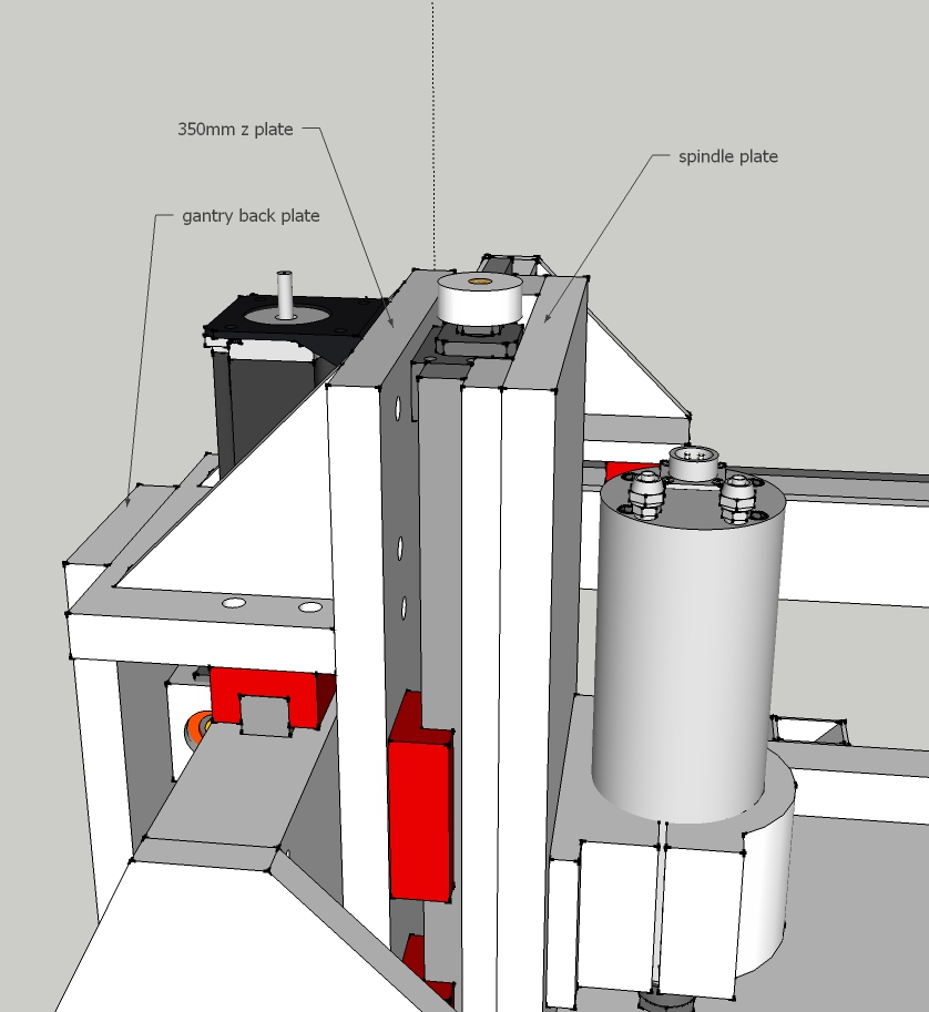

So, is that the issue that will cause the vibration, the rails going above the gantry top? If it is then I will have a look at what I can do.

Hi Charlie,
Good to read that you've switched to the conventional Z axis, although I hope you've done it due to understanding the problem rather than peer pressure.
To to lay it out again, using the calculations for the simplified example previously shown:
Conventional Z axis deflection of between 0.19um - 10um depending upon Z axis extension
Unconventional Z axis deflection of 10um - FIXED (i.e. the worse case conventional at all times)
Your unconventional sketch in post #39 looked like it might get around the 'tuning fork' problem but it would not be very practical as it was drawn at full extension and this meant cutting would be up near the gantry! Your only option for practical work would be to drop the spindle down in the mount to hang down out of the clamp, but I think this would not be especially stiff. Your only other option in the design would be to raise the lowest bearing block to allow the Z axis to drop further but then you are back around the loop of an unconventional Z axis as per the above.

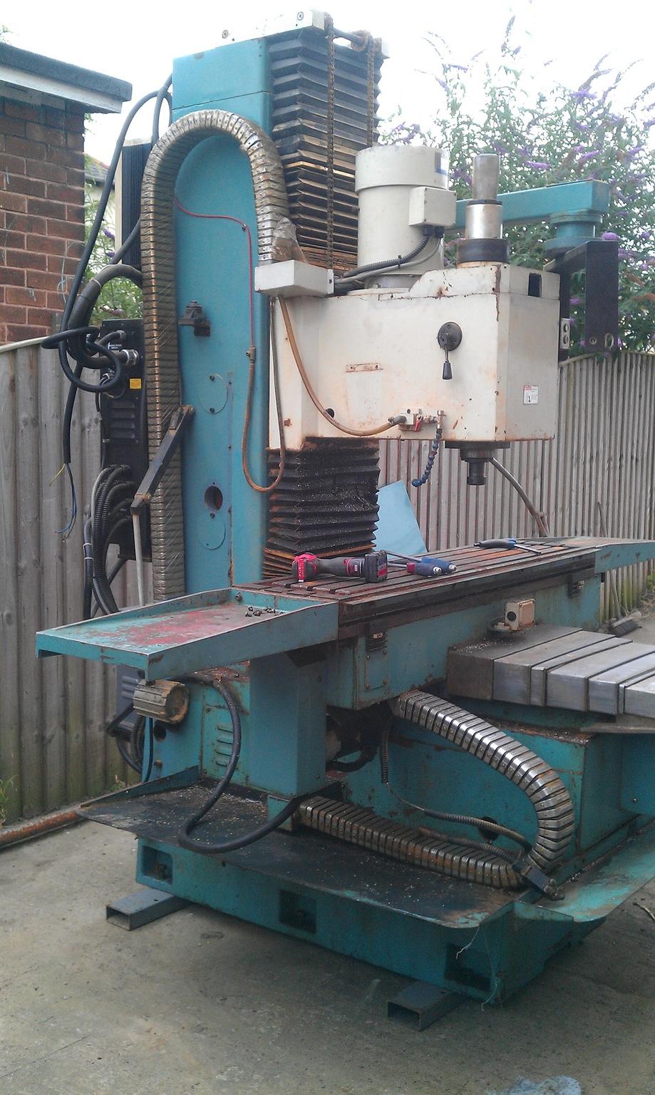

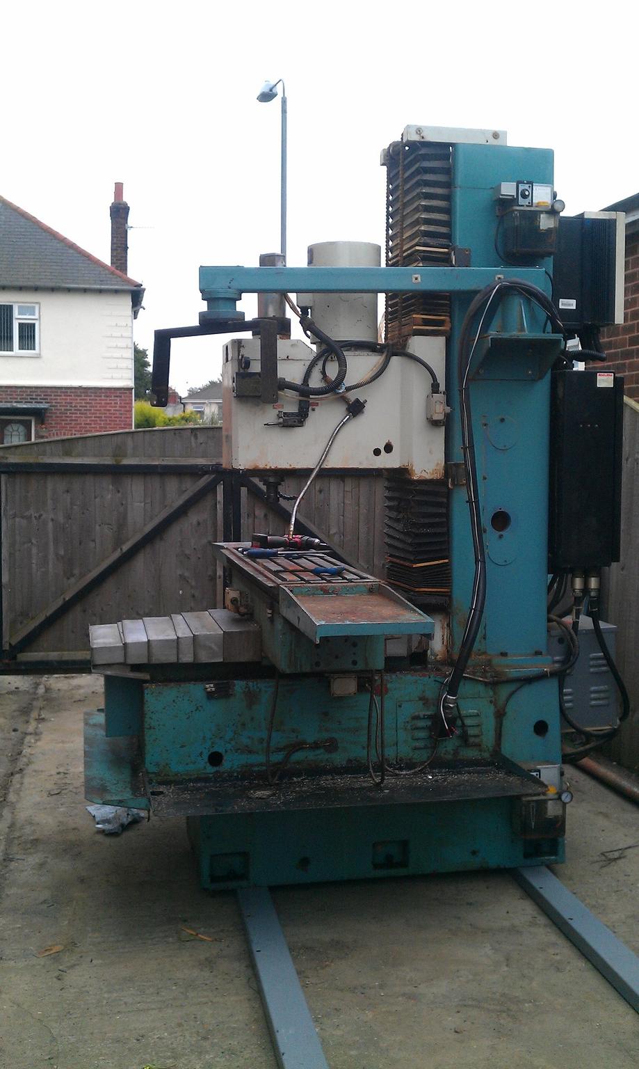

To give an example I picked this CNC Mill up at scrap value. 1100 x 500 x 500 cutting area. DC servo's, 7.5Kw Cat40 spindle, Was fully working apart from needing PSU for the out dated Hindeman control which at some point around 2060 when get time I'll be replacing with Mach3 and CSlabs Analog controller. DIY isn't always the best option esp when you get into milling steels.!
Attachment 13163Attachment 13164
I see three problems with buying a mill.
1. I couldn't say I made it myself ( big one)
2 It's bloody huge! I would never get it in my back garden and even if I did, I wouldn't have anywhere to put it.
3 Divorce is expensive :-)
Cheers, Charlie
Well easy replys's to these Commnets.!!
#1 It would be an achievement in it's self for someone new to CNC to Retrofit something like this and they could be proud if they did it.!
#2 This should tell you everything you need to know about what's required to cut steel.!! . . . . It's nearly 3000KG and mostly cast iron.

Well here it is, Idea 9 :worked_till_5am:, mainly for woods/plastics but also hoping to do a bit of aluminium or cast iron work when I modify my mill (which I havn't actually got yet! :eagerness:)
All bits in blue are steel, the gantry is built using 80x40 4mm box section aluminium with a 20mm plate across the front, the X axis rails will be 80 x 40 steel with 5mm of resin for leveling but I am not sure whether to go 3mm or 4mm steel thickness (is 3mm enough, I will go 4mm if its weldable??) the frame is 50x50 3mm steel and I plan on putting 4"x1" aluminium box section running the length of the bed with a 10mm alu plate on top of that drilled and tapped.
To manufacture the gantry I plan to machine the front plate, leaving a little for finishing. The aluminium box section will then be bolted together, solid aluminium blocks will be machined to fit in the ends. I am then hoping to lightly skim the X rail seating faces square to the front face and also lightly skim the front face before attaching the 20mm plate. I will then skim the profile rail support faces on the alu plate. What do you reckon?
The frame and X rails are all one component and even though I haven't welded before I am hoping to get the top face for the rails within 5mm so that the epoxy leveling will do its job! I realize that I am going to have to shim the ballscrew mounts so that they run parallel with the rails but is there anything else I should watch out for?
I have included the sketchup file for anyone wanting to tear it apart for scrutiny and as always appreciate any feedback as to why it will/won't work.
Cheers, Charlie
I wouldn't put that profile at the back, that limits larger pieces. Instead cut 2 more small side pieces and reinforce the last one of the stair steps at the back of the table, welding a pack of 2 together. Same for the front. may be even one more at the middle. Or reinforce back and front with additional plates.
How long and how wide is the table? may be if you remove what i say you will need adding it bellow, even at front also. Depends on your priorities. Tough i see at the other hand you use a lot of diagonals, so that last may be not necessary.
Attachment 13340
The machine overall size is 950 wide by 1550 long with a cutting area of 610mm x 1300mm x 150mm
The upper cross brace is also used to mount the stepper but I can add more strutts between the x rail and 50mm frame if thats what you mean?

I would use no diagonals at all as the structure seems right to me. However i will use 10mm thick plate for the bolt on connections. That should do it
Thanks for the quick replies guys.
Hi Boyan, when you say no diagonals, you mean to remove all angled box sections? and then swap my 5mm plate for 10mm on the existing bolt plates, the reason I chose 5mm was because it would be easier to weld to the 4mm box section (I think!)
Cheers, Charlie
Yes,
and if you do the small effort of designing and welding additional bottom plates where the threads will go, i am sure about that.
There is no problem welding 10mm plate to 4mm box section, on the contrary, the weld when properly done will make things stronger
Anyway, you could just buy 6m flat 10mm thick bar and cut it to many pieces with the Rage.
I have been looking at the X drive and have modeled up what I have in mind, I was originally thinking twin motors but I didn't want to tie up a 4th drive, so if I go for the following method would the belt length cause too much issue (I have worked out the belt length and the nearest standard length from Zapp is 1895mm) and also would a nema 23 do it or should I go upto a nema34. In the first image the belt is housed in a 50x25 3mm thich channel, in the second I have moved it up to show the belt run. This gives me about 2mm inside the box section in all directions clearance. Should I expect more belt sag or whip , I am hoping if they are tensioned OK then it will be sufficient but as I have no experience of using belt drives I have no Idea!
Cheers, Charlie
