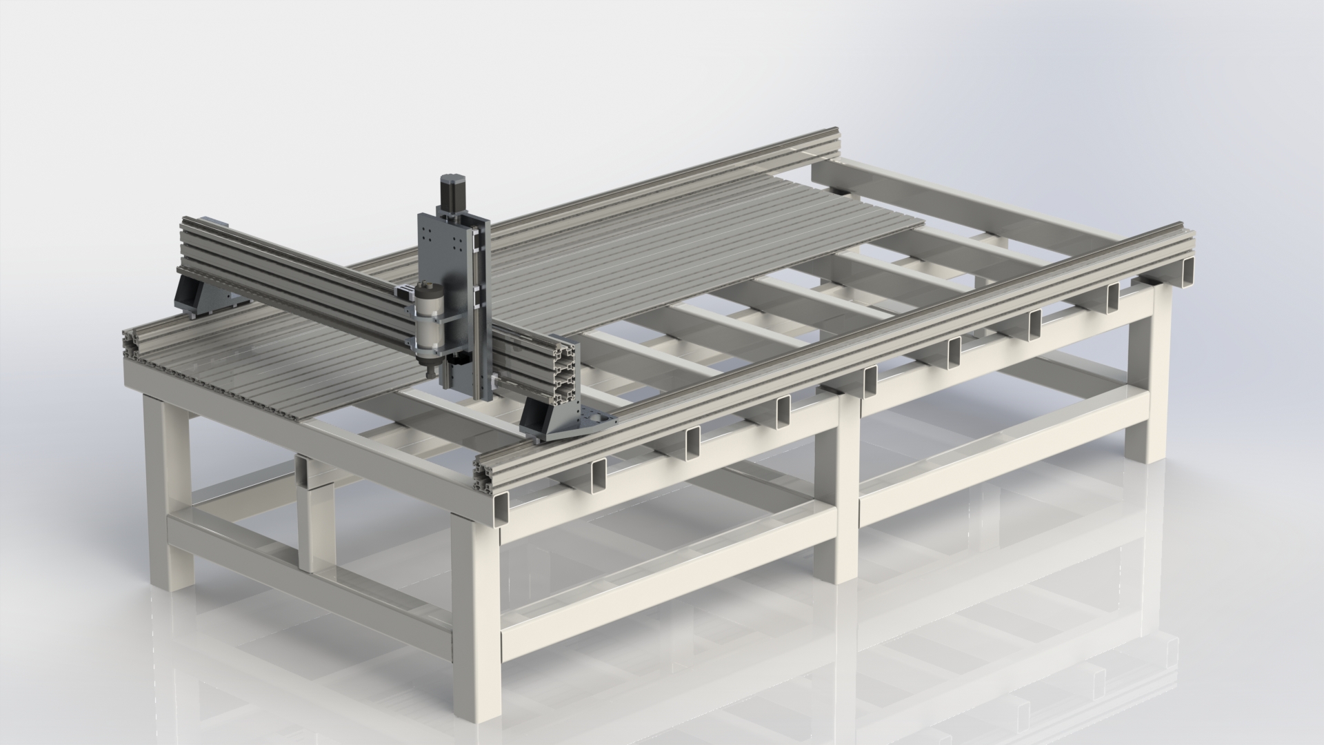

4 Attachment(s)
Re: 8x4 router build. Steel base & Aluminium gantry gantry
Well, I've managed to get a good start on the machine over the past couple days. This thing is solid!
Attachment 13937Attachment 13939Attachment 13938Attachment 13936

What a beauty. My heart warms looking at big steel structures :hysterical:

Thanks, I have the same warm heart feeling haha gets warmer when I try and move it. Haha
Decided to go with Adtech servos and drives. With the edingcnc board.

Looking great - very purposeful, workshop looks soooo tidy, but I guess it is your works unit and not your garage.

What can i say, i fabricate every day, however its been a quiet week, plus the fact i ad them cut to size haha +/-2mm so was a case of trimming them up and welding. the welding took some time due to having to jump on different parts to stop and warping etc.
