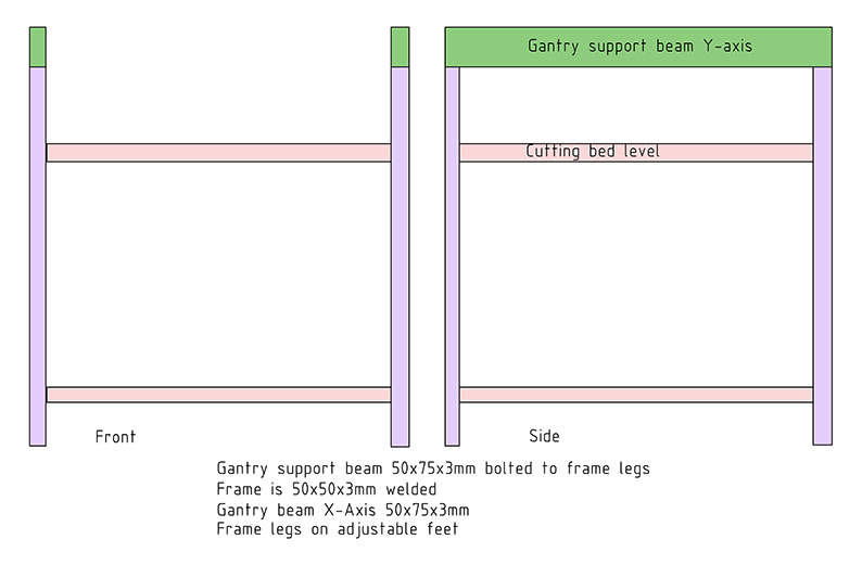

View from front looking at current gantry design.
http://www.mycncuk.com/attachment.ph...id=15648&stc=1
This is for the open-bed style table with the longer gantry arms. The linear guides can be easily covered from the top.
The gantry beam will pass through the side support plates and be welded up and gusseted inside with some nicely cut parts, the outer face of the vertical supports can be strengthened with a couple of ribs to resist side-sway.
Mounting the support rails is harder on the open bed style though, I was going to bolt them on but this style really wants a box frame at bed level.

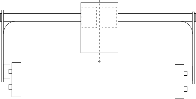

My high-rail option is sketched out earlier, it had no risers at all on the gantry - the beam was right down on the carriages.

Or you could move the rails up closer to the gantry they support. The gantry only needs to be 2" above the bed, doesn't it?
To add scale to my poor sketches, the bottom of the gantry beam is 140mm above the bed surface, not too bad??

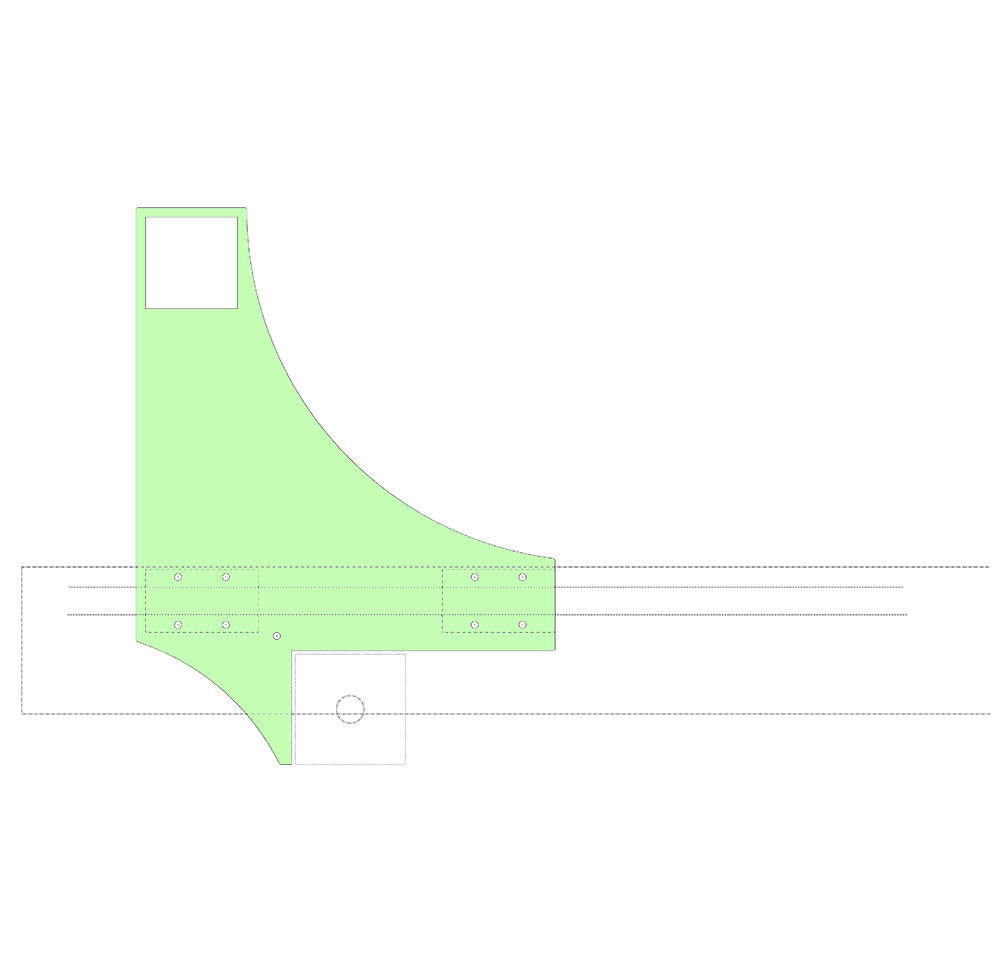

http://www.mycncuk.com/attachment.ph...id=15652&stc=1
The top box is the gantry beam, 50x50, the motor sits down the bottom on a plate that swivels on the point shown. It will be spring loaded but restricted so it cannot jump out of the rack and chew it up.
A couple of 75mm gusset plates under the beam on the inside and a rib or two on the outside should stiffen things up a fair bit.

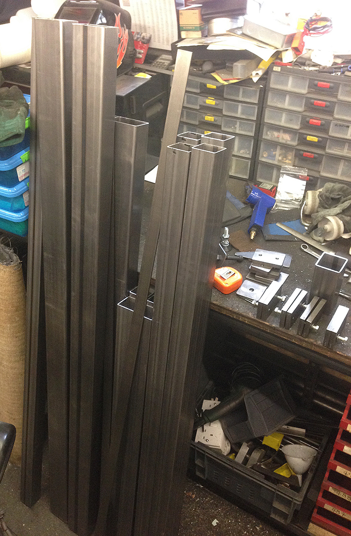

Steel came Friday, nice and straight and after a few stress tests (me standing in the middle of a 7m long beam) I realised just how rigid this stuff is http://www.practicalmachinist.com/smile.gif
Construction question:
I was thinking of welding on some 100x50x10mm pads under each corner of the motion frame and similar to the top of each leg, then bolting the two parts (welded motion frame/bed and welded leg assembly) together, just to give the opportunity to shim out any variation in leg length etc. Good idea, bad or not worth it???
Next, the bed/motion frame - should I attempt to weld it up as one piece, or weld closing plates flush into the ends of the cross-members, drill/tap and then bolt together?? If yes then how to weld the closer plates in - only way i can think is to heavily bevel the plates then insert and fill bevel with weld tying into the tube sides??? Plates would be 46x76x10mm.

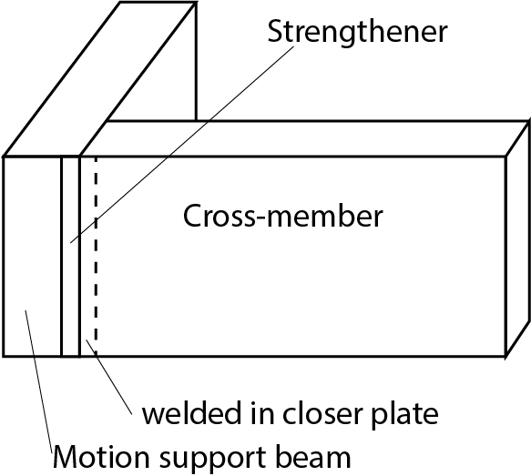

Upon assembly i realised i could not weld in the lower cross-beams as planned, I'm not really up to vertical mig yet, cannot get it on the bench, and the underside welds could not be done at all. Answer - make some more bolt fitments out of 10x50mm bar, weld them on and bolt the lower cross-beams in, this will make disassembly easy too.
If you are trying to weld thin steel and thick steel together you need to run the weld pool down the thick piece of metal and then quickly move across to the thin metal, back to the thick metal, down a bit across just enough, back again to the thick piece, down again etc etc
If you try running a bead equally down the joint, the thin metal will blow out or the thick metal will not get proper penetration.
A CNC machine is never going to generate enough force to cause a properly formed weld to fail, it will probably never get above 1% of the failure point. But if you decide to do nice 'stack of pennies' welds that would make an instructor happy you will be introducing a lot of heat into your frame that will cause stress and distortion over time.
Clamp it, tac it, clean it, back weld an inch at a time and drink lots tea so the heat doesn't build up.
