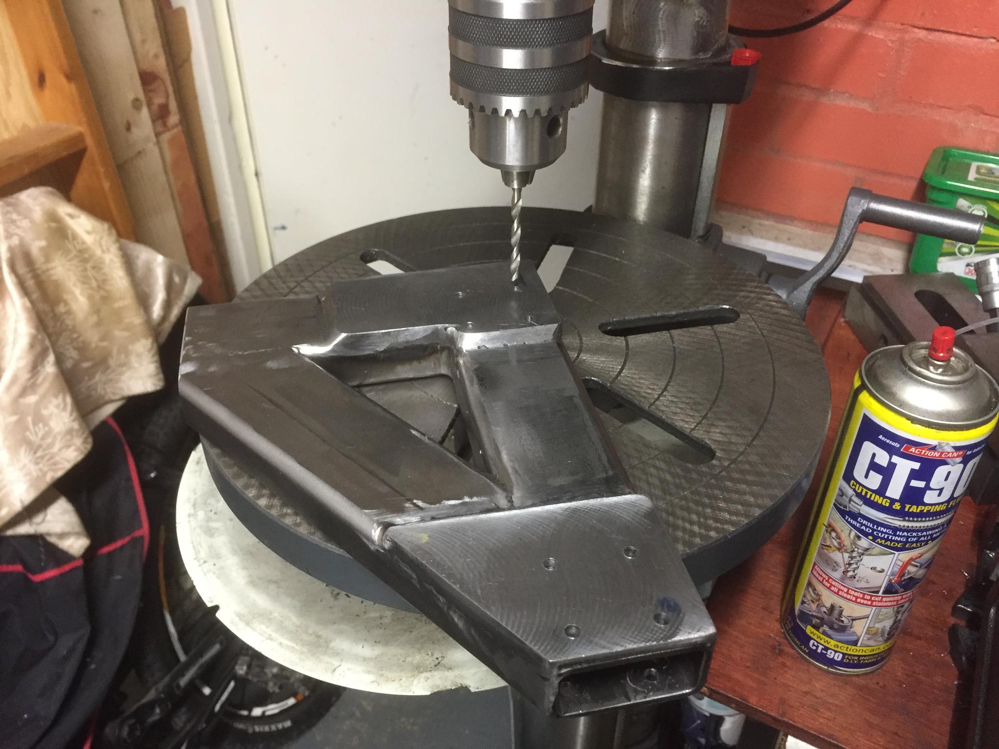

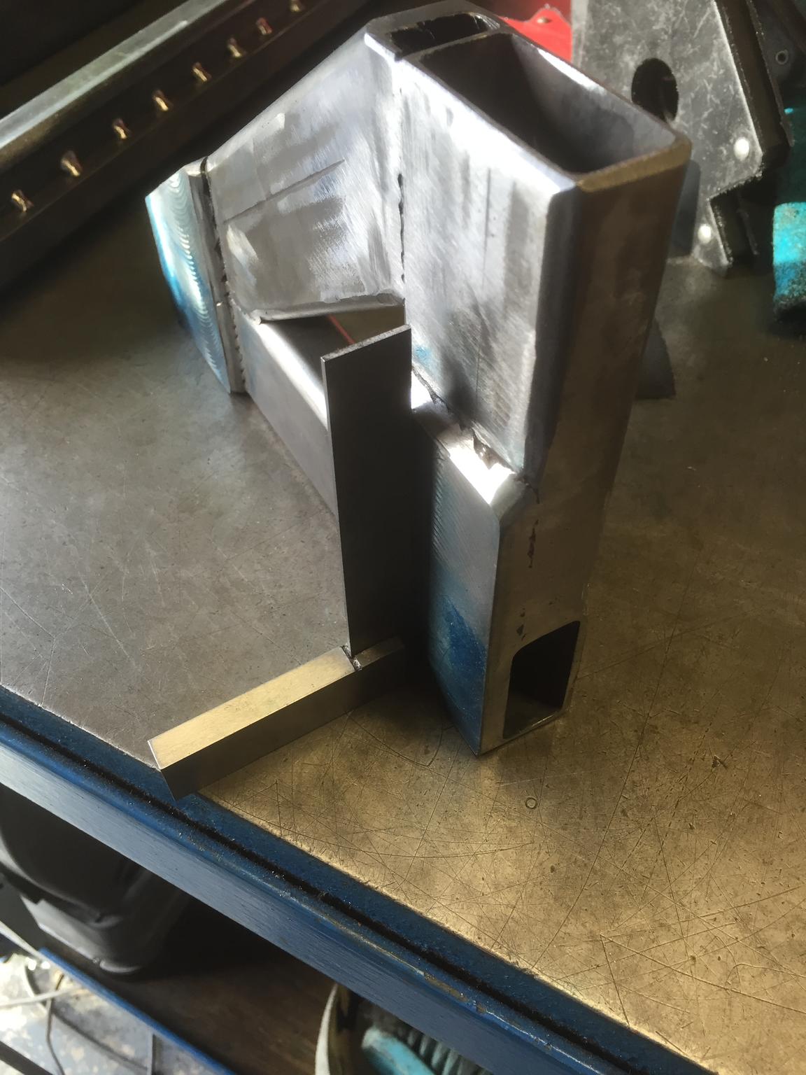

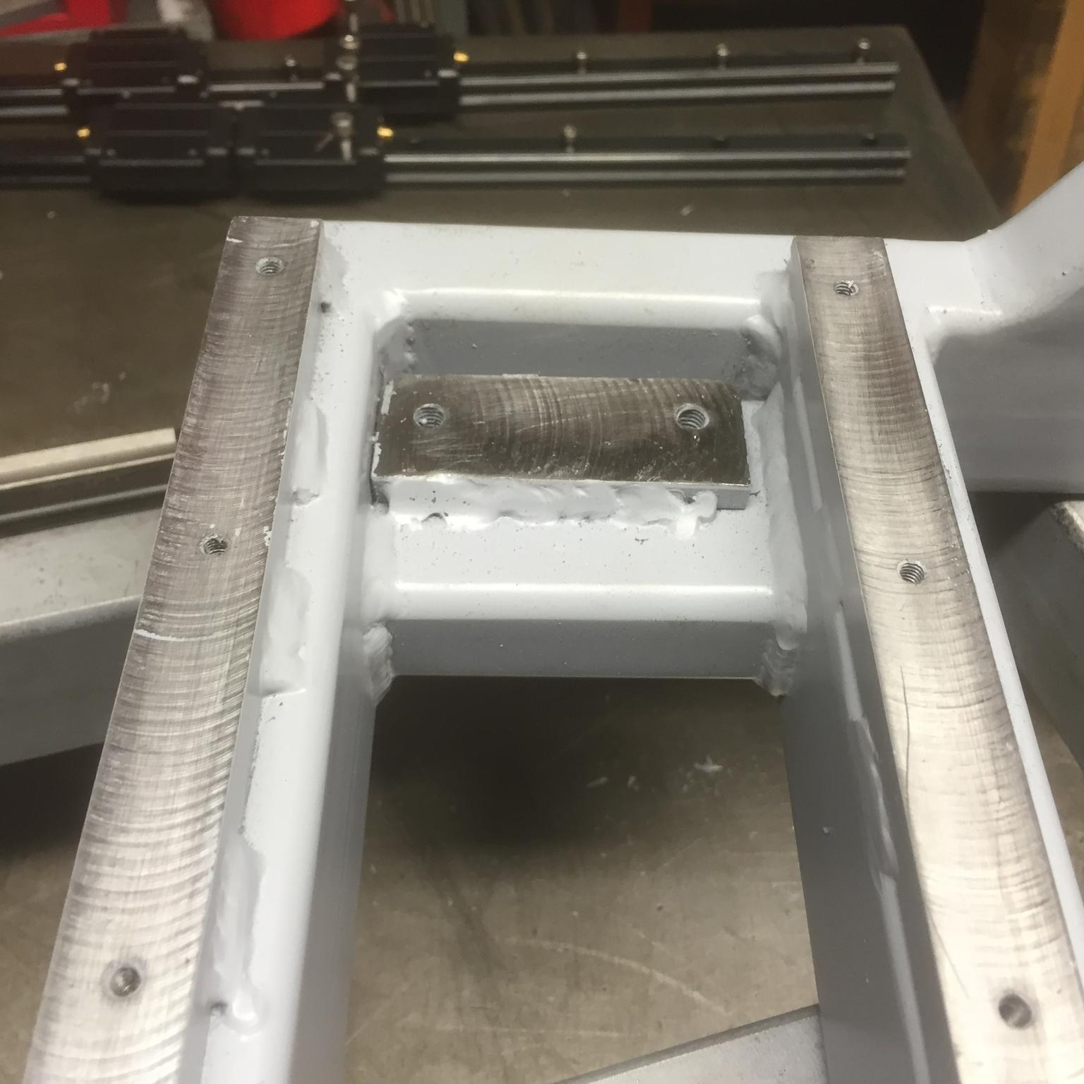

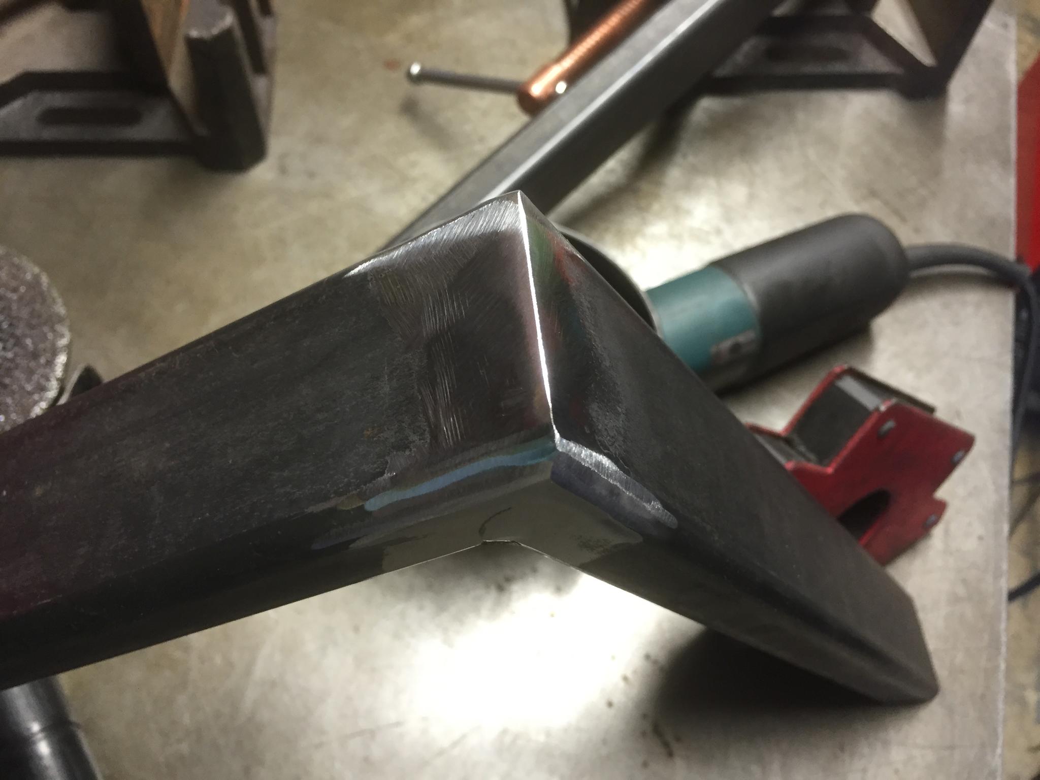

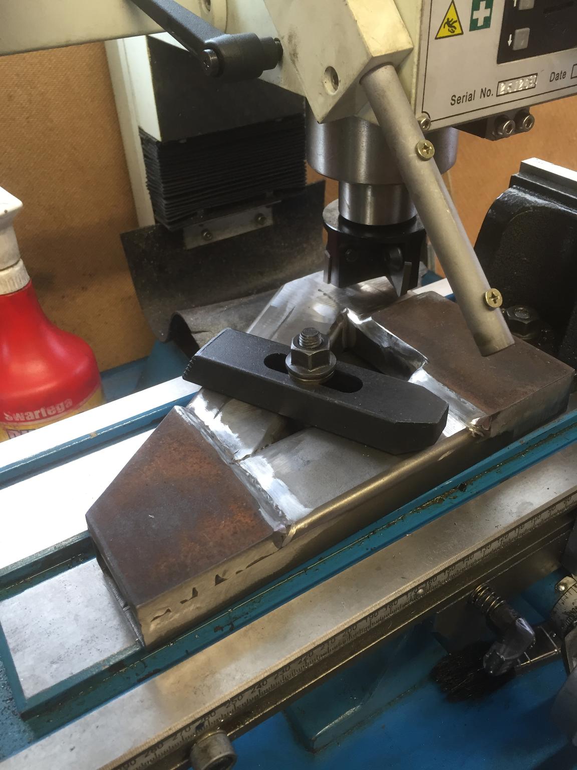

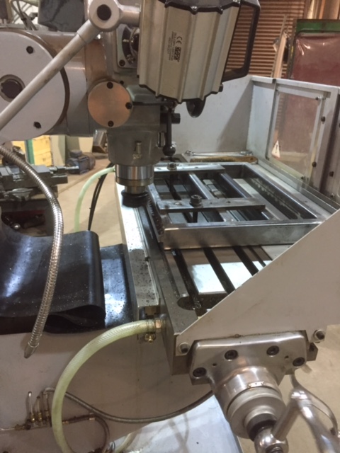

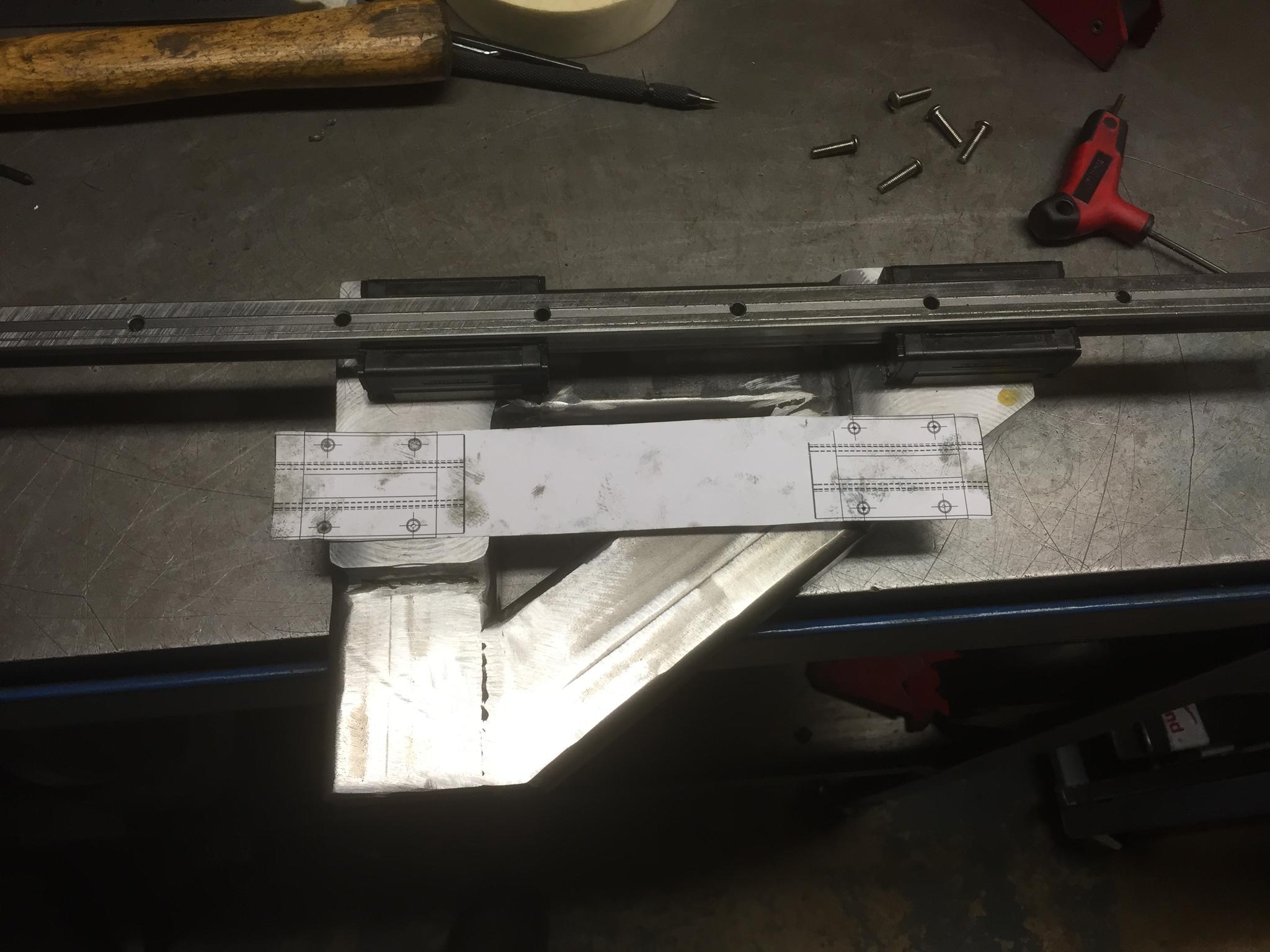

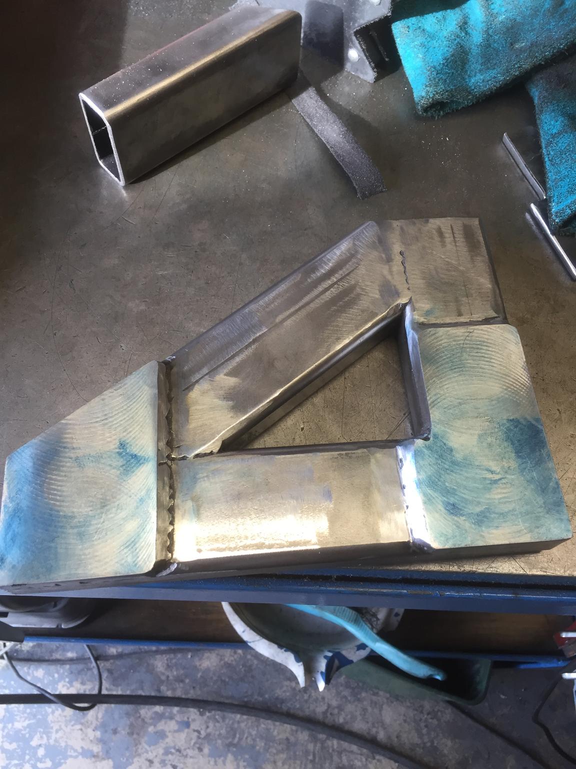

Another fabrication day.

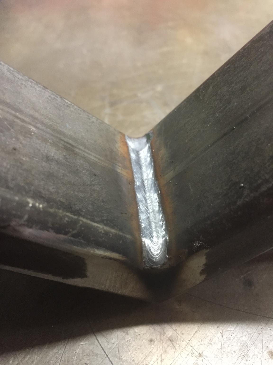

Done some welding, this time I used 0.6mm wire for trial. Have to say that I am happy with results as my profile thicknes is 2.5mm and other plates are 5mm at this stage.
Attachment 16770
Welding is all about heat control and avoiding distortion.
Here is my setting for 0.6mm MIG
Attachment 16763

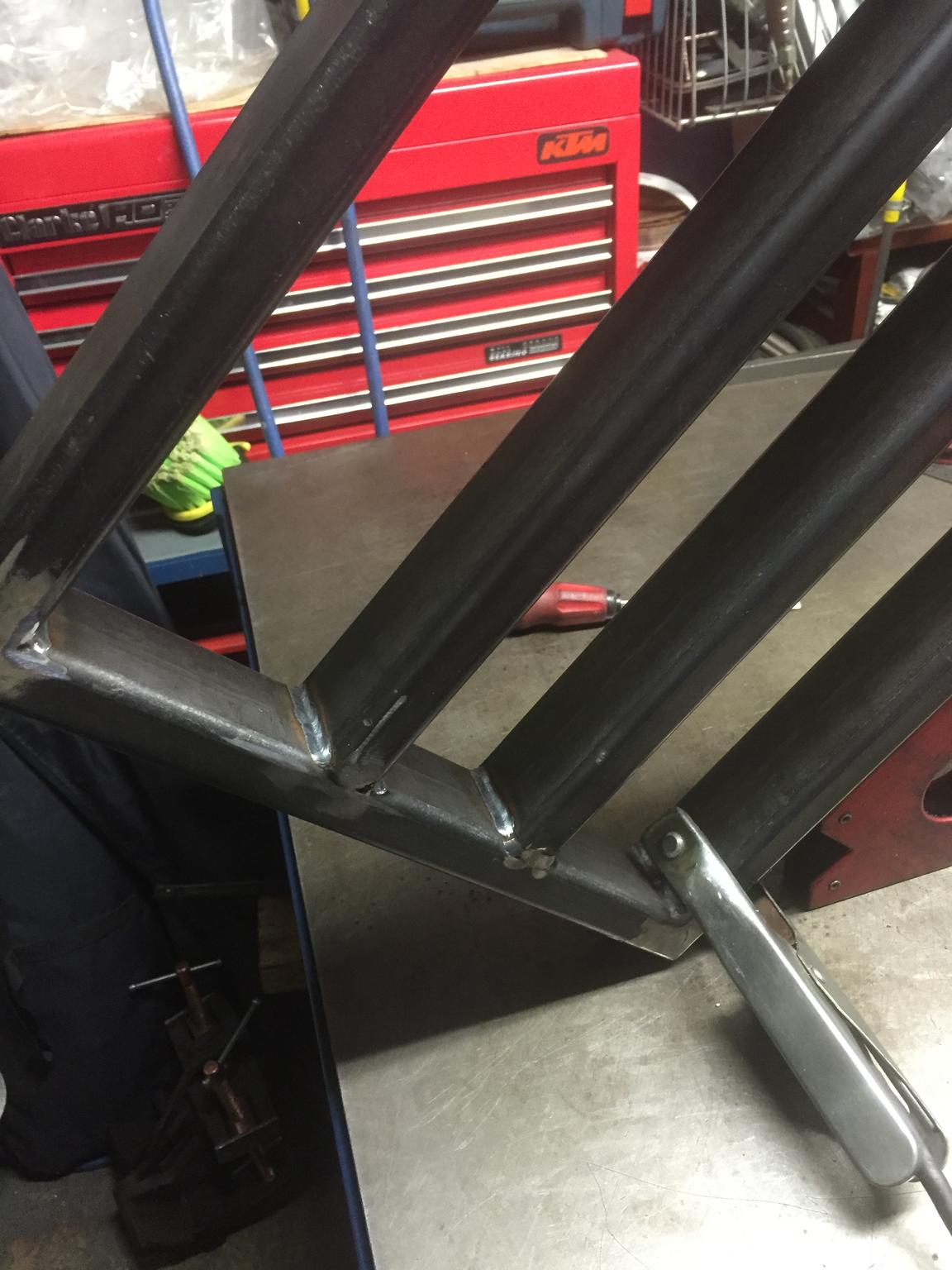

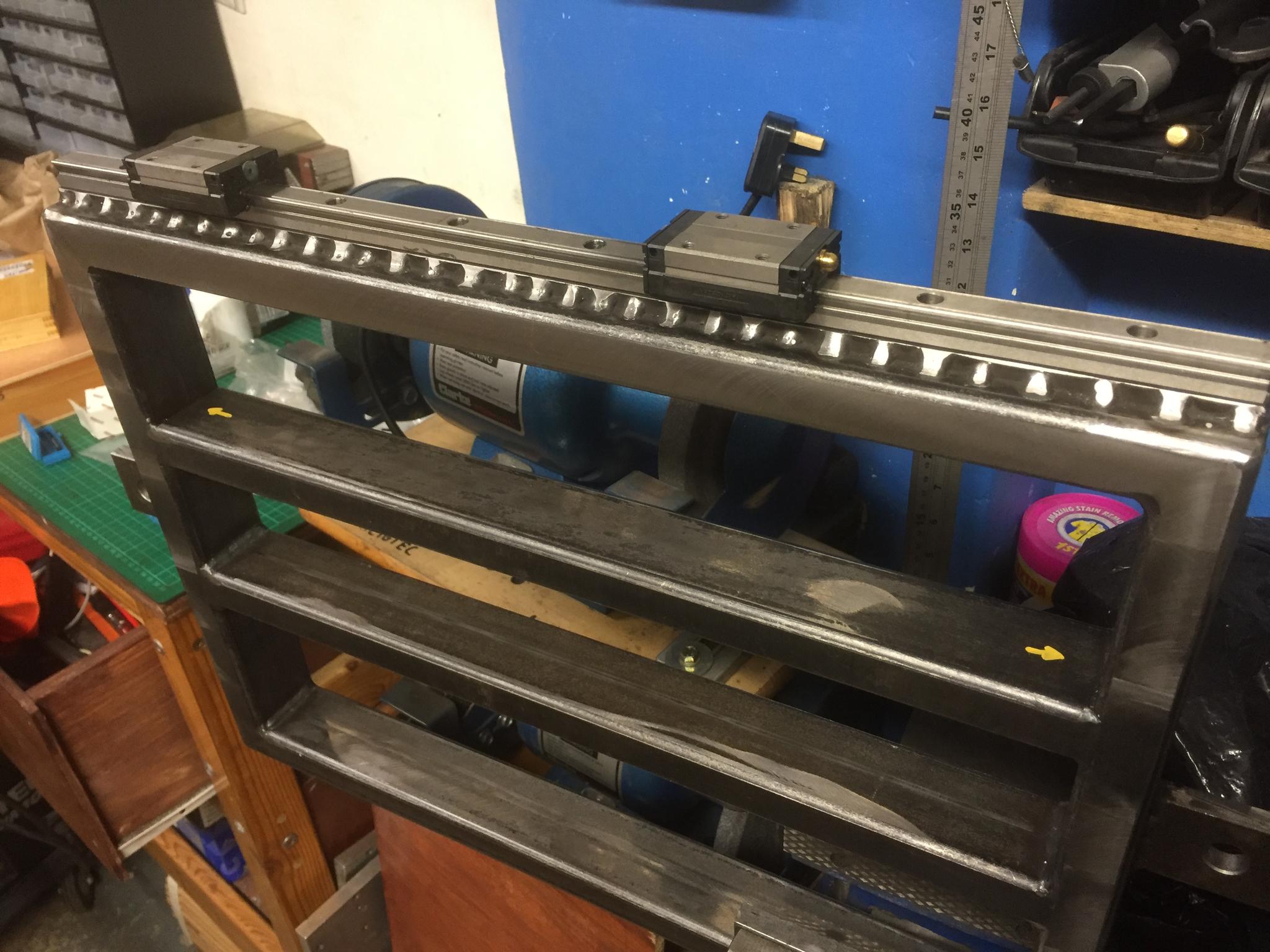

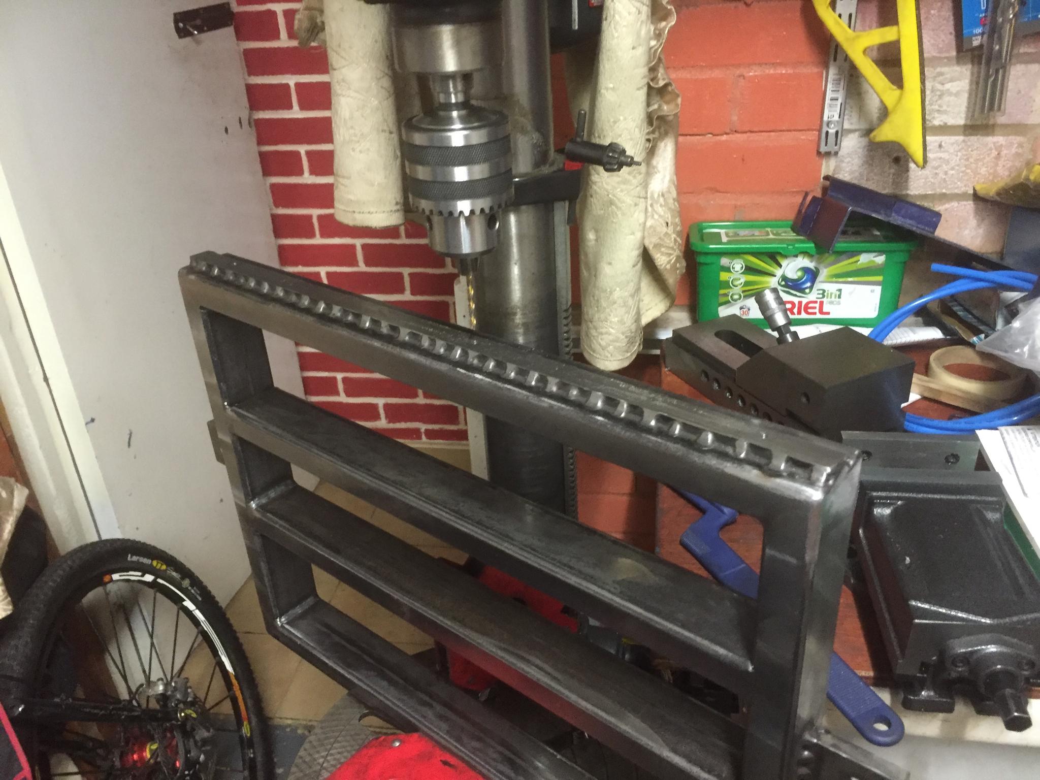

All major welding is done I believe. Cable chain-carier, table top, sensor will be bolted.
Here is some shots from today:
Attachment 16764Attachment 16766Attachment 16767Attachment 16768Attachment 16769Attachment 16771Attachment 16772Attachment 16773

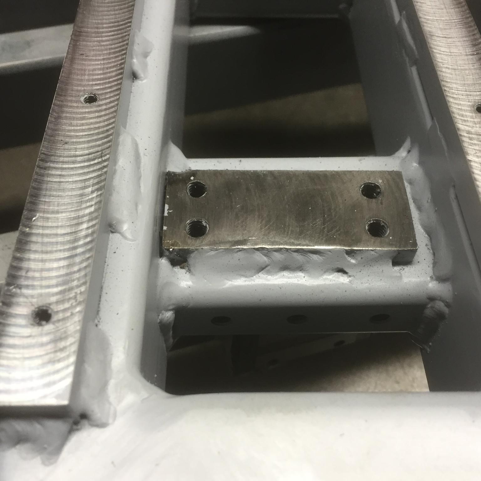

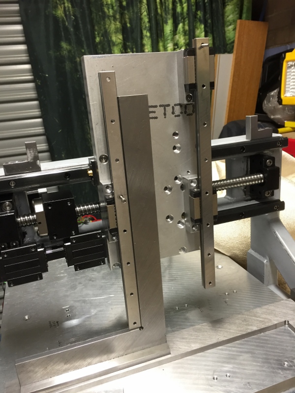

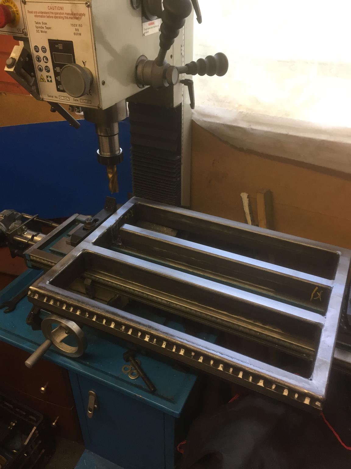

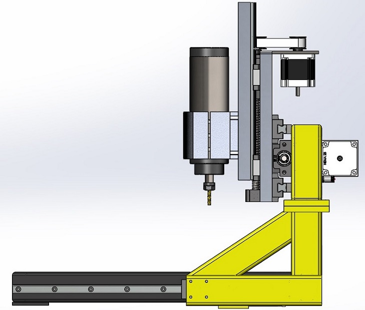

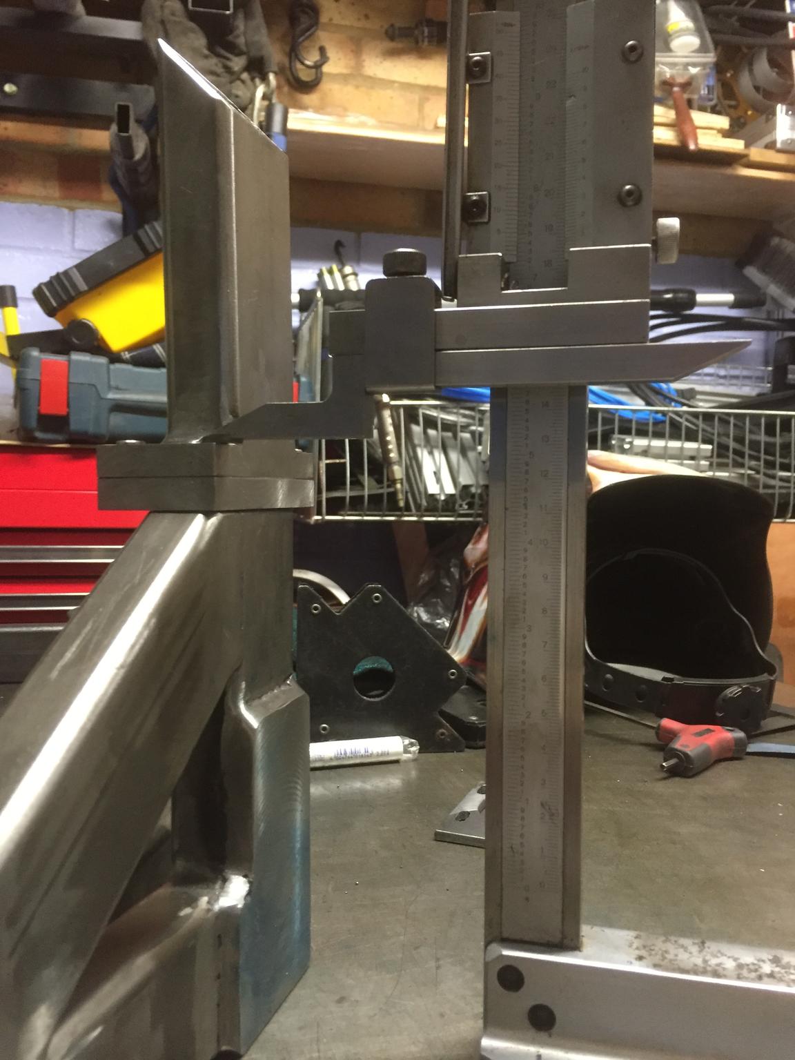

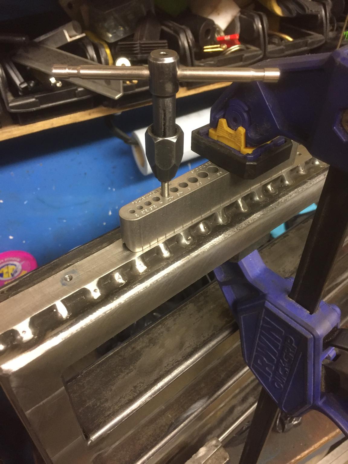

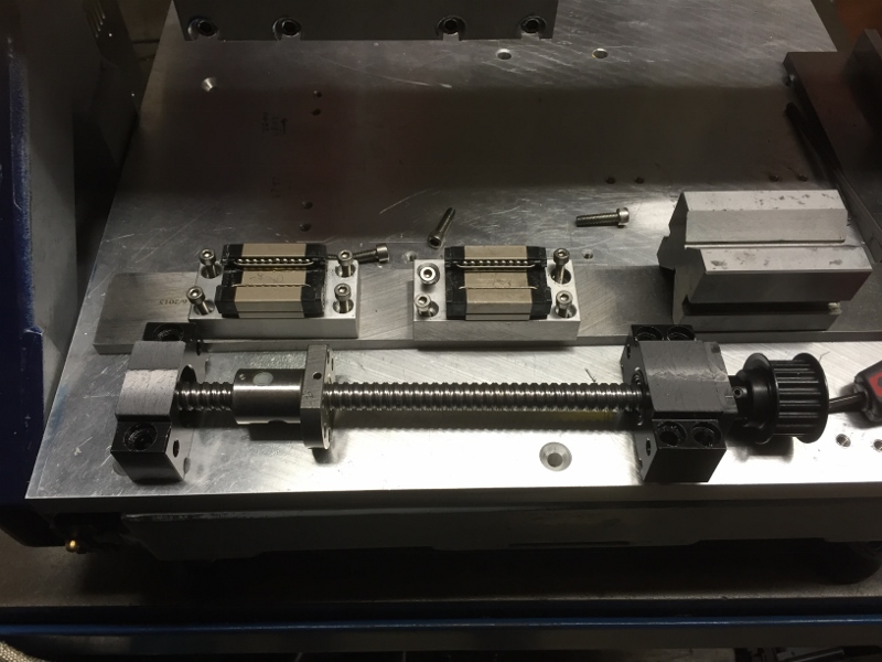

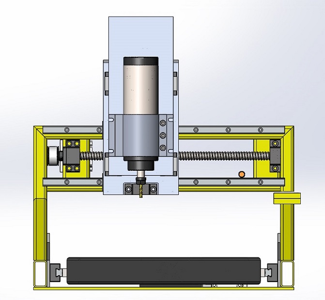

Time for Y axis drive. Gantry legs will be connected under the bed by flat steel 50x5mm.
I will use only one ballscrew for moving the gantry as this is desktop size machine (travel distance from left to right is 300mm, forward and backwards only 220mm).
I sacrificed 80mm of travel on Y for bigger distance between bearing block - stiffness won.
Attachment 16841
Had to fabricate Ballscrew nut bracket today - picture later.
Than I can center the ballscrew mount (front and back) so there is no tension on screw when turns backwards/forward.
A lot of steps in fabrication depends on previous - all related. Can not jump forward without doing something which have to be done first. Sometimes I loose the plot and do something what shouldn't be doing at that time like - pick up for sensors:
Attachment 16842Attachment 16843
or sensor bracket/s

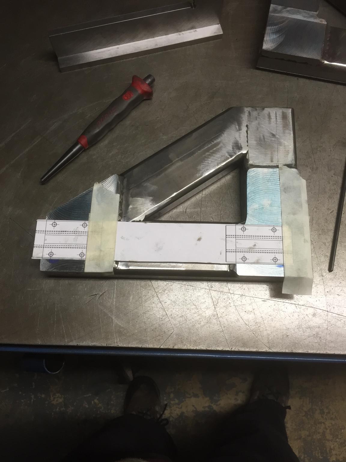

Thanks Jazz, SolidWorks helps a lot, I print the template before I drill any hole and cat any shape, use automatic puncher to be precise. Can not wait to the end.
Re: Desktop size steel welded router 3 axis
Tom J
Yep I do the same paper and Spray mount it's priceless.!. . I even do the same On cnc machine some times when cutting parts out of large sheet just to be sure they'll fit and not waste material or clash with clamps etc. I then write Tap sizes etc for holes on sheet to remove chances of error etc.
Tom J
JAZZCNC
Yep I do the same paper and Spray mount it's priceless.!. . I even do the same On CNC machine some times when cutting parts out of large sheet just to be sure they'll fit and not waste material or clash with clamps etc. I then write Tap sizes etc. for holes on sheet to remove chances of error etc.
Thanks chaps, for a desk based worker like me those are brilliant tips! I hadn't realised the benefits of an automatic puncher and I hadn't thought of printing a template. Now to see if the free version of Sketch-Up can print to scale? And find out what sort of spray mount to use?

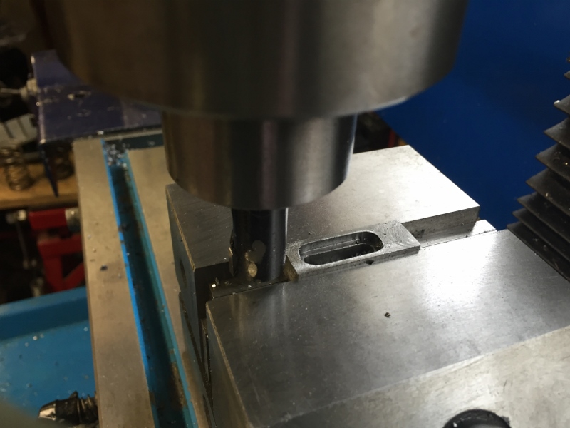

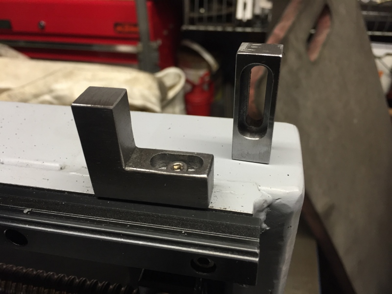

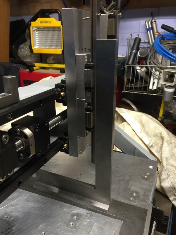

3 Attachment(s)
Attachment 16887Attachment 16888

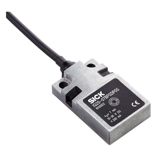

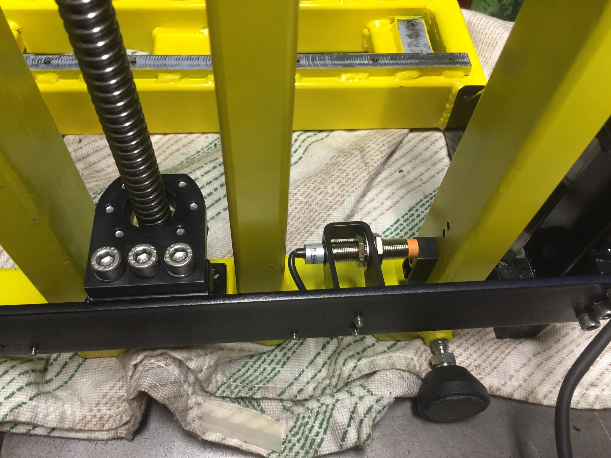

Got problem with proxy sensor in X axis - not too much room to fit.
Any recommendation for flat body type and 1-2mm range PNP NC like that:
Attachment 16889
I find the Round type better has they give more adjustment. Use traveling switch then you'll only need one per axis and it can travel with Z axis facing down there's plenty of room on back of there for a bracket and loads of room on top of gantry for targets.?

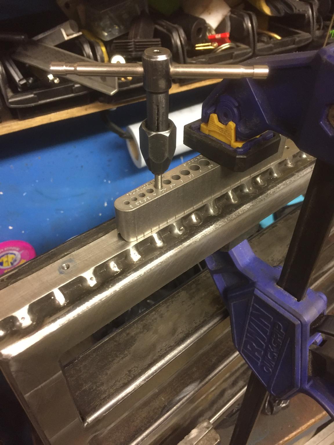

4 Attachment(s)

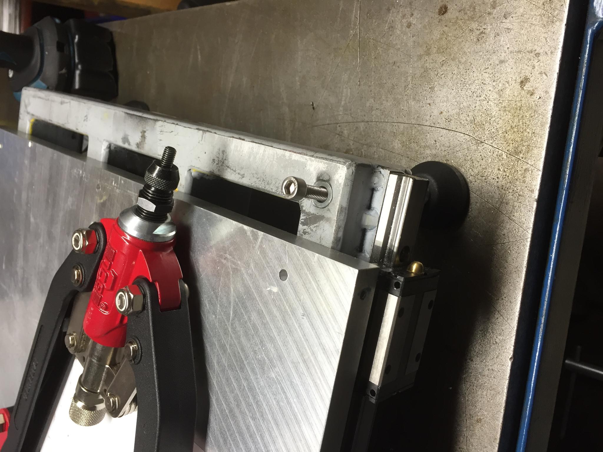

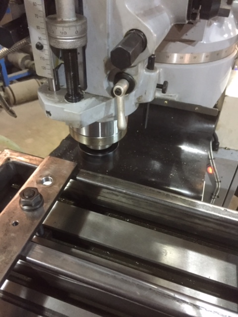

Got some old alu plate - enough for table
Attachment 17582
Bed profile was 2.5mm thick before. Now after surface planing is a bit less so I used thread rivet to fit the table top.
Attachment 17583
Attachment 17584M5 countersink bolts
Attachment 17585 One Y sensor for Home and Limit (PNP NC)
Ali plate will make a nice bed. Any reason you didn't put the proxy on the other side where it can't run into the stepper motor?
Yes Neil, here is the reason:
Attachment 17586cable chain took space on other side

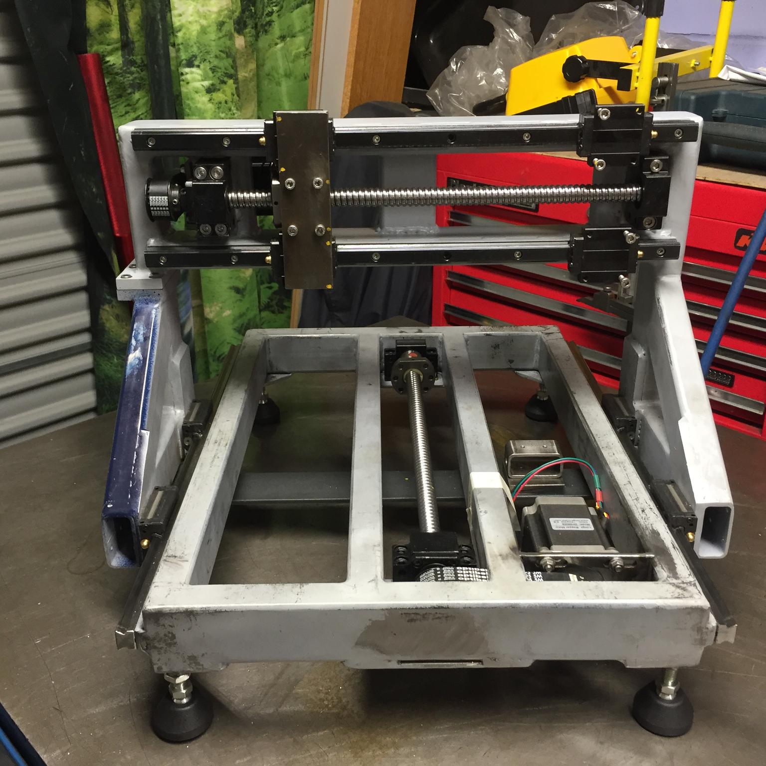

Black oxide kit used to blacken the steel parts - mostly mild or bright steel
Attachment 18575Attachment 18570
Now everything strip down for painting
Attachment 18573Attachment 18571
I use body filler to cover imperfection
Already lost patience and final result not brilliant
Attachment 18576Attachment 18577Attachment 18578Attachment 18579

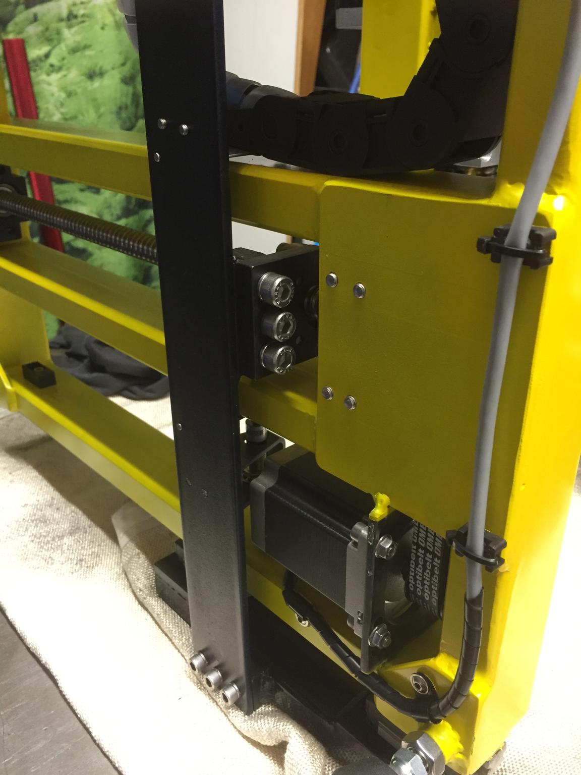

10 Attachment(s)
Looking good Tom.:yahoo:. . . . Now it's time to get dirty. .:onthego:
Tom J
Final look

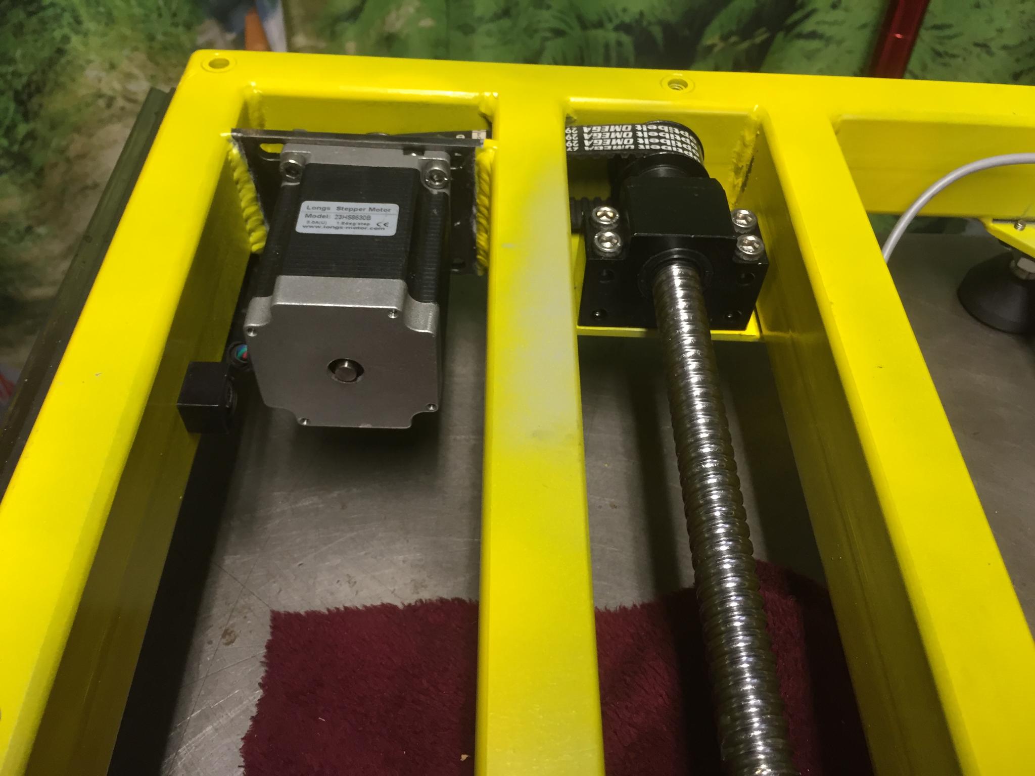

Still not happy with the speed of X axis. Motor had to be slow down to 1450mm/min.
Z and Y goes above 2000mm/min.
Today I run only ballscrew nut with everything loose and still stalling.
I remember noticed that on dry test (driver - motor) one was stalling at much lower speed.
My motor is 23HS8630B with 1.6mH phase inductance, powered by 24V only, 6 cables (4 used only +A-A+B-B)
I use 4 wires so winding are in series 0 is not in use
Attachment 18750
I will keep it connected that way do not want to sacrifice torque at low speed, so need more voltage.
Am I correct?

I use DM542, they can handle max 50V, so I can not safely plug in to my big box
Attachment 18751
Ok well can you try it at 45V and see how it goes
... will post results with 41.5V, that what I've got from torus trafo 2x30V 2x7A, after rectification voltage went up nicely.
