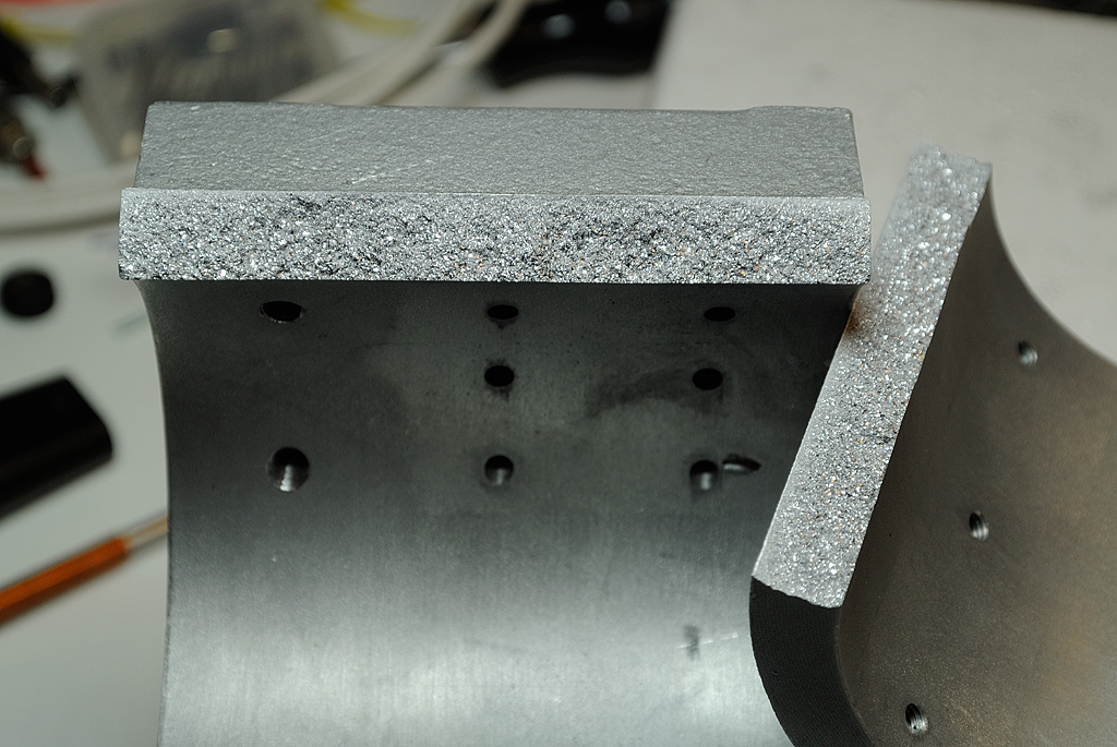

Can i expect from equal aluminium angle 90 degrees on the outside? I was so sure that is 90 degree, so even did not check it when was buying it today. Took it home decided to check the squareness it and it is less than 90 degress.. Tried to google it out, and here is what i found: "A 90-degree angle is certainly the most commonplace for aluminium angle stock, but there are products which have less than a 90-degree bend".
So maybe i was lucky to get that with smaller angle or it is common not to have proper 90 degrees angle? I saw someone was using those angles in this forum to bolt together the frame, wondering if there were some issues with that?

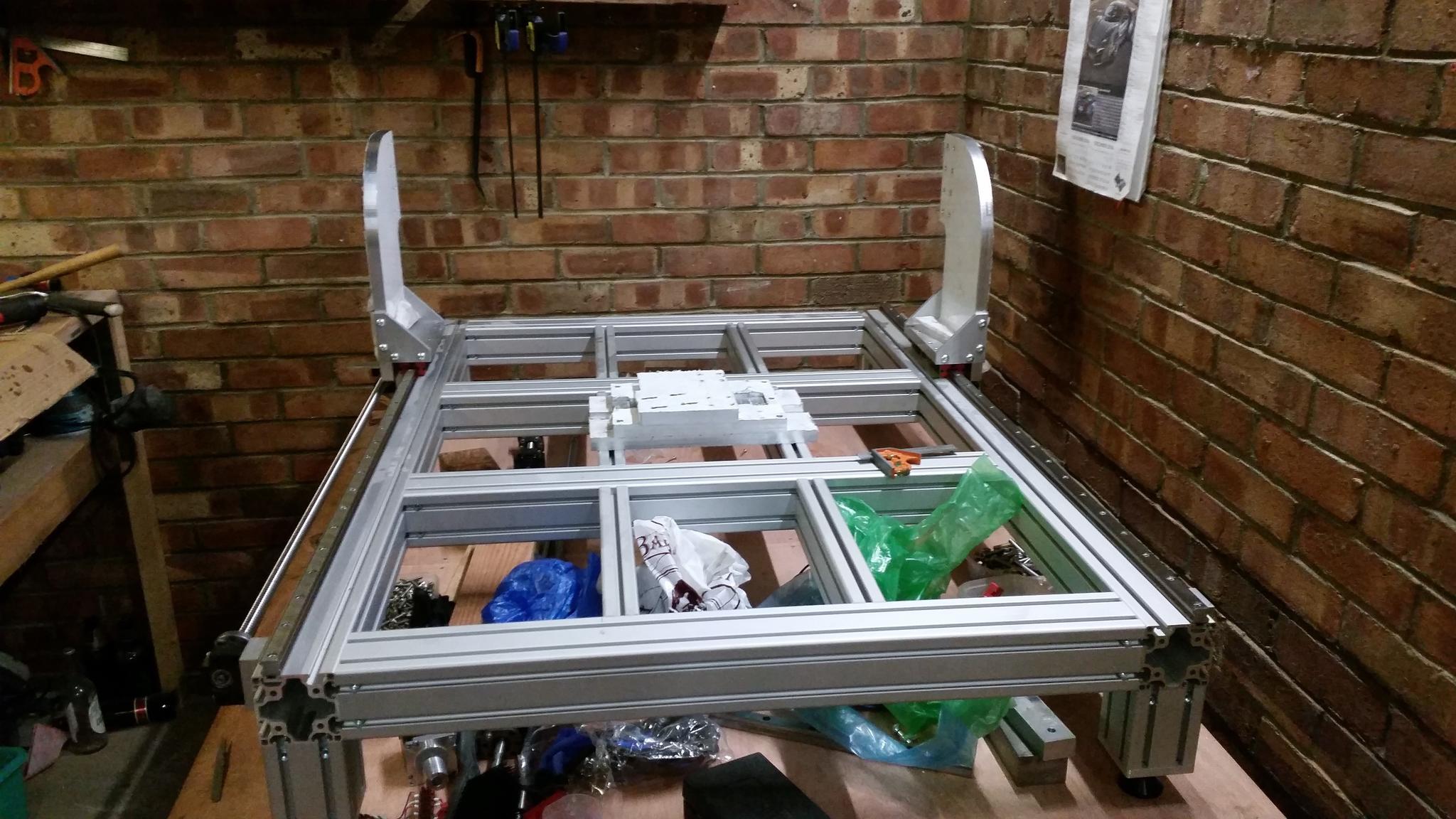

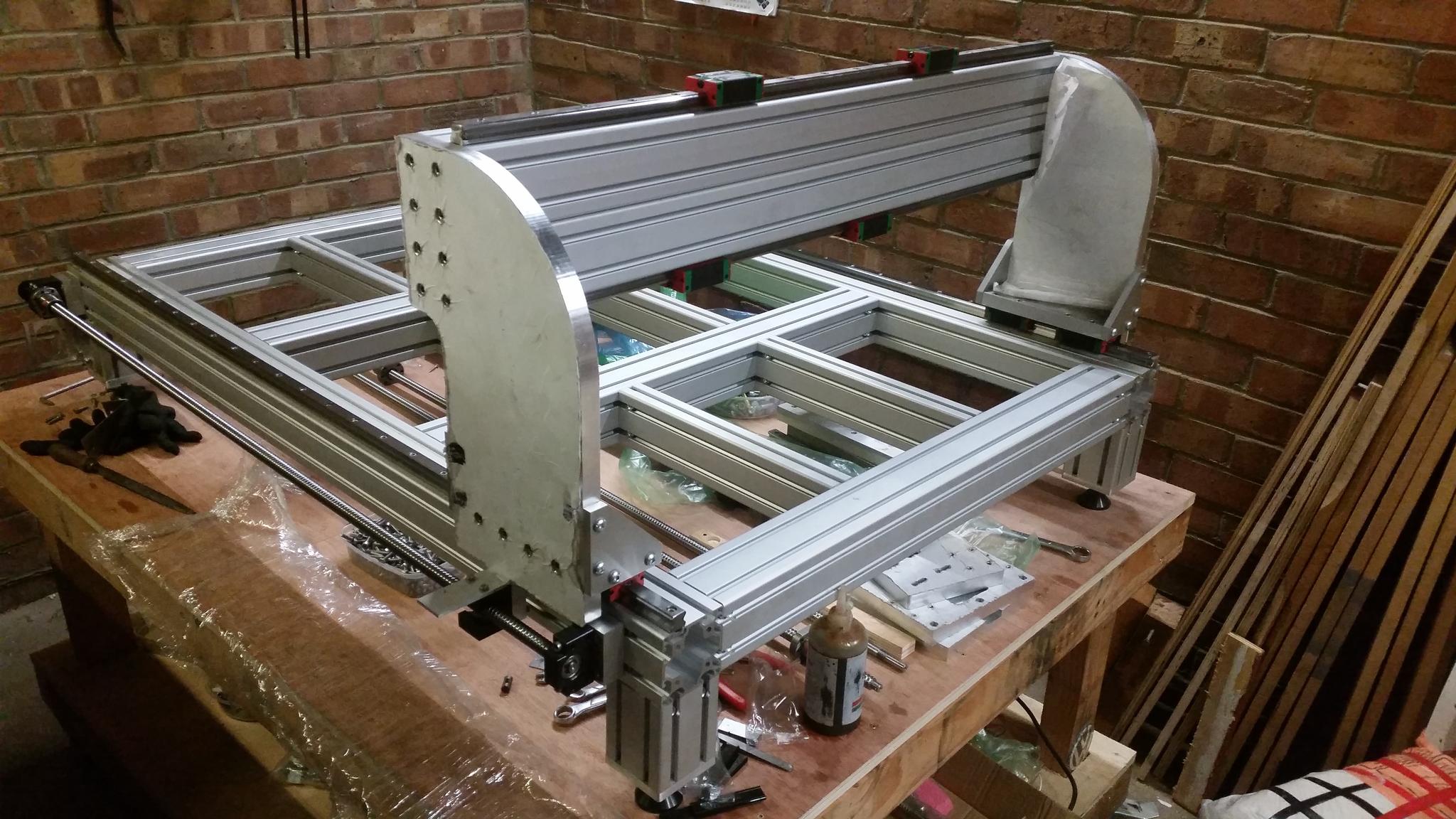

Hello. Its been a while after my last post, but things kept moving a bit. Since that got aluminium plates, simple ones drilled and and tapped myself , more crucial parts like gantry sides, z axis plates, motor mounts will be machined by our guru JAZZ.
Attachment 20441Attachment 20442Attachment 20443Attachment 20444Attachment 20445Attachment 20446Attachment 20447Attachment 20448Attachment 20449
Then built a bench for machine to sit on Attachment 20450 and started to lay the frame profiles Attachment 20451 after drilling holes for profile fixings i put them together and here is my base of the machine Attachment 20460Attachment 20454
After that folowed rails, cariages, plates, ballscrews, pulleys
Attachment 20455Attachment 20456

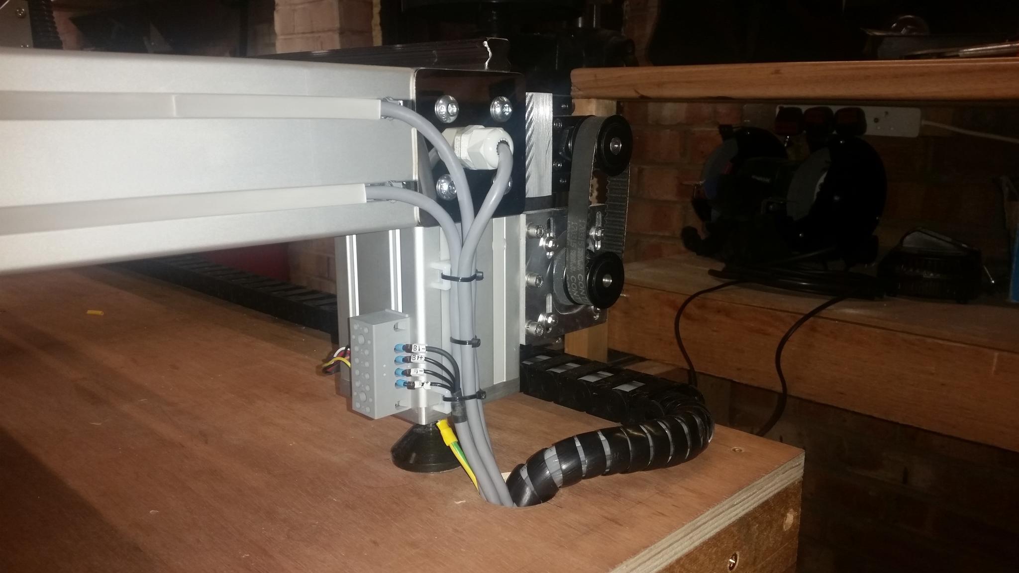

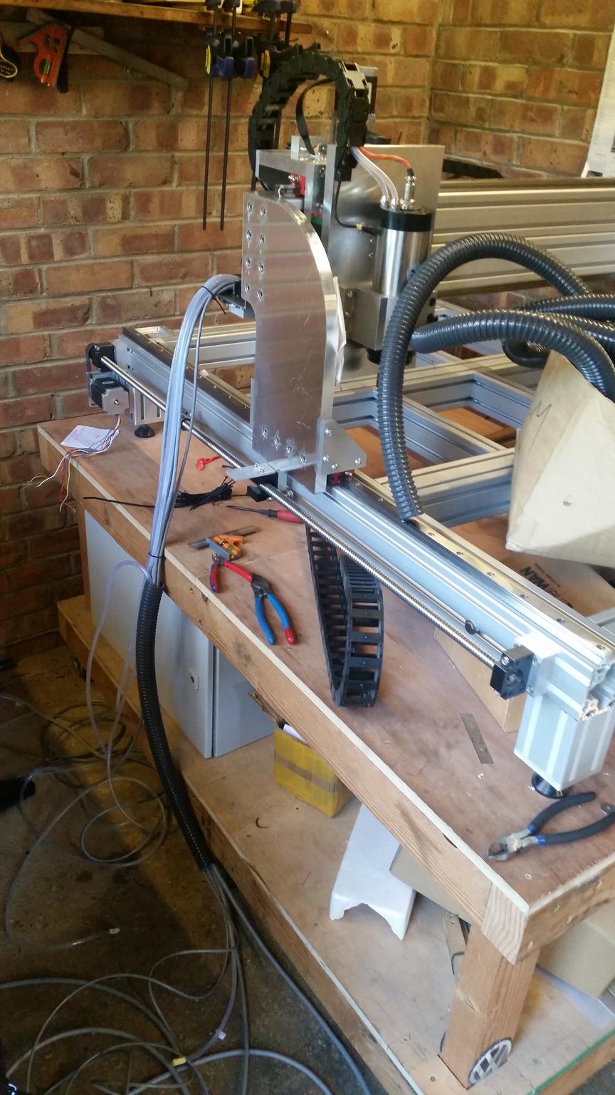

Hello. Coming back with some updates from my build.
So the news shortly are that mechanically machine is done, and partially wired. Now it will be time for the electrical drawings, laying out components buying some of them, mounting everything into electrical boxes..
Some progress photos:
Attachment 22625Attachment 22626Attachment 22627Attachment 22628Attachment 22629Attachment 22630Attachment 22631Attachment 22632Attachment 22633Attachment 22634Attachment 22635Attachment 22636Attachment 22637Attachment 22638Attachment 22639Attachment 22640

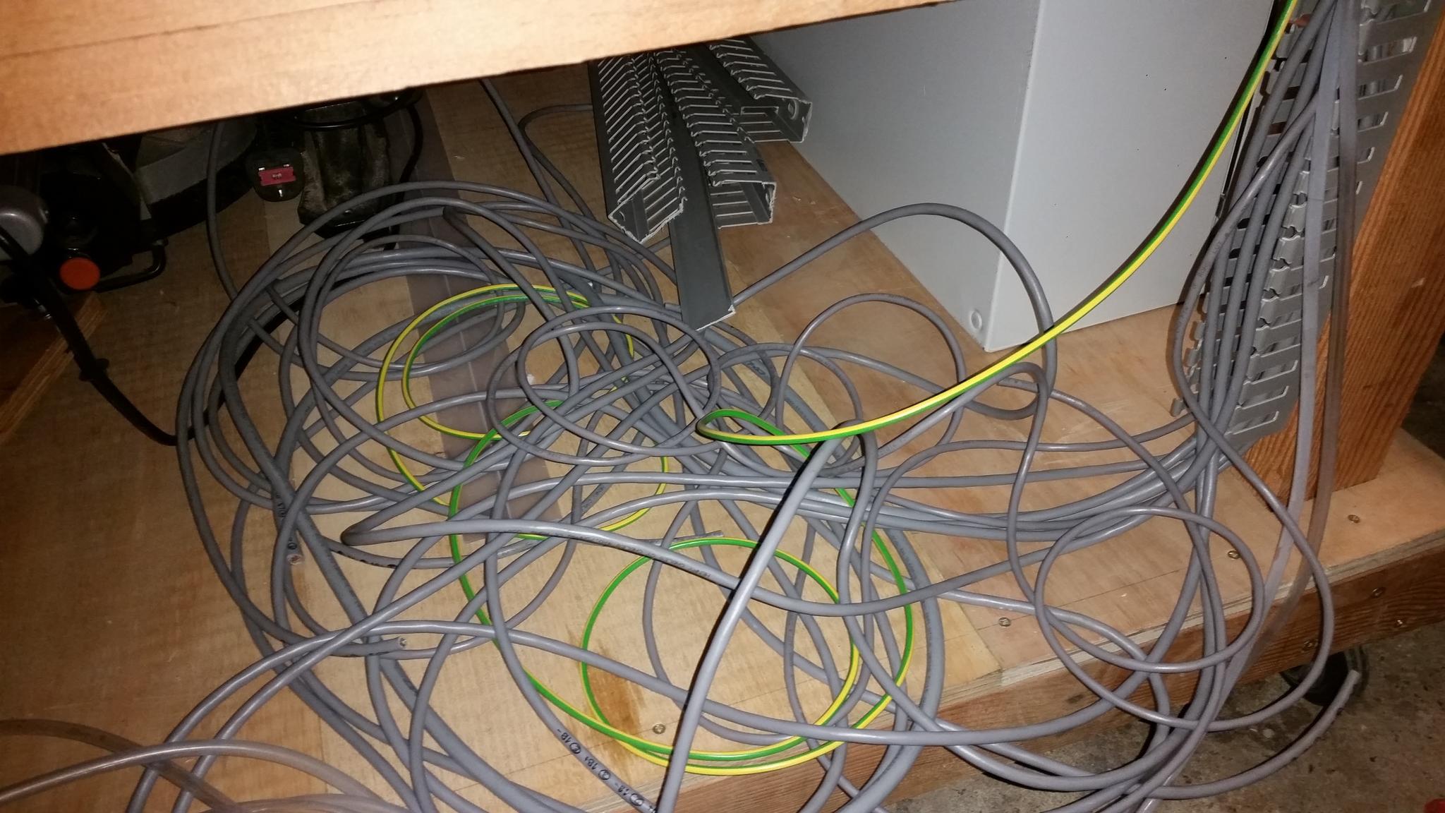

At the moment I ended up with some cables which will need to go to two control cabinets. Two because one is not enough which I got initially, so I got another one the same size, so I am thinking to have mains voltage distribution, for pump, powers supply, and vfd in one box and all the electronics to have in another one. Attachment 22641Attachment 22642
Now I will be doing a bit more reading about electrical side, try to draw some drawings. Have couple of questions for now
