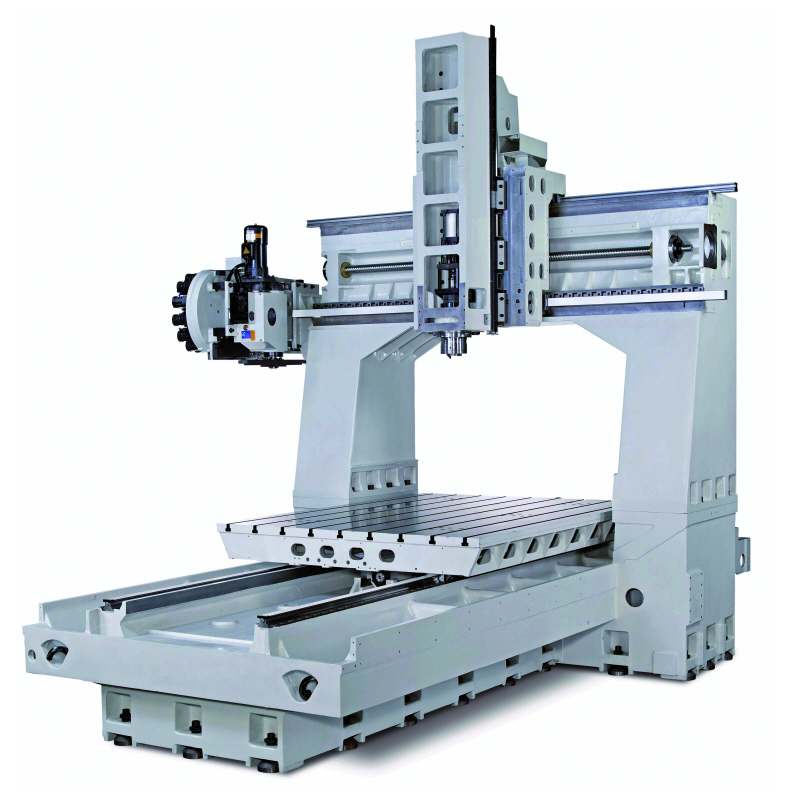

You seem responsive to feedback/criticism so I'll give you my two cents given I've been thinking of a very similar project.
First of all it really will be too 'solid', there isn't a need to make the frame so large with cavities to reduce the weight. Any cavity you introduce to the frame is just another process that needs to be worked out, why make it more complicated than it needs to be?
The A frame you've introduced will indeed be stronger but if you ever need to machine something that overhangs the table it may interfere with the frame. All commercial machines I've seen are vertical to make best use of the available space, if any extra strength is required it can be put at the back like your original design showed. It's a less 'efficient' use of material in terms of outright rigidity but is the best solution to the problem.
Attachment 18477
This is a pretty typical design, as you can see not much is allowed to get in the way of the workspace.
UHPC/EG may be weaker than steel and cast iron in every way, but it's also 1/3 of the density and less expensive. Use this to your advantage.
You appear to have the Y axis rail spacing as wide as possible, is there a good reason for this? If you bring them closer together you can create a more rigid table while at the same time reducing the width needed for the base of the frame. less width = more thickness = more rigid frame (for the same weight).
I think you really should look into getting a proper spindle, they really do make the biggest difference. Why cheap out on the thing that matters most? There are options available. I think a good question to ask would be, do you really need a high speed spindle? A 10,000 rpm milling spindle will be far more rigid and can make up for the slower speed by using bigger tools. Datron often use single flute tools, one of these at 30,000 rpm is similar to a 3 flute tool at 10,000 rpm.
I look forward to seeing how you progress, and remember there's more than one way to skin a cat. There's the right way, and there's the way people say it should be done.
Attachment 18477
Cheers,
Fenza
