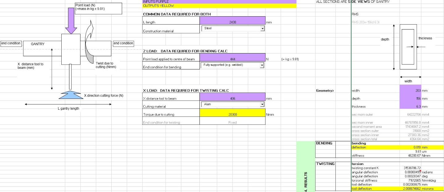

Sometimes I forget about the speed of the screw also being an important factor. I put together a little table for resolution based on ballscrew, based on my calculations I need to go with a higher pitch or up the gear ratio to keep the speed ~80% max. Upping the ratio of course hurts resolution so Im looking for a 20 pitch screw. Higher pitch also helps keep the ballscrew speed down, but of course hurts resolution per mm.
Attachment 17903
Thoughts on this?

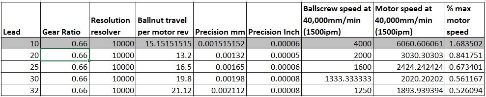

Alright new table now that I got the gearing correct the ballscrew and motor speeds were correct but I took the ballnut travel per motor rev the wrong way.
Attachment 17904
So based on these numbers still looking at 25mm lead screw. With a ratio of 2:3
Ballnut travel per motor rev 25*0.66 = 16.5mm
Precision mm = 16.5/10,000 = 0.00165 (is this real? i.e. with a quadrature resolver will I truly get 10,000 counts per motor rev?)
1600 rpm ballscrew speed to get to 40,000mm/min (~1500ipm)
Motor speed of 2424rpm (67% of max motor speed)
So am I looking good here? The precision seems great and the speeds would be very acceptable with some headroom on the motor speed.

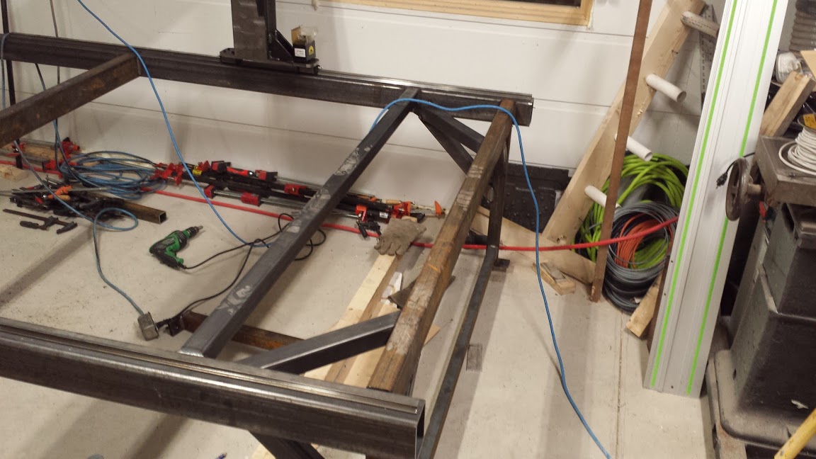

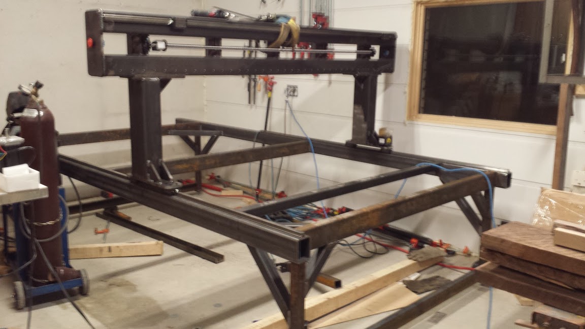

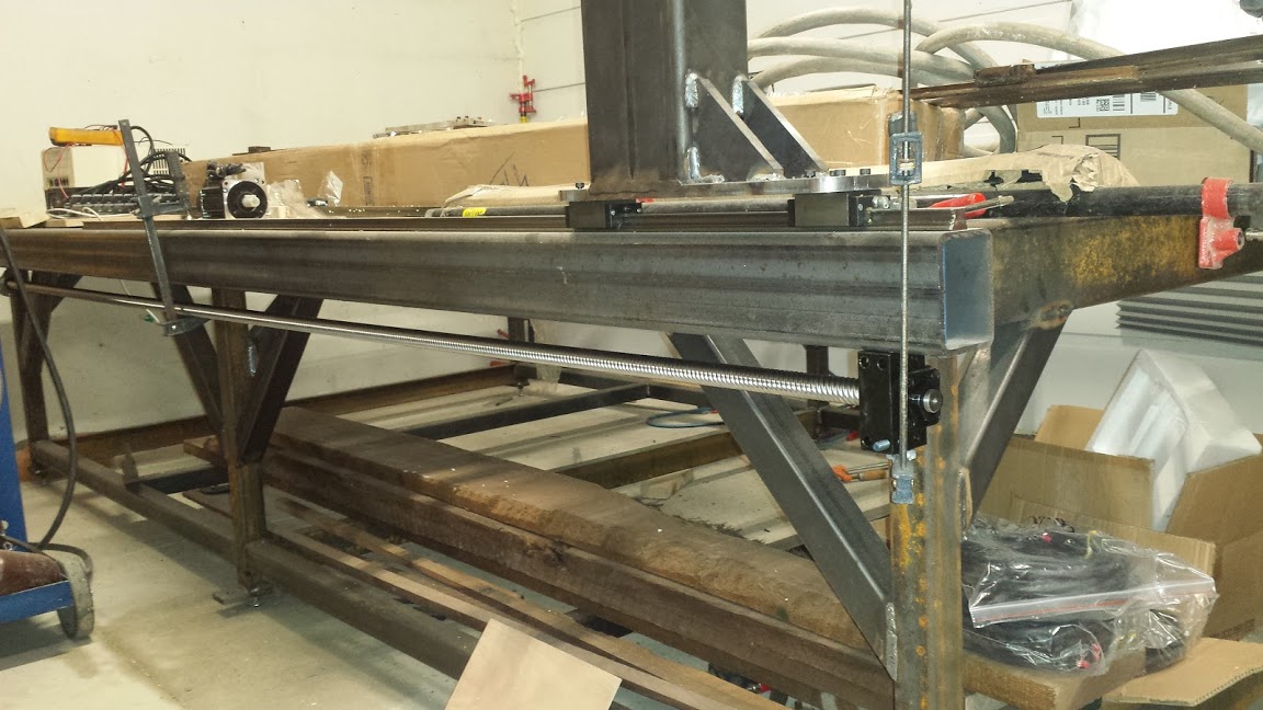

Got a little more done on the frame, havent had as much time as I would like in the last few days. My bed is 16 inch on center and I decided to brace in between each of the bed cross members only the first ones in so far.
https://lh3.googleusercontent.com/qX...Q=w547-h971-no.
https://lh3.googleusercontent.com/vc...=w1727-h971-no
Ballscrew
I need to finalize my plans for the X axis ballscrews so I can make mounts for them. Then motors mounts.
So a couple questions -
Do the numbers for the 2525 screw look good and make sense? On this long screw should I go with fixed:fixed mounts, I have read that this can stiffen things up a bit for a long screw.
Like some of the big guys do, can I get away with intermediate supports along the ballscrew and drive the screw? Or go the rotating ballnut route?
Do I even need the belt ratio on the X axis ballscrew? Would the motor speed be to slow without the gearing (~1600rpm at 1500ipm)? If I spin the screw, I could go direct drive with a 0 backlash coupling. Not that belting is all that difficult to implement it just takes some complexity out if I go direct coupled.

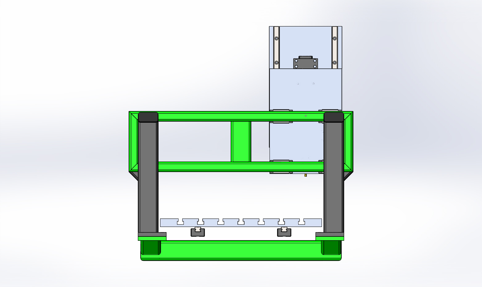

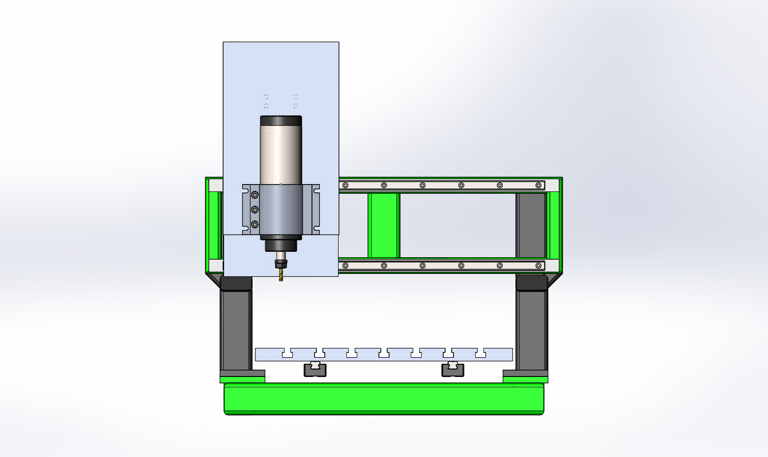

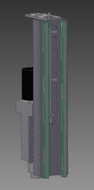

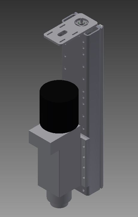

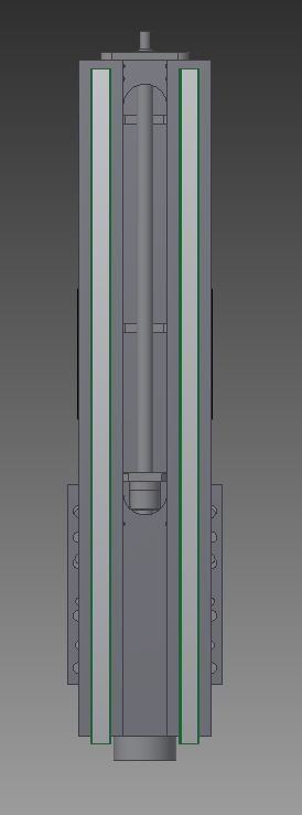

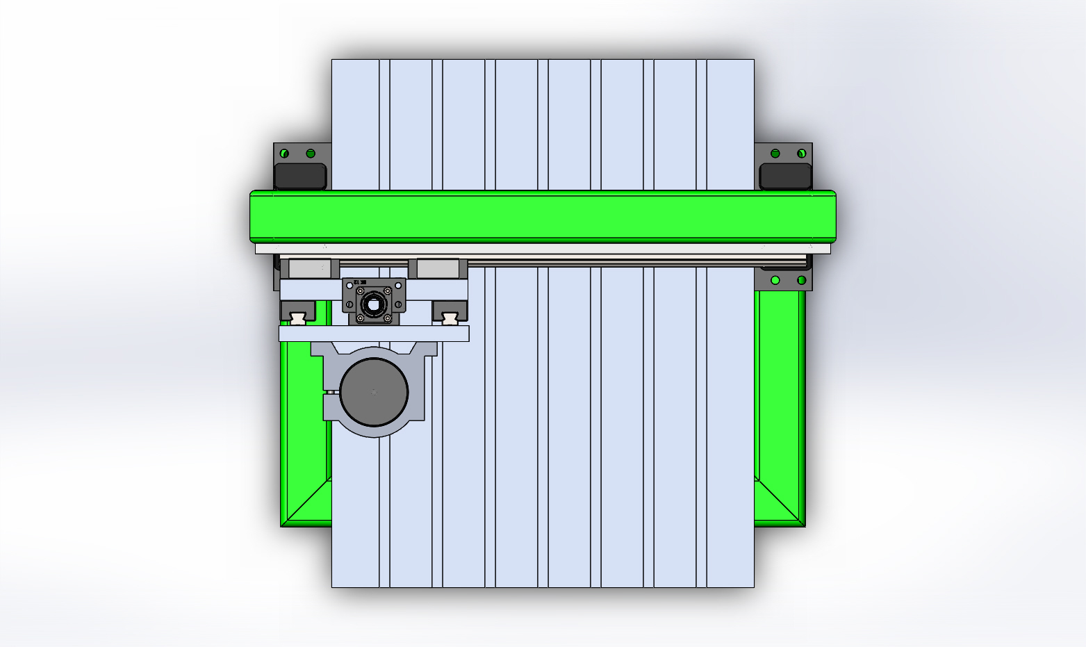

I think this will be my final Z axis design. 20 inches of travel with the ballscrew inside a 3inch x 5inch x1/4 wall box tubing. I have added supports to the internal of the box tubing to add strength and support the tubing when I cut the large slot on the backside for the ballnut.
I think this will keep it pretty compact and also plenty strong. As always comments are appreciated.

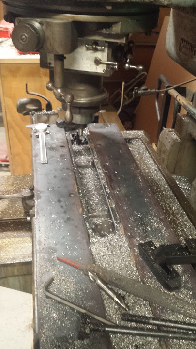

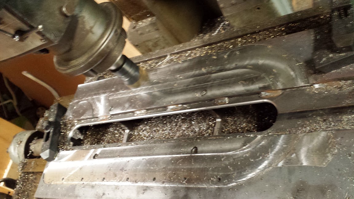

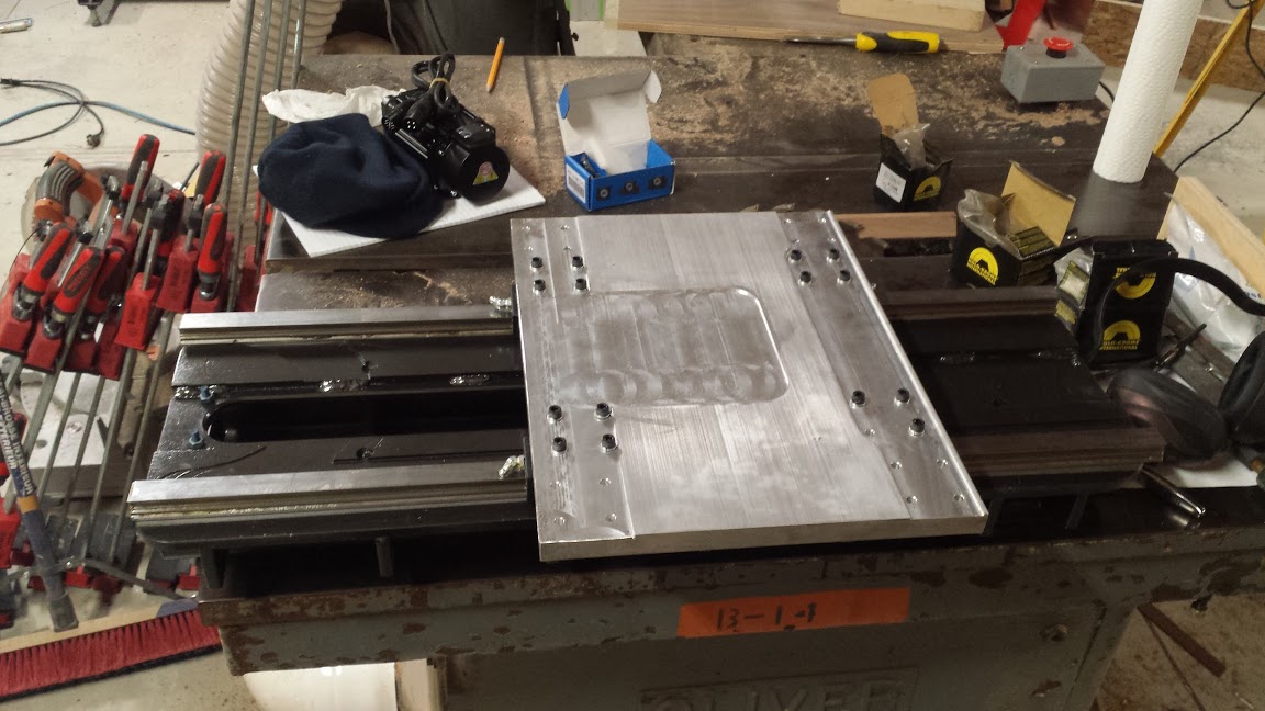

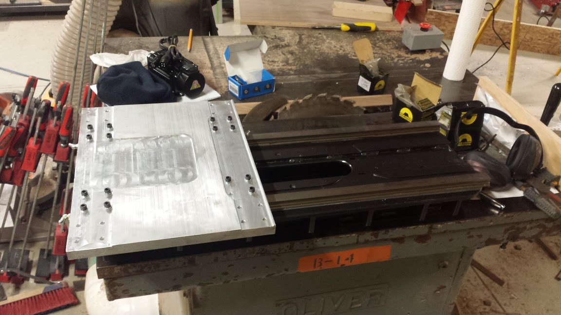

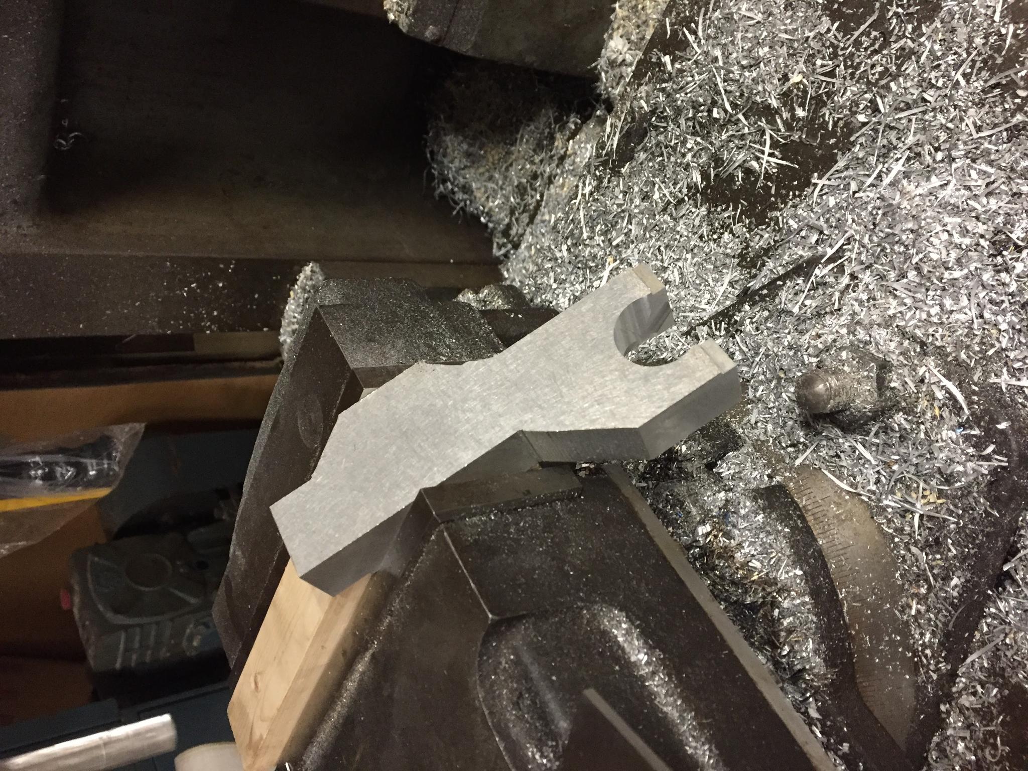

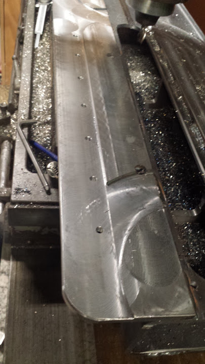

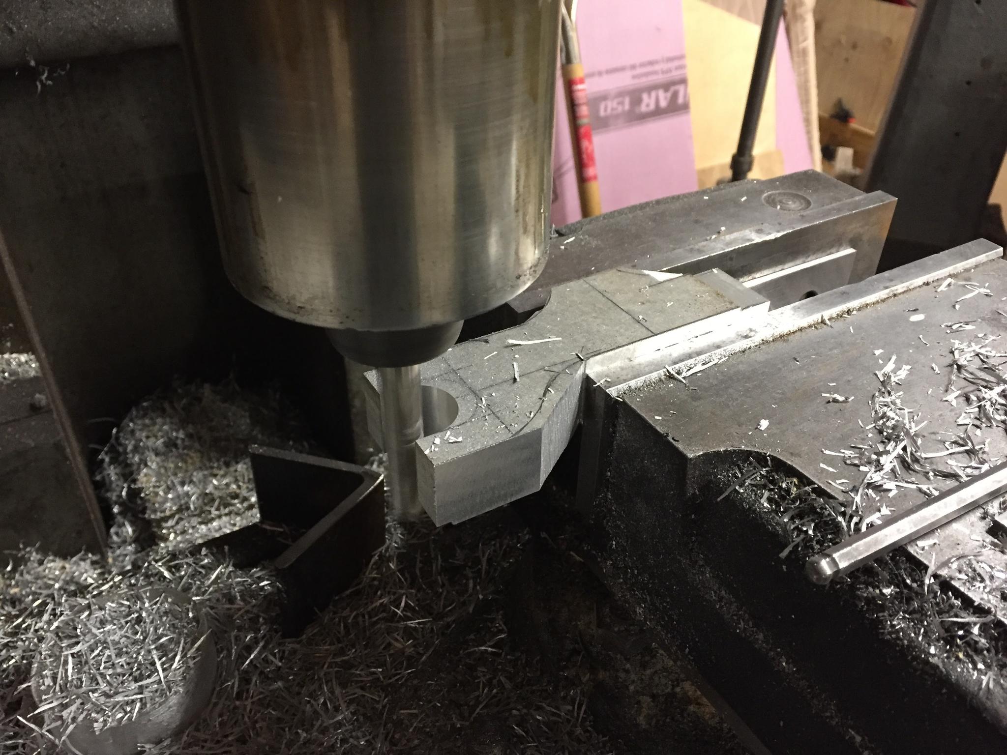

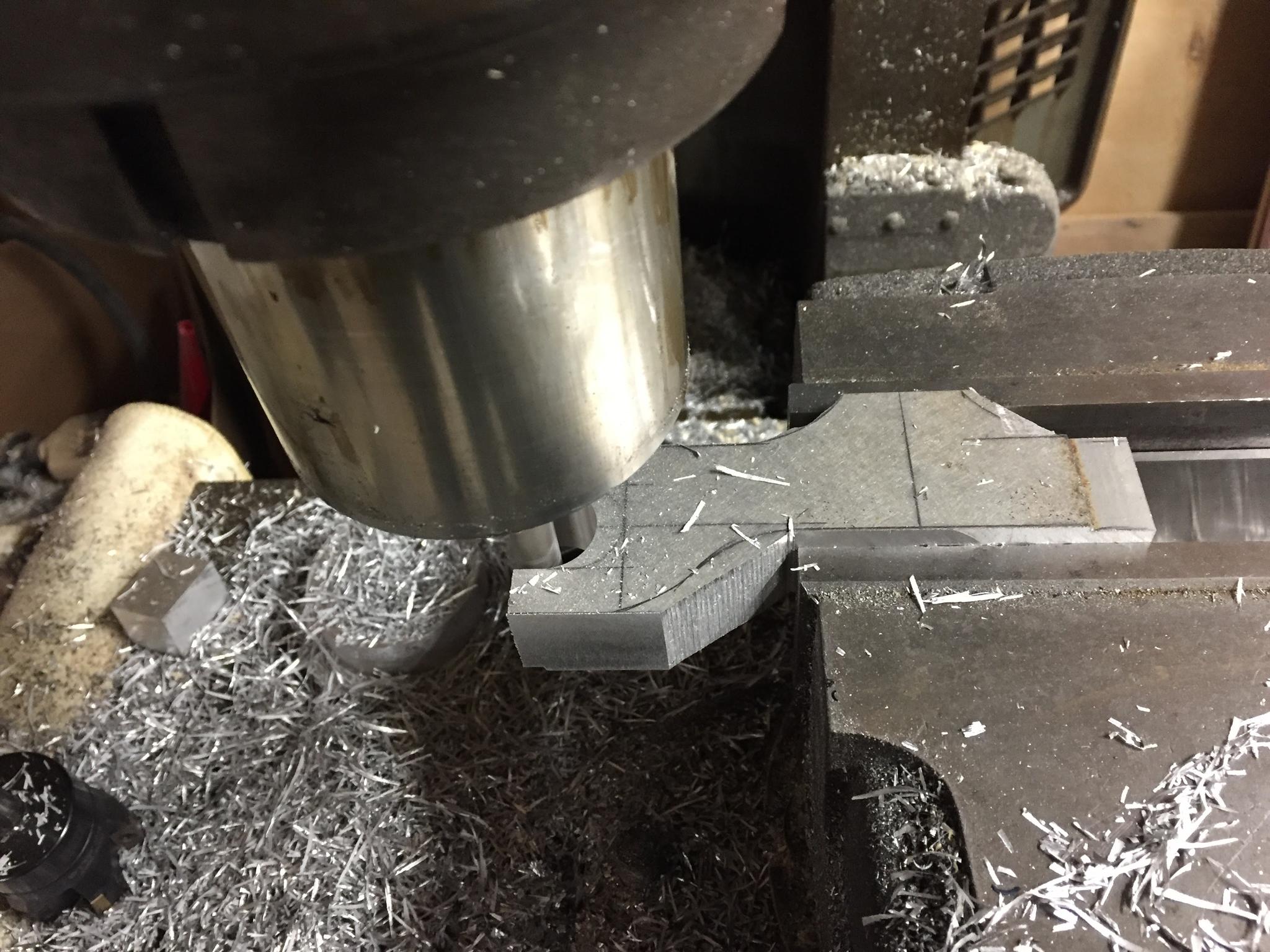

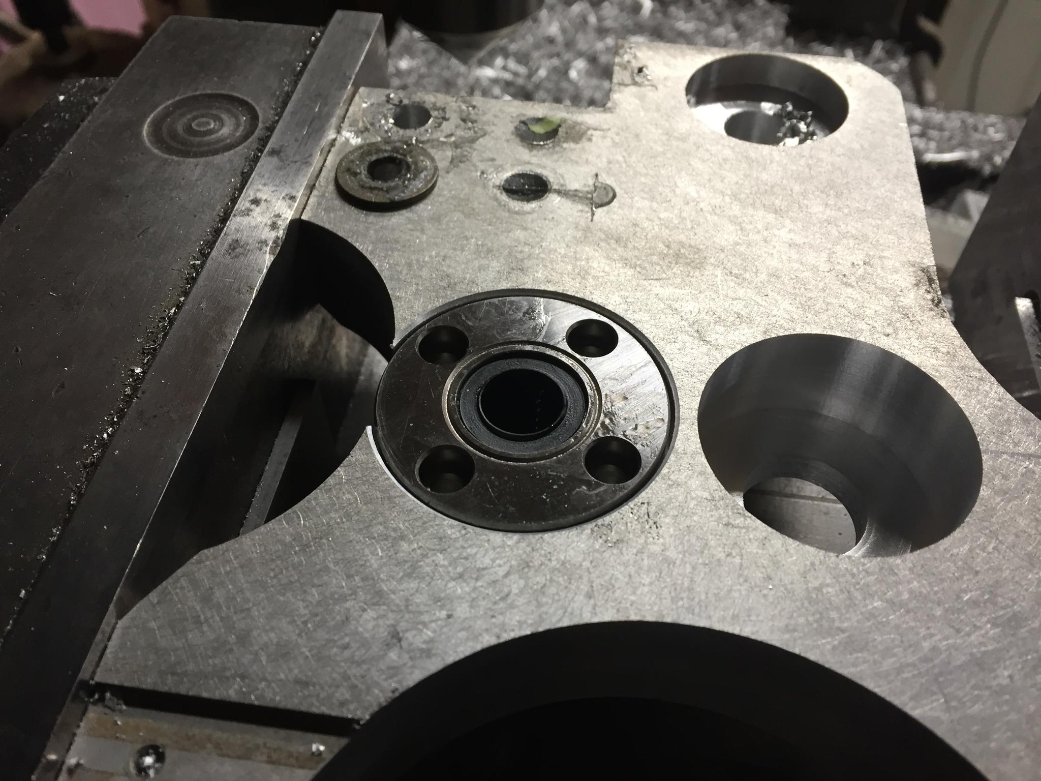

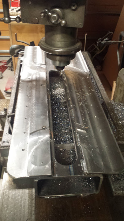

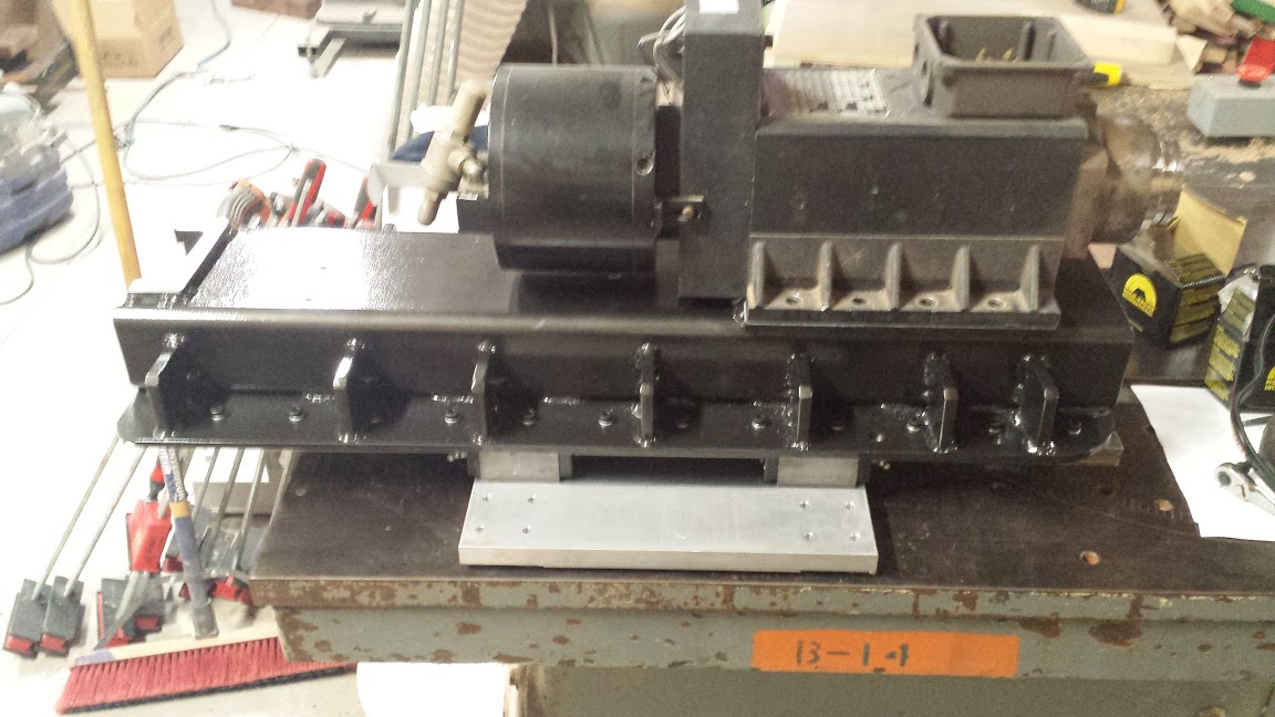

I got a bit done on the Z axis over the weekend. When I was laying everything out for the Z I decided that 4.5 inches between linear rails was not wide enough. So I welded on some 3/8inch plate in order to widen it to 8 inches center to center on the rails.
Starting the milled slot for the ballnut to travel
Attachment 17975
Slot cut through and now cleaning up the edges
Attachment 17976
Attachment 17977
Internal view showing 2 internal supports. I figured these were needed to help keep movement to a minimum when I cut the large slot in the tube. They had to be driven in with a sledge as they were a little tight but I got them in. They are welded in place by drilling 3/8inch holes in the box tubing and then spot welding through those holes.
Attachment 17978

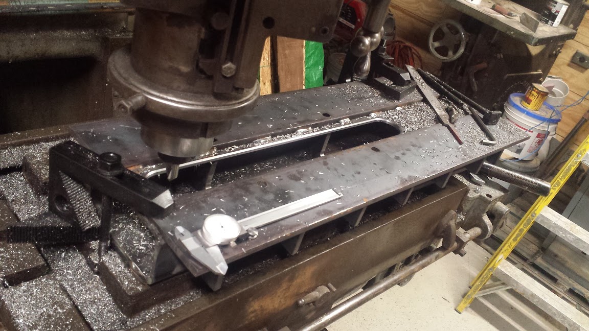

Begining the face milling process. I milled a linear reference for one of the rails. The curves are just the tool paths I had to take to make it all work as my mills travel isnt enough to do the whole thing in 1 pass.
Attachment 17979 Attachment 17980
Here you can see the milled linear reference for the rail
Attachment 17981
And a blurry picture of one of the rails test fitted
Attachment 17982

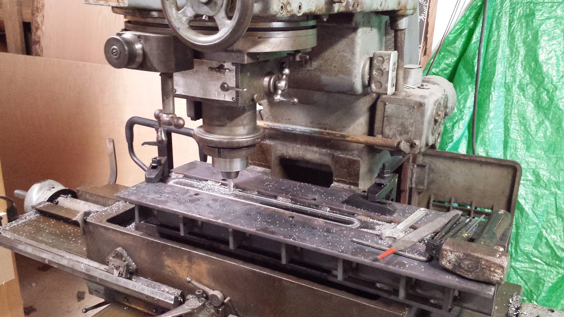

Re: First Build 5 x 12 Steel Frame CNC router
Is that a manual mill or CNC controlled? Either way, good craftmanship!
sinnsvak
It is a manual mill but it has a rotary head. Pretty cool machine, Kearney Trecker 2D rotary head die mill. I had never seen one before and just stumbled across this one when looking for a mill. It can cut circles up to 8 inches. The one I have was built in 1946 and was a little rough, very helpfuly with this cnc router build. Although the table only travels 18 inches X and 12 inches Y so for the Z axis its a bit limiting... but I find ways around that so not a big deal.

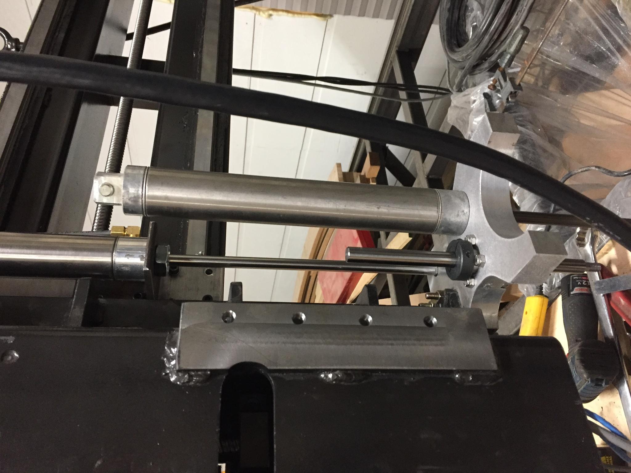

I am waiting on my ballscrews to arrive so I can finish the build out of the major mechanical parts. Crazy how they can go from China to US and clear customs in 1 day and then take 4 days sitting 3 hrs from me... Still no guarantee they are coming tomorrow.
Once ballscrews are mounted and some initial adjustments are made I will do the epoxy pour.
So a question, I received my CSMIO - IP/A in the mail and did some initial hook up to it. Followed the instructions in the manual for setup and download of mach3 plugin. I however can not connect to it. I can ping its IP address but both the firmware uploader and Mach3 can not connect to it.
Any thoughts on what I am missing?
I made a new rule in my firewall settings to include/allow the IP address
Intially I can ping it and get flashing lights on the IP/A
after about 3 - 5 minutes the lights go solid and I can no longer ping it...

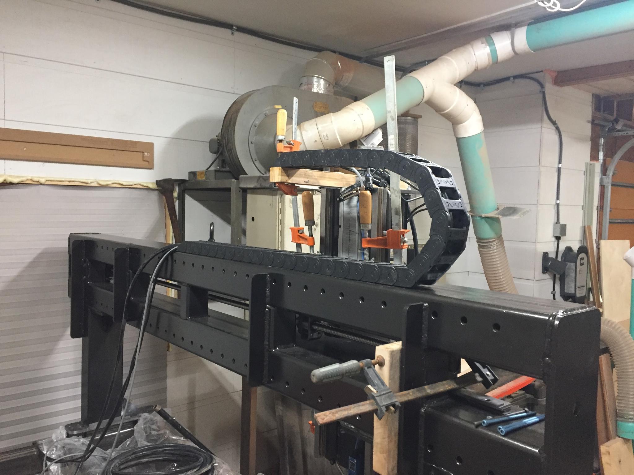

Still on the search for a good enclosure for the electrical components. Anyone ever put the spindle motor vfd on the gantry rather than run long VFD motor cable to the spindle? I was thinking about do this to keep the 3 phase cabling (higher current to the spindle at least) as short as possible. I think some of the big CNC players do it this way where they have a control cabinet on the backside of the gantry. Thoughts on this?
Scott
Scott Damman
Scott
I was contemplating this many times or to integrate it in the machine somehow. First the dust will be a problem, but you could make a cover for it. Biggest issue for me is if cable disconnects and touches a metal while i am touching that metal too. though the machine must be grounded. I don't know. there must be a reason not to do it. It has some vibration requirements also.
Do-able but involved and costly.
Dust and Vibrations are the biggest issues. Cover the VFD and heat becomes an issue so Good Filterd cooling is required. Vabration over time can cause issues so it will need mounting on rubber standoffs.
I would not do it - if this is a single phase input/three phase output VFD then the supply cable will be carrying more current than the motor cable. As mentioned, vibration and muck are serious enemies of electronics.

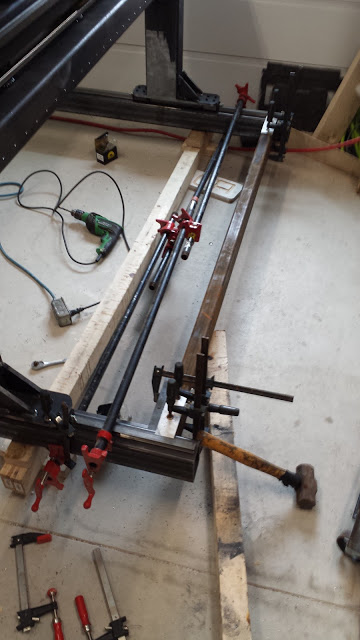

8 Attachment(s)
Thanks for the thoughts on mounting the VFD to the gantry. I had kinda thought about those items as well, the main driver for me was actually 3 phase switching noise caused by the VFD. I use double shielded VFD cable but at these high frequencies (300 - 400Hz AC at 2.5khz switching) there can be alot of noise that causes interference elsewhere in the home. Anyway I have scrapped the idea in favor of wall mounted.

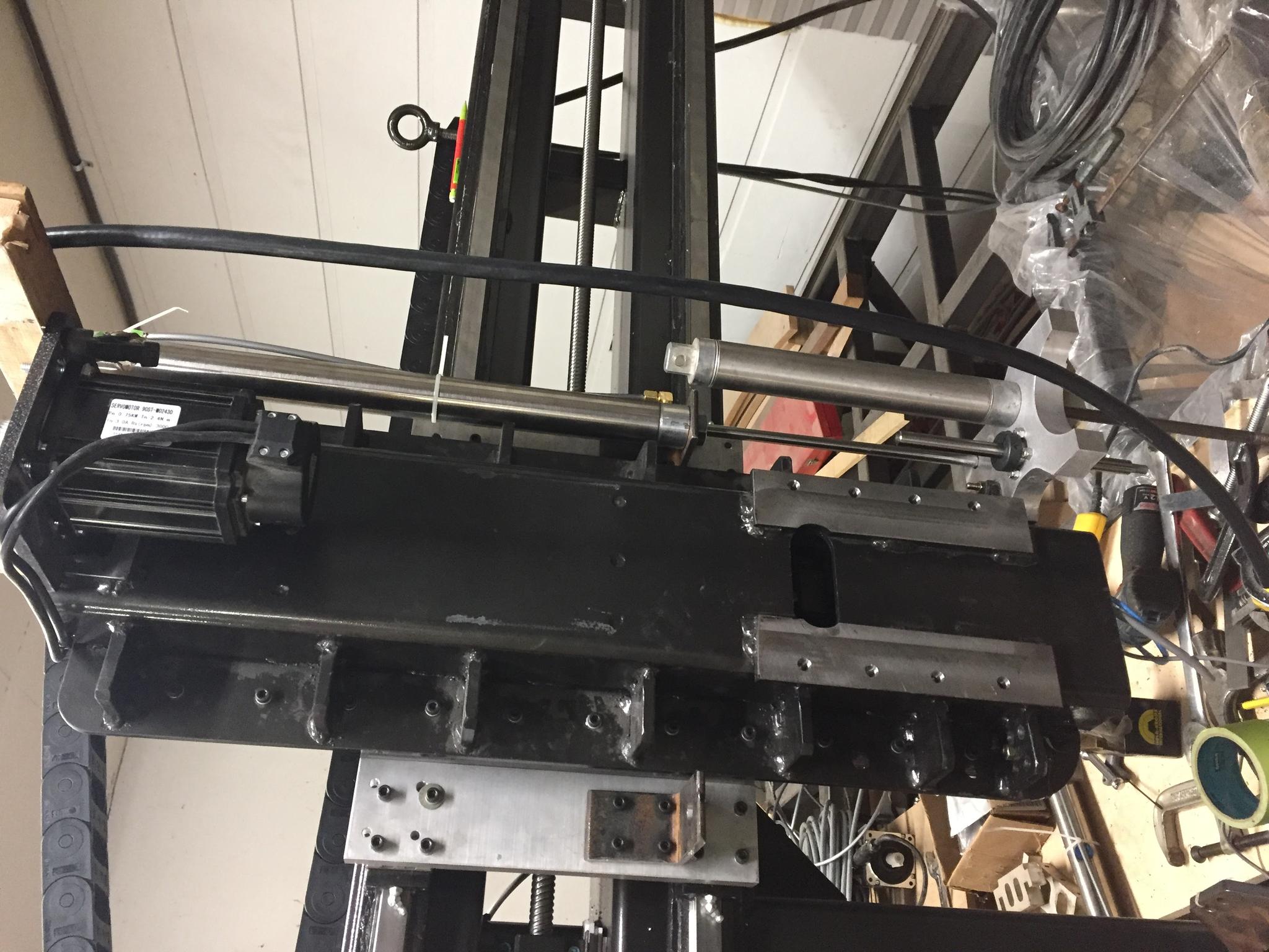

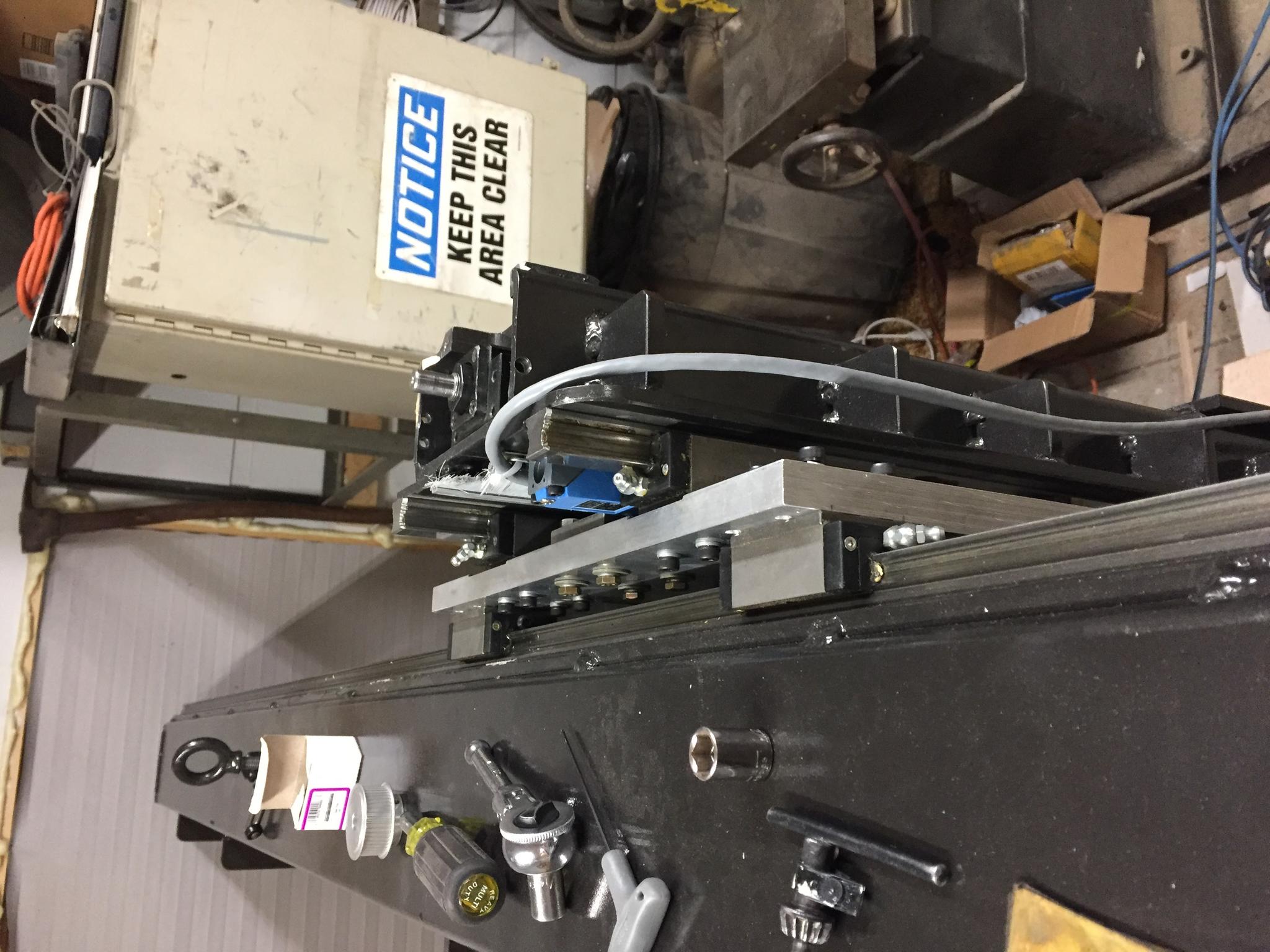

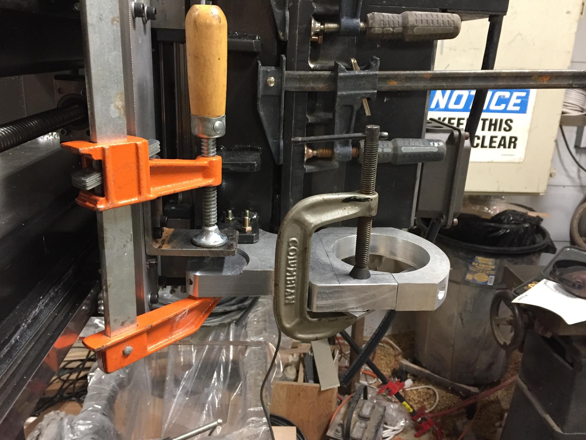

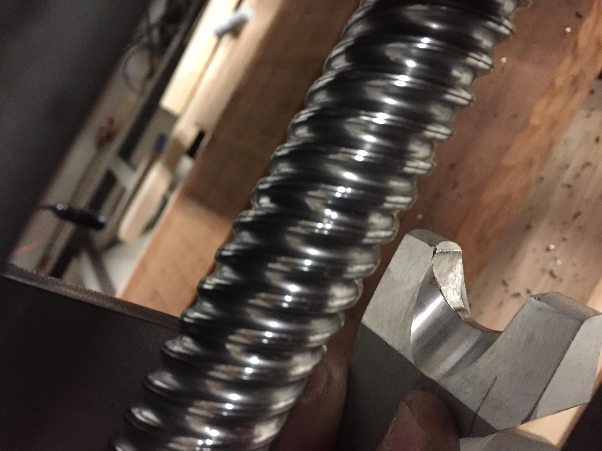

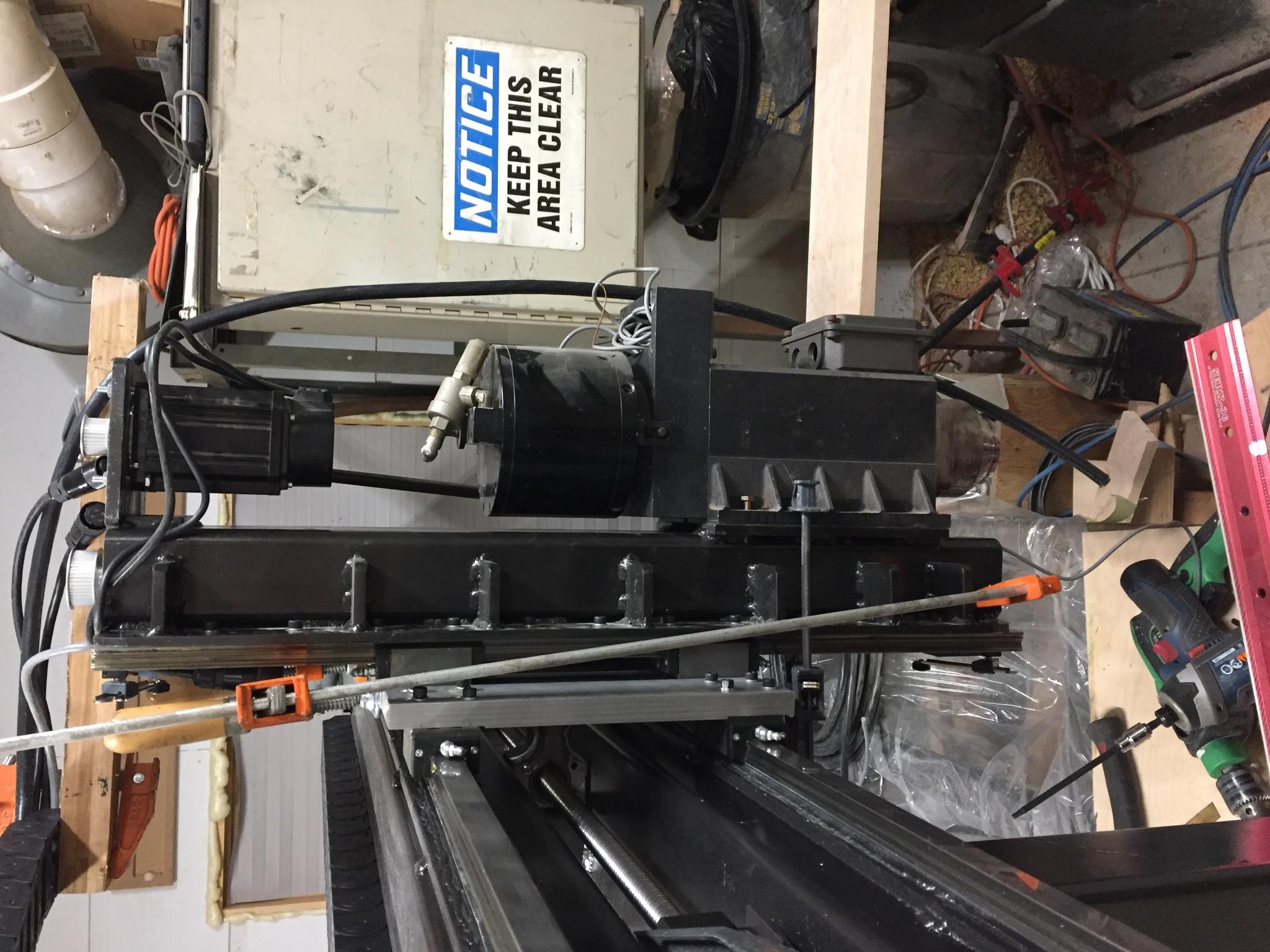

Finally some updates on the machine.
Attachment 18199
Attachment 18200
Attachment 18201

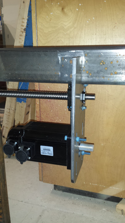

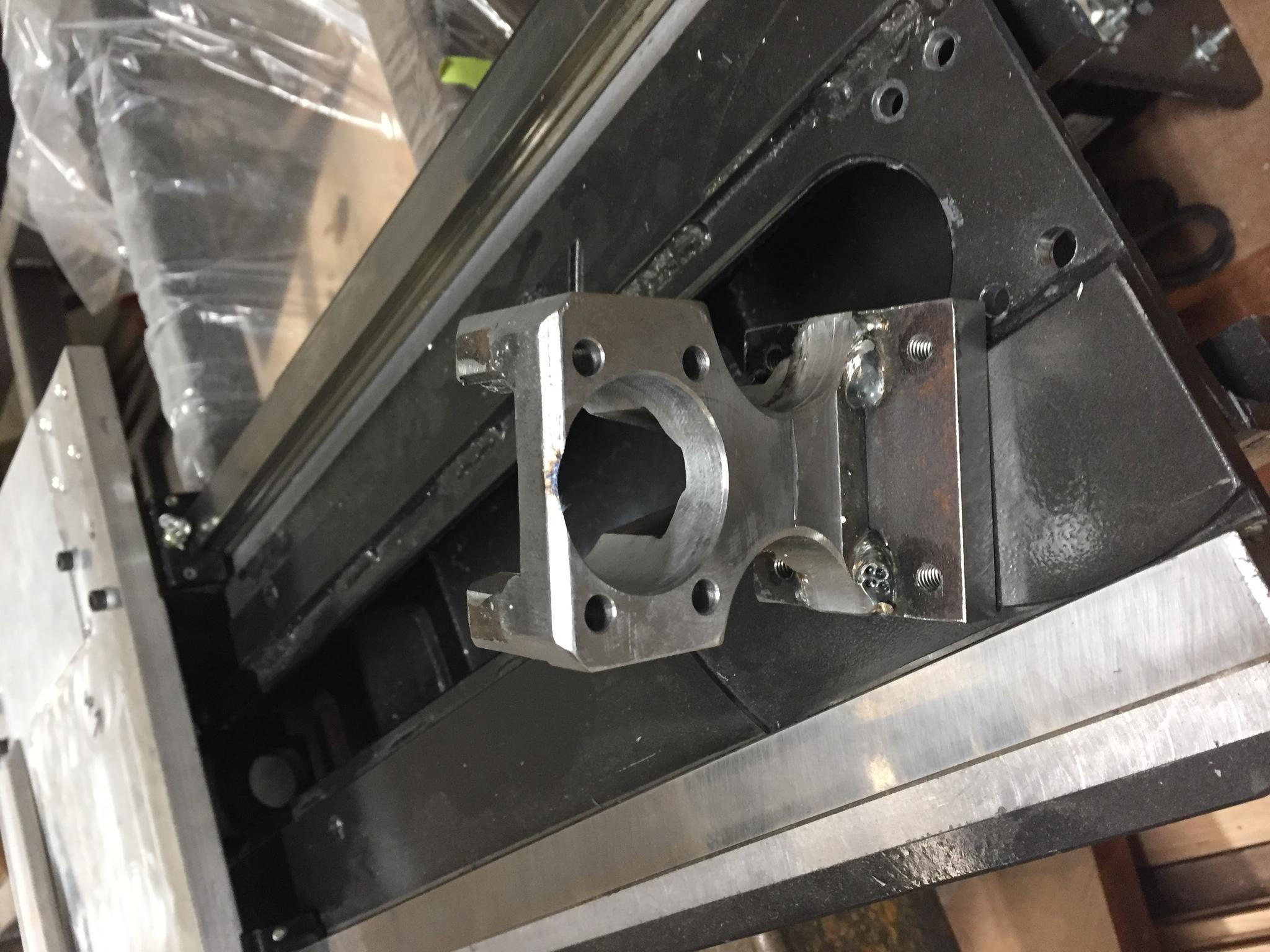

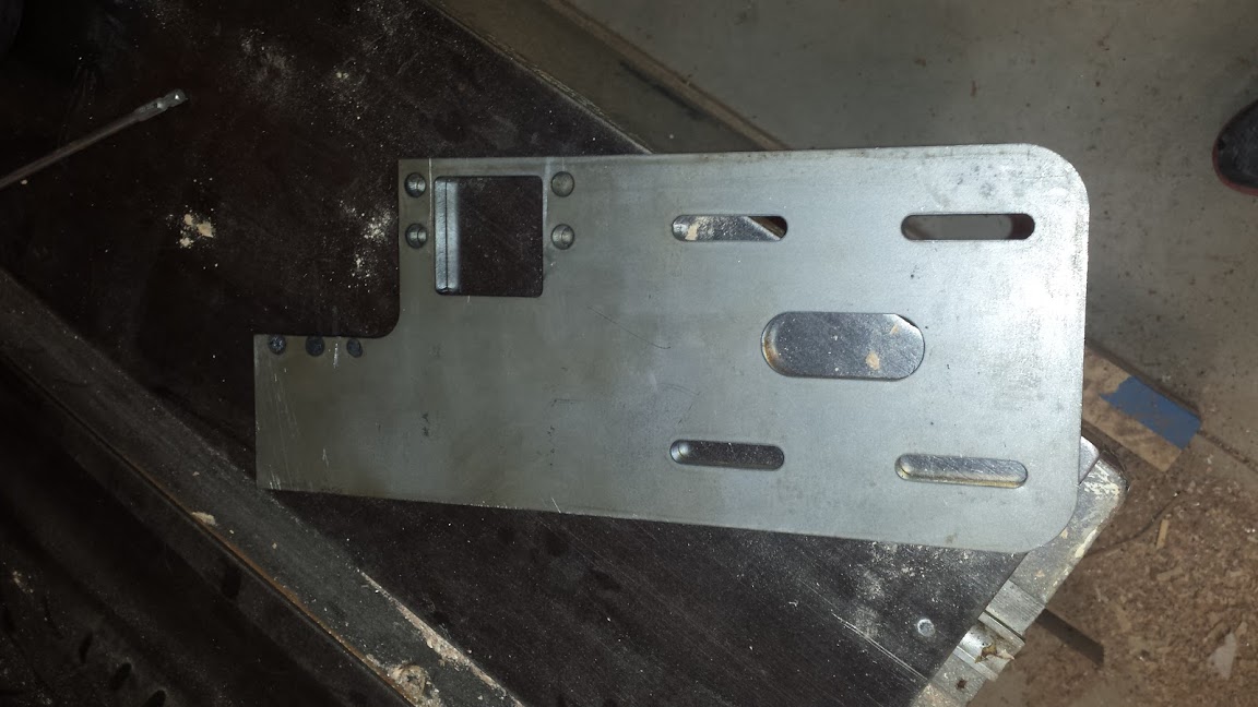

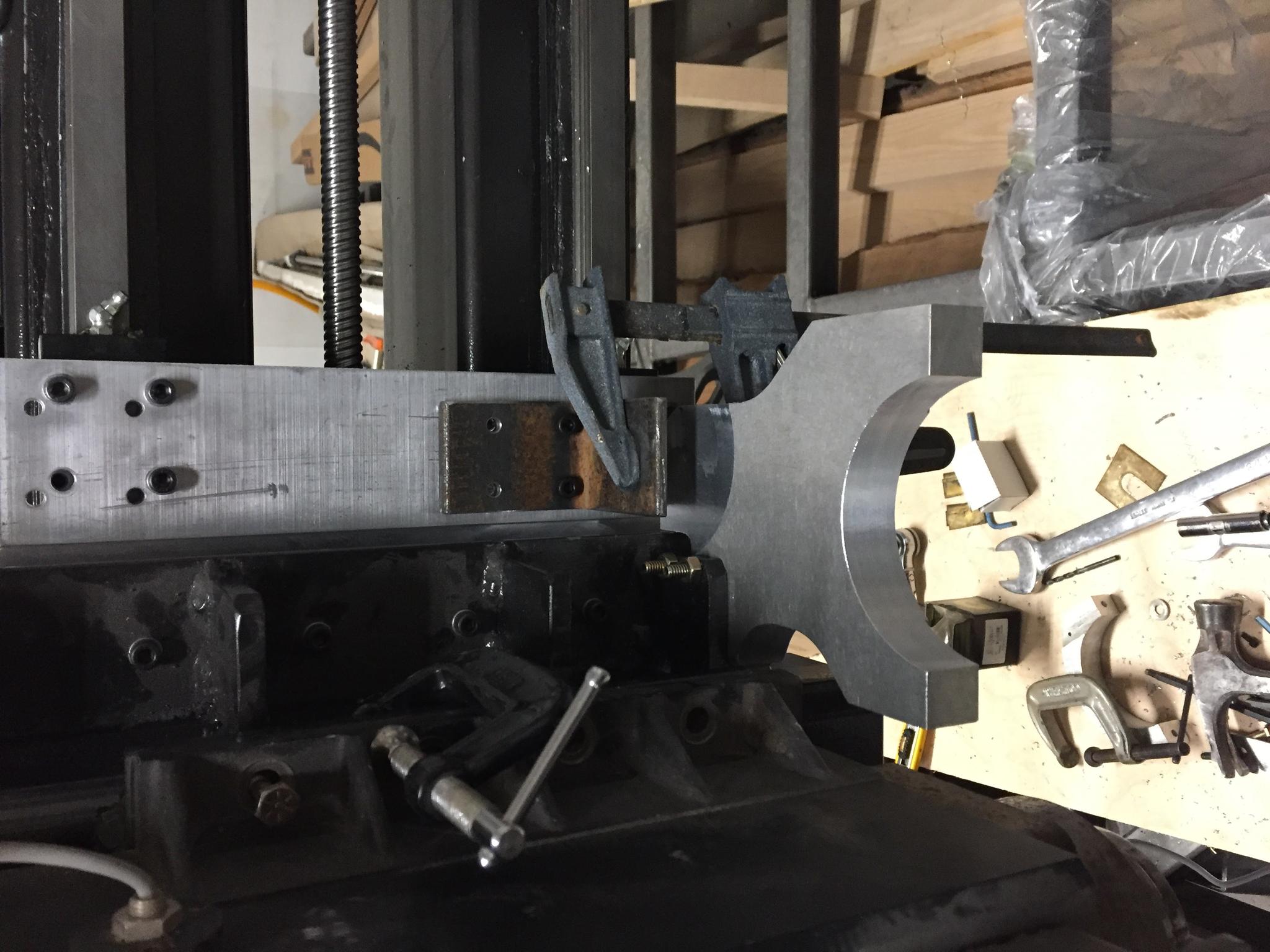

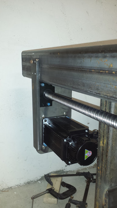

X axis motor mount plates (laser cut) and servo motor mocked up.
Attachment 18202
Attachment 18205
Attachment 18206

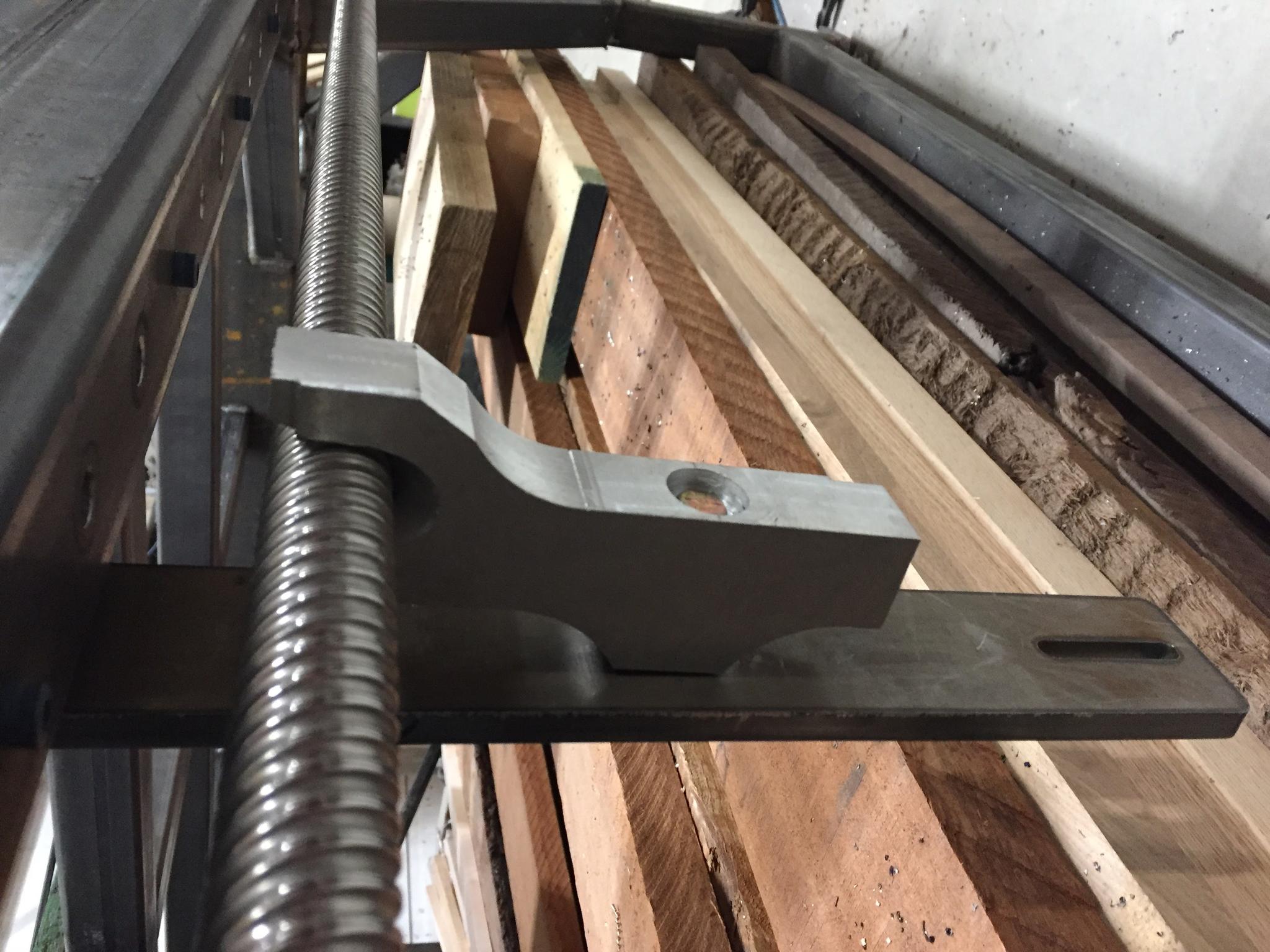

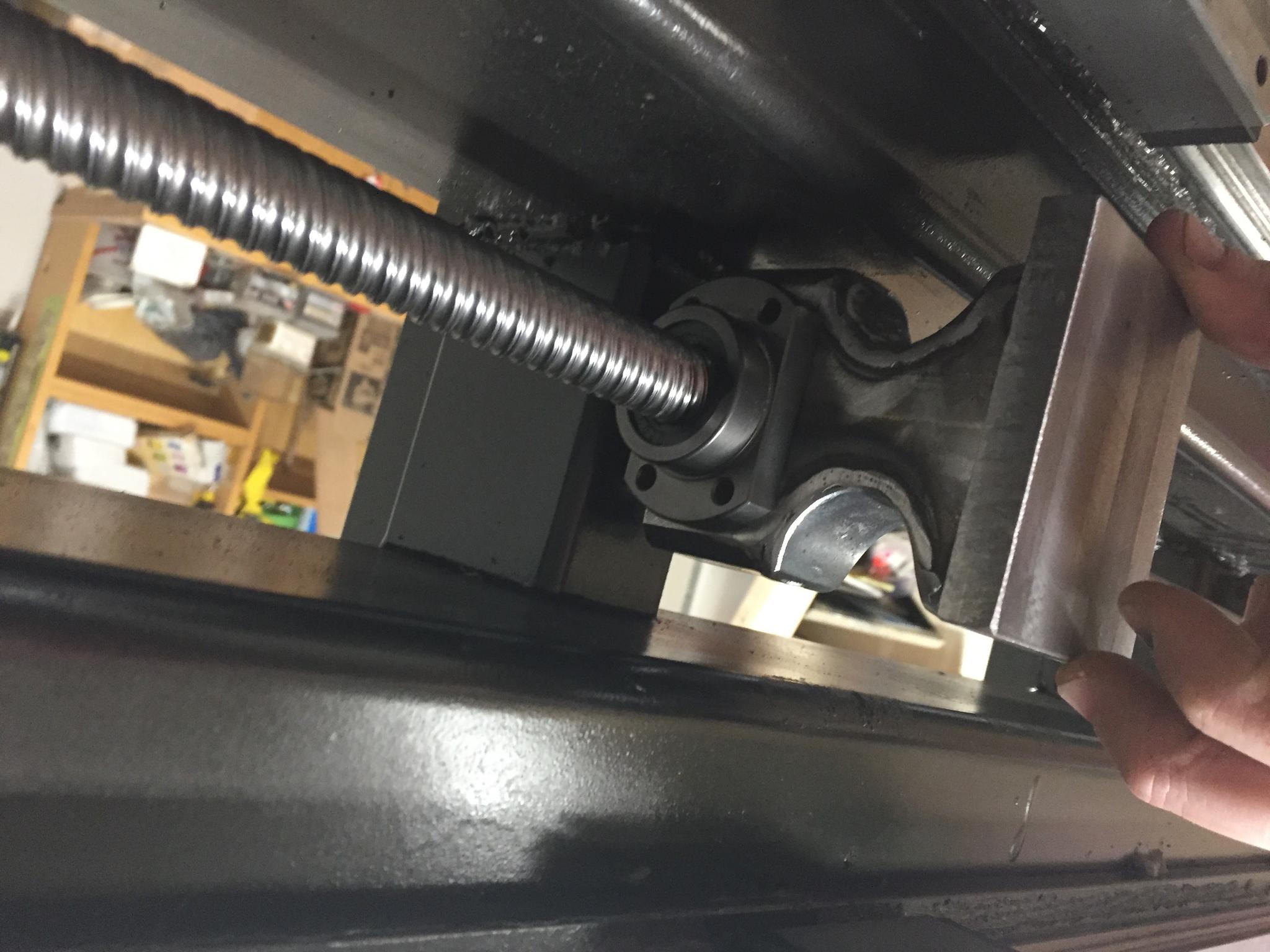

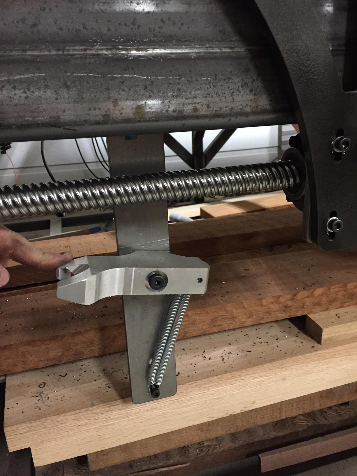

Long ballscrew mocked up for bracket design
Attachment 18204

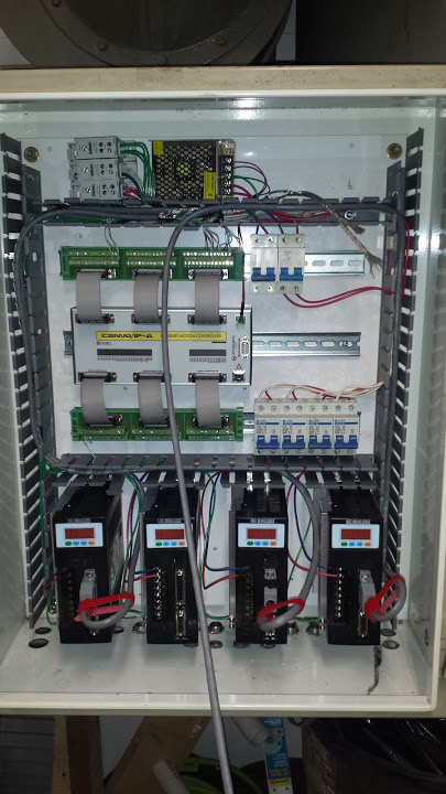

Also made some good headway on the electrics. Still cant get CSMIO to connect so will have to contact them here soon but Im a bit of time away from needing it.
Attachment 18203

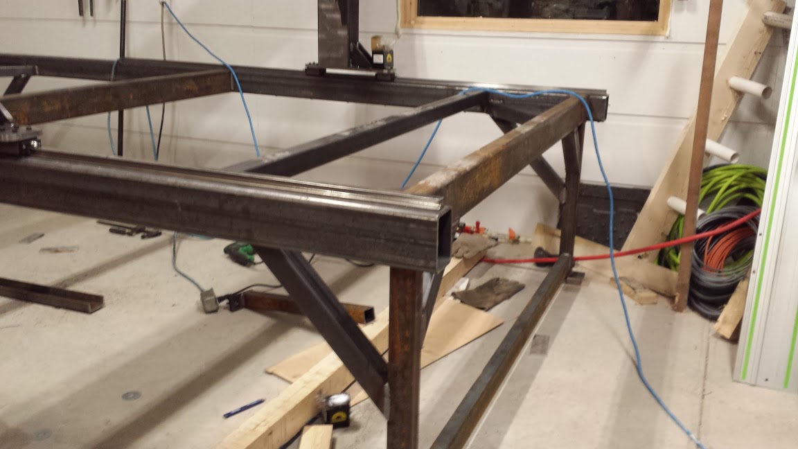

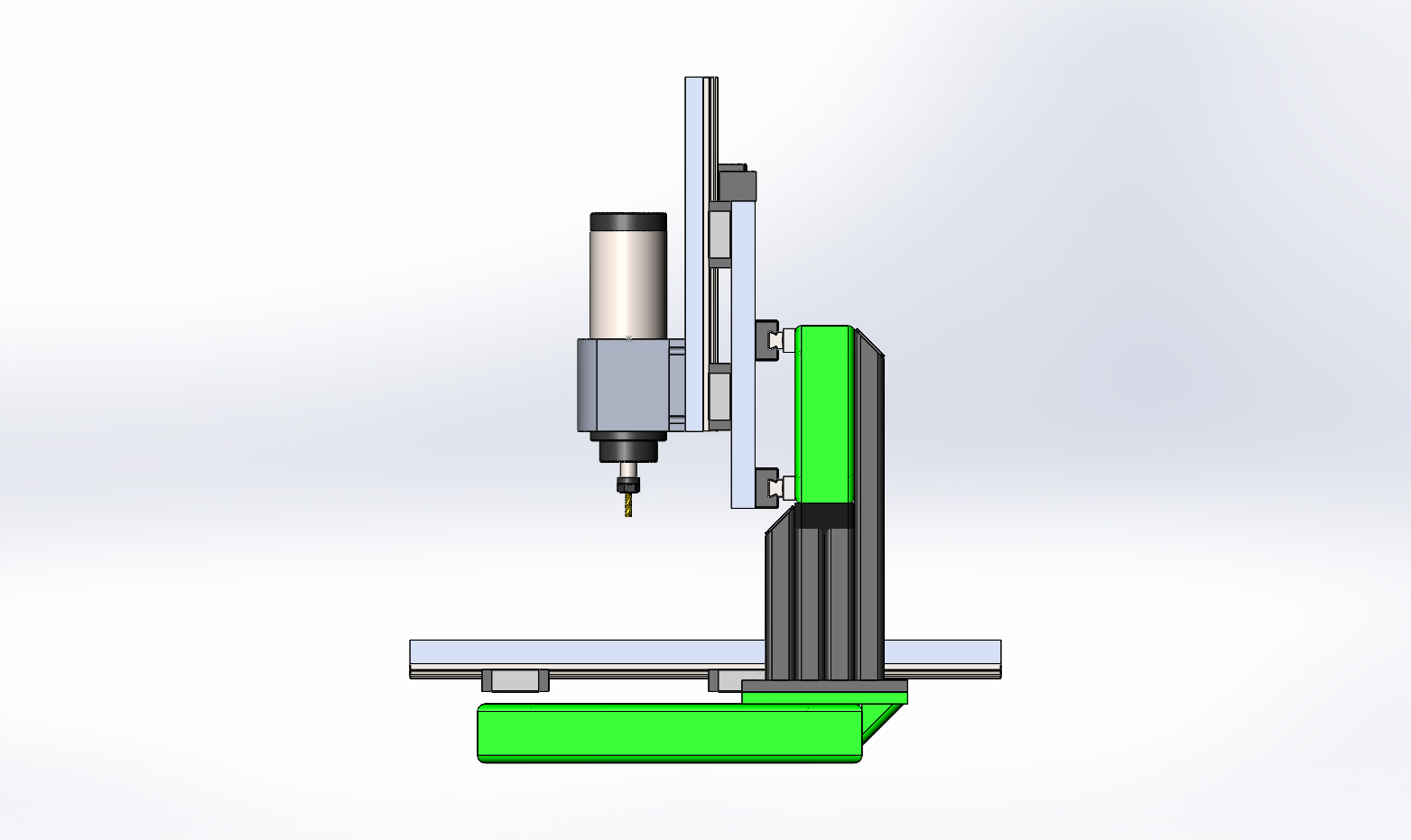

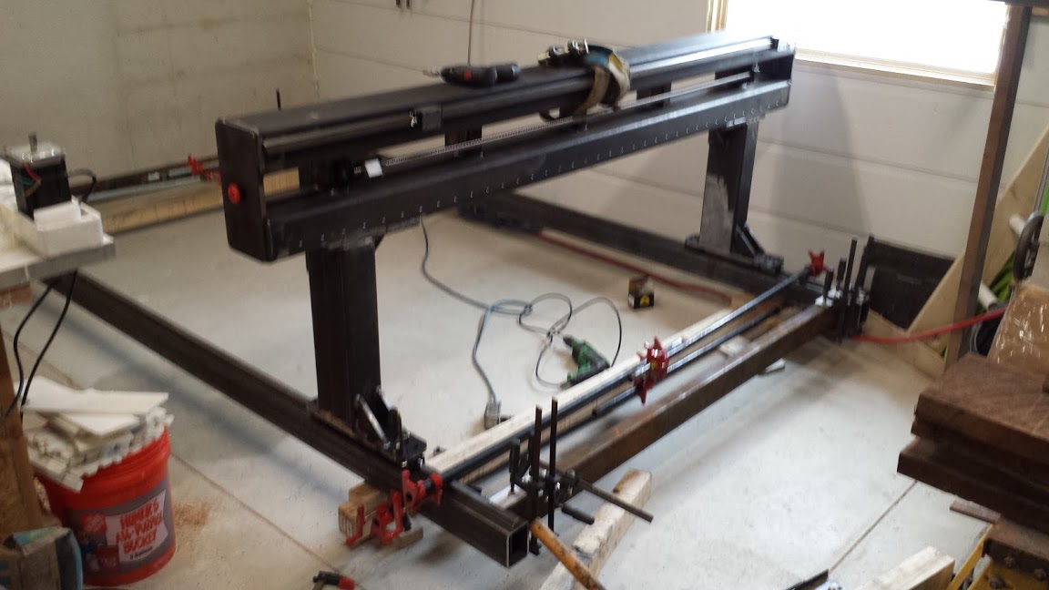

I fully agree, legs has to be revised.
I make another desktop router with fixed gantry this time and see how I made it:
Attachment 18946Attachment 18947Attachment 18948Attachment 18949
all made from rectangular profile 50x25x3
I weld everything with Tig this time will start new topic about my build
Good luck
Tom

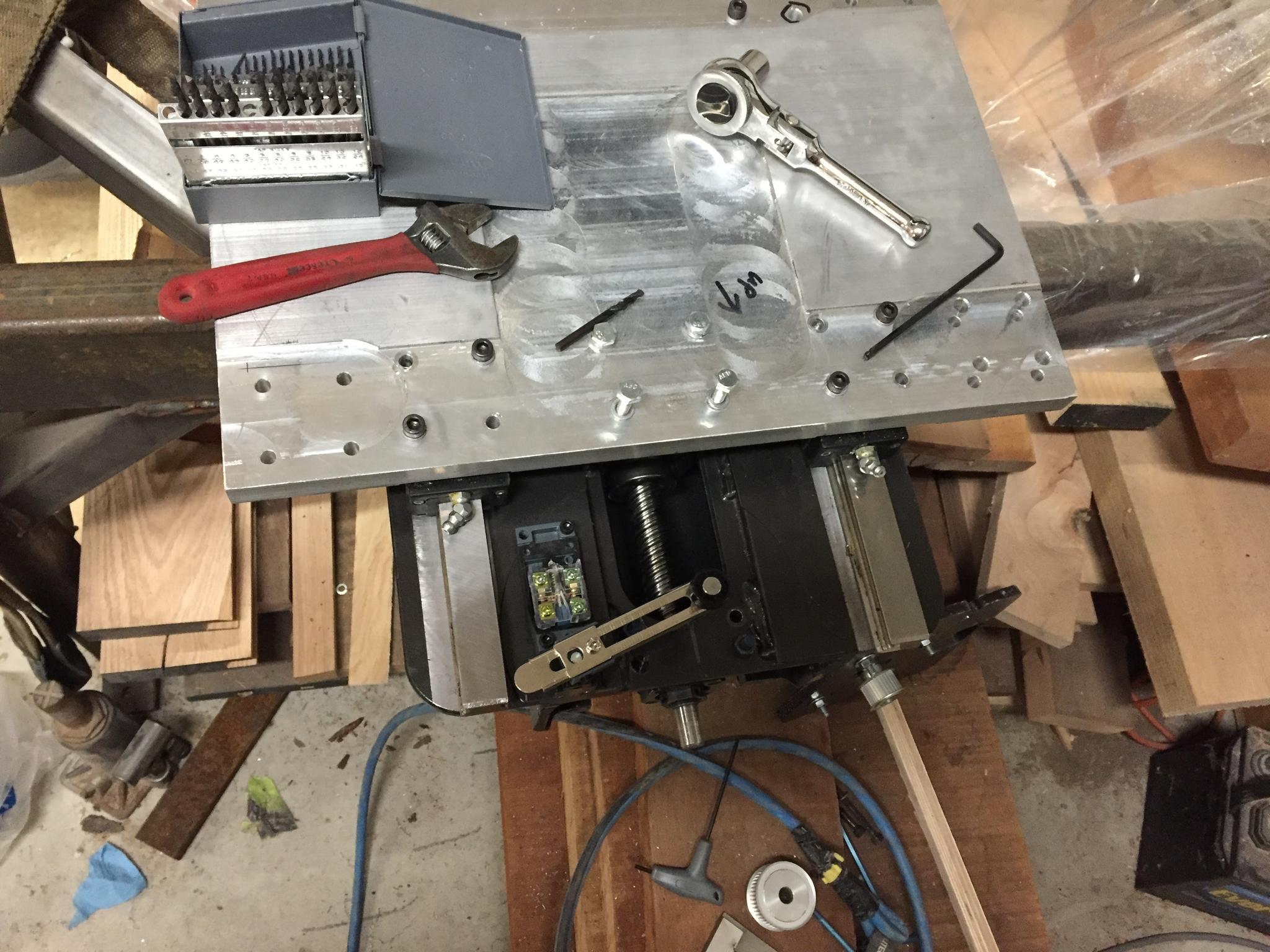

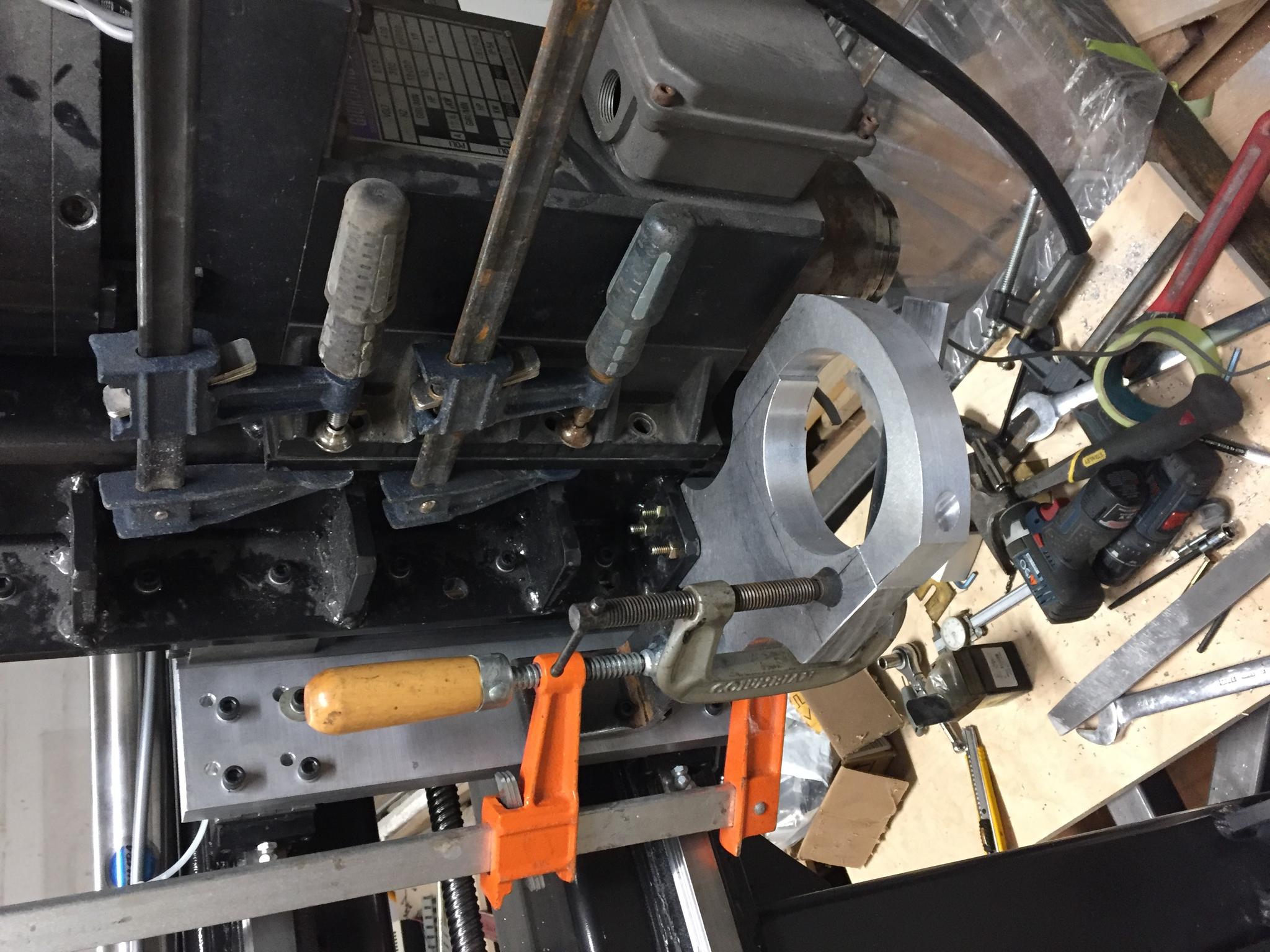

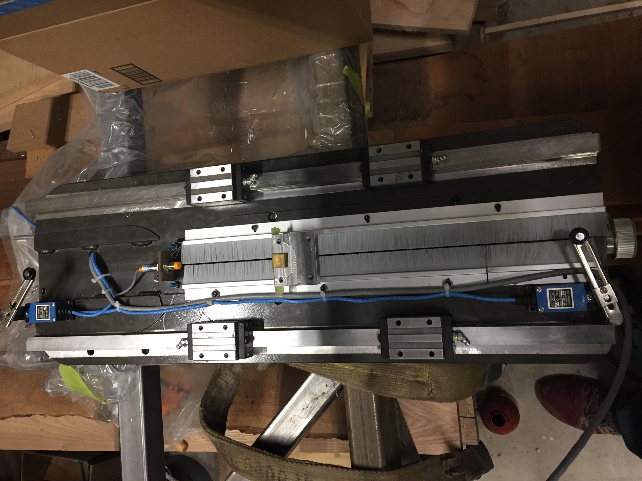

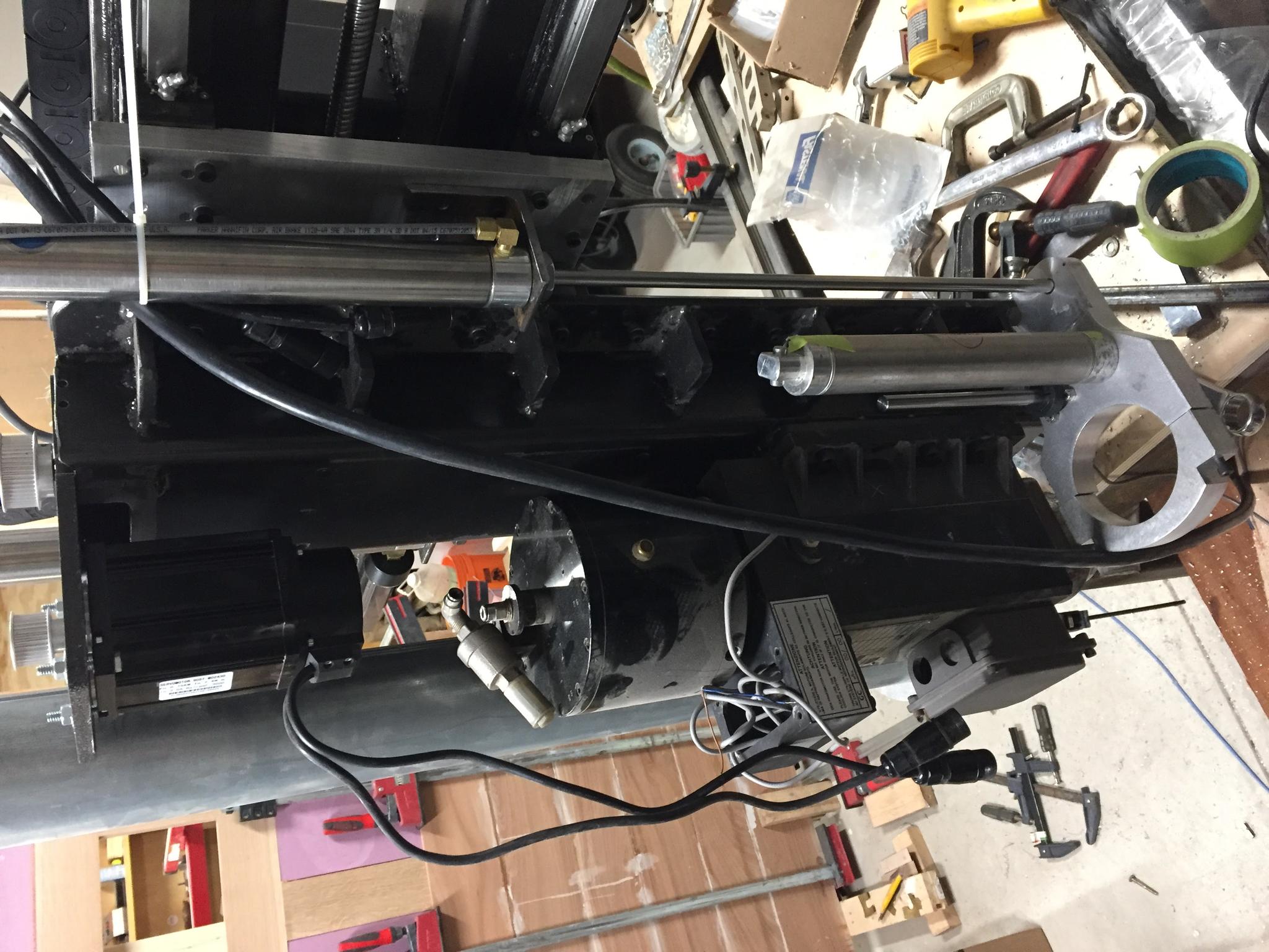

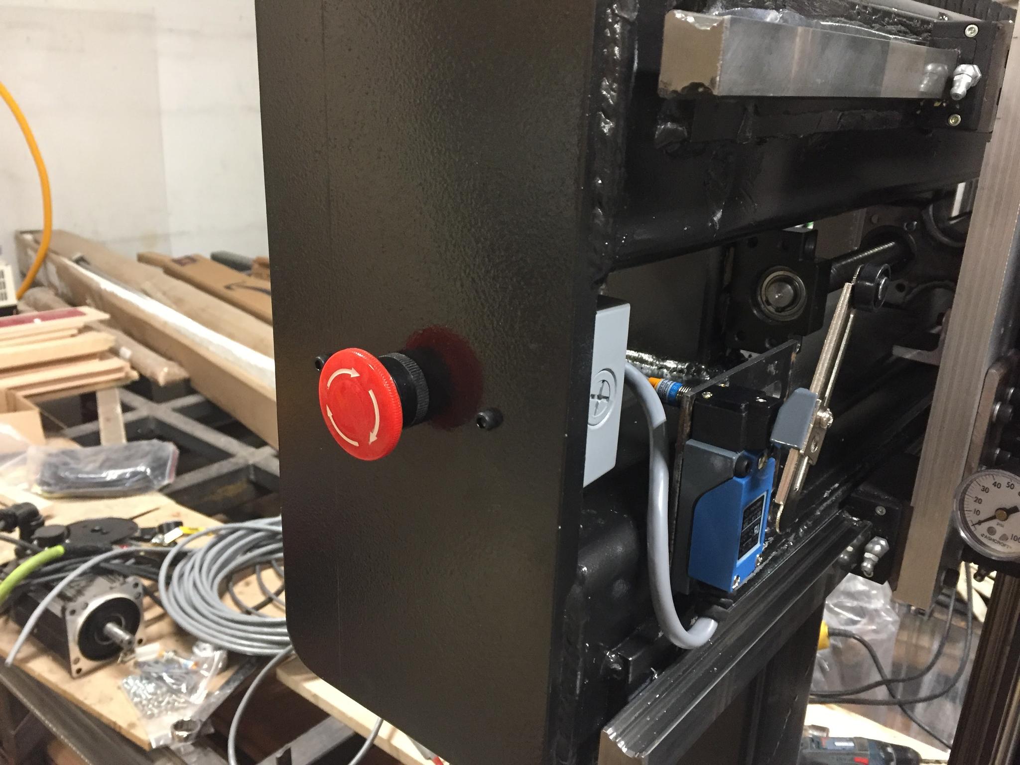

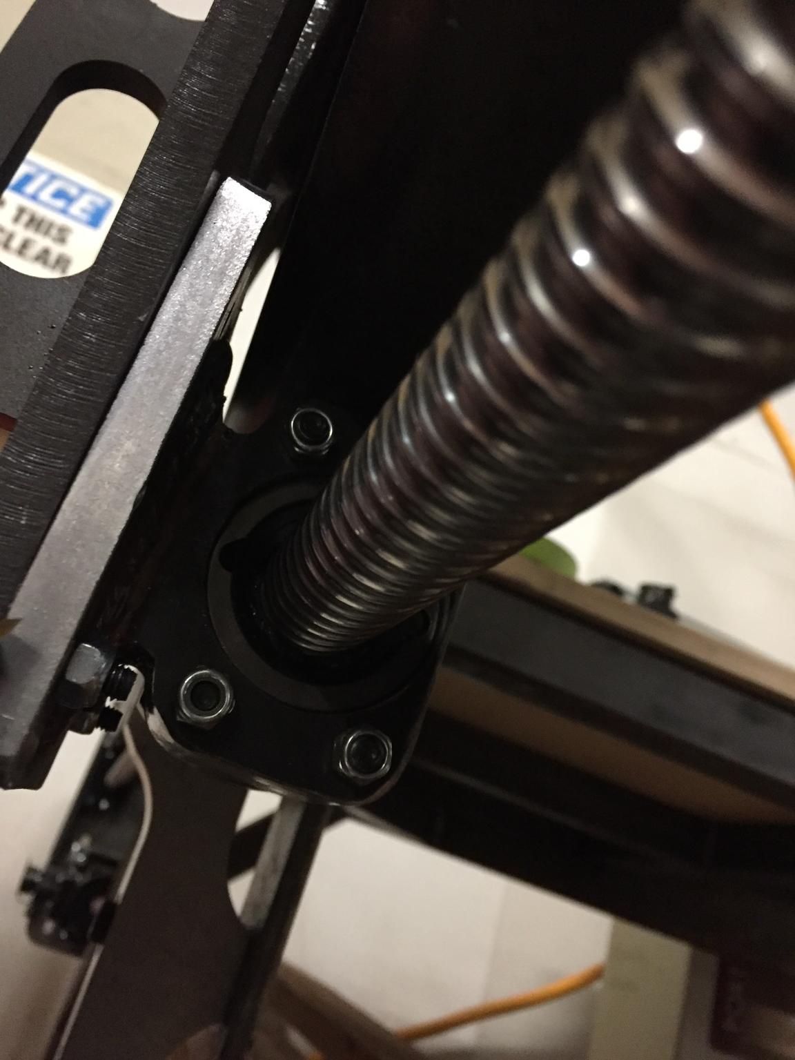

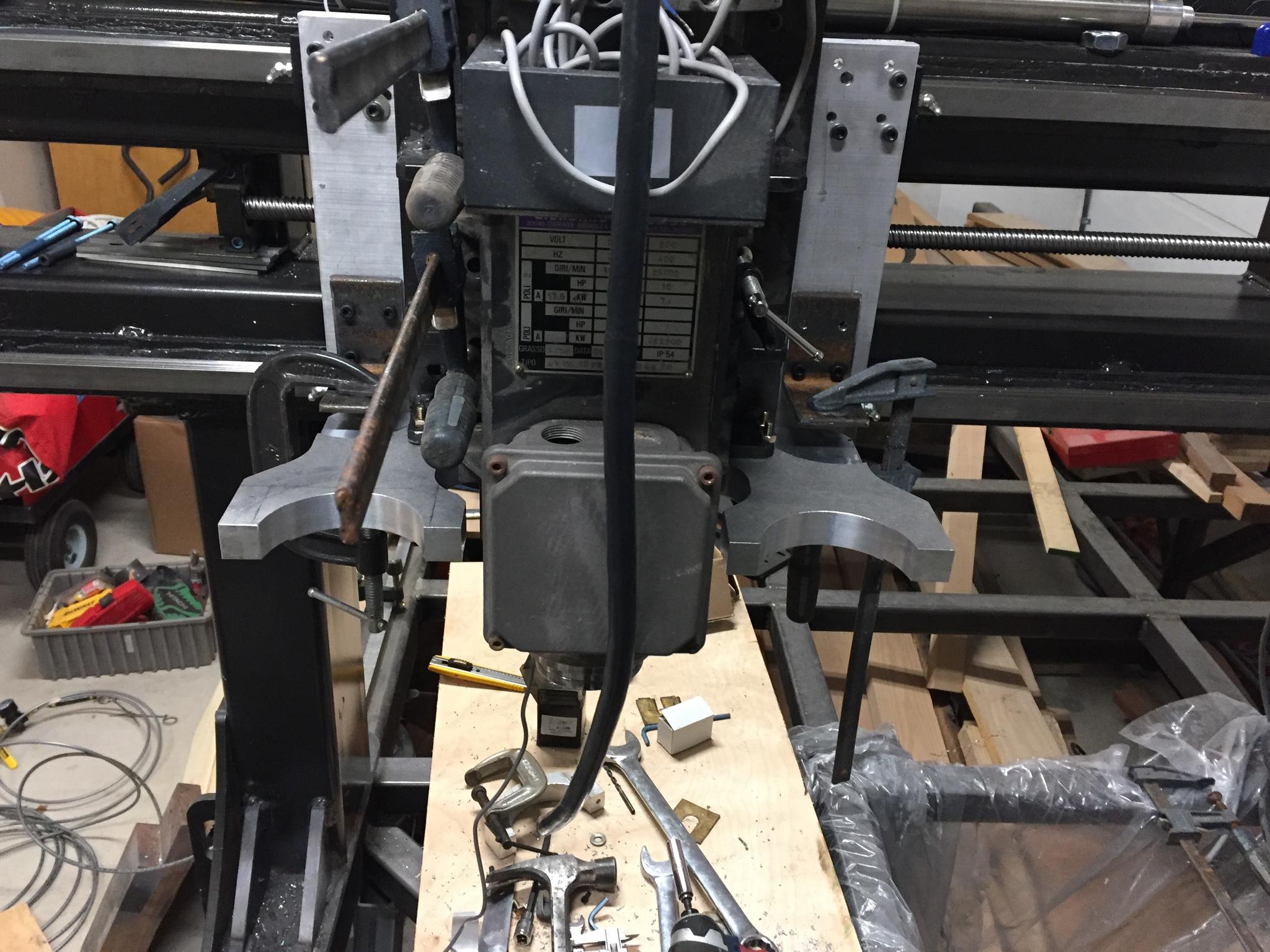

51 Attachment(s)

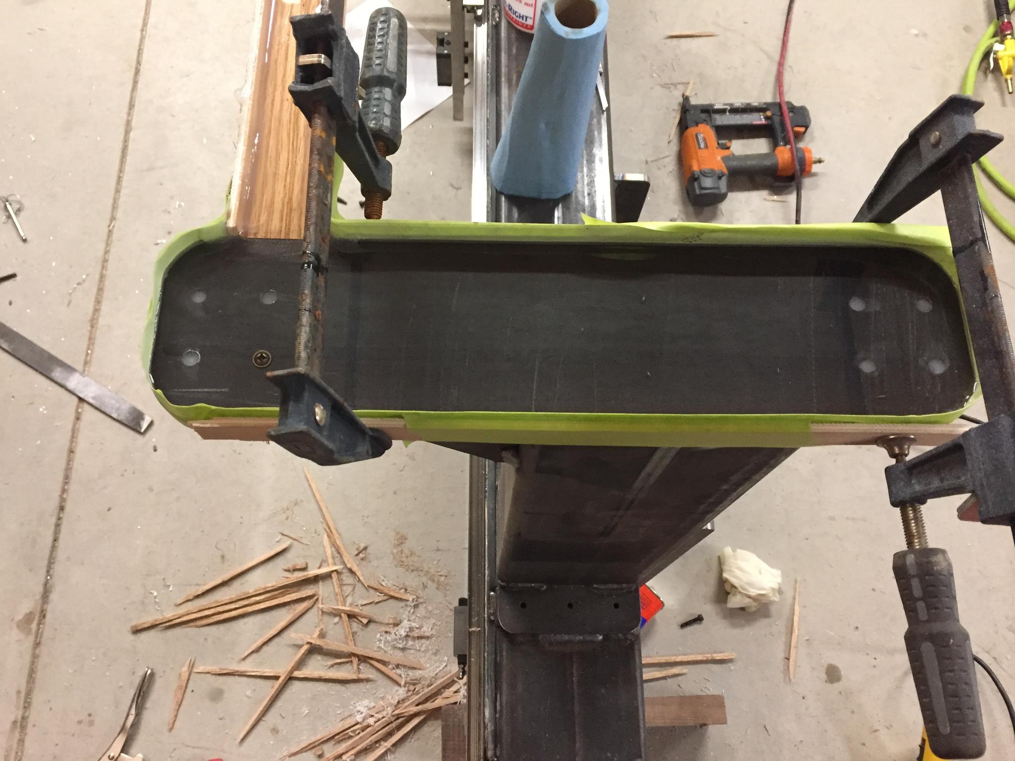

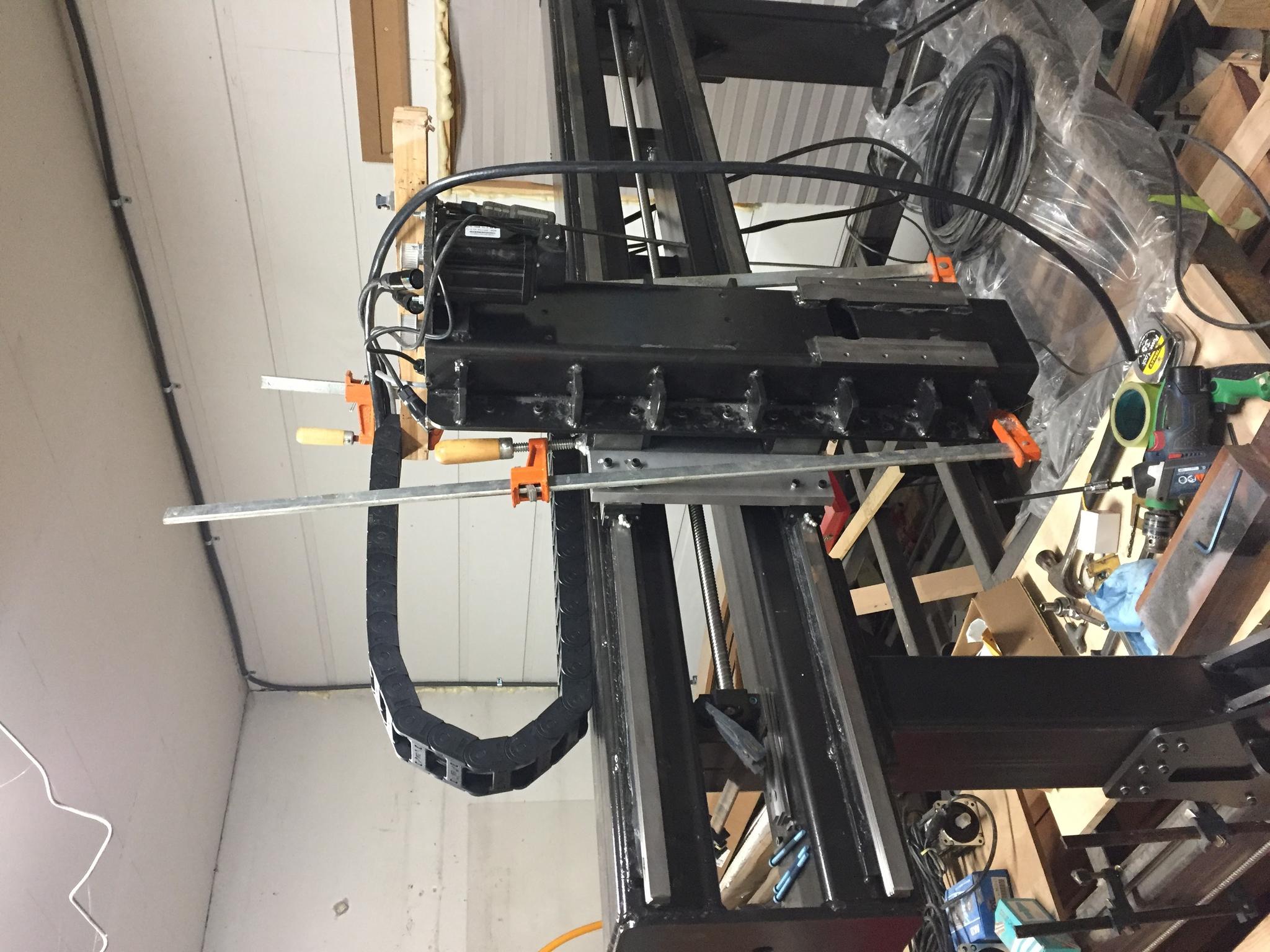

I have been MIA for a long period, normal life and other projects got in the way over summer. Finally back to working on the CNC.
Attachment 19859

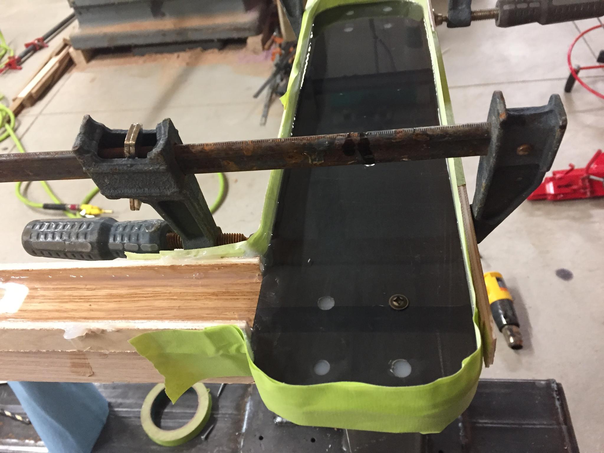

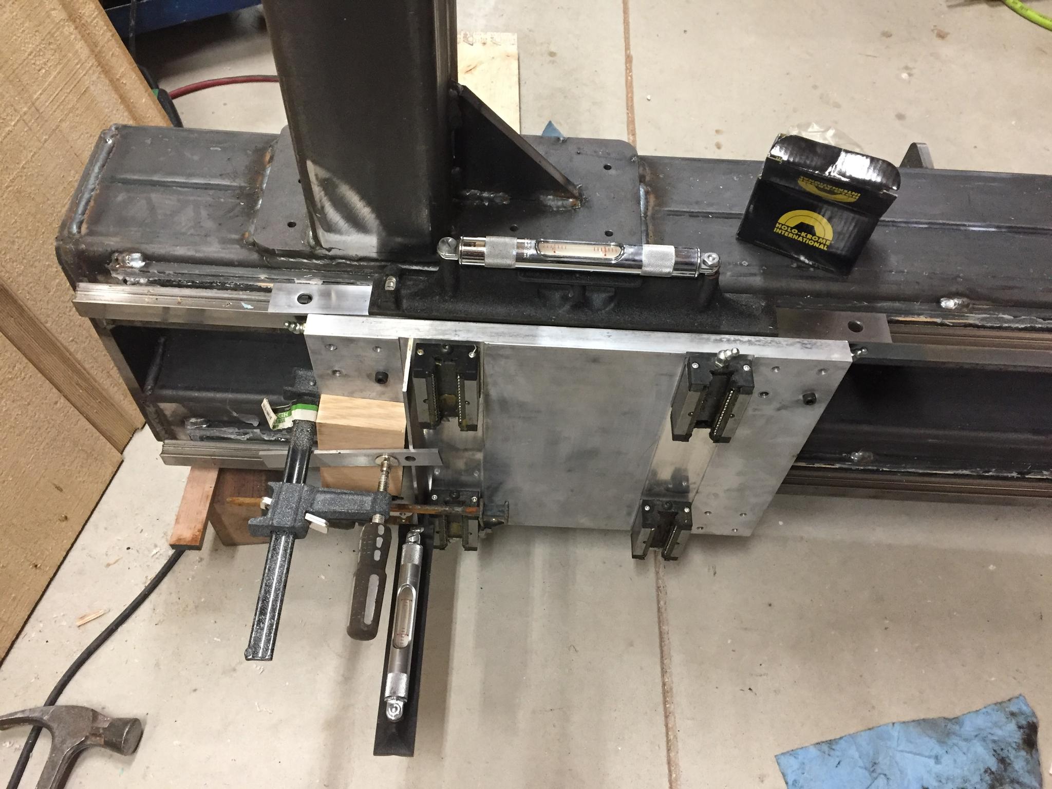

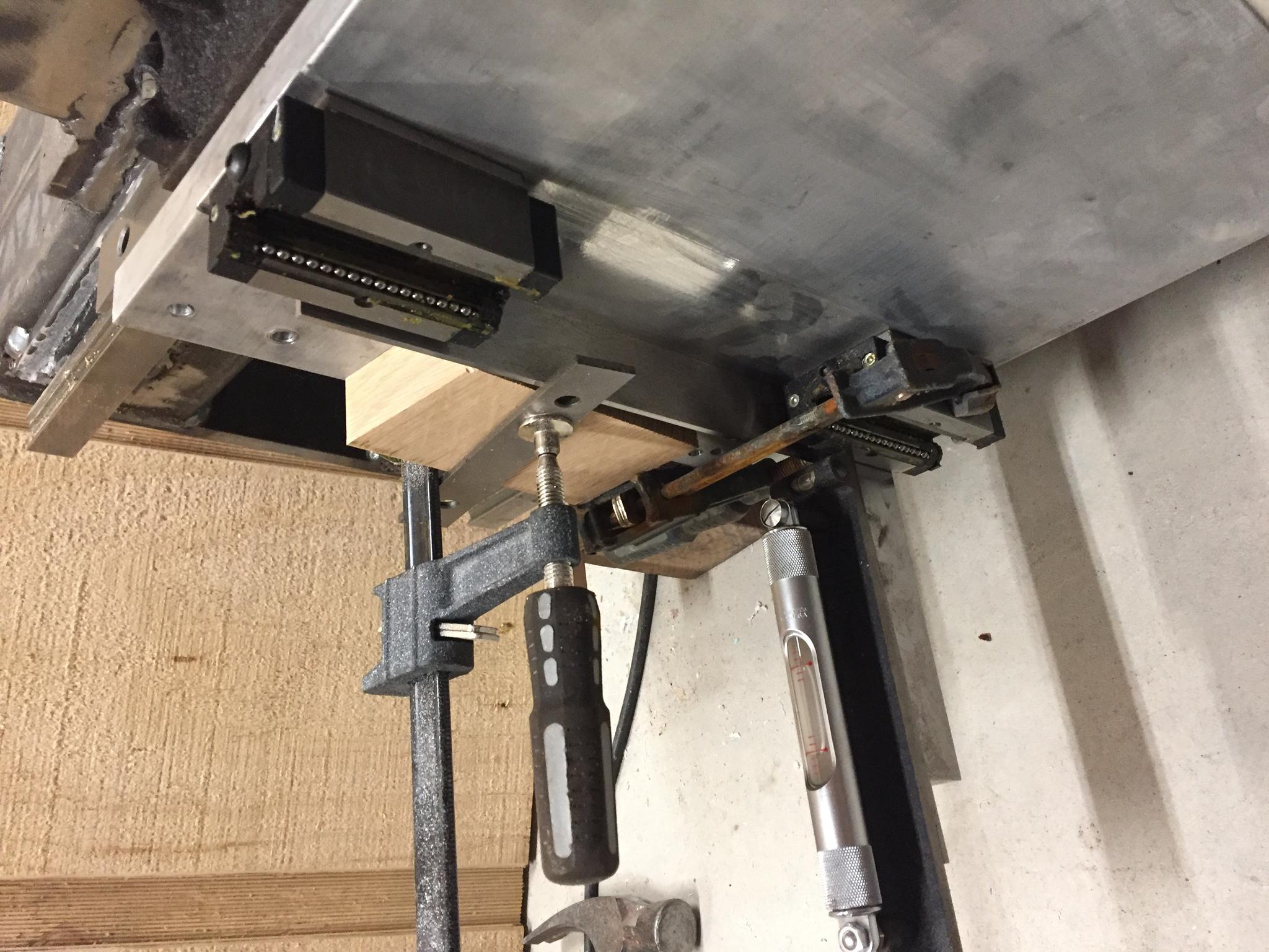

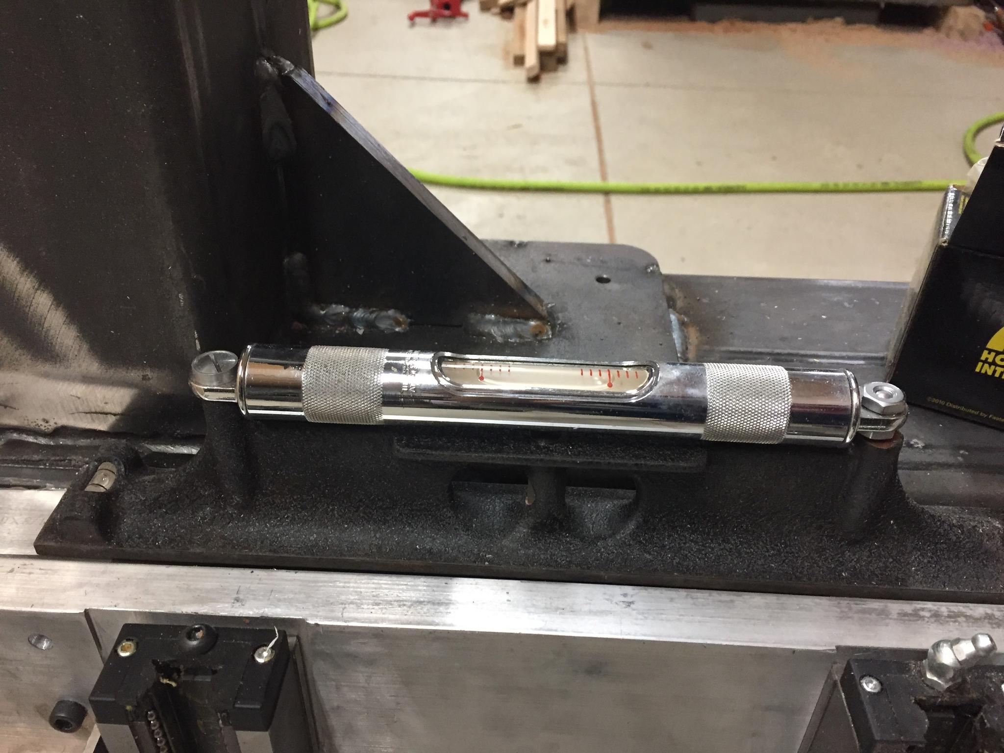

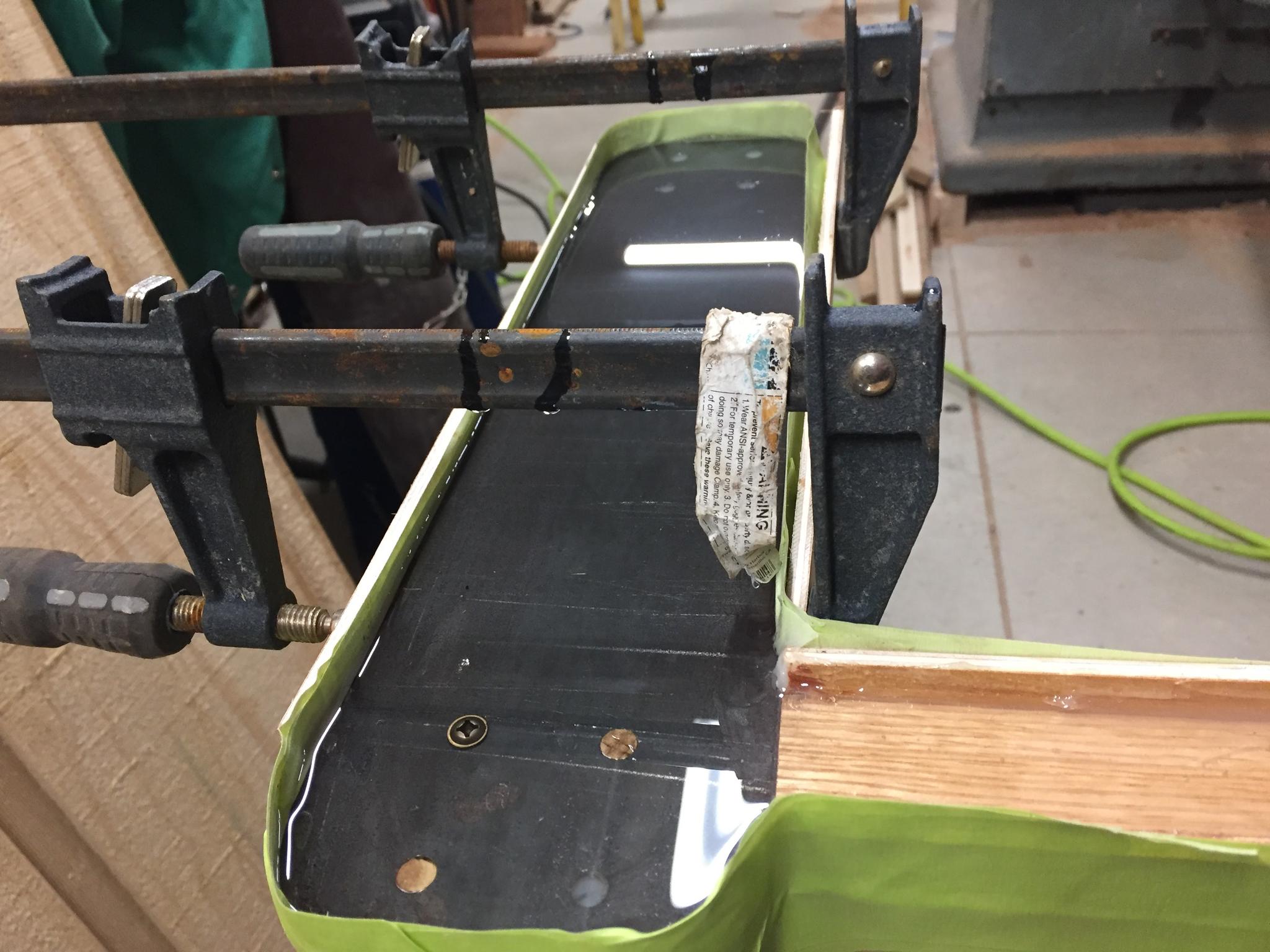

Leveling the Y to Z plate for gantry foot epoxy pour
Attachment 19860Attachment 19861Attachment 19862
Pouring the gantry feet
Attachment 19863Attachment 19864Attachment 19865Attachment 19866

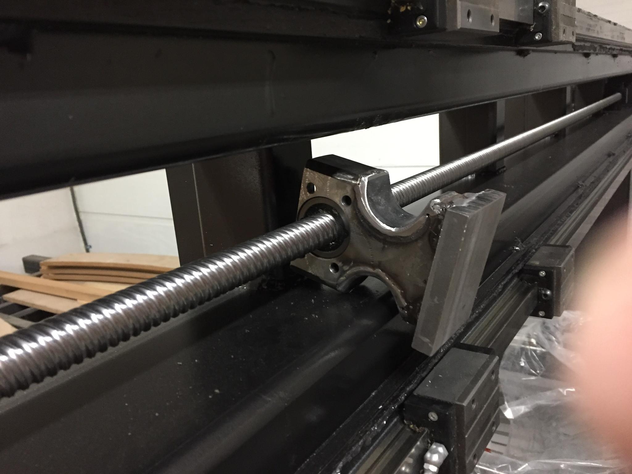

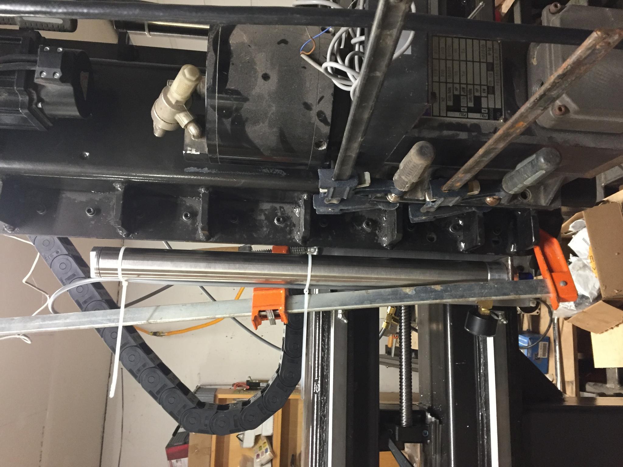

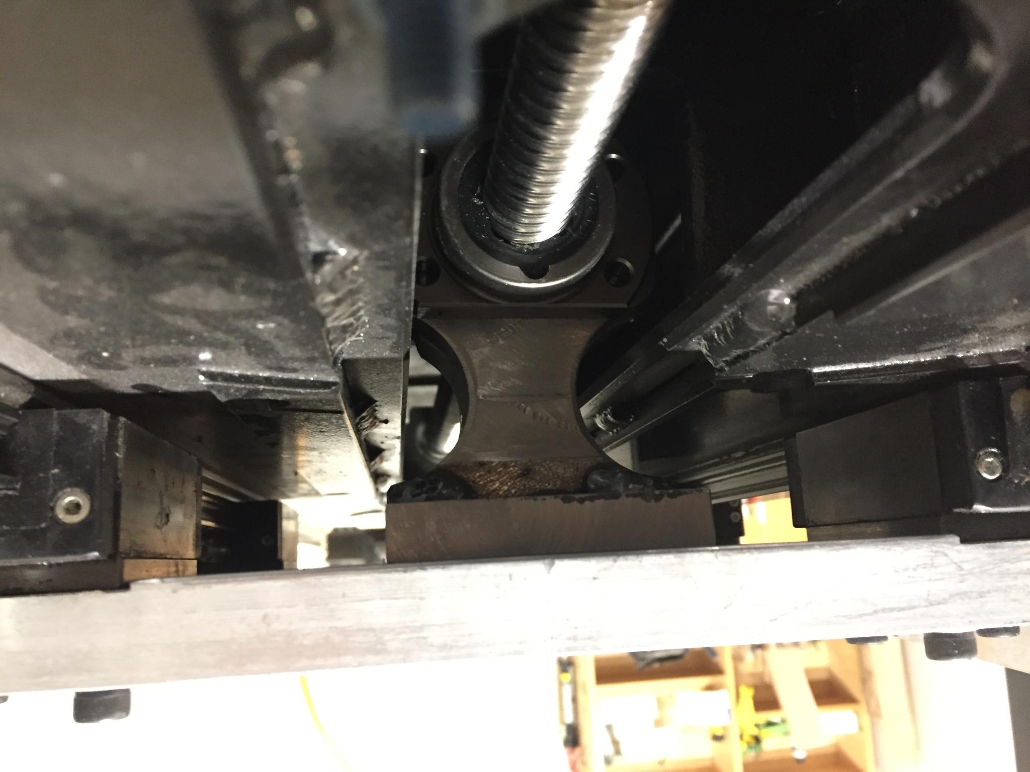

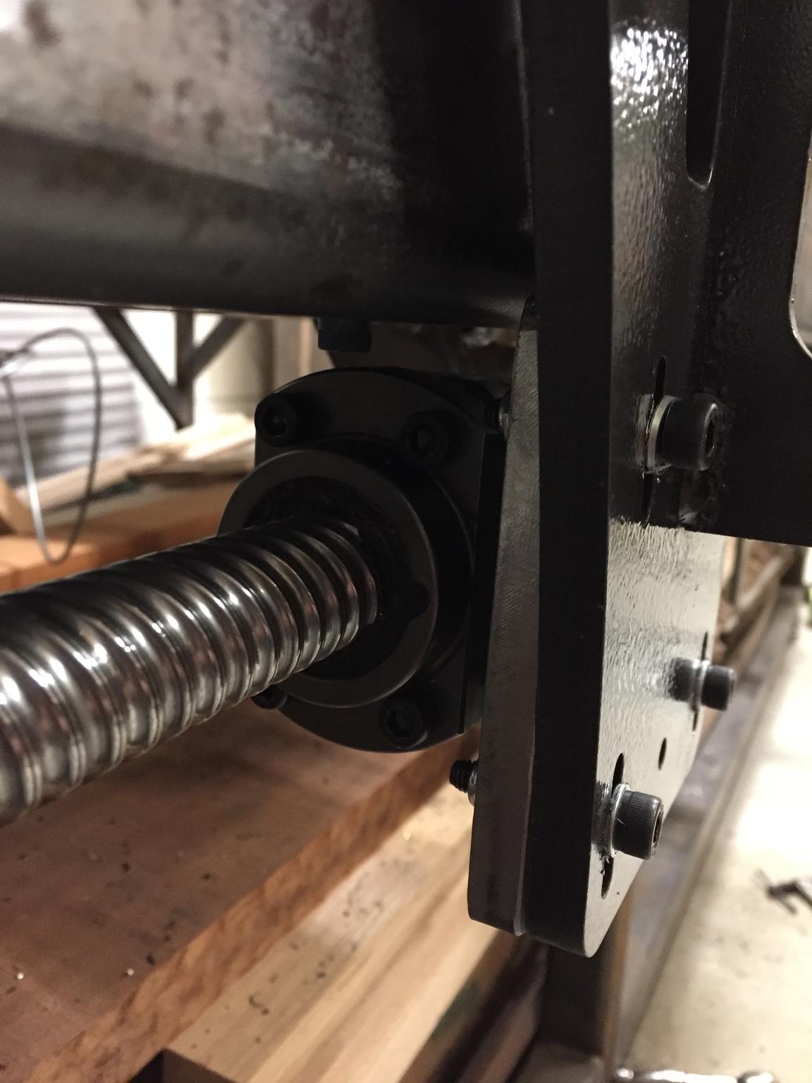

Ballscrew to Z axis plate, made with steel I had on hand
Attachment 19867Attachment 19868Attachment 19869

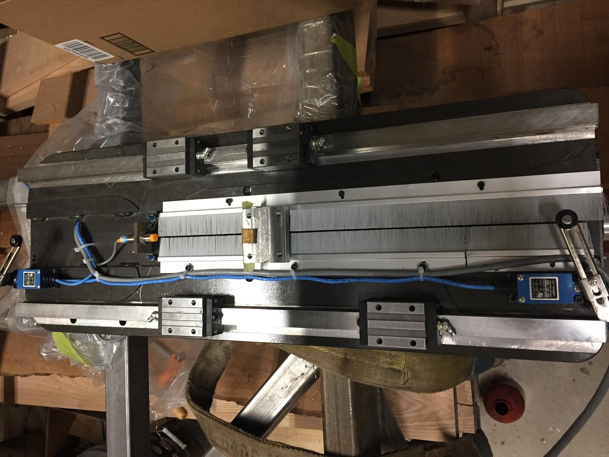

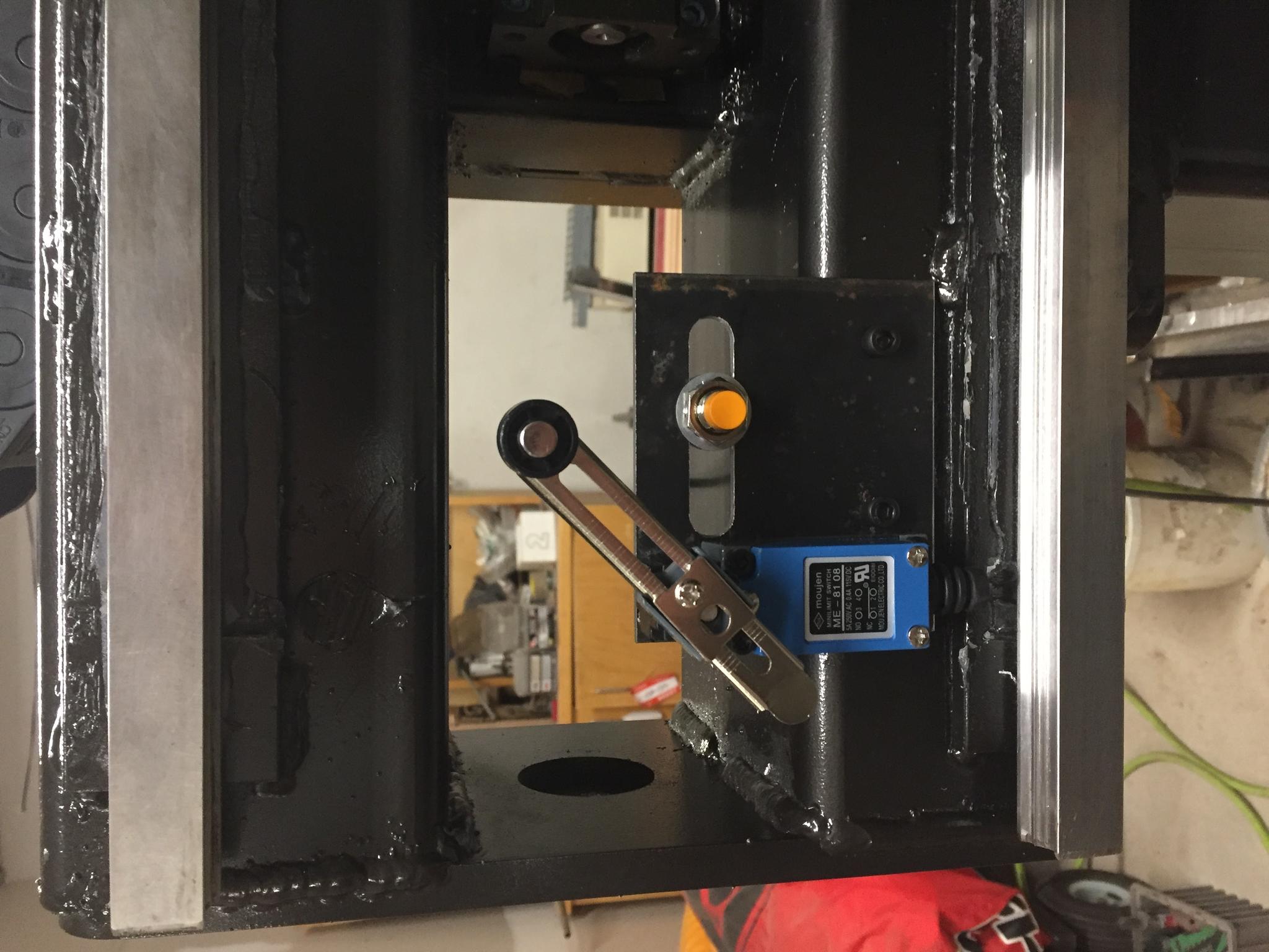

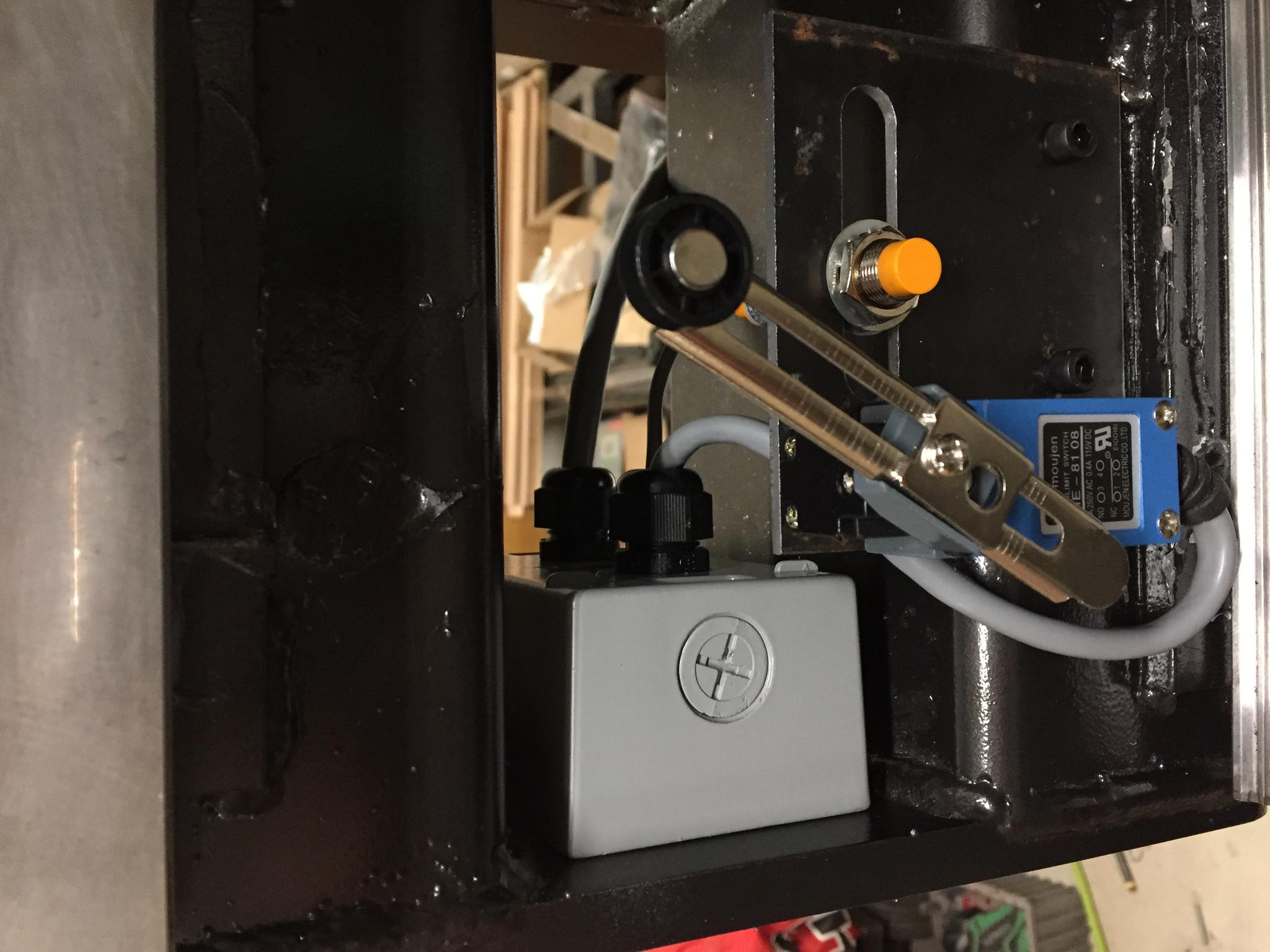

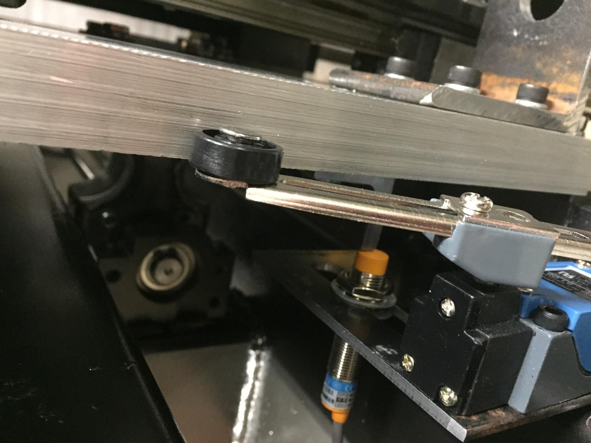

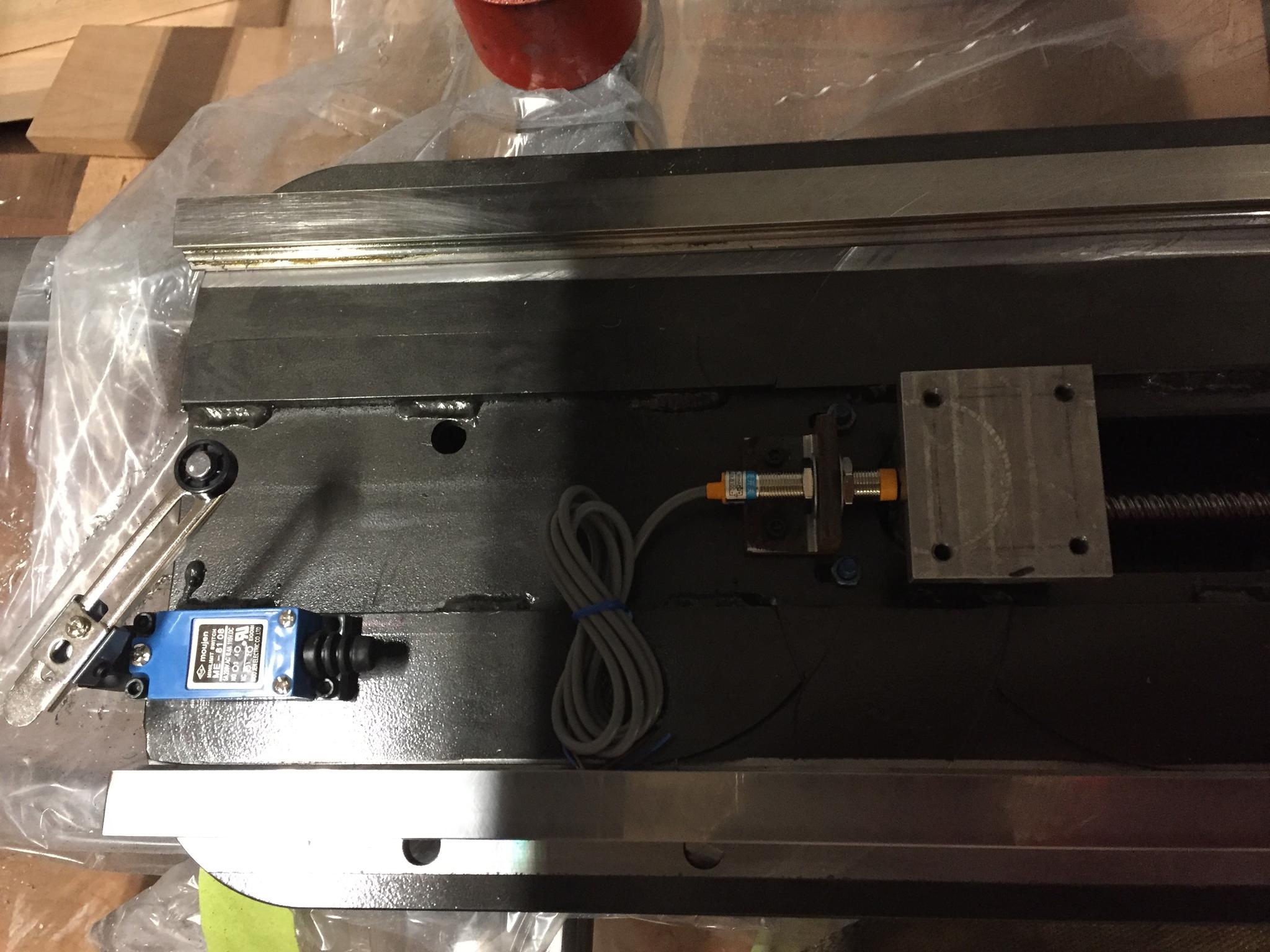

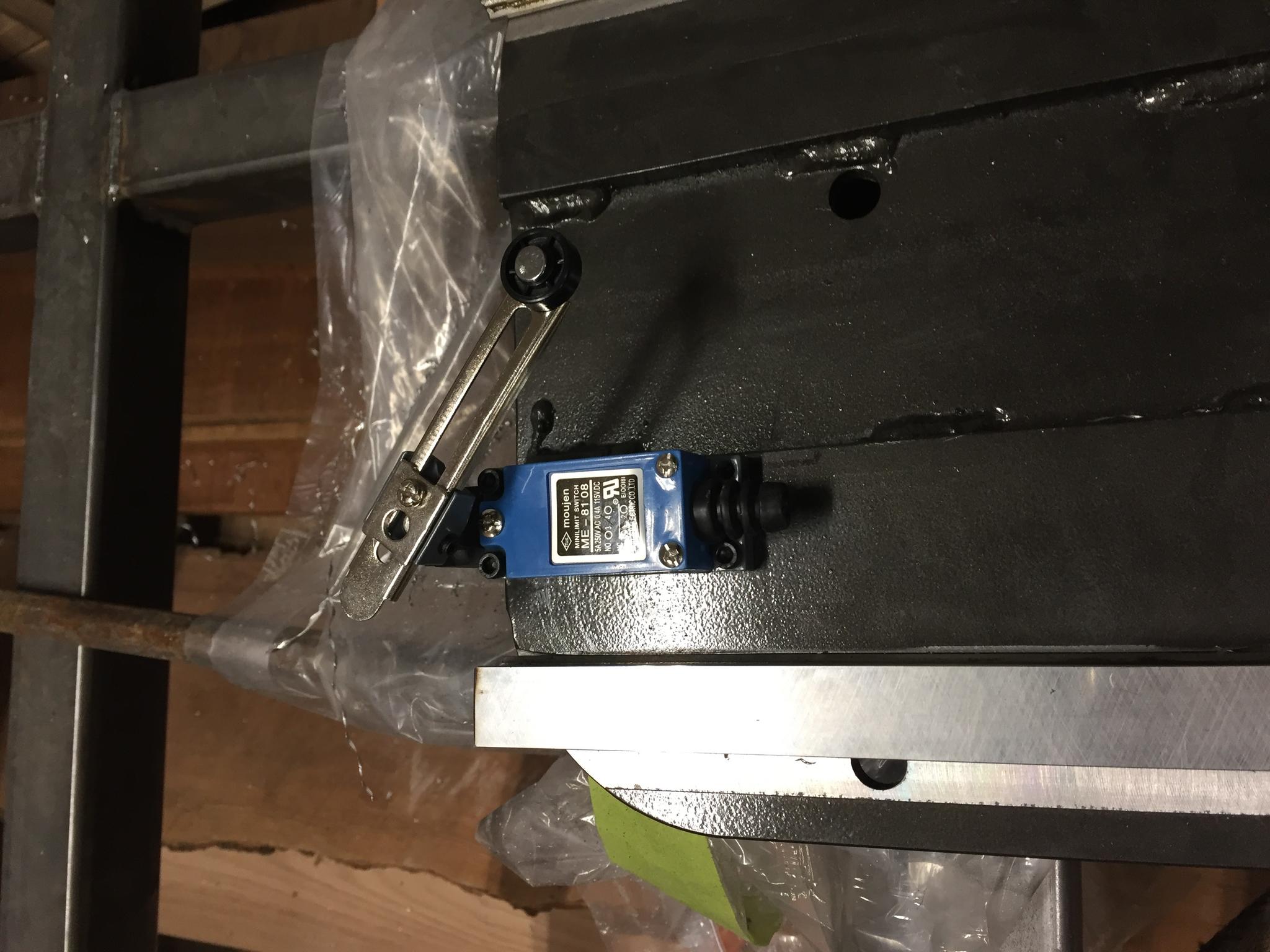

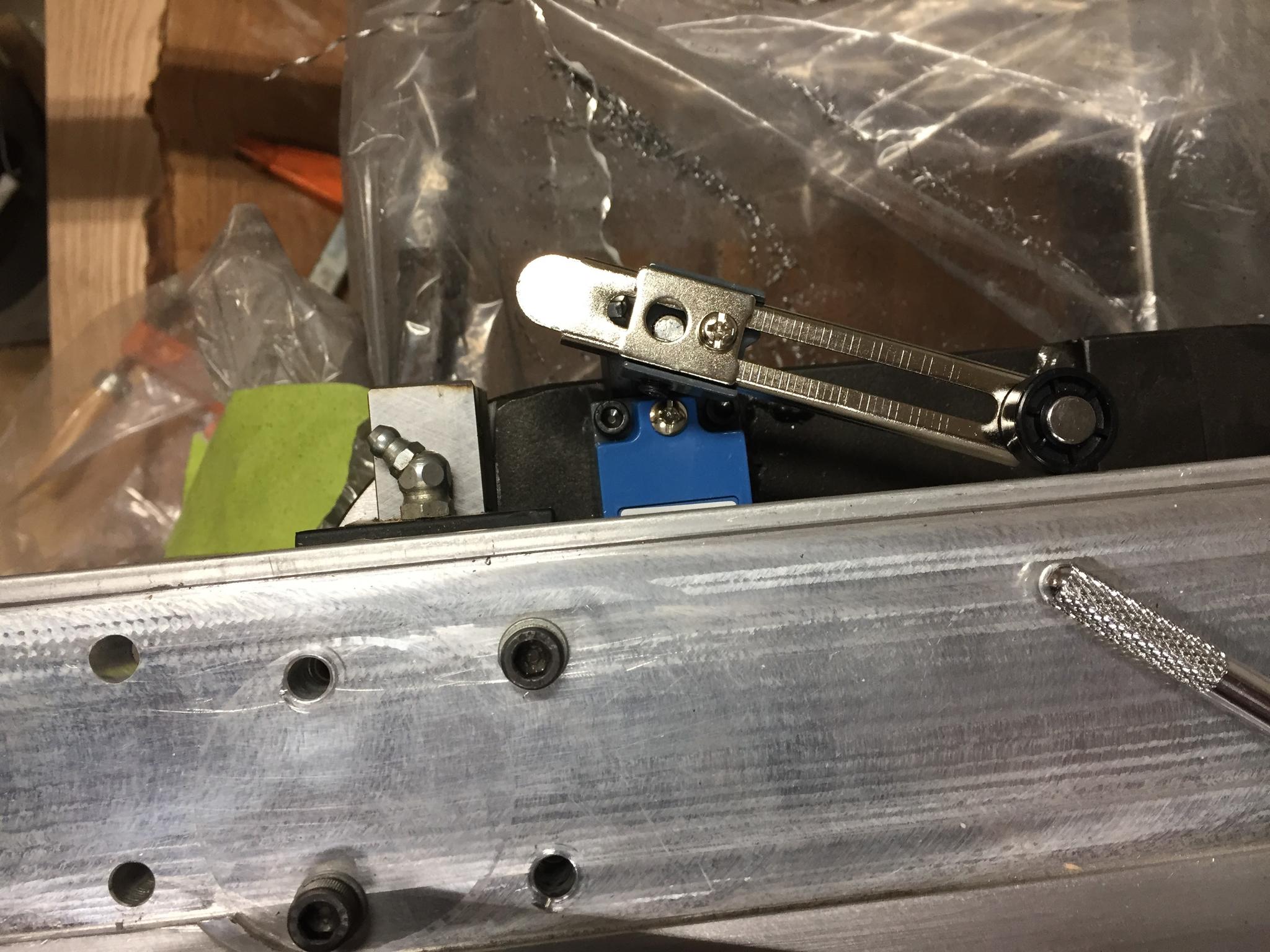

Installing limit switches for Z

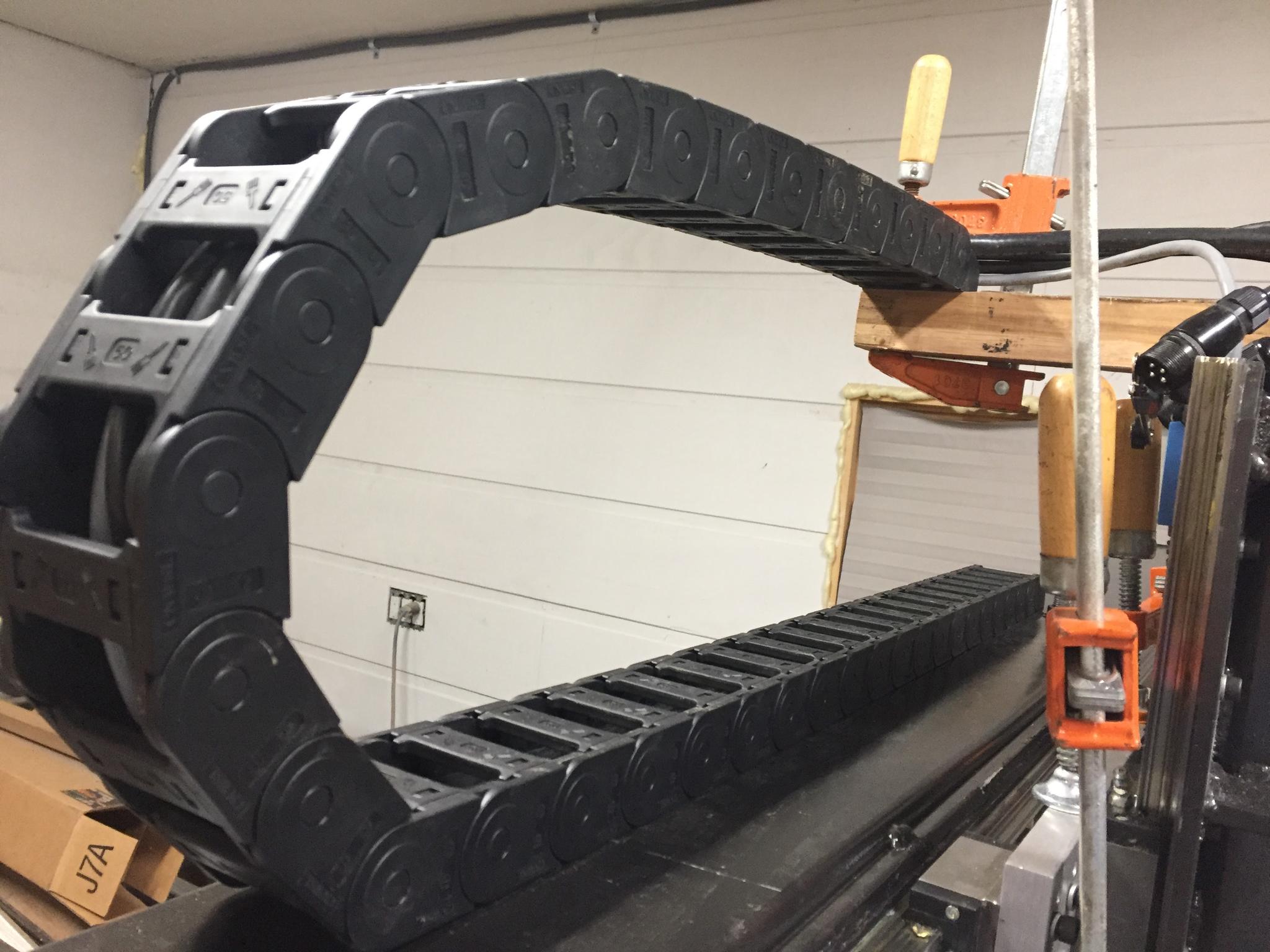

Attachment 19870Attachment 19871Attachment 19872Attachment 19873

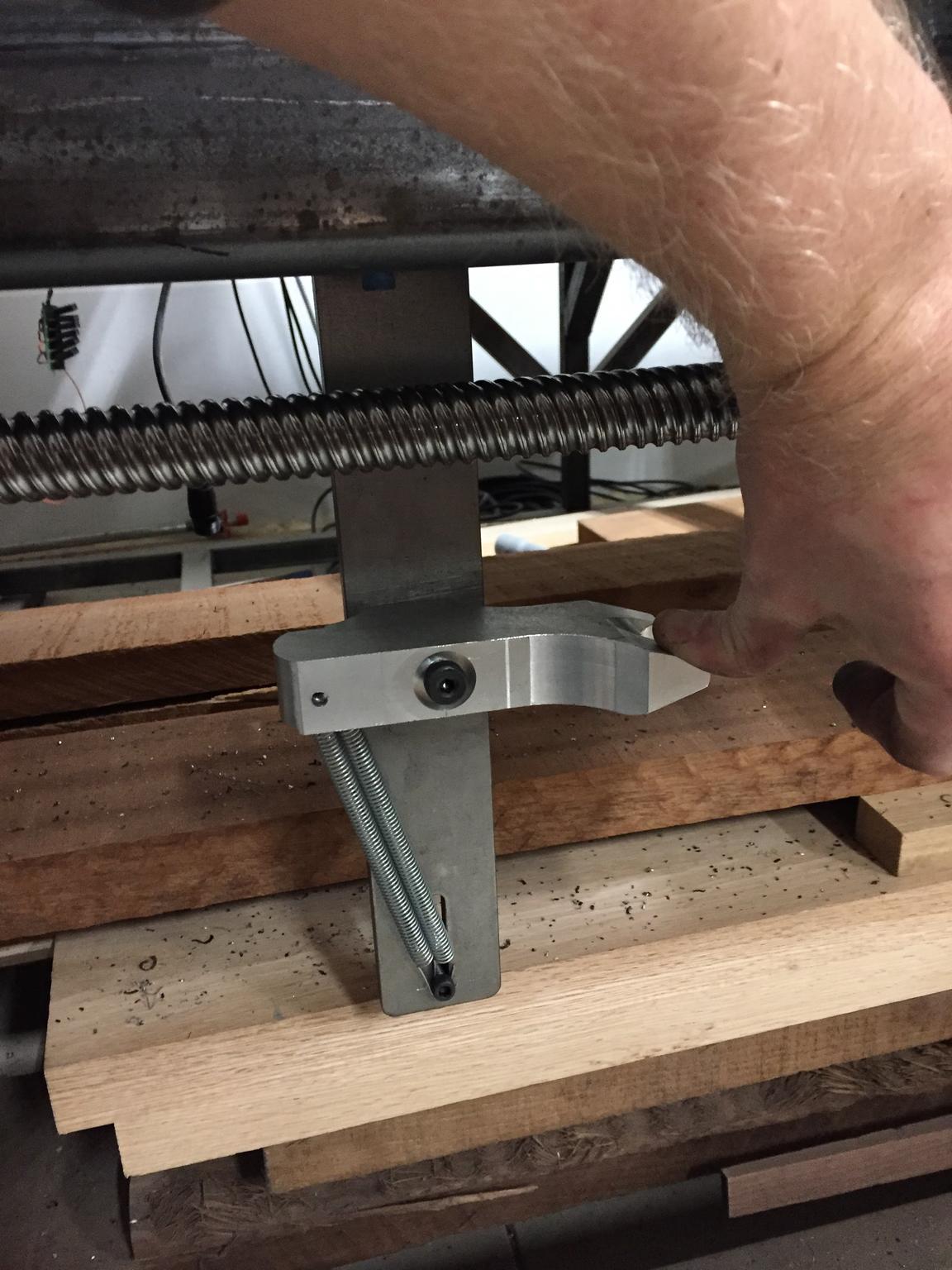

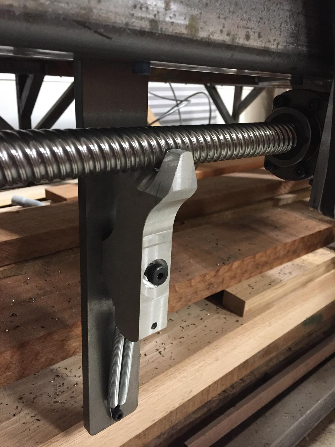

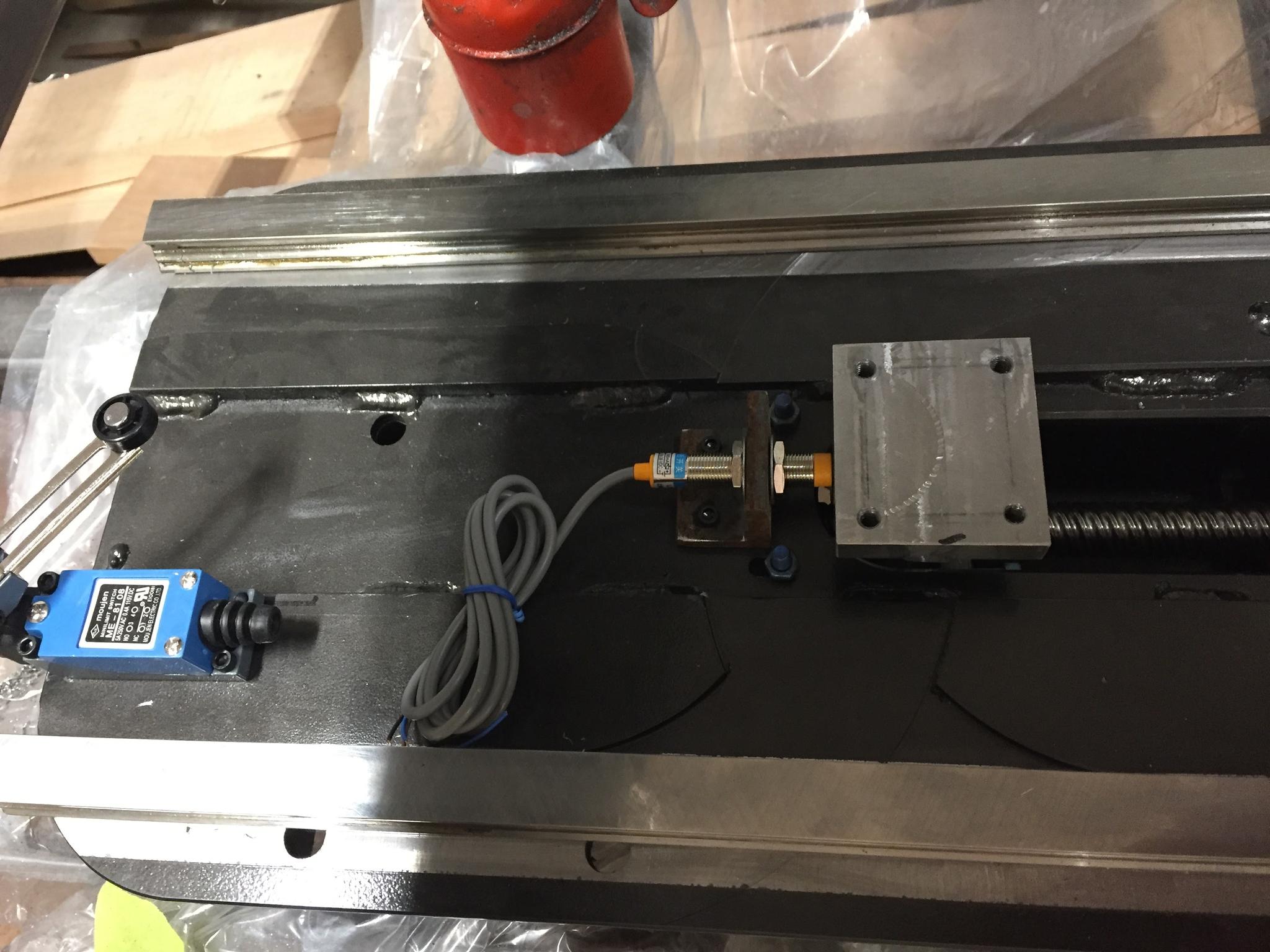

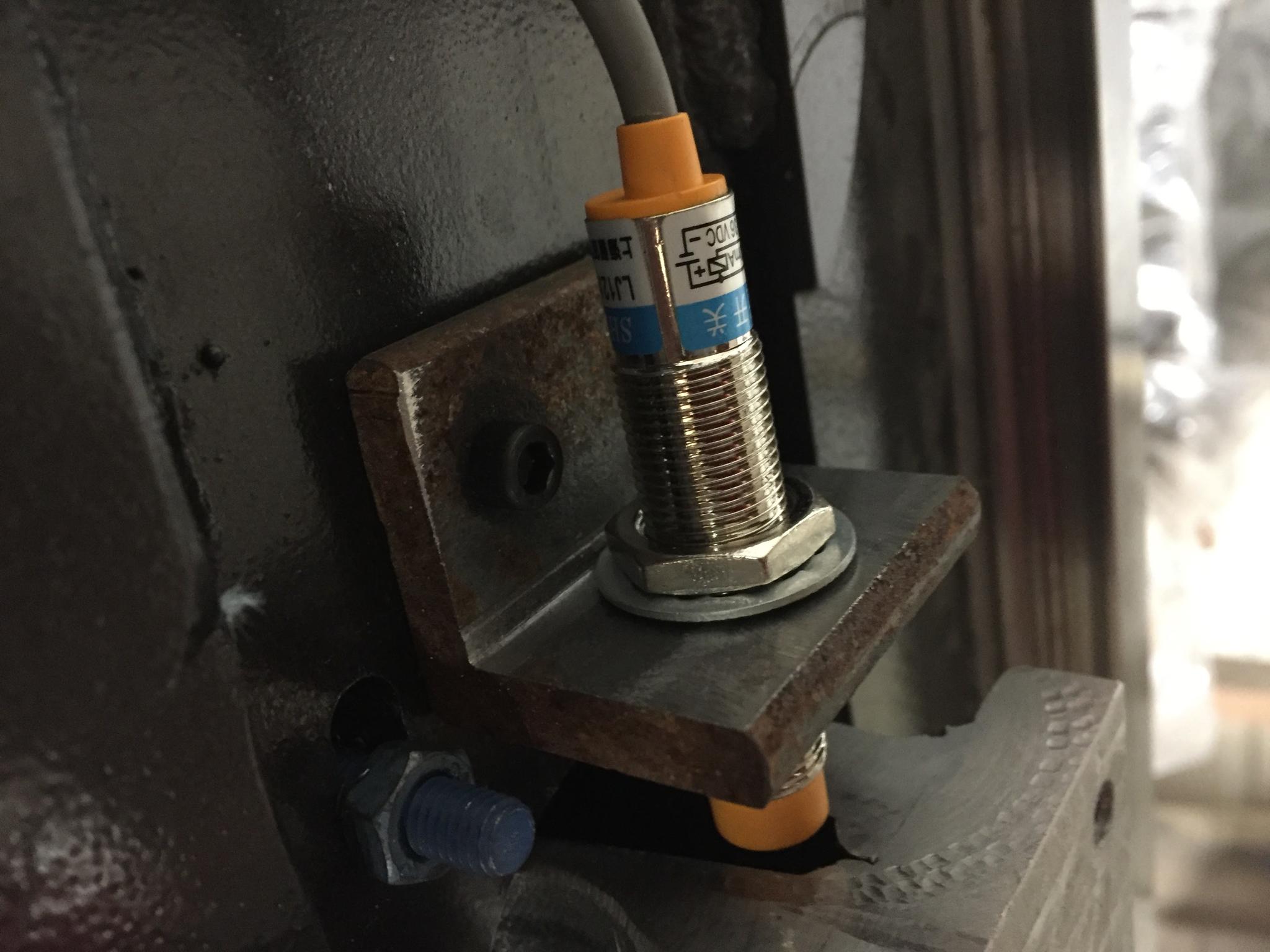

Z home Prox Switch
Attachment 19874Attachment 19875Attachment 19876Attachment 19877Attachment 19878Attachment 19879

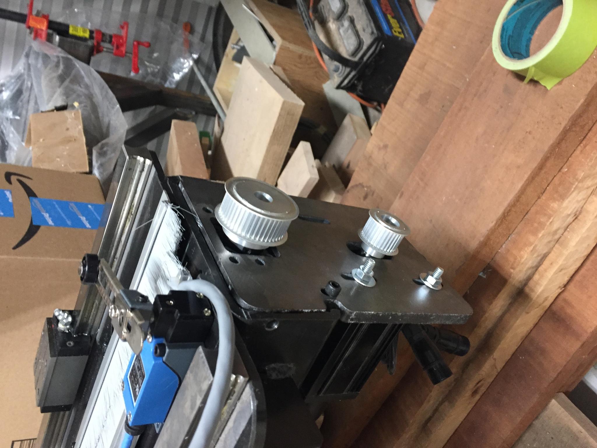

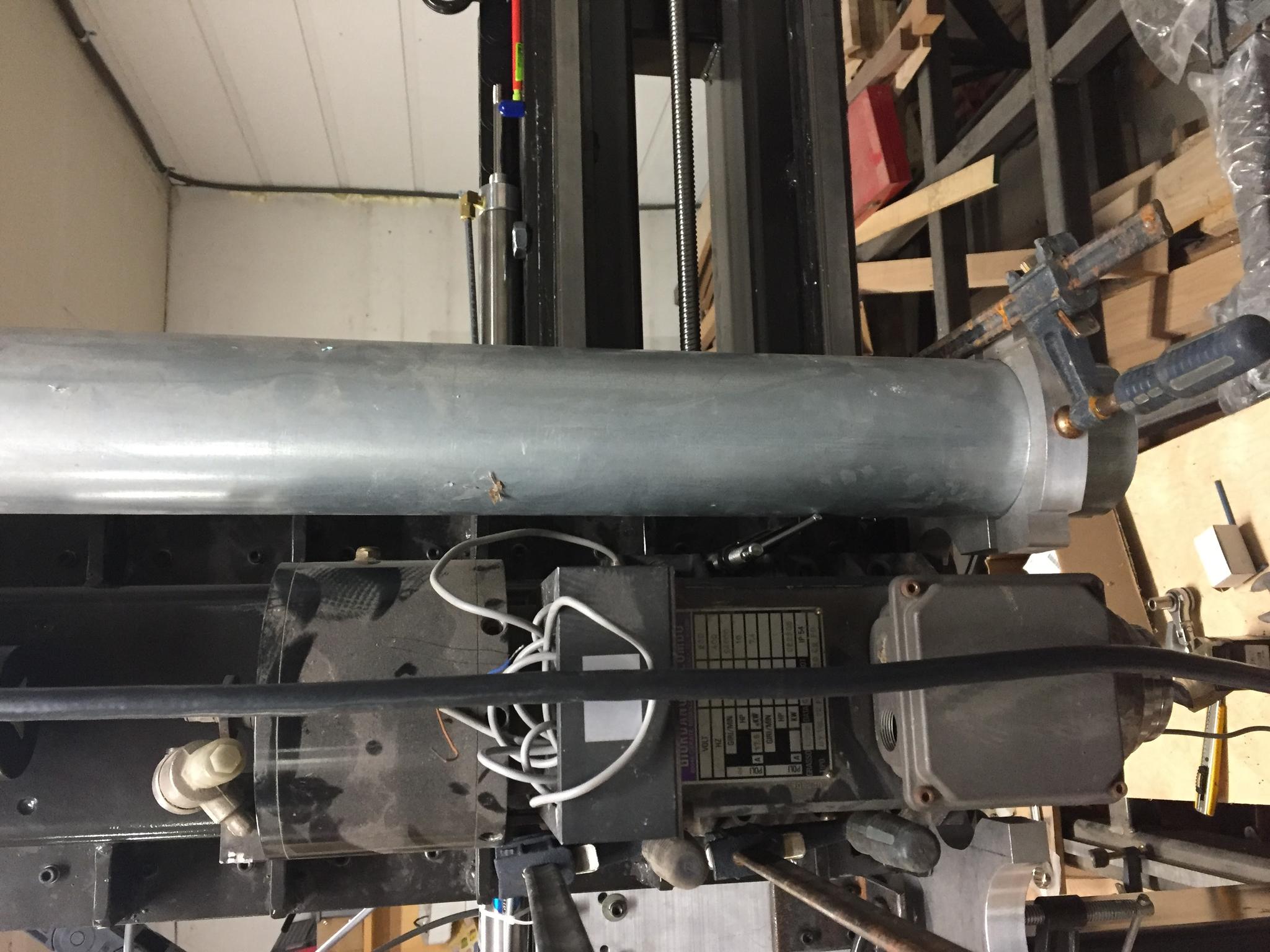

Finished underside of Z axis with dust shielding in place
Attachment 19880Attachment 19881Attachment 19882Attachment 19883Attachment 19884Attachment 19885

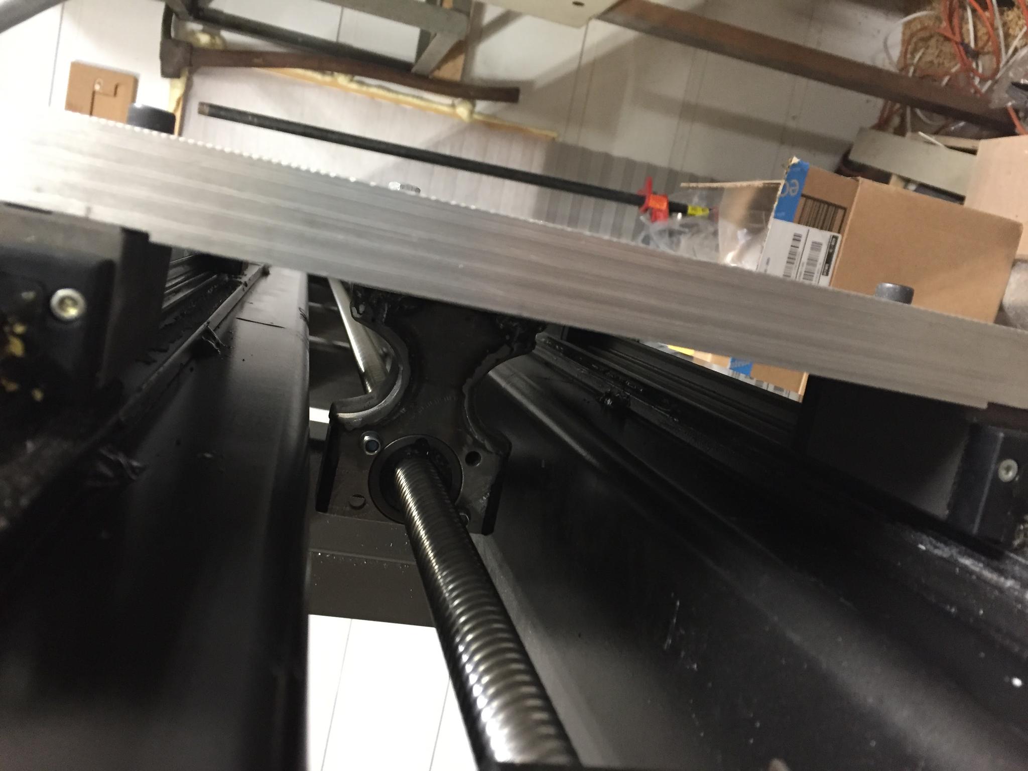

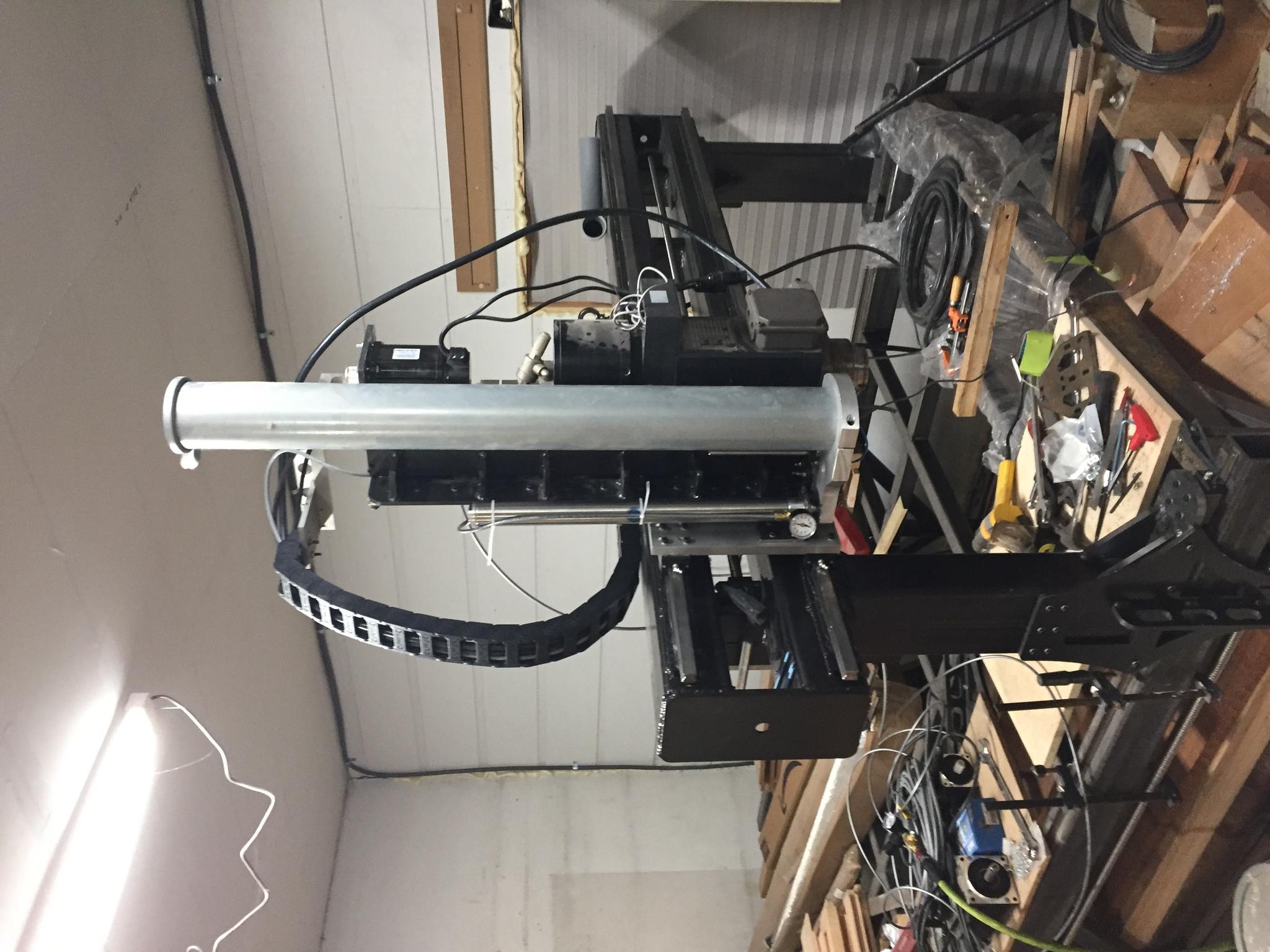

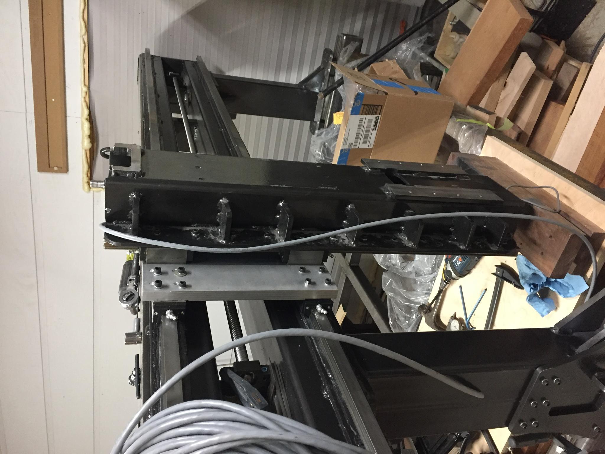

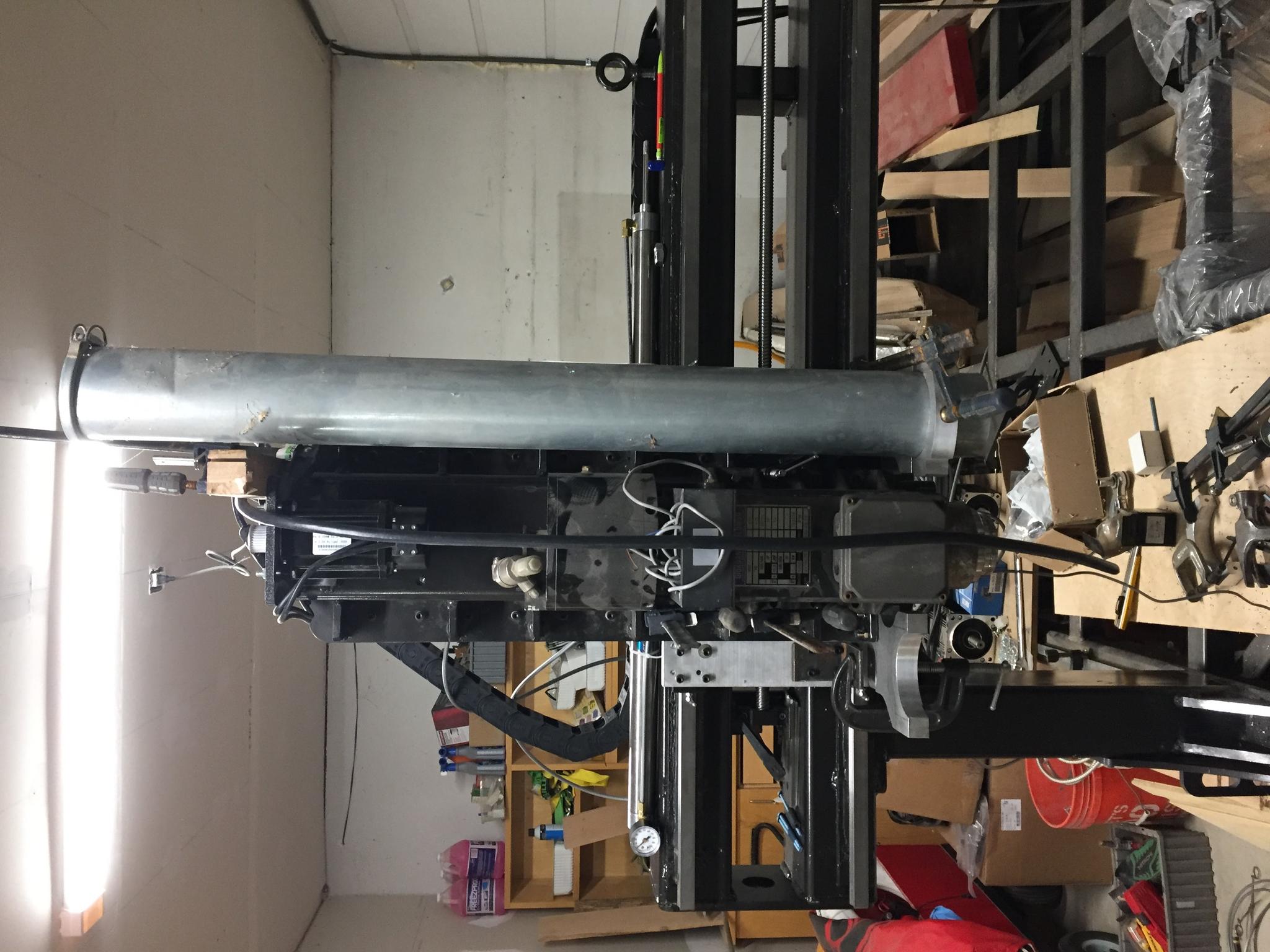

Z axis installed onto Y axis/gantry
Attachment 19886Attachment 19887Attachment 19888Attachment 19889Attachment 19890Attachment 19891

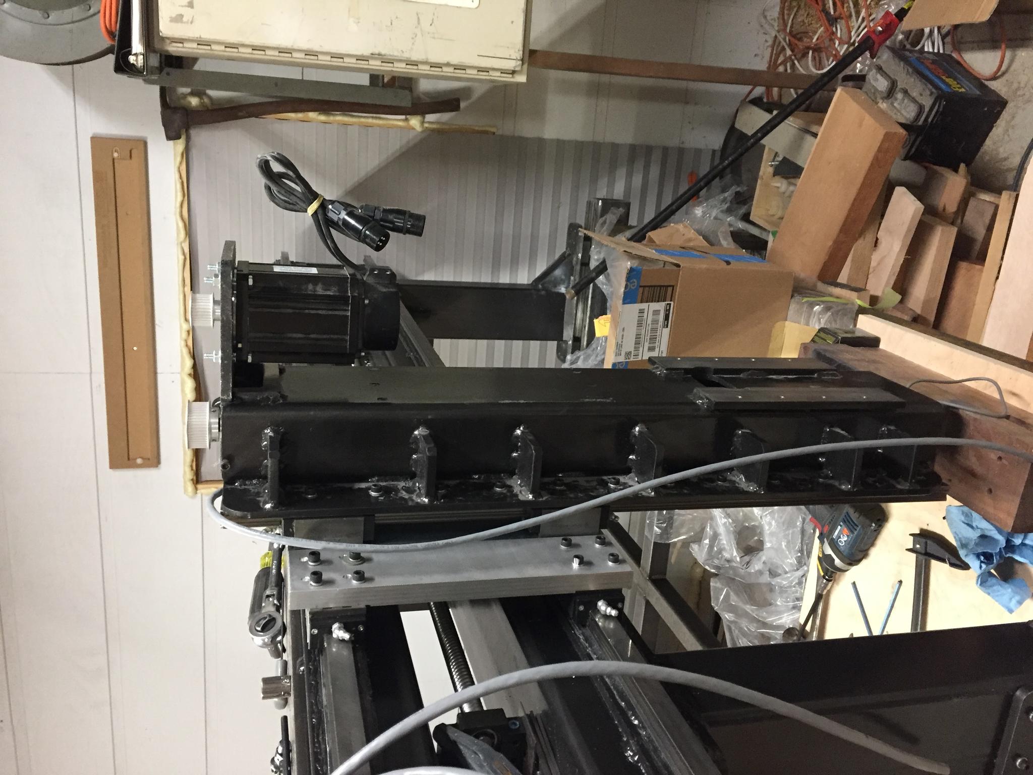

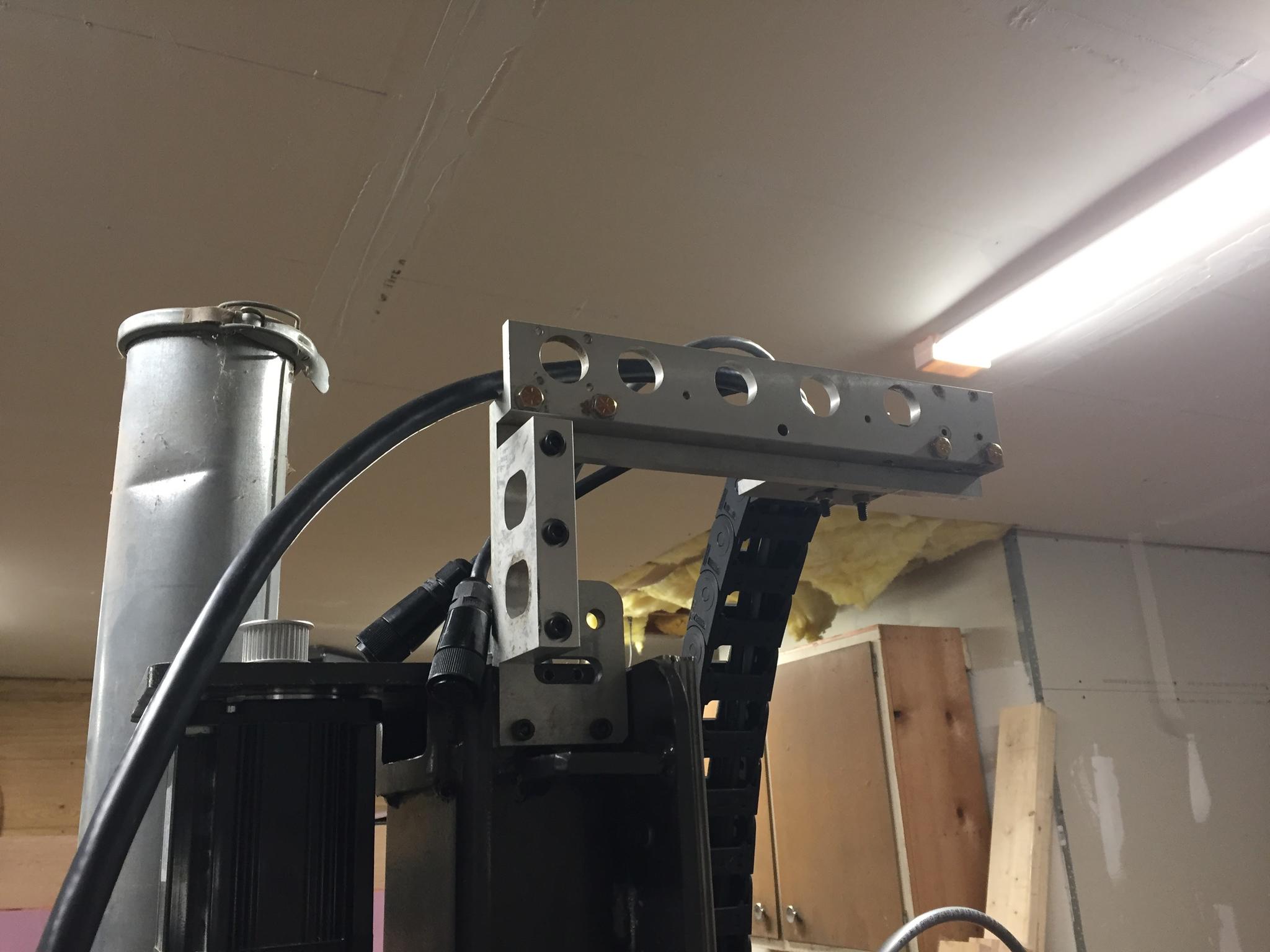

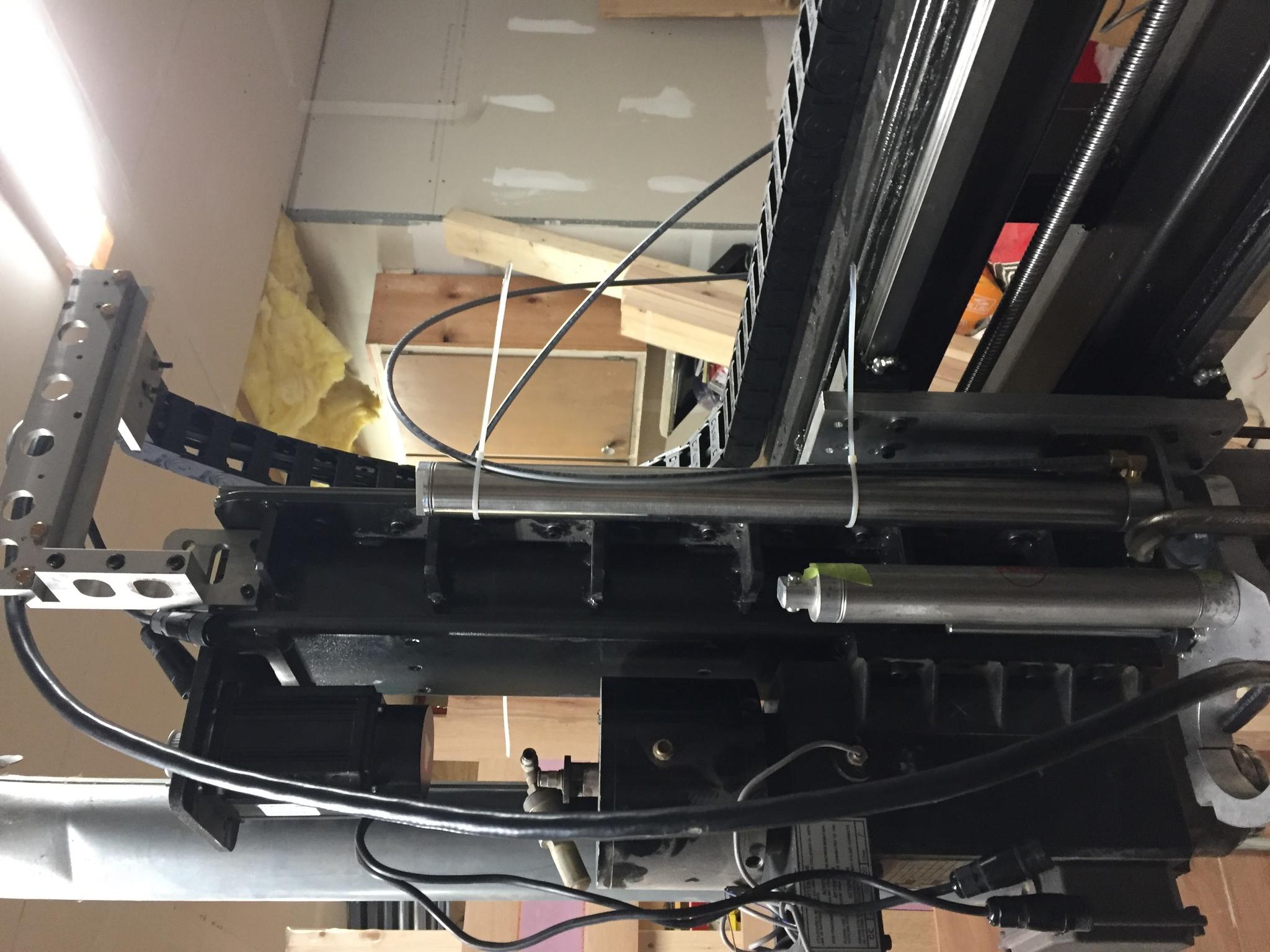

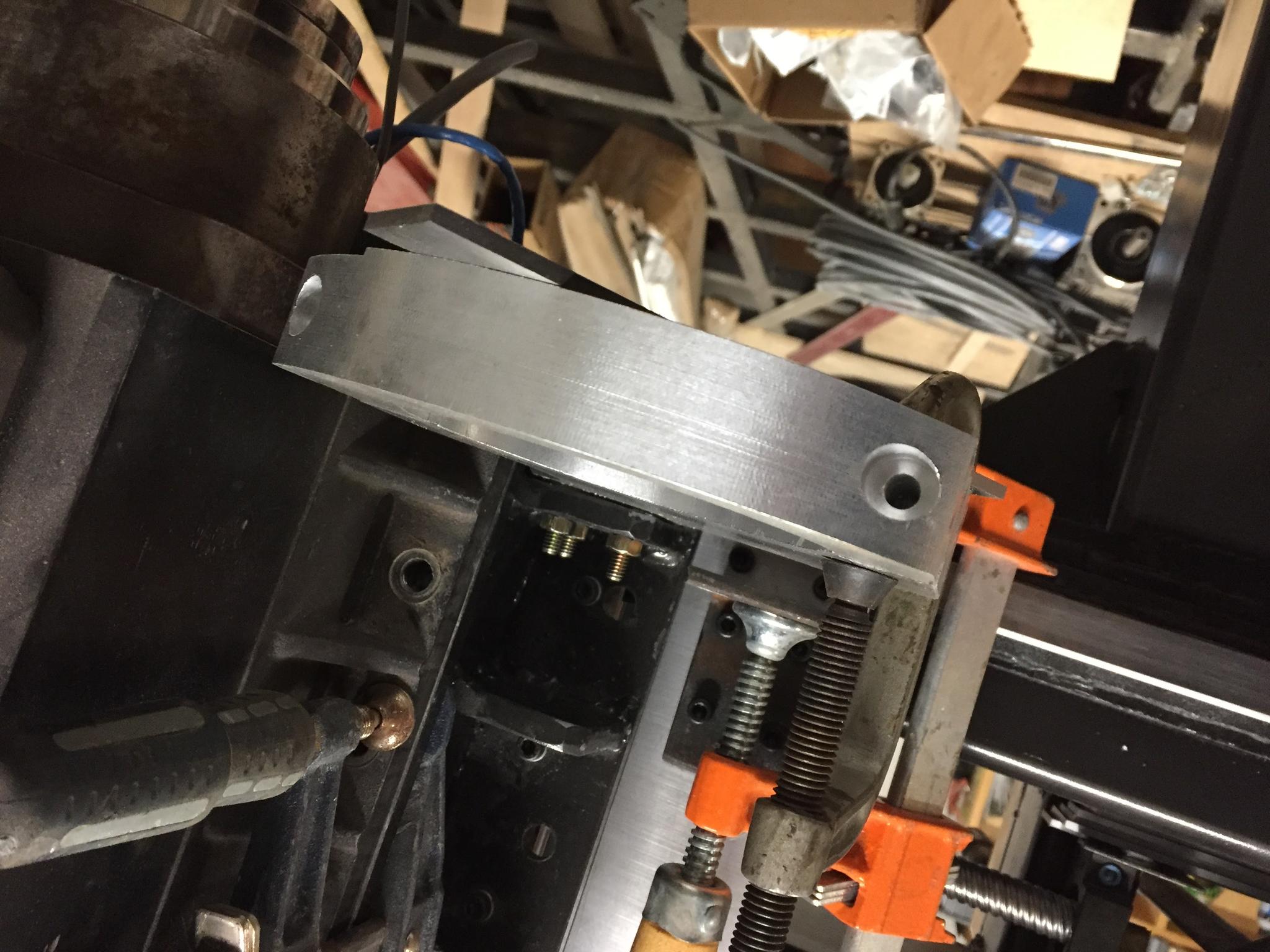

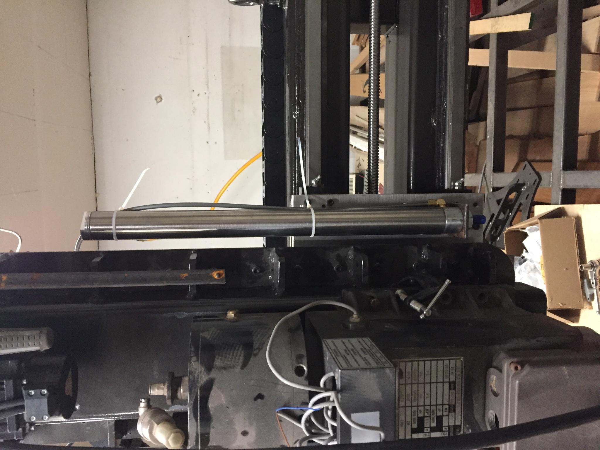

Lots more Z axis mockup
Attachment 19892Attachment 19893Attachment 19894Attachment 19895Attachment 19896Attachment 19897Attachment 19898Attachment 19899Attachment 19900
Building brackets for dust collection holding and pneumatic counter balance system
Attachment 19901Attachment 19902Attachment 19903Attachment 19904Attachment 19905Attachment 19906
Machining and installing guides for dust shroud, shroud/brush will be on pneumatic cylinders so it can be pulled up when needed and also when I add the tool changer.
Attachment 19907Attachment 19908Attachment 19909
As it sits today, my plan is to work backward from the Z axis finishing each axis as I go. Sorry for the dump with little text but I wanted to update this with where things are. I can give any specific information as needed

4 Attachment(s)
Made a tiny bit of progress last night. Got one of the Y axis limits and also the homing prox installed.
Attachment 19992Attachment 19993Attachment 19994Attachment 19995
Davek0974
Chinglish and unless you know exactly what parameter does what, then its all guesswork.
Dave, This is exactly what I was worried about when digging into the servo itself. I think if I get a bit more understanding of servo driver tuning I will have a better chance of understanding the Chinglish... I hope.
Boyan, that is a very good point, I never checked the max acc and decc in the servo drive. Likely that is the limiting factor. I didnt think about it until now but as I increased the acc I didnt notice an increase physically so probably the servo drive is limiting. I will have to take a look tonight.
Which by the way is well described on many places around the web, but i still fail to comprehend it entirely .
I totally agree, seems like each spot that describes how to tune a servo does it slightly different, making it more confusing for those of us just getting into it... Like Jazz said Black Magic
Thanks for the help!

5 Attachment(s)

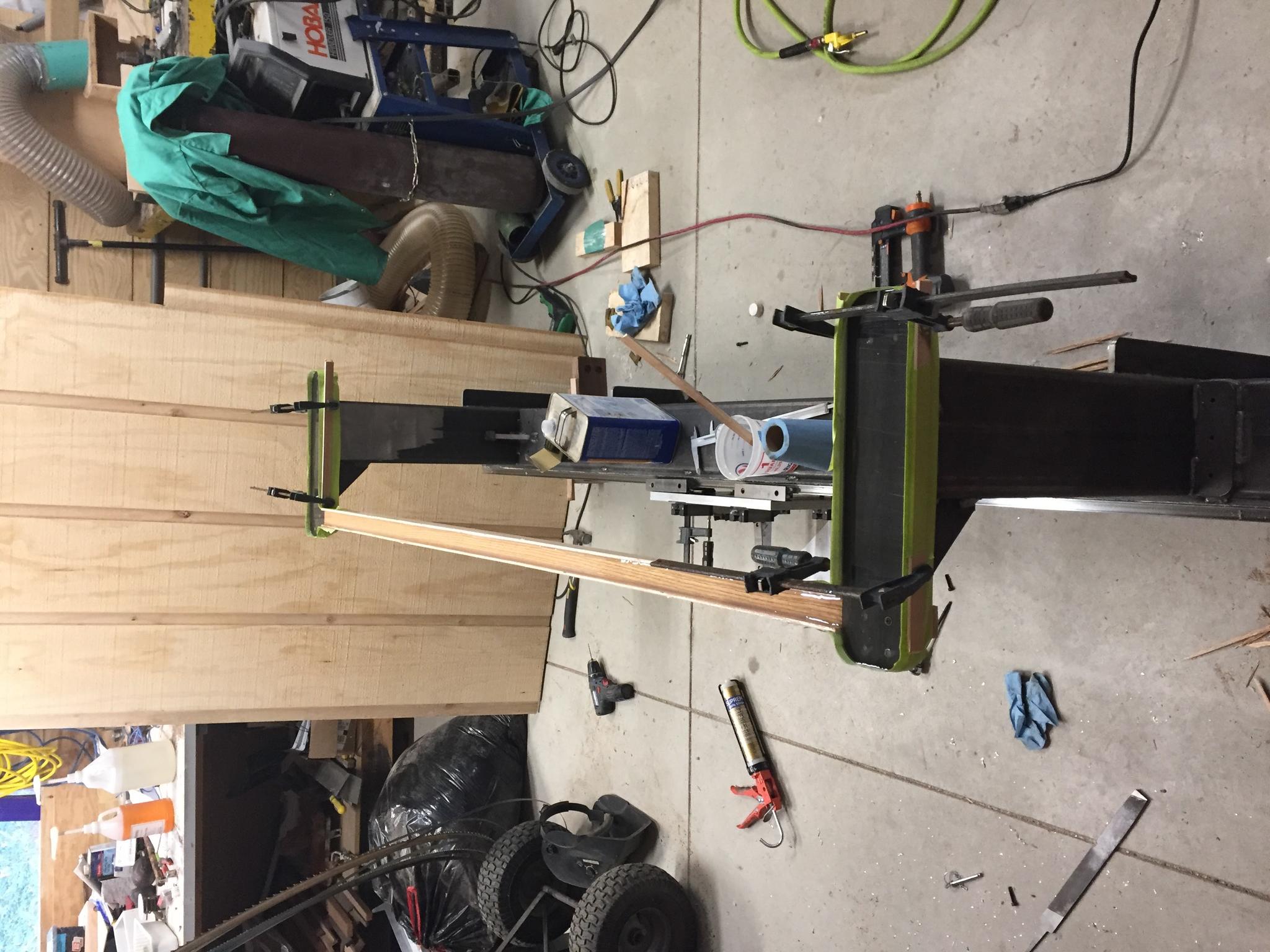

Made a bit more progress over the weekend,
Got one of the X axis screws mocked up
Attachment 20043

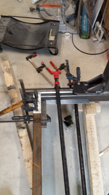

Here I am machining the spring loaded brackets that will act as X ballscrew mid supports. These will support the screw and when the gantry goes by will move out of the way on the pivot. I need to get some shoulder bolts still for these and do a bit more machining for clearance of the ballnut as it passes (to ensure that it cant get hung up on a change of direction).
Attachment 20039
Attachment 20040
Attachment 20041
Attachment 20042
I also got a air valve block installed on the gantry for all the air that the Z axis needs, also put a terminal block on the gantry in order to reduce the number of wires that needs to make its way back to the control. I ordered some 20 conductor shielded communication cable to go from the control to the gantry terminal block. Gives me a few extra wires incase I need any future expansions or additions.
Im getting excited as its closer and closer to cutting. I am waiting on new toothed pulleys for the Y and X as I made a mistake when ordering, once those are in it will be time for truing and squaring then cutting.
More to come....
6 Attachment(s)
Some more progress made, I got the ballnut mount made and installed and also finished one of the ballscrew mid supports. I made a video of one of the ballscrew supports in action, I am just pushing the gantry back and forth. I pushed the gantry from one end to the other as fast as I could and this one support seemed to damp the ballscrew frequency. Im hoping to finish up this side tonight and then do it all over again on the other side.
https://youtu.be/0gP4IUO0QKg
Attachment 20052
Attachment 20053
Attachment 20054
Attachment 20055
Attachment 20056
Attachment 20057
I need to do some learning on tuning 2 X axis servos at the same time, if anyone has any suggestions im all ears.
