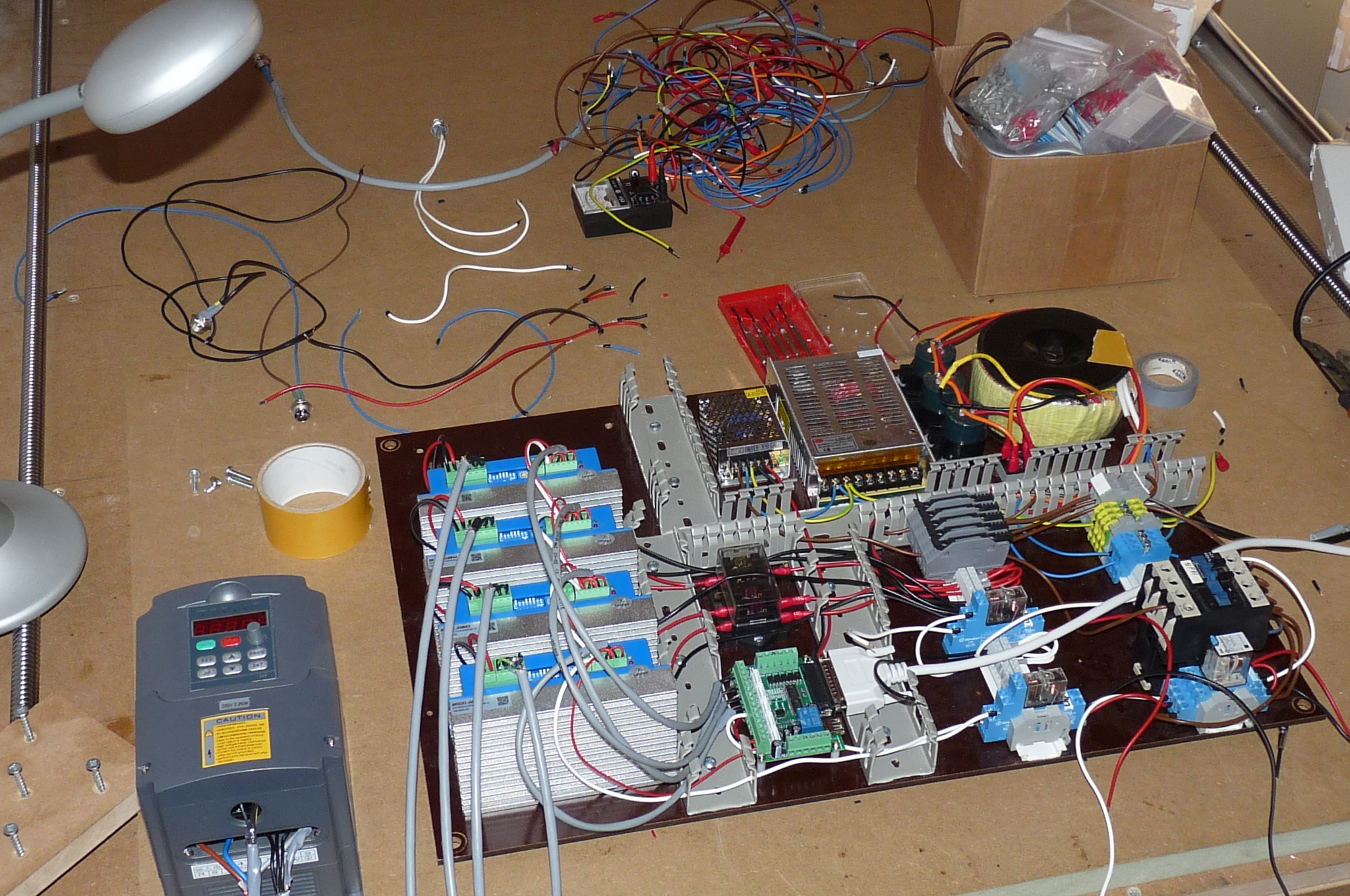

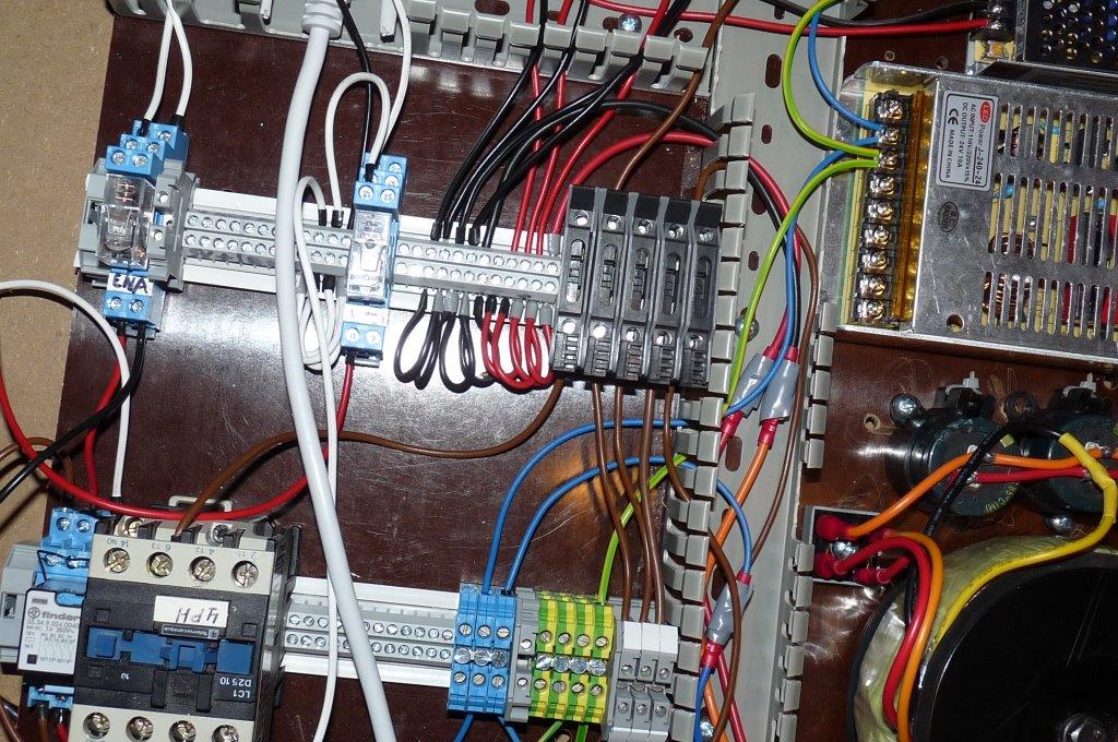

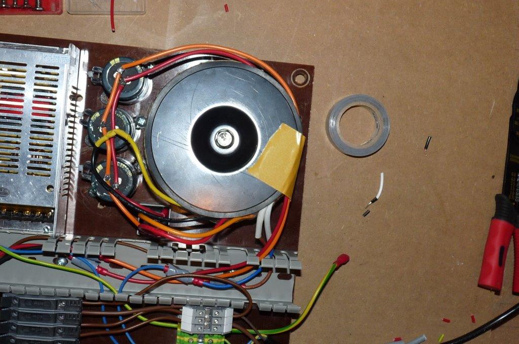

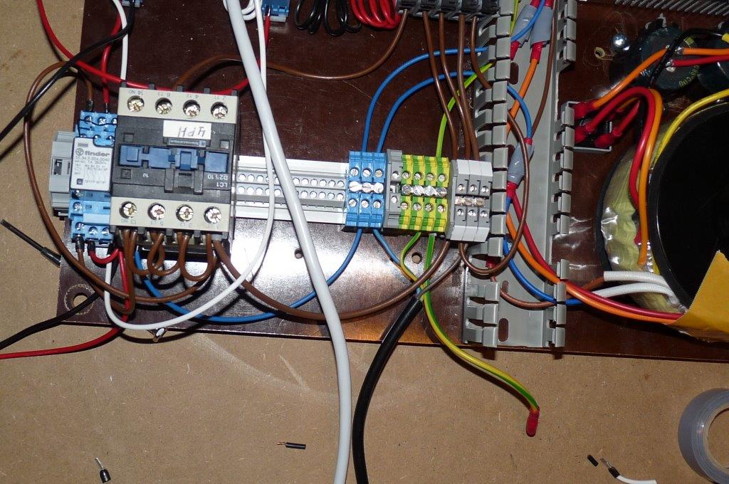

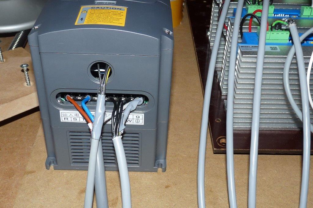

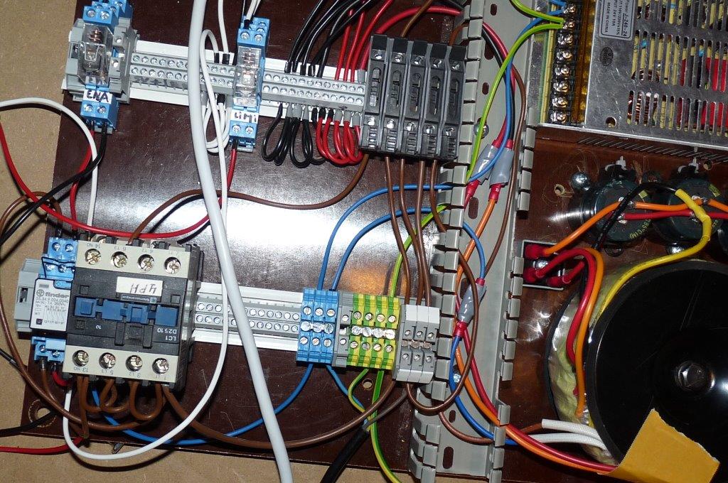

Not related to interference but for safety - I was just looking at the 4th photo in post#1 ('dsc_0004.jpg') and noticed that the blue and brown cables going to the toroidal power supply appeared to be connected to incoming cables using male/female spade connectors. There looked like there was exposed metal on at least on of them.
If they are indeed the mains supply cables I don't think this is a good idea. Either put some heatshrink over each joint, or better still solder the cables together, heat shrink each individually, then heat shrink over both.

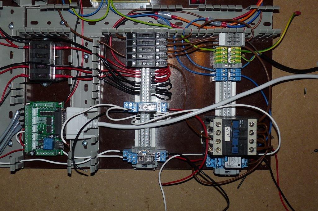

So I unwired everything in the control box. Rewired separating power lines from control lines, and reducing enormously the amount of cables in there by chaining +5V and enable between the BOB and drivers. I now use 2 core shielded cable for the PUL/DIR signals. That made the wiring a heck more simple. Limits are not yet wired, homes neither, and the 24V PSU is not powered. Guess what ? Works like a charm !
So now I'm going to move forward step by step, making sure that each increment does not cause noise to appear.
Things look muuuuuuch neater now :) I'll keep you posted. As for the ferrites, I'll order some of them just as a safety.

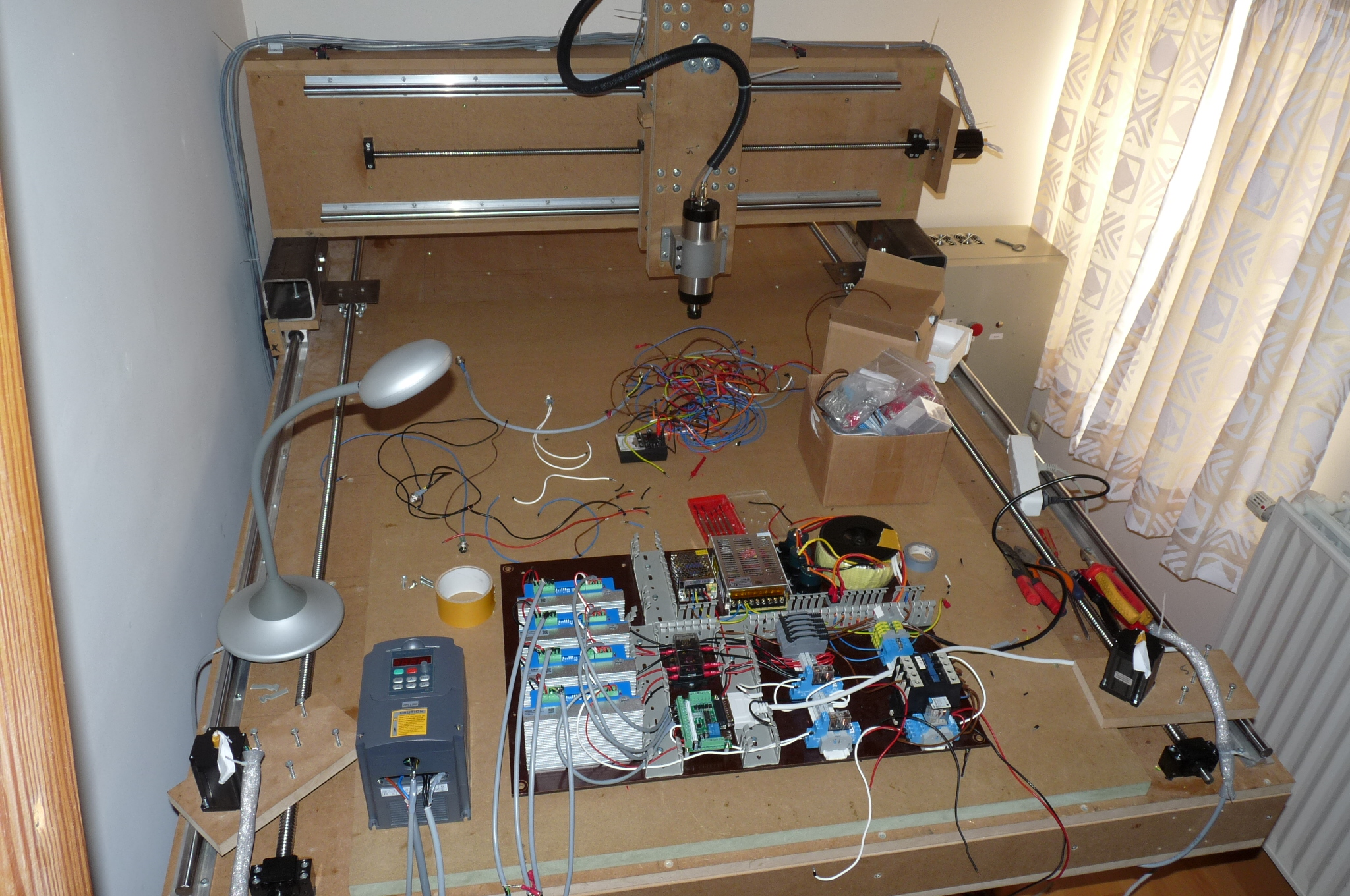

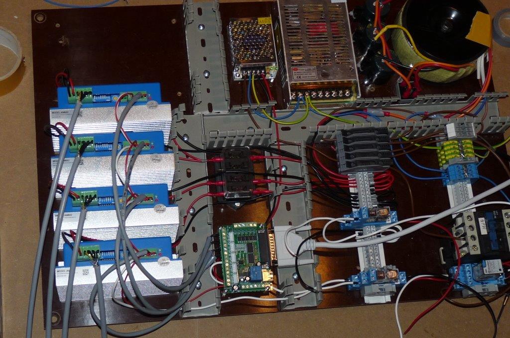

Yes, the building earth goes to the electric company I believe. Standard setup here. I am actually not using any box anymore, it's all out of the box, screwed on a fireproof plate (not metal). I am sorry I haven't posted pictures. Here it is:

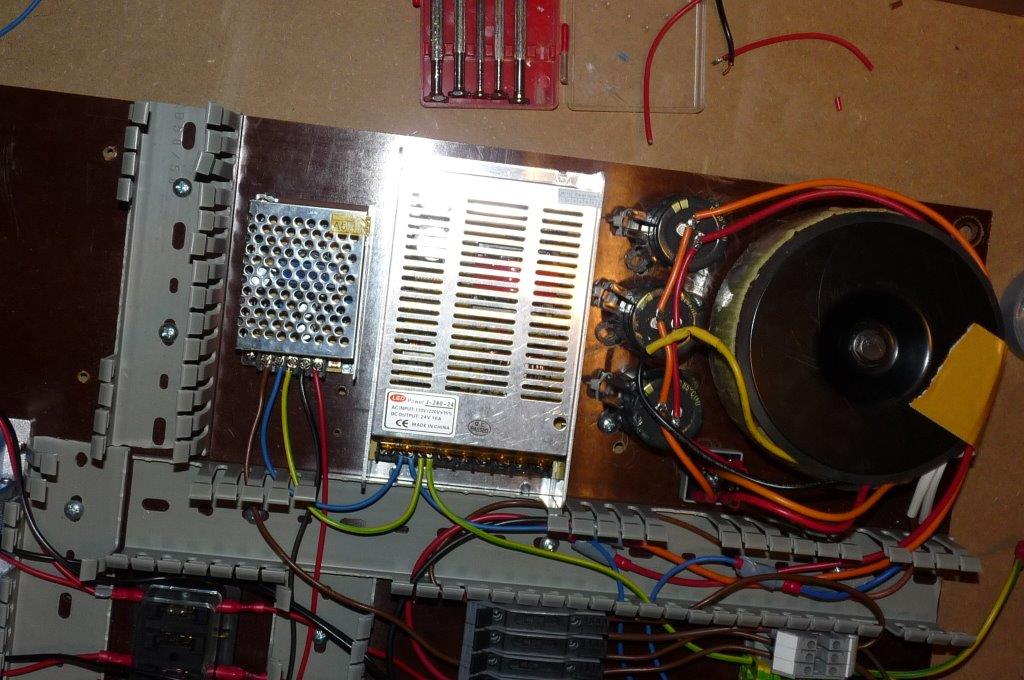

The X motor plates have been unmounted to prevent the gantry from twisting. The fireproof board is out of the box for easy access and testing.
Attachment 17947
All relays are not wired, there is no e-stop, no reset button, no contactor, not fans, no switches (only a switch on the power cord extension), no 24V power supply (Earth and Neutral are daisy chained with the 5V PSU, but there is no Load going to it as you can see).
Attachment 17933Attachment 17934Attachment 17935Attachment 17936Attachment 17937Attachment 17938Attachment 17939Attachment 17940Attachment 17941Attachment 17942Attachment 17943Attachment 17944Attachment 17945Attachment 17946
So, here is what happens:
1. drivers powered, Mach3 in reset mode, motors disabled, VFD powered, spindle off
2. click reset in mach3, motors are powered, enabled and locked
3. I can jog fine on each axis
4. press RUN on the VFD, spindle starts spinning right away. half a second after pressing RUN, I can feel (with my hand) and hear the motors move a few steps (ike 2-5 I would judge by feeling). Obviously I can't put my hands on all motors simultaneously, so I try one by one (the VFD is wired separately so I can carry it around with me).
5. press STOP on the VFD, same thing, right before the spindle stops spinning (so I would say in the lower frequency, around 500/1000 RPM), the motors move a few steps.
There are two parameters to the noise:
1. the time offset between the moment I press RUN or STOP. I guess this depends on the time it takes to get to the problematic frequency.
2. the number of uncommanded steps the motors move
If I press RUN, then wait until the spindle reaches the desired speed (100Hz), then press STOP, wait until it stops, and repeat this process a few times, I would say the problem occurs 7 times out of 10. The number of uncommanded steps and the time offset are always random.
Hope you can see things better now :)

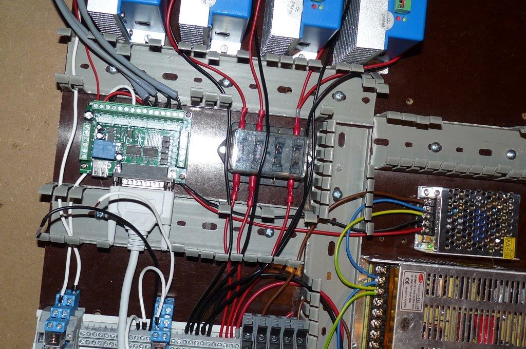

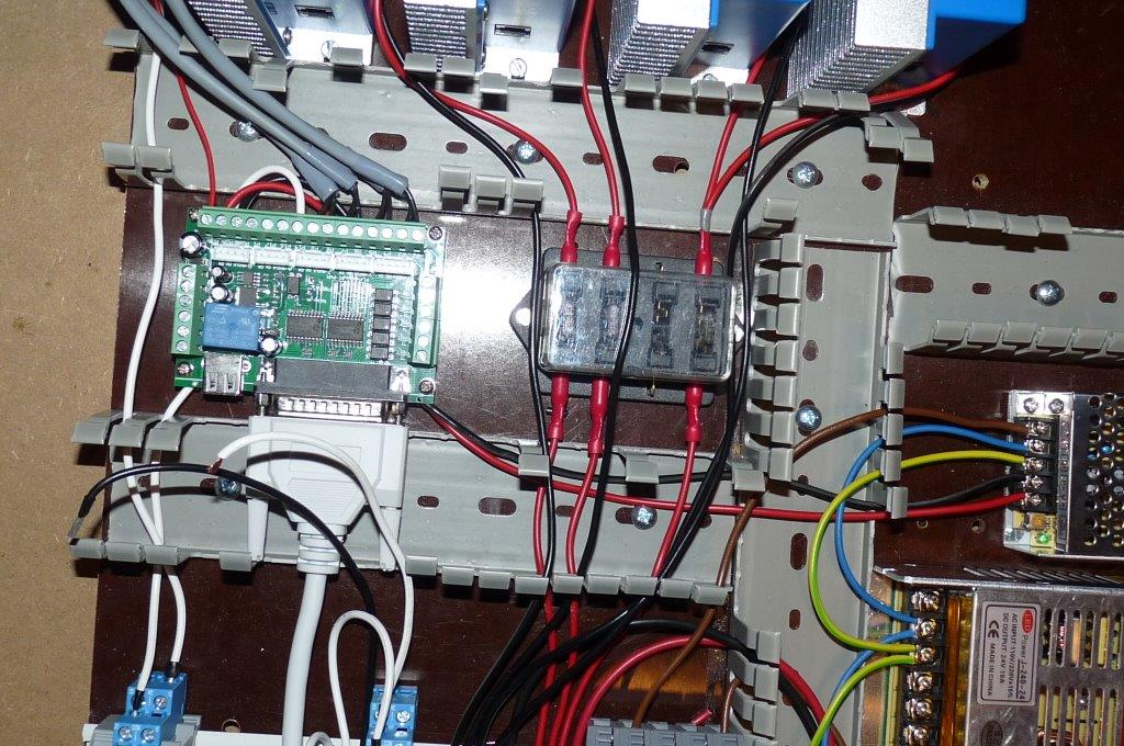

I can see one problem straight away. You have no main power to the BoB. In the (invisible) picture below the two middle connectors on the right are the main power (12 - 24v) for the BoB electronics. Without that you will get all sorts of random effects.
I tried to copy and paste from the pdf of the BoB manual, but it didnt work - anyway OP has BoB manual.

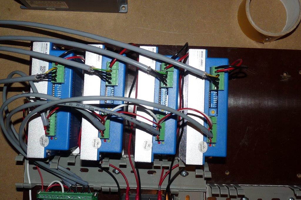

Looking at your signal cables between the drives and step/dir on the BoB - you've used shielded cable, but I can't see if they are earthed?
I seem to remember that you can also power it through the USB socket. You could try this from the PC, if this works then longer term use a USB plug and lead but cut the cables, identify the power supply cable and wire it to an external 5V supply.

You are right about the BOB's signal cables. STEP and DIR are CY-2 0.5mm^2. The shield is not earthed. I know I should, this was just really me trying to get minimal connections.

Yes, that's right, but there are two terminals made to replace the USB port, and I'm currently using them:
Attachment 17948
Well, guys, problem solved ! Guess who was right ??????????
JAZZZZZZZZZZ !!!!!
The 5V signal to the BOB had two routes to 0V... getting the 5V from the PC solves the problem :) This is why disconnecting the PP cable was causing the noise to go away, since it would suppress one of the two 0V possible routes.

Well, a clue could have been that when the 5V PSU was off, its power LED was slightly on (not fully, but you could see some light), indicating that power was flowing from THE PC through to BOB to the 5V PSU (receiving -5V I guess).
Anyways, problem fixed, let's now move on to cutting !!!!
Had you originally connected V- on your 5v PSU to GND ?
On your BoB the terminal marked PC GND is actually the current return path and should not be connected to GND but only to V- on the power supply. The BoB itself has a GND plane connection next to the 12-24v terminal, which is the current return path AND GND for the BoB electronics.
Yes that's what I had done. PC GND to 0V of the 5V PSU, and PC +5V to +5V of the 5VPSU.
Can you provide a quick diagram on how to do what you're explaining ?
I trust you mean PC GND to -5v on the power supply.
On your power supply check with your meter for continuity between -5v and the earth terminal. It should not be connected internally in the power supply. If it is you will have a ground loop. These power supplies are generally not connected between the -5v terminal and the Earth terminal. Also make sure that if you use the 5v power supply that -5v is connected to PC GND on the BoB and nowhere else (I am assuming that you do not have any other requirements for 5v in your control box).
The Earth connection on the power supply should be connected to the star earthing point to provide shielding for the power supply.
In a conversation with Graeme, he thought that the power supply, if under loaded, may react badly to interference from the VFD and cause all manner of effects, in fact it could go unstable by itself. So even if you get the earth and current return paths right, you may still have problems as you are only driving the optos on the BoB.
Jazz hit on a solution, and the PC USB supplying 5v to the BoB is workable, but I do not like using USB ports to provide power as they have limitations.
If it is working now don't muck about with it, but I still don't believe that we have got to the root cause of the problem.
