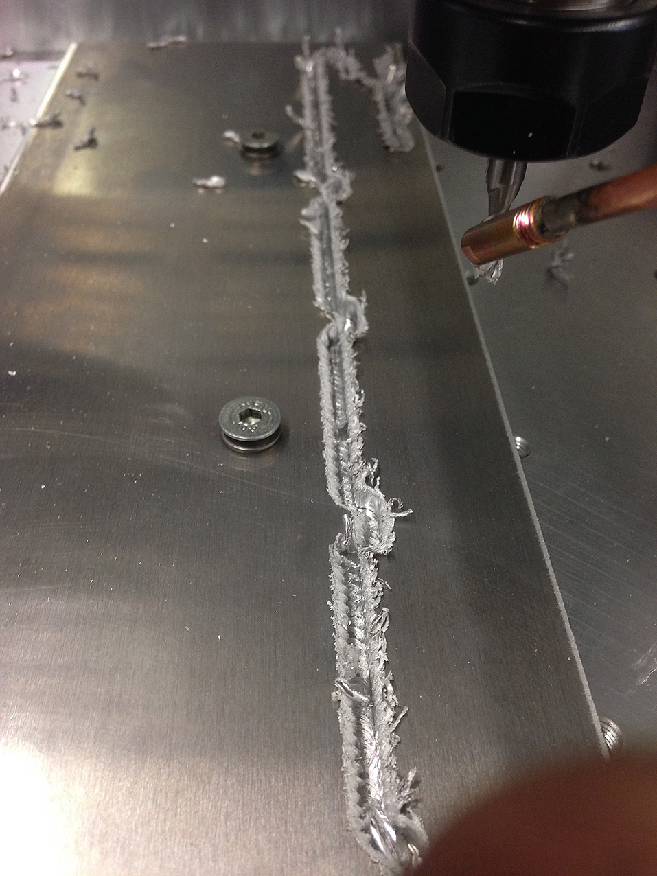

4 Attachment(s)
Re: Questions on using a moving gantry style mini-mill...
Oh well, not there yet:upset:
I spent a while assembling a fogless coolant thingy, plans as found all over the 'net, pretty easy build, seemed ok.
This was my setup - pre-drilled the cut-to-size plates so i had a fixed position, jig style setup.
Attachment 18018
First run was at FS calc speeds, new 5mm high helix carbide tool, that ended up in a right mess very rapidly, boy did it complain! The fact that it managed to carry on ripping through the metal with a fully loaded tool was quite impressive - tough little some-bitch this machine!
The tool did not break!
After the "what the f*** was that?" moment passed I hit the e-stop! On examining the aftermath, it appears the new coolant system stopped the coolant and was just on air only, this allowed the tool to load up and that was the end.
After an hour of messing i got most of the gunk off the cutter - that stuff was welded up!
Attachment 18019
Upon removing the plate from machine I could see the carnage below, the load-up had pulled the tool from the collet and happily chewed my nice new bed:upset:
Attachment 18020
I cleaned that up with a flat file and tried again. Same cutter but this time I altered the parameters from one ramped full depth roughing pass to stepped multiple passes of 0.81mm at 1500mm/min.
I also cranked up the coolant but it sucks big time and is the typical fogger system that i did not want - the whole room filled with oil/paraffin mist, I can still taste it! Totally unsuitable but i pressed on as i did not want to be beaten on this.
I got a video of it roughing out - https://youtu.be/A9ZqR9chMwg
Things seemed a bit happier, fingers were crossed.
Then came final pass on the 2mm tool - again nice new solid carbide, the small holes were run at 1000mm/min at 0.62 DOC, ramped - these worked perfectly and i was impressed here.
The pre-finish on the three loops at the bottom again worked perfectly.
The final pass on the outside edges was at full-depth and 0.1mm cut, 1000mm/min - this is where it all fell apart again - the corners of the cutouts where the larger rads were left made a bit of a squeal but first cuts worked ok, the left side of the main part cut ok on one side of one notch but the second broke the tool and that was it for the day.:miserable:
Attachment 18021
I had ordered spare cutters but some were crap and had to go back, that left me with just one 5mm and one 2mm from another supplier - the 2mm is trash and the 5mm is still gummy after about 1mm depth.
The final part is above - onion skinning will not work as there is a slight variation in bed heights and the part cannot be removed fully. I think tabbing and a sacrificial sheet of hard card or something under the plate will work better.
I also have an odd issue where mach3 went into reset when on the line before a tool-change - it would stop the spindle, lift up to clearance height then sit there in reset, pressing reset again allowed the spindle to come to park position for tool-change and then carried on normally. This happened a few times. My only suggestion here is interference from the M05 spindle-stop triggering the reset and this stopping the code right before the M06 command. I have a filter for the VFD and will bung that in.
So, unless I can find some tooling in the Bridgeport cabinet, I'm stuffed for the weekend.
I also need a coolant system as paraffin mist must be bad for health, it certainly tastes like crap!

Educational....
As i have ordered some cutters from a reputable supplier now, I asked them what the recommended cut specs were for rpm, chip load and feed. They instantly sent me a nice chart with it all on, feeding the data into HSMAdvisor shows up where i was probably going wrong a bit :)
Things alter rapidly when you give the calculator the correct data - i was running too fast, too deep, too much chip. Adjusted specs for a 2mm single-flute carbide would be...
18,000rpm
2.5mm DOC
600mm/min feed
I recall when i snapped the 2mm on the weekend I had it set at something like 1400mm feed and 5mm DOC :)
Helps having correct data i guess.

Waited a week for the cutters to arrive, first 5mm carbide bit the dust in 30 seconds! The speed calculated at 12000rpm and using my lookup table i set 14500rpm as my speeds are off. The cut started and as soon as the cutter ramped in about 0.5mm of the 2.5mm set the motor bogged down like it was totally powerless and ping went £10 :(
So, back indoors, reprogrammed for about 20,000+ rpm and started again on my reserve tool, all started ok, 1st pass was flinging sizeable chips across the room, ramps down for second pass and even though i set 0.4mm holding tabs in various places, the first part broke free and fell out thus ruining that bit. Thinking the cut was too heavy i backed off the feed a bit in Mach3 and let it go, 75% of the last roughing pass and the part breaks free and takes the cutter to the bin with it. It's irrelevant but thats £25 of bits in 15 minutes, plus another sheet of 5mm Alu in the bin. :( :( Talk about pissed off!
Right, observations...
1 - Is this job actually possible?
2 - is there any point at all at running less than 100% RPM - these spindles seem to have zero power.
3 - It seems to be cutting 0.2mm below the set height - I need to tweak the Z height routine a bit, set the plate thickness a bit off to lift the tool 0.2mm
4 - How thick should holding tabs be - I set 0.4mm but clearly not enough.
5 - I set 2.5mm DOC for the roughing on a 5mm bit, go less, 1mm??
Exceedingly vexed at the moment :(

I wonder how you take so brave cuts and meanwhile try to tune your mist system....:boxing:
Why just you dont cut a 50x50 mm pieces and figure there the speeds, feeds and mist system.
Here are some tips, you could say cornerstones:
-mist system tip should be 0.8-1mm, 2-2.5 bar pressure at reservoir, mist spray length should be 80-100mm if all done correctly. when done correctly it will blow away even when 20mm bit cutting
About the cuts in aluminum. you will continue to snap bits until you don't figure what are you doing. Deep slotting is a recipe for disaster. Make slot double wide so you have space where the chips to go, or go slower.
Start from 12000rpm and ~600mm/min, slowly rise speed and look about the quality of the cut/6mm 2 flute/. But not on big pieces. Make small pieces and test all untill happy, including final slot depth test.
And better more mist than not at all
I leave 4mm thick by 10mm long tabs

Dave this what I meant when said Aluminium bed is Ok but often you'll have Spoil board on it. So here's what I would do.
Fit spoil board that can be screwed into and surface it. Then I would change the Code and move the smaller part in wards and drill holes put screws where I have black circles on your last pick.
Then onion skin the both parts with about 0.3mm. Doesn't matter the large part will not be held down one side the rest will old it.
The skin then just breaks away and quick cleanup with De-burr sorts what's left.
I do this type thing all the time in shity 1050 2mm plate and works perfectly.

Points noted Boyan, BTW the coolant is working nicely - the cutter was clear even during the heavy cuts.
Jazz, the two screws in the small cutouts - they would be fitted after the finish pass on this features?
Spoilboard - MDF?
What sort/size for facing cutters?

Yes screws with washers in cut outs after finish pass on pockets.
MDF, ply anything that can screw into really.
Facing cutter then widest you have but with such small piece then wouldn't take long if small.
Actually to be honest dave if spoil board is resonably flat then just for this job won't even need surfacing because your only profiling. The main reason I said surface is because 0.3mm isn't much so can easily cut thru if not flat but if you want to have thicker skin then don't bother with surfacing.
