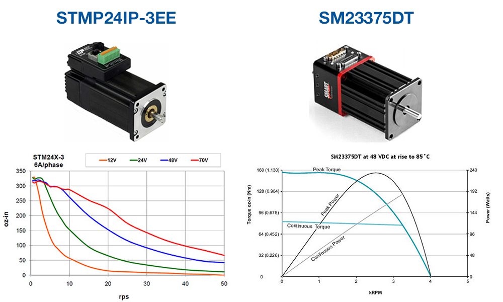

Do someone have some opinions on this stepper http://www.aliexpress.com/item/Nema-...999.264.8phZye? 1.8mh seems nice, but the seller dont looks so professional.
Re: Aluminium FEA optimalized CNC router
But the price is higher and the inductance is higher
The price is same or lower. You have shipping costs and eventually duty to pay. If you are saving on stepper motors, you will not go far with that build. The links i gave you are the cheapest in Europe
Attachment 18935
Inductance is probably my biggest concern.
This is the motor that everybody here uses for a step motor on their CNC. No surprises, works well at 70V. The motor you show has less inductance on paper, but how true is that...
Boyan Silyavski
That was kinda my question. Is there anyone who have tested this/looked into it before?
Edit. I see that cnc uk sells the steppers in a kit with a 36v supply. I asked if they would put on a 48v supply instead. According to the classic 32*sqrt(inductance) rule about 57v should be optimal. Why is they selling 36v supplies in their kits?
