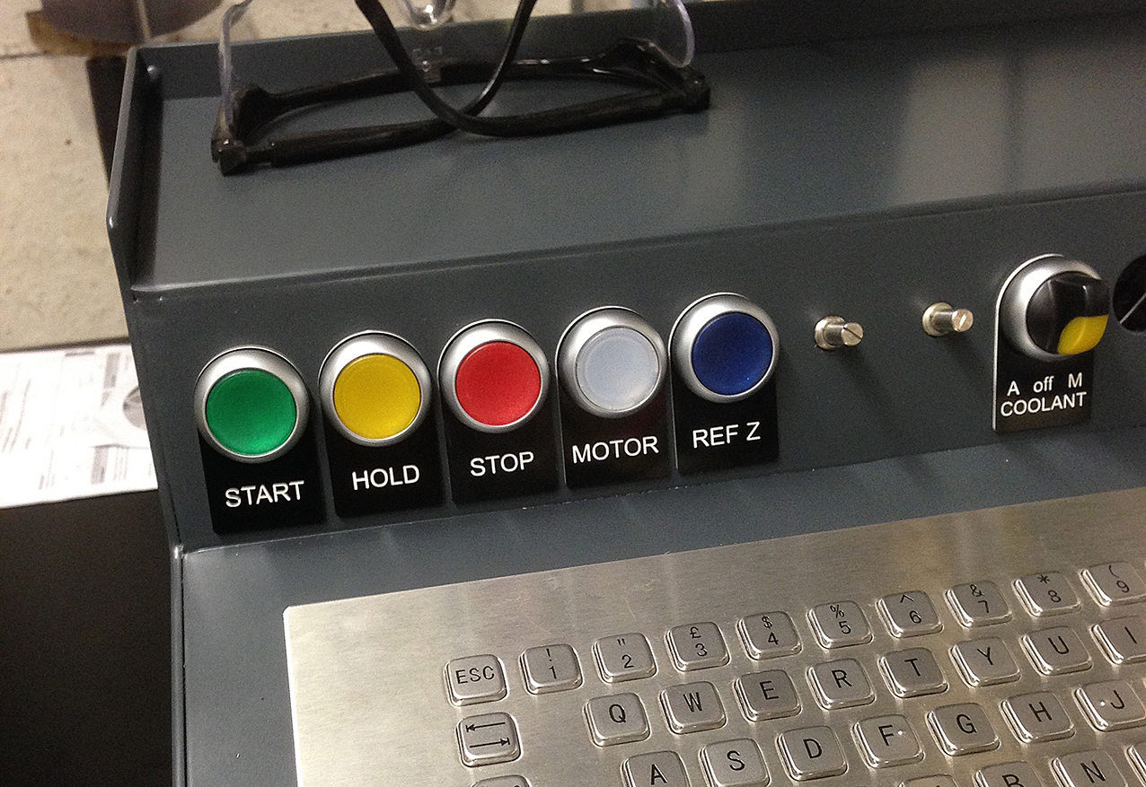

Panel controls...
With the Bridgeport you have to run in reverse when in low range, is there a way to have this done in Mach3 or will it still be a Hi/Low selector switch on the panel?
The VFD for main spindle, with the vari-speed mechanical system I'm not sure if i should try using the vfd as variable or leave it fixed at 50Hz, the top speed is limited to 3500rpm absolute max as it tends to wreck the spindle bearings above that and low down it probably would not have the torque needed, so stick with mechanical ?
Main spindle on/off manual control - would these buttons control Mach3 or would they control the vfd directly?
Just looking for ideas here.

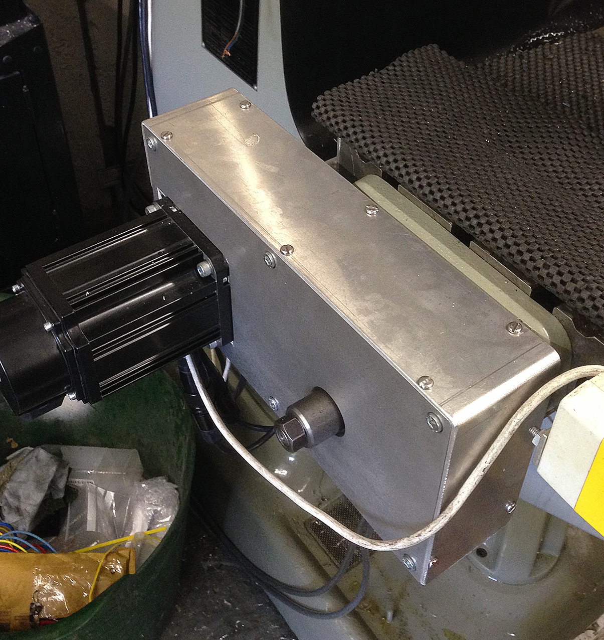

I will send you a photo of my setup later on. I have made parts to allow me to use the manual quill with the removal of a single screw.
Also look on CNCzone for SCzEngrgGroup's conversion of the bridgy.

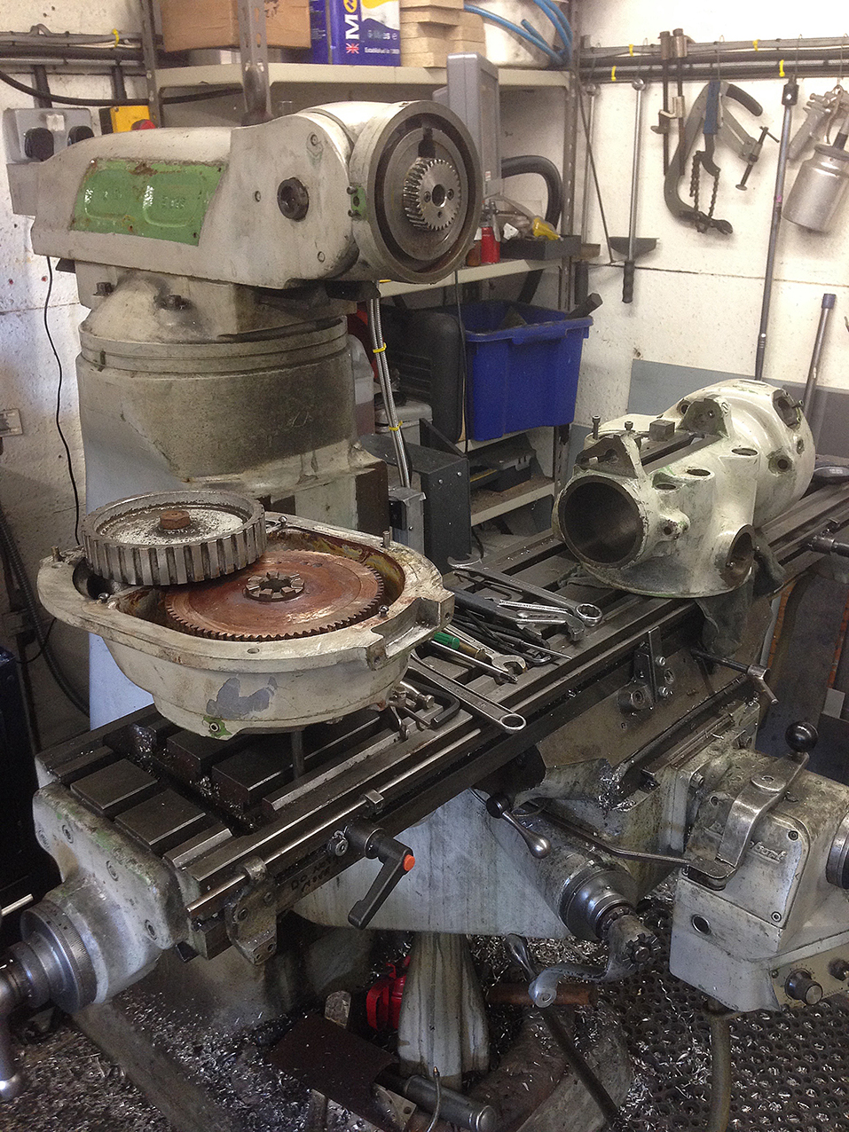

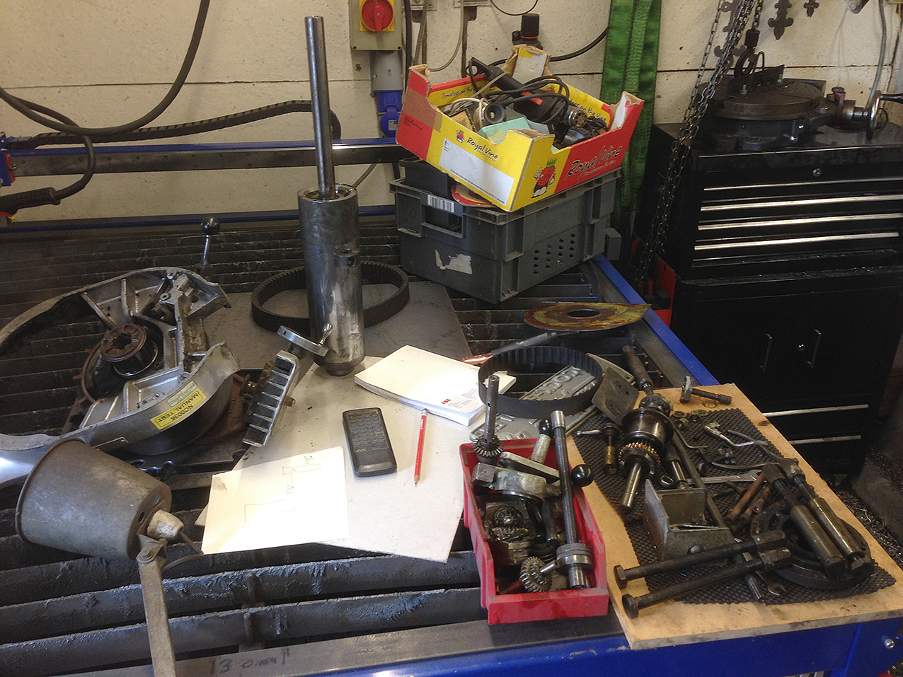

Have finally got the head apart on the mill - a tiny broken shaft was holding me up - an absolute bugger to get out.
Attachment 18494
Attachment 18495
Now thats off it should move a bit more rapidly. The plan is to do a complete strip, wire-brush the poor repaint job it has off then sand and repaint in "Bridgeport Grey" engine enamel and reassemble to a bare machine then fit the CNC conversion.
The DRO and Original, working power-feeds will be sold off to raise funds.
Space is the biggest problem, will probably have to erect a shelter and do most of the prep in the garden.

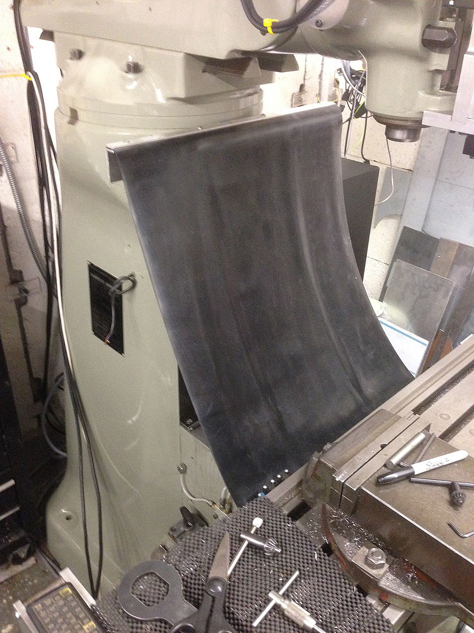

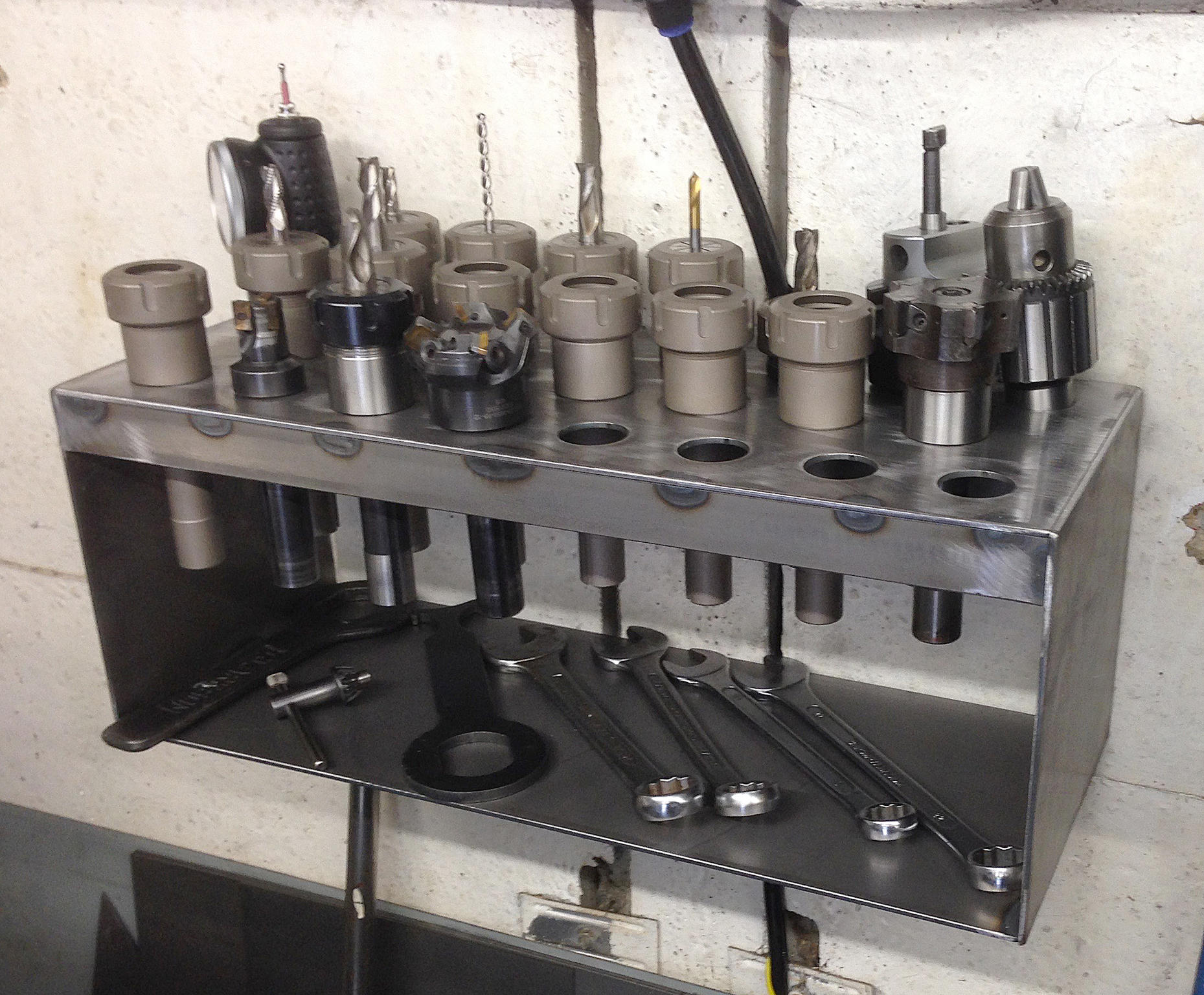

Just to throw a spanner in the works may be completely irrelevant but on my travels today saw a bridgeport (couldn't tell you the model) converted to CNC, that used original and a 24k spindle slightly different setup to your plan.
The 24k spindle was mounted literally beneath the original in a frame so when changing between spinles he just had a Z offset to consider but apparently with Knee or second Z thats not a problem, frame actually locked into a collet then connected to frame, his spindle was shorter than mine and he lost a fair bit of Z travel but this still left a good amount of travel on Z for what he used the 24k for.
Just thought I would share unfortunately I was out on the road bike (lycra man) to escape idiots for a while so no phonewith me to grab a picture.

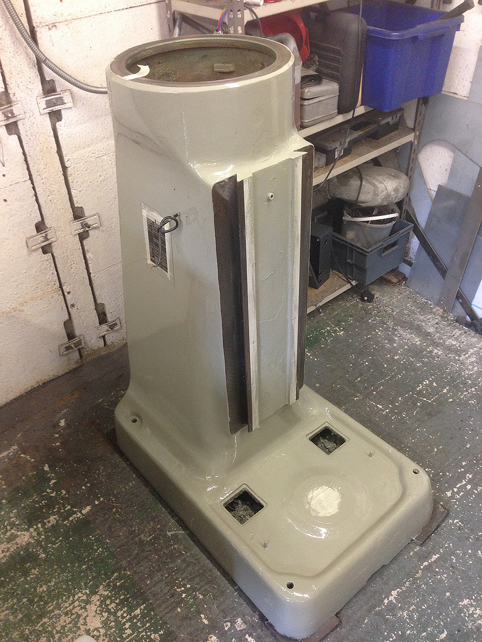

Stripped most of the poor paint job off now, will be sanding and painting this weekend, not filling the dents in as it's a machine not decoration ;)

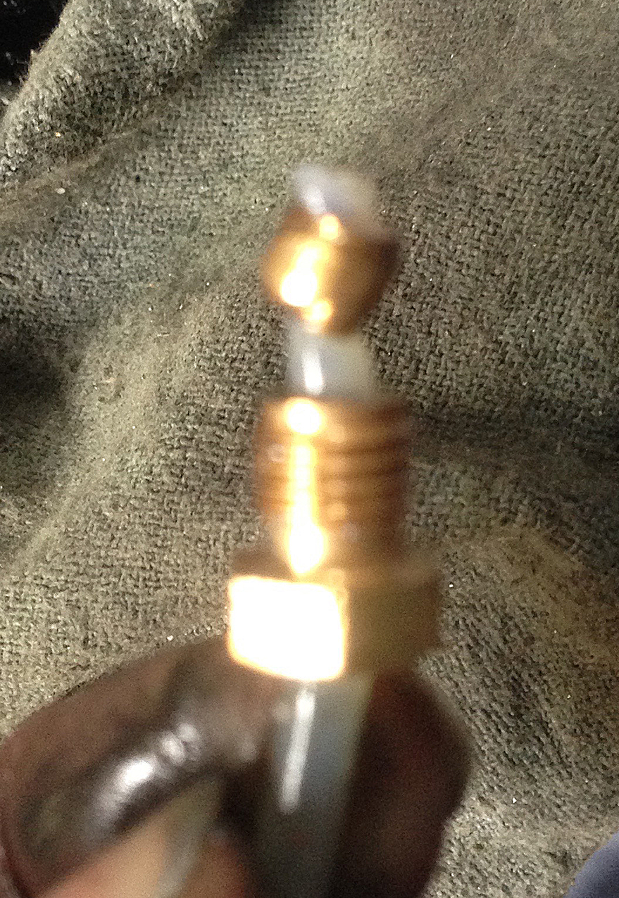

Now for the spare parts :(
The knee lift-screw bearing is dead, it looks like a 3306-2RS Double row angular contact 2 rubber shield item - 30mm ID, 72mm OD, 30mm W
Can anyone confirm that please?
Also is there a good source for the tubes and fittings for the lube system in the UK, might replace the lot as it looks like some of the points on the knee lift ways were doing nothing, luckily i always backed up with the oil can;)

Re: Bridgeport Manual to CNC conversion...
I got replacement Bijur metering units for my mill from Lubetec. They do have a web shop, but it's just a generic skinned airline/pneumatics one used by lots of similar suppliers, and doesn't contain any of the lubrication stuff.
They do however have their own catalogue online, which contains all the centralised lubrication stuff.
I did consider the Arc Euro parts, however the threads were wrong and the genuine Bijur ones weren't that much more expensive. Just checked and they were £5.54+VAT each a few years ago, so not worth the hassle of retapping threads and changing fittings.
You'll need to get the flow rate of the existing metering units, as well as the thread/style/direction of flow if you need new ones.
I removed all the metering units from my mill, connected them up, and then left the lube system running overnight (it's an electric motorised one designed to lube every few hours). Any that were still dry in the morning, I replaced as they're pretty much impossible to clean properly once gummed up, and a few metering units is far cheaper than the potential damage from lack of lube.
One trick I did use, was to fill the system with ATF fluid and leave it running for a day. You can then check that all the slides have a nice coating of red oil, which tells you the system is working and getting oil to where it should.
For replacement pipe/fittings, I just used whoever could supply them. My mill originally had aluminium distribution pipe, which had corroded where it had been sitting in coolant, so I replaced it with the same sized copper pipe.
Thanks I'll have to test them all first then.
The plumbing is all nylon so that should be cheap enough with some olives.

Looking better...
Attachment 18524
Got the knee painted too.

Got most of the big stuff stripped , sanded and painted now. Started putting a few little bits back on but cant do much until i get the new knee lift bearing.
Found an issue with old lube system - this is the feed to the saddle...
Attachment 18527
Olive was cocked and tube crimped, probably wrong size olive for the pipe :(
Moving on....
Motor mount plates for X & Y axes.
Is it better to hang the plates from the four bracket mount screws or the three bearing retainer screws?
Attachment 18528
Using the four screws would mean a much larger lump of metal is needed to span the width, I won't be refitting the dials so using the three mount screws probably won't affect anything.
Any thoughts?
Go off the plate:
https://lh3.googleusercontent.com/-u...mounts%2B-%2B4
https://lh3.googleusercontent.com/-R...mounts%2B-%2B5
I made a spacer and clamped it all there.
My Y axis one looks like this:
https://lh3.googleusercontent.com/-a...mounts%2B-%2B3
https://lh3.googleusercontent.com/-v...mounts%2B-%2B7
I bought proper angular high spec contact bearings for the screws (+£250) and some very fancy face locking lock nuts from Germany.
