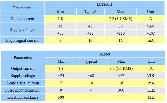

I see there M860's now, they're always black in the pics online. The 2 top ones look like my AM's the 2 bottom ones have funky cases lol.
Attachment 23899
I don't see the h in the serial number sure you checked it all out already it'll be printed on stepper driver case but leadshine do a few drivers in DC and AC/DC flavours and it's the h your looking for.
