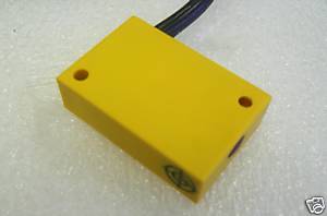

With the spindle control done, Ive decided to tackle the Limit switches... there are proximity switches present on the machine of the type below:-
Attachment 2637
these were again connected to the old main logic board now thats gone does anybody recognise this type of switch, i know i could change them for micro switches but as they are going to be used for limit rather than Home switches i would like to utilise them if i could...So any ideas???
Label says 36vdc 200ma BN=L+, BK=OUT, BN=L-.
They could be Reed switches,Rick?
I doubt it, a reed switch wouldnt need a 36v supply. These are active devices.
Rick, is there a magnet or something to activate them? Or are they just activated by the table?
OK answered my own question... they are inductive proximity switches, easy to use with your opto-isolated inputs, just need to work out which polarity they are... is there a part # on them?
IS5003
IS-5003-ANOG
10 - 36vdc
made by ifm electronics
http://ifm.com/ifmgb/web/dsfs!IS5003.html
There is a gap in the slide to detect position
I thought you would know i2i lol , well while the site was down I managed to track down a data sheet and now these proximity switches are operational with a nice little relay board, I think they were used as home switches in the original design as they only operate at one end of each axis only, I understand this is not the best way to go as the repeatability is not good, so im going to get the drill out at sometime and drill the recesses at the other end of the axises and use them as limit switches.

You're right they are used as home switches, and i suppose as long as the area is kept clean they would be ok for the job.
Do you have a schematic for the relay add on.
Looking at the data sheet it looks like it will drive a small relay direct, or even switch an input to ground.
