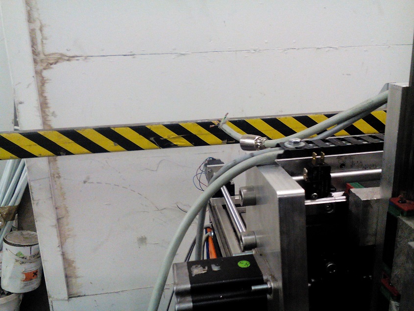

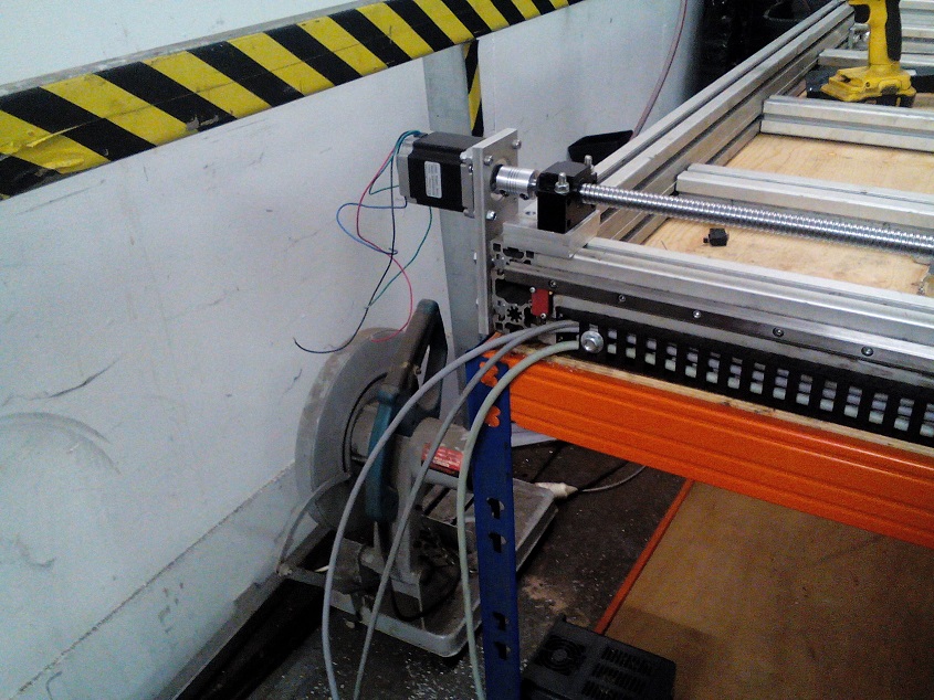

Little bit more done today, limit switches are fitted directly into the aluminium extrusion
Attachment 23122 You can just see the red microswitch at the end of the energy chain a Hiwin carriage triggers it, there's identical switch on the other side in same position.
Attachment 23123 And just under the bolt in the energy is the other switch only one bolt at moment need to find a 5mm piece of aluminium so I can fit the 2nd bolt but the edge is tight against the Hiwin rail so it's solid.
I drilled them tapped the holes, very happy how they came out. There is no Z axis switch yet will rebuild the Z axis so they will be added then.

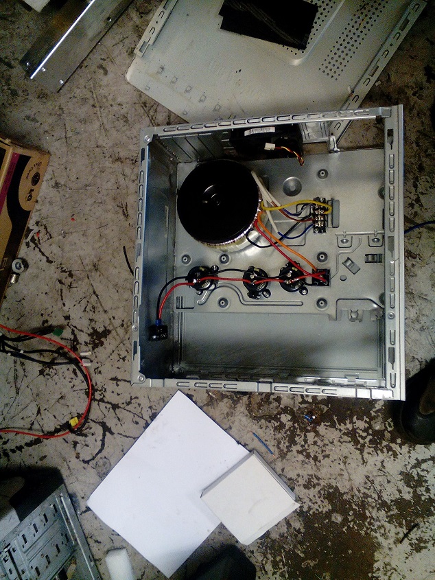

Power supply is ready to be hooked up to the AM882's

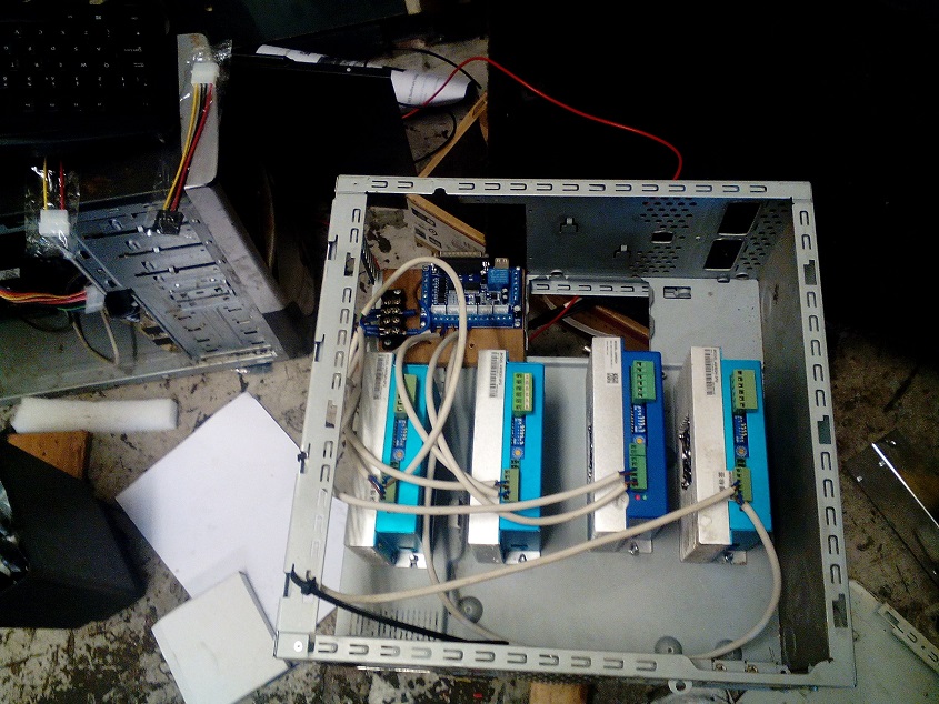

AM882's now have all the stall protection wired in
Attachment 23125
The PC to control this now has windows 7 and Fusion 360 on it, and a parallel pci card installed. Wiring is in the energy chain just need to connect everything up, earth the spindle and connect solder that up and we can get it running.
Need to get some wiring for microswitch just going to use cheap 2 core a junction box to split the power from the home built PSU to 4 steppers and some connector plugs will pick up on way to work tomorrow.

Looks ace mate good progress! Is there anything special needed in order to enable stall protection on the drivers? I have the same ones but only have them wired normally at the moment, remember seeing in the manual that it said it only works above 300RPM.

Just wire the output to the emergency input on your controller board then if it's missing a step the machine shuts down. You can see it's the 2 wires for stall protection next to the direction outputs on the AM882's.
On my controller I had to wire them to a connector and then to the emergency input on my BOB as I have to cram 4 wires into 1 emergency socket, it's worse for the ground I have to cram at least 7 wires into 1 lol.

Got the limit switches wired up and the Y axis limit switch cable fed through the energy chain which meant removing it, it's a very tight fit ;)
Spent ages on little bits like making sure the CY cable is well supported, cabling is fed nice and neatly back to the control box.
