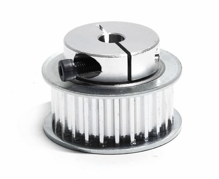

I did some more research and came across these types of clamping pulleys:
Attachment 29868
What are your thoughts on these?
I'd give these a go on the ballscrew end.
Needs a bit more research but I've seen them on aliexpress.

IMO The advantages of "taper-lok" and my DIY ER solution is that they are more compact, better concentricity, better grip, no damage to the shaft from grub screws, infinite ajustability and depending on pulley size less mass.
