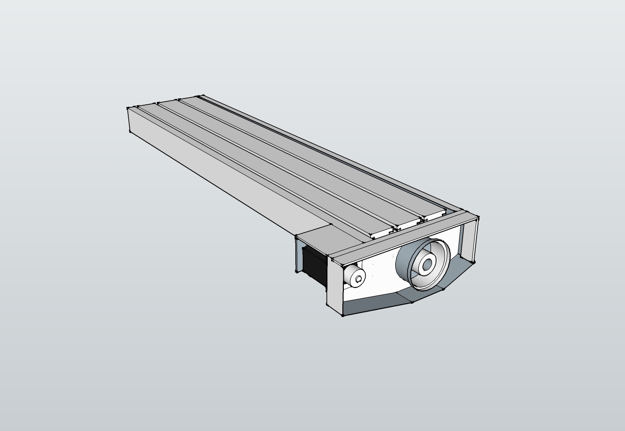

Well here is an idea, im sure there will be people with experience of this sort of thing.
Attachment 4490
just a basic concept and yes There are covers missing for clarity...
This type of thing is what i was looking into and it all misses the y axis as well so no loss of x or y. excuse the drawing its my first google sketchup

I'm playing with the idea, primarily because I think it looks good, effectiveness be damned! :twisted:
On a related note, I also asked similar questions about the under-table mounting, the consensus seemed to be that it wasn't a problem. The following thread might have useful things for you: http://www.mycncuk.com/forums/showth...or-under-table

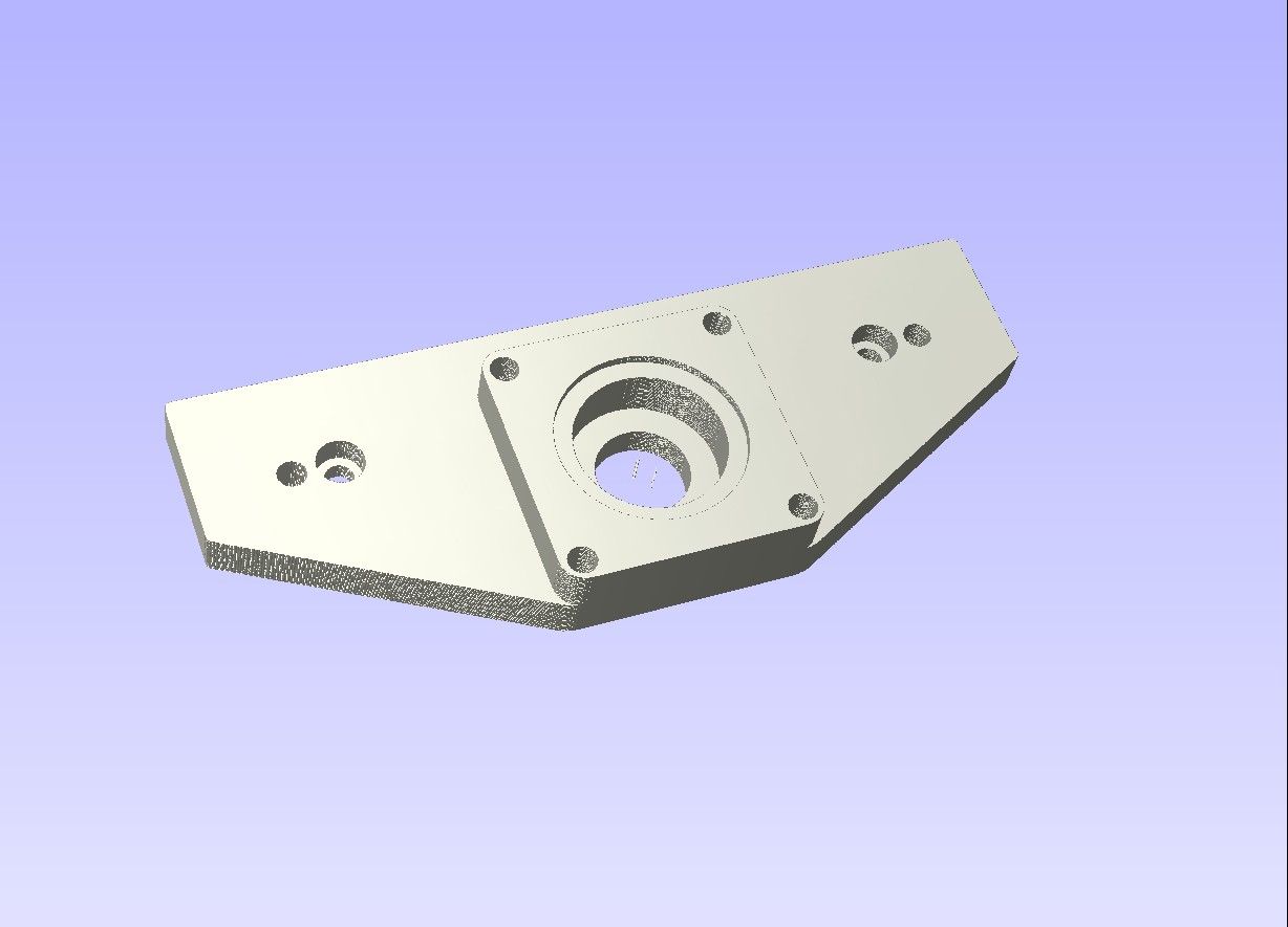

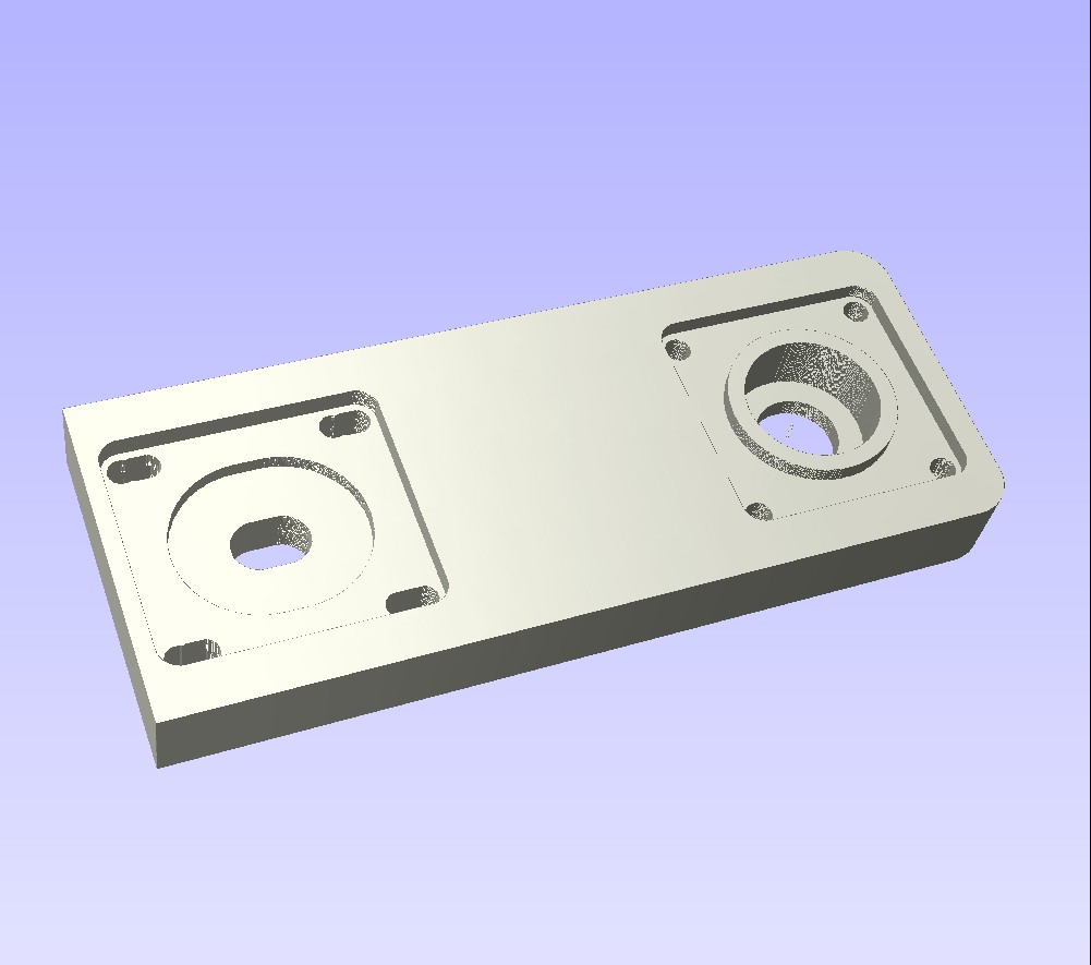

LOL well here is the Vcarve output for the endplate for the Z with a side mounted stepper, or if prefered it can be hung on the end infact ive desinged it so you could hang it on the left rignt or even underneath,Ive not included the tensioning system yet as im still working on it. I still think it looks bodged on the end but that is just my opinion lol
Attachment 4496
Attachment 4497
I will make the prototypes out of a non metalic material i suspect...:smile:
Oh and ive made it incorperate the ballscrew Double A/C bearing housing as well.
