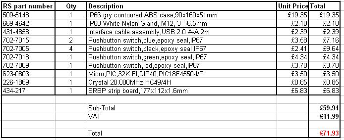

Here is the BOM for my version:
Attachment 5963
These are all the mains parts, just need to add a few caps and resistors... penys...
