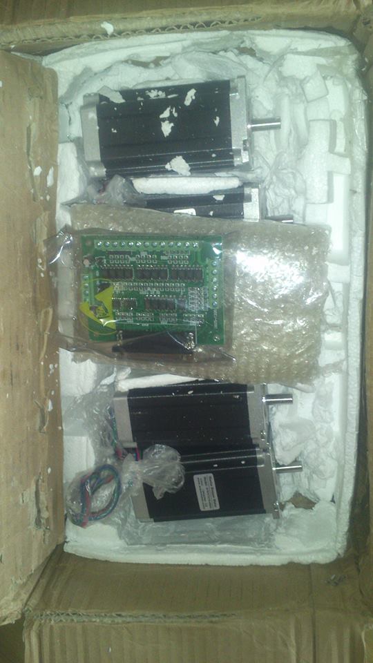

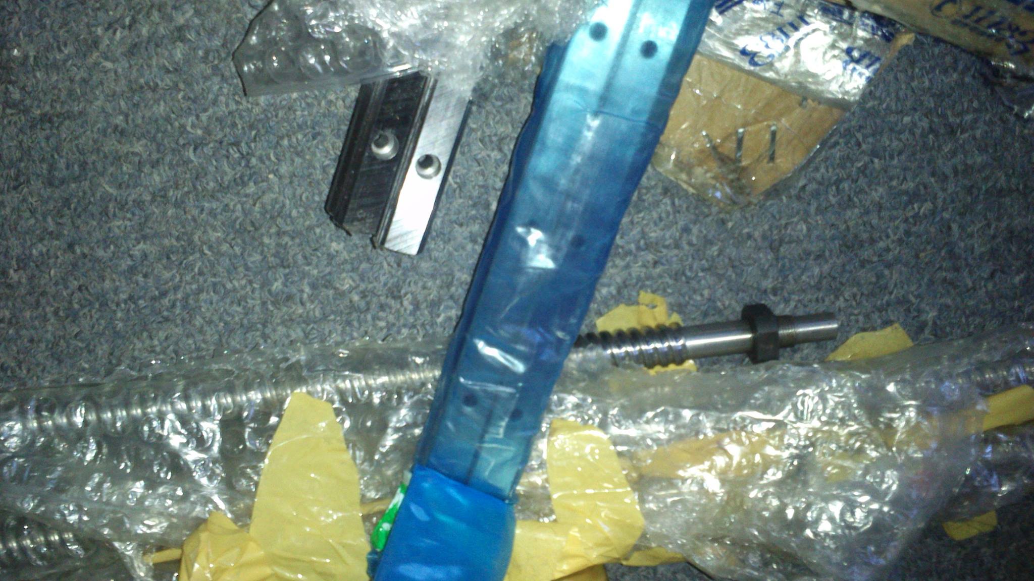

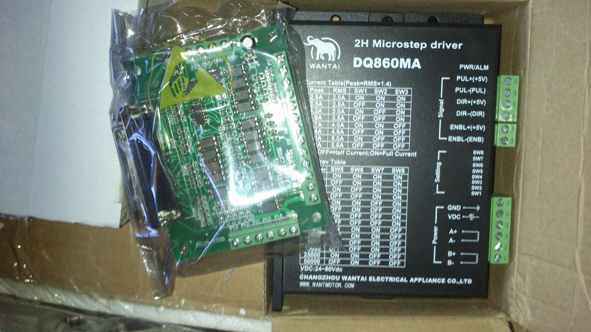

		Hello guys I recieved all the goods from china for the cnc
Axis X
2pcs RM1610-1500mm Full length 10 pitch
2pcs HGR15 -L1500mm
2 AM882
Axis Y
1pcs RM1610-1200mm Full length 10 pitch
2pcs HGR15 L1200mm
1 AM882
Axiz Z
1pcs RM1605-350mm Full length 5 pitch
2pcs HGR15 L=350mm
1 DQ860MA
Motors
5PCS Nema 23 stepper motor 425oz-in,3A,2ph,1.8°
Breakout board
1pcs 6 axis cnc  DB25/ interface board adapter milling engrave c10

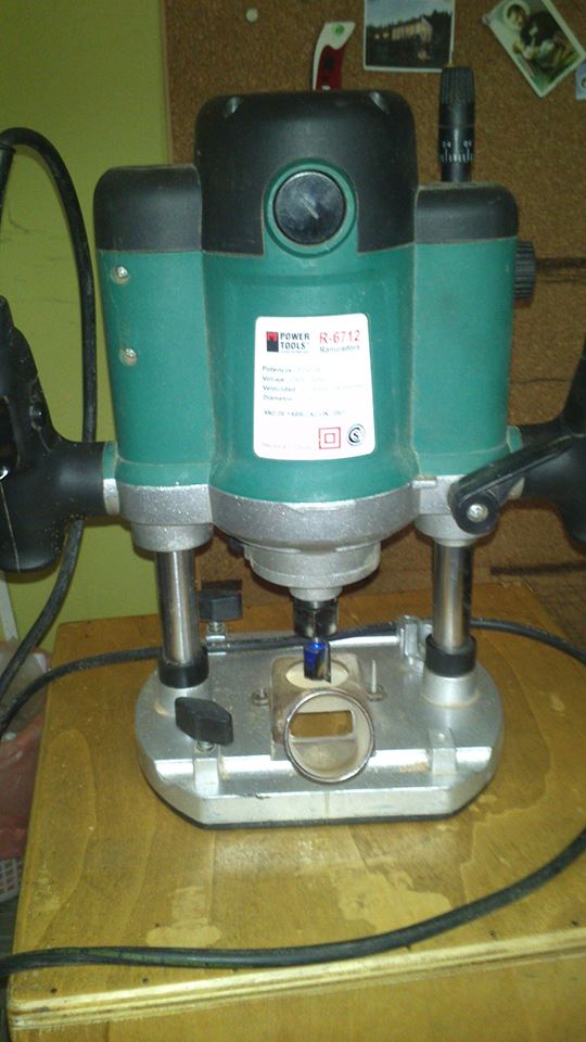

I want to thank you for your help, thanks to you I could select the components. I would like to know if you could  give me some advice regarding the spindle selleccion. I have a 2050W router and do not know if I should use this or if it is better to buy a water cooled spindle or any other,since I donŽt know if the power that I need 2.2 kw or 3 kw is  suitable for milling materials I will use.
On the other hand, I want to ask JazzCNC for help to build the power supply appropriate for this equipment,and to help me decide on the components I should buy to make it. And finally I would like to know what I have to do with the components, what procedures I need to follow.

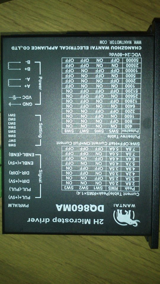

		Hello guys I recieved all my stuffs from china,I want to build the psu  suit for my needs. Can you give me an advice to buid it please.
I have Axis X=2 AM882,Axis Y=1 AM882,Axiz Z=1 DQ860MA,four  Axiz=1 DQ860MA,Motors 4PCS Nema 23 stepper motor 425oz-in,3A,2ph,1.8°.  Thanks for everything!

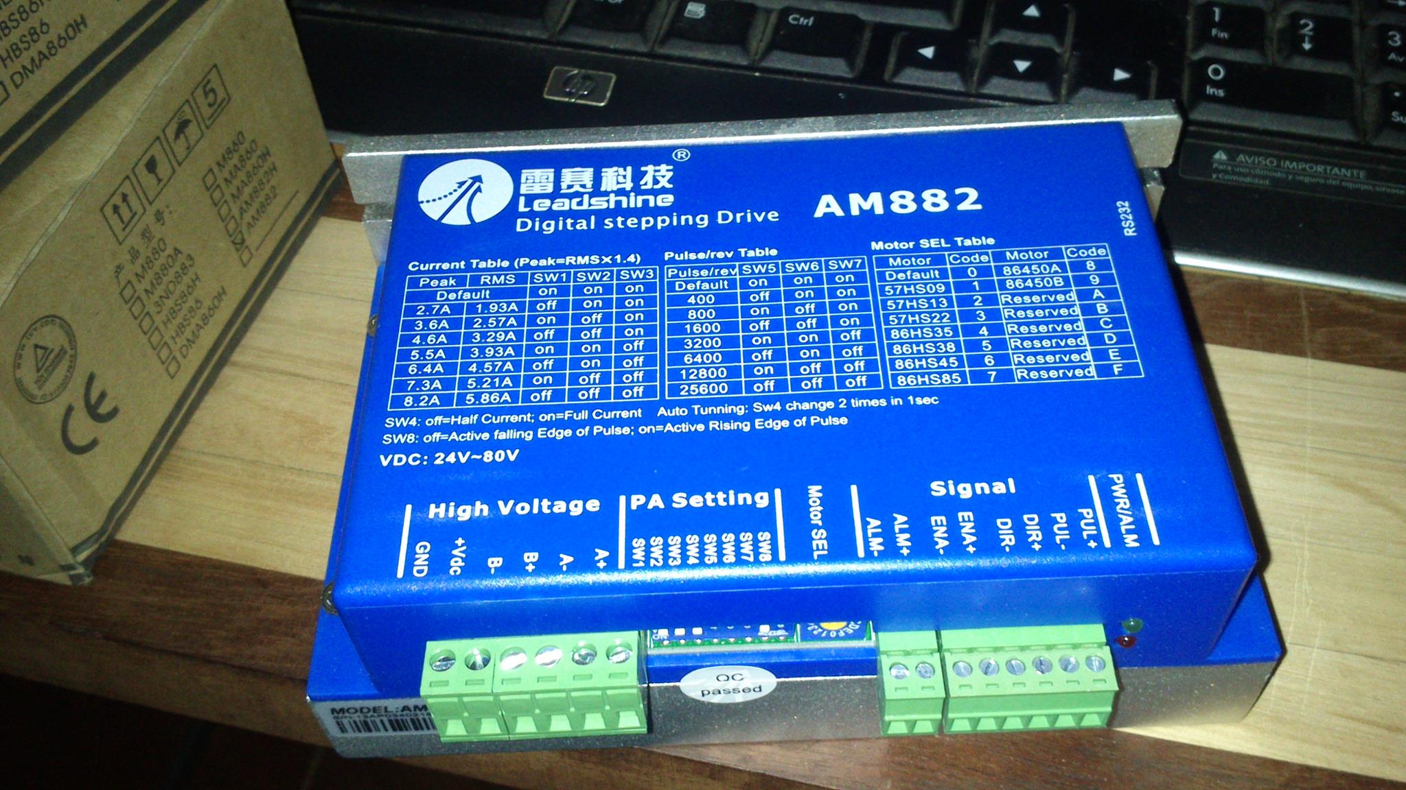

 Contact me thru PM with your email address and I'll help you with PSU but won't do it over the forum as it can be miss understood by others and potentialy dangerous and damaging if done wrong or misunderstood.! . . . . . . Others may offer over the forum but I'm not prepared to do that.!
Also At the moment looks like you plan to use AM882 for X & Y with DQ860 for Z & A but you have bit of a mixed up setup there mixing digital drives with Analog drives and if Slaving A axis with another(X) to form twin motor axis then you would be much better using same drives on each.! The AM882 would be best for this because they have stall detect and fault signal.
Another thing is the motors.! Which motors are they and do you have a data sheet or model number.? Becasue you quote 425oz rather than Nm I suspect these are the high impedance motors often found cheap on ebay.? If so be aware you will get much lower performance from them for the same amount of Voltage compared to same power motors with lower impedance. This will affect the feeds you'll achieve and lower the amount of torque available higher up the speed curve.!

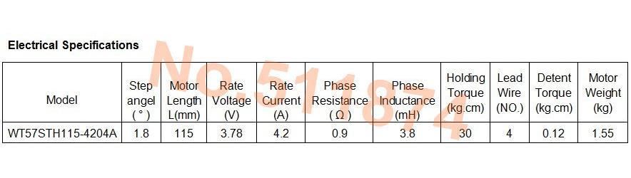

 Yes they are high inductance - the lower phase current (3A) is the giveaway.

			Then you're basically stuck if you want them for a reasonable price. Will CNC4YOU not ship to your country? If not, then you need to find 3Nm (425oz-in) motors with 3.2mH phase inductance. They generally have 4.2A current rating.

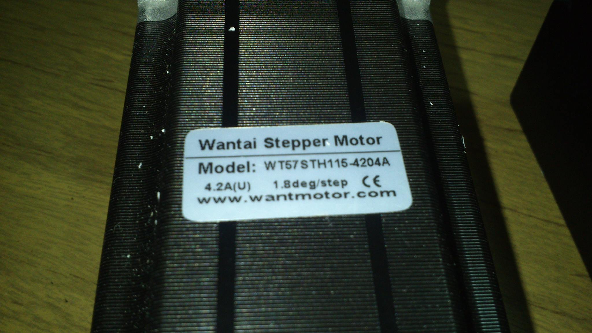

 Hello guys I try to follow your advice in all the buys. I bought this models, wt57sth115-4204a, Attachment 12414Attachment 12415Attachment 12416 and I find this on internet Attachment 12417Attachment 12418.
I ask for low inductance as Jonathan told me. Ibought this in October 2013 and after 1 month of travel and the rest of the time in ARGENTINA CUSTOM y recived this. Some times I want to leave this country!! But my family is here.
 Great good to see you took Jons good advise. Those motors while still a little higher than some motors of same power are still have low enough impedance not to be restrictive.
