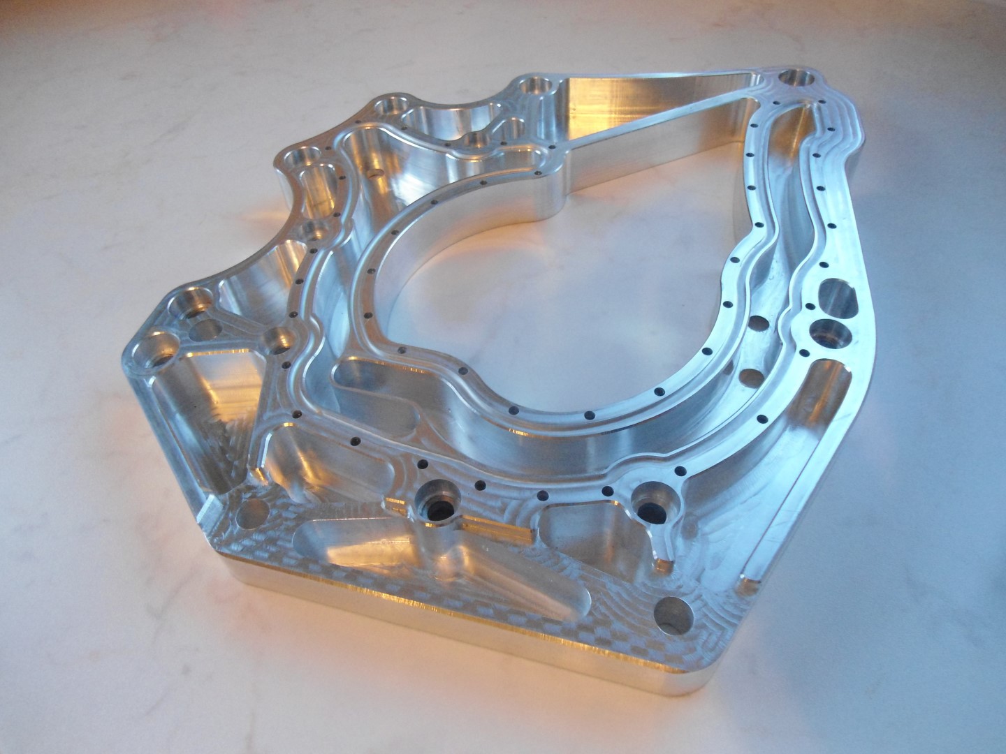

Yep, I also made the water cooling block below by borrowing my friend's CNC router. We were nowhere near finishing so we took my mini lathe in the van. Almost everyone who passed our box said 'look, they have a lathe!'... you'd think they'd never seen one before. The lathe proved just as useful to other teams as us - I think I helped out 5 different teams with it, including skimming a shaft from a sidecar.

That's a beautiful piece of aluminum. Must be fun at the competition.

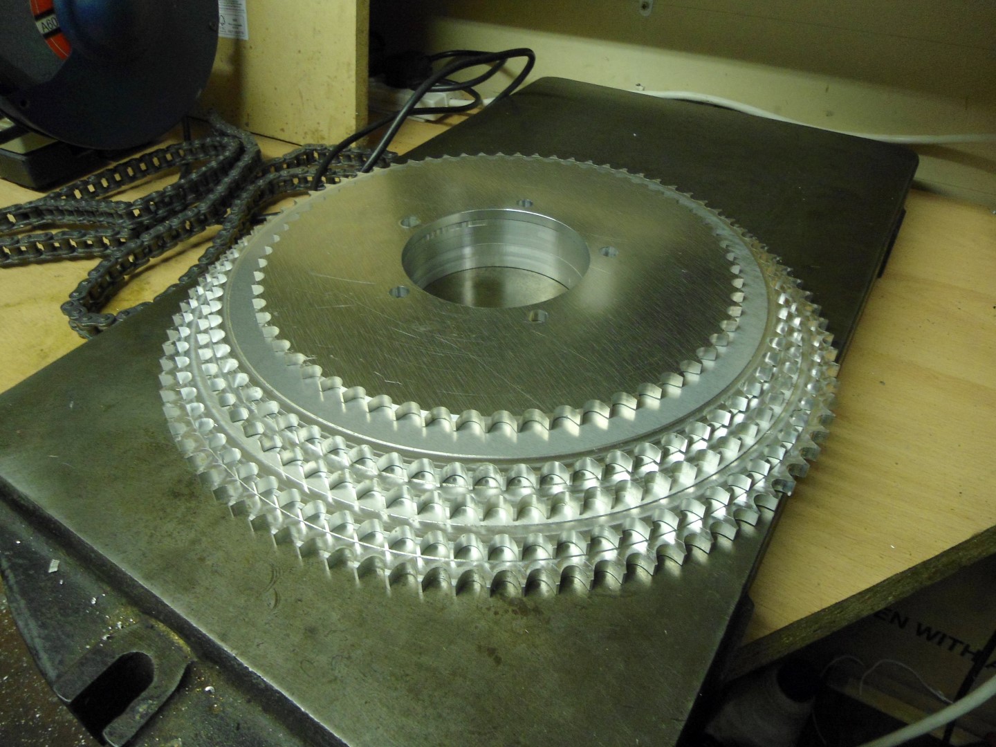

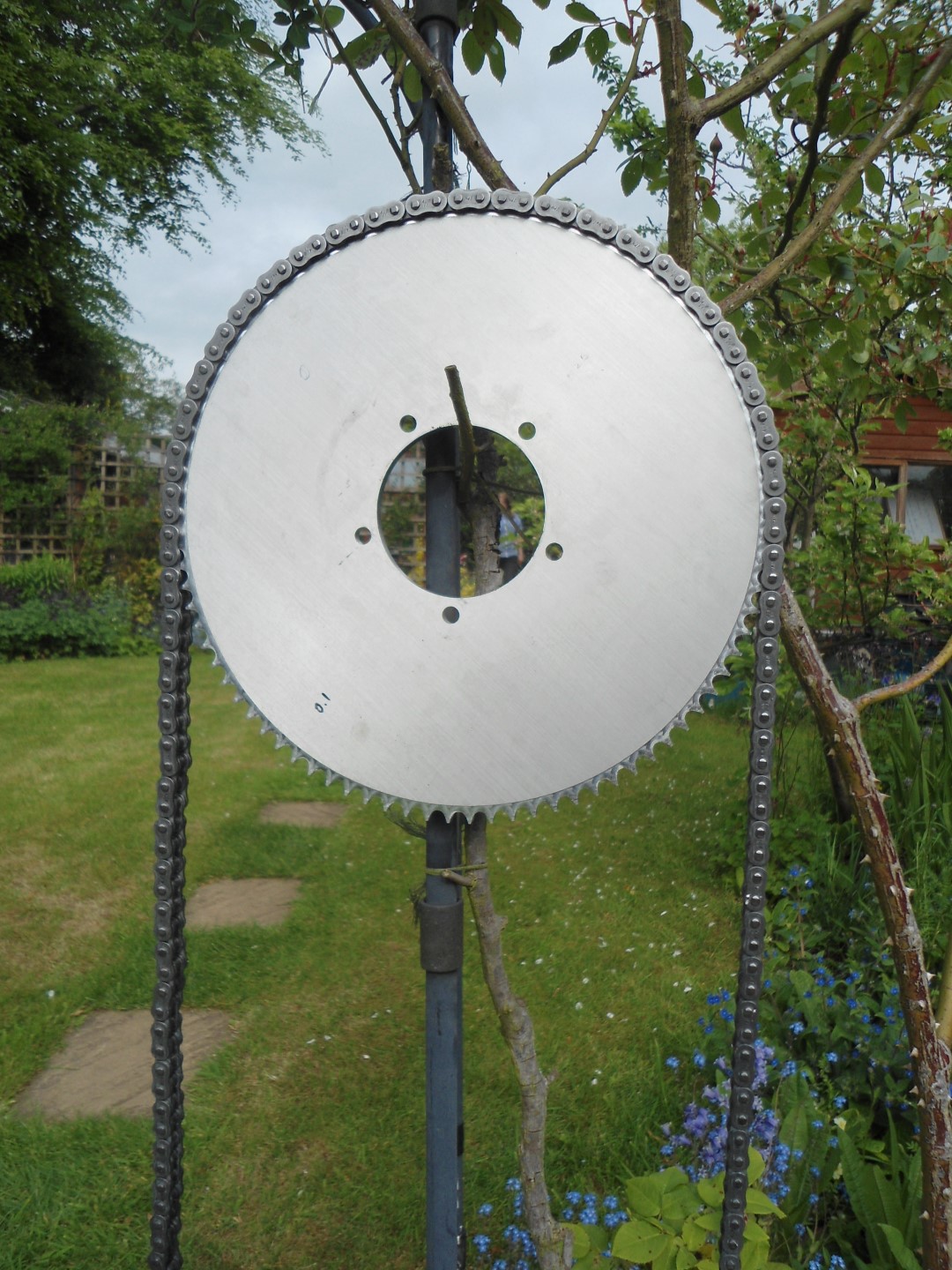

Here are some more parts I machined for the bike - some sprockets:
http://www.mycncuk.com/attachment.ph...id=15525&stc=1http://www.mycncuk.com/attachment.ph...id=15527&stc=1http://www.mycncuk.com/attachment.ph...id=15528&stc=1

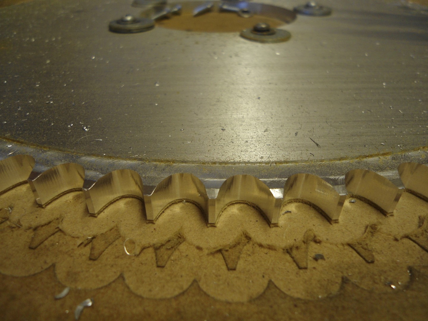

They were surprisingly easy - I just used a 6mm cutter for the main profile and a simple V-shaped tool I made from silver steel for the chamfer. Next time I will add some pockets to save weight. For these I was in a hurry so didn't bother.
They worked, but were a bit wobbly as the aluminium plate wasn't terribly flat! The bike has done about 100 miles on the TT course and the 6082T6 aluminium hasn't worn much at all, so it doesn't seem worthwhile splashing out on 7075 grade. I think I'll just order some tooling plate to guarantee sufficient flatness and make plenty.

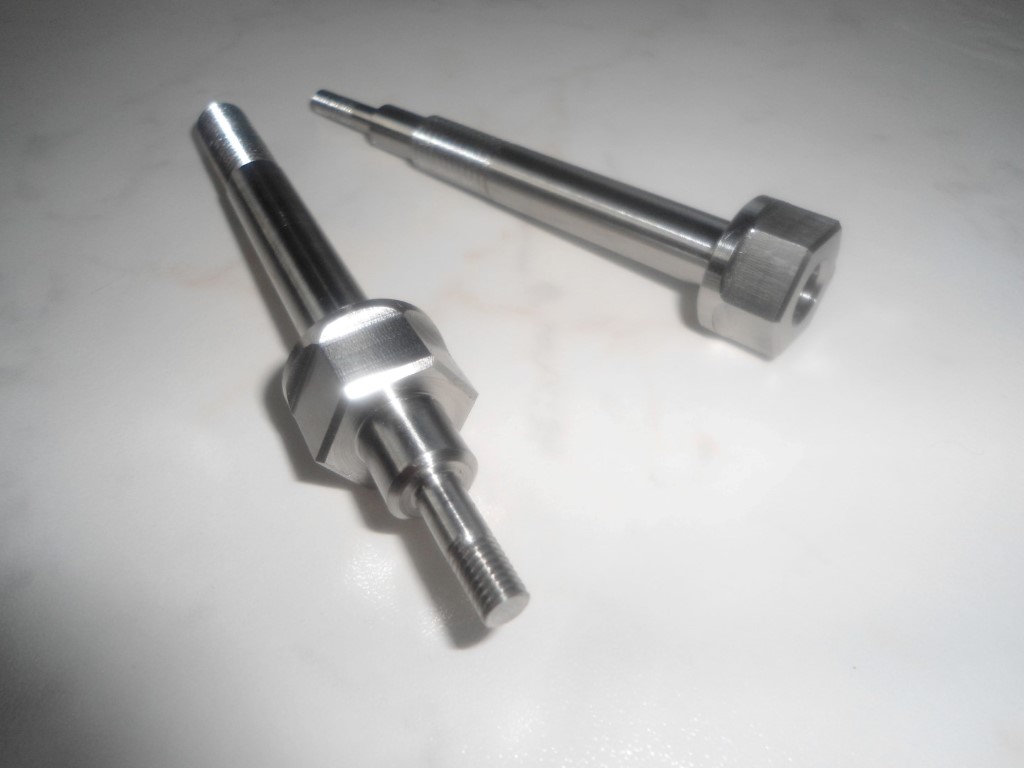

For this race I made a new rear sprocket plus some titanium M12 bolts so that we can have data logging of the suspension:
http://www.mycncuk.com/attachment.ph...id=15742&stc=1
