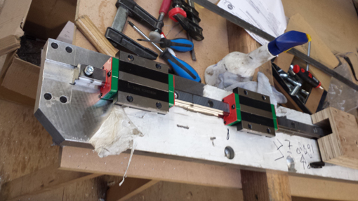

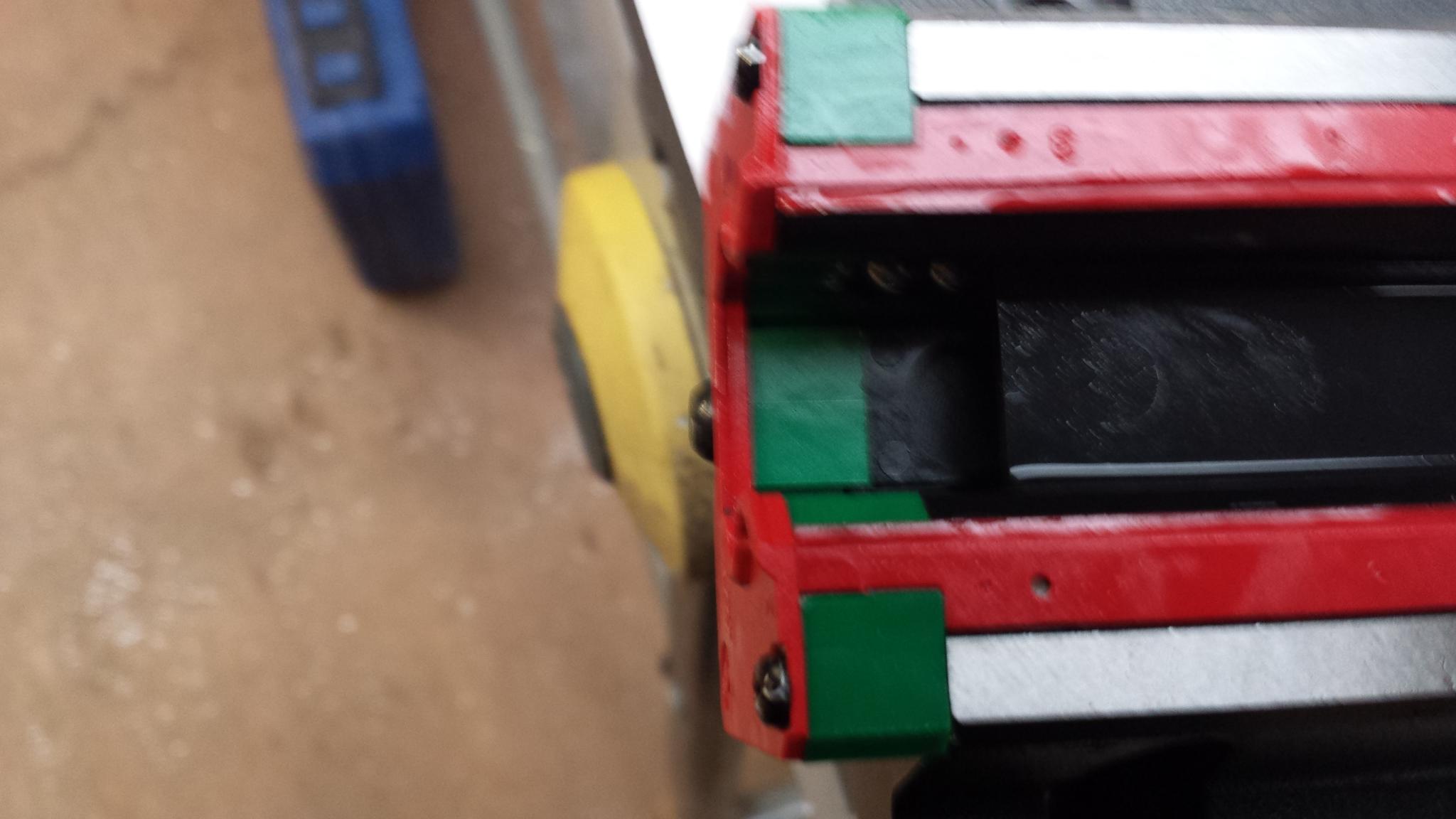

I've slid my blocks on to the rails and removed them multiple times while setting up, using the plastic retainer pushed against the end of the rail each time. No problems so far, although I just know I'm going to have a wobble some time...
cut the rails to length and slipped on 2 blocks this afternoon... don't know what I was worried about :highly_amused:

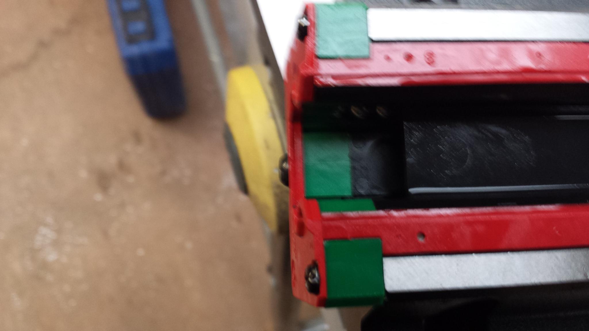

I assume these are double seals?
http://www.mycncuk.com/attachment.ph...id=14683&stc=1
is it worth adding the scraper? I assume it is just a case of unbolting the existing seal & slipping it on?

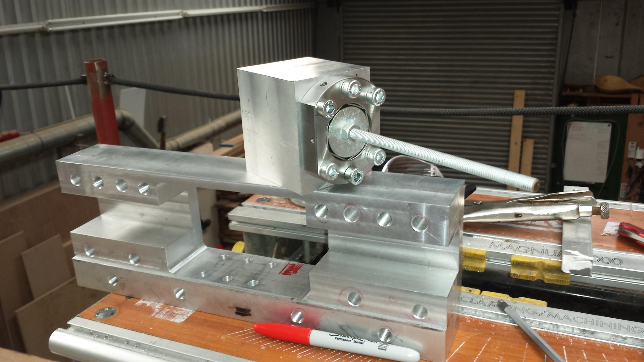

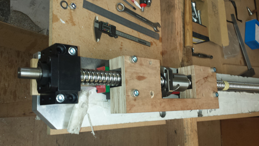

so... mocking up the bearing carriage for the x axis, the wooden block was made as a model to see how the clearances worked out and to visualise the ballnut mounting method, as I could not see the wood for the trees in cad. once assembled the mounting for the ballnut is obvious immediately. working in wood is an easy and cheap way to prototype parts, the block of 6082 this will be machined from is about £100 and will take the best part of a day to machine so cant afford many mistakes
http://www.mycncuk.com/attachment.ph...id=14875&stc=1
http://www.mycncuk.com/attachment.ph...id=14874&stc=1

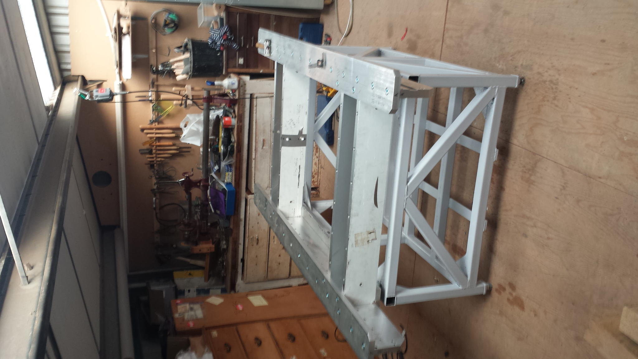

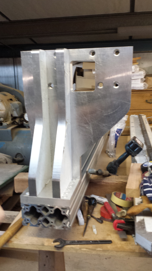

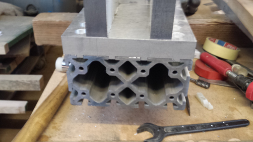

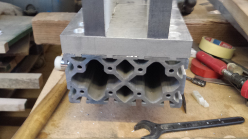

gantry risers are finished... ready for trial assembly
http://www.mycncuk.com/attachment.ph...id=14882&stc=1
upside down but shows how the top plates interlock with the gantry rail to help with alignment
http://www.mycncuk.com/attachment.ph...id=14883&stc=1
detail
http://www.mycncuk.com/attachment.ph...id=14884&stc=1

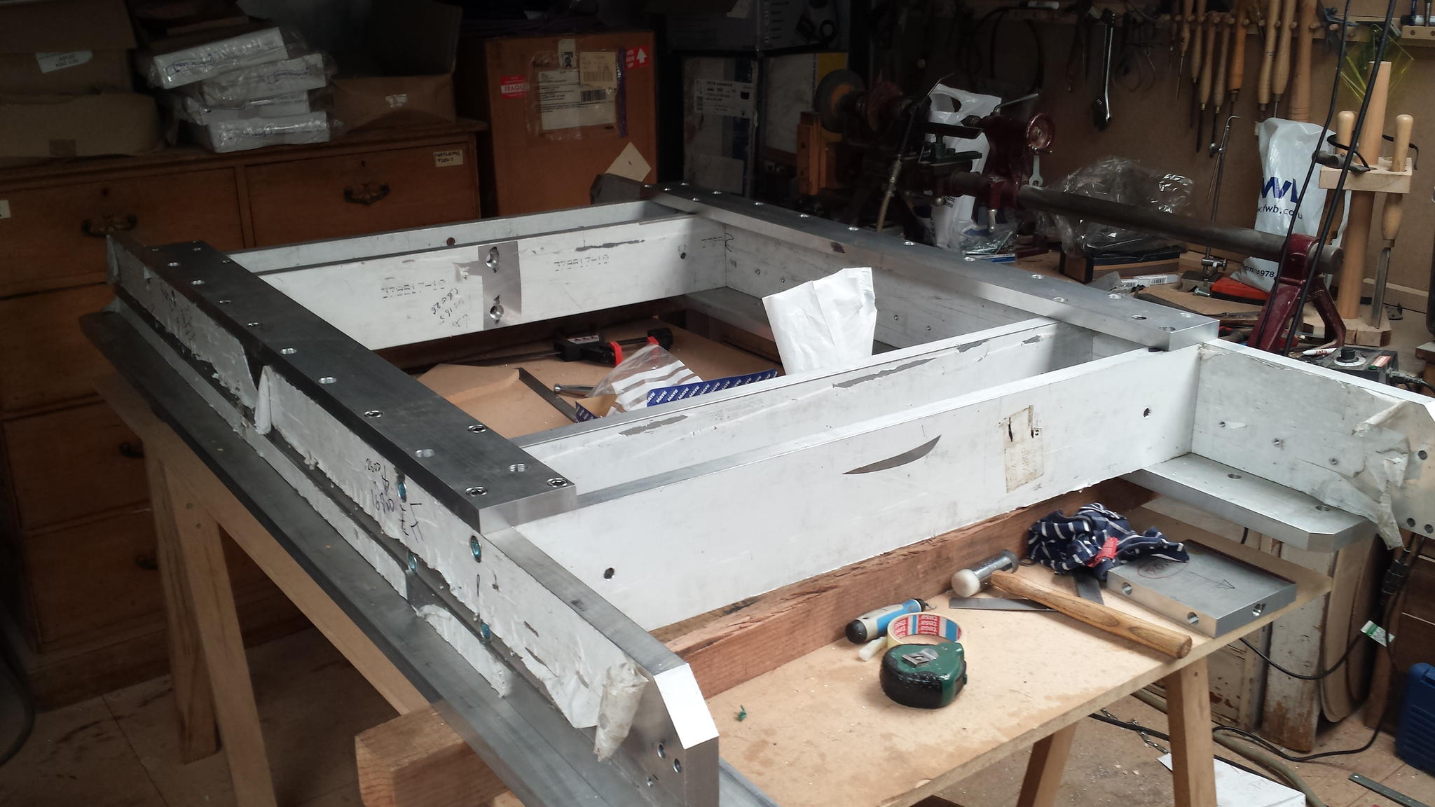

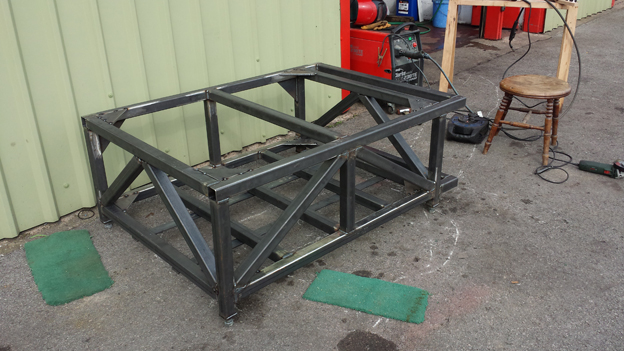

bit more progress, x axis is hopefully "finished" ie only needs minor changes like limit switches and guarding fitting.... and base frame is made, so I can start a trial assembly soon
http://www.mycncuk.com/attachment.ph...id=15094&stc=1http://www.mycncuk.com/attachment.ph...id=15093&stc=1
x axis on its stand, square and levelled..
http://www.mycncuk.com/attachment.ph...id=15201&stc=1

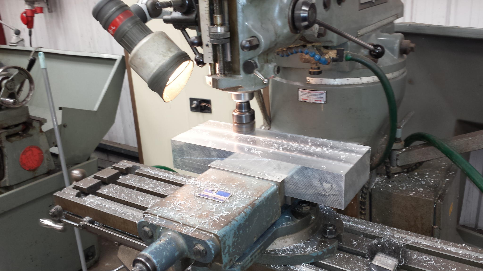

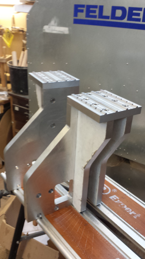

bearing carriage machining...
http://www.mycncuk.com/attachment.ph...id=15200&stc=1
and one finished
http://www.mycncuk.com/attachment.ph...id=15199&stc=1
both now done... bit of aping & counterboring then I can start assembling the gantry

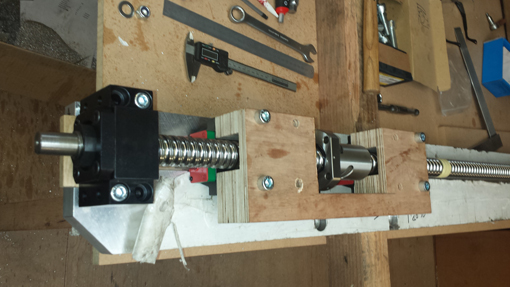

Ballnut, 32mm, housing and bearing carriage ready to fit
http://www.mycncuk.com/attachment.ph...id=15386&stc=1
