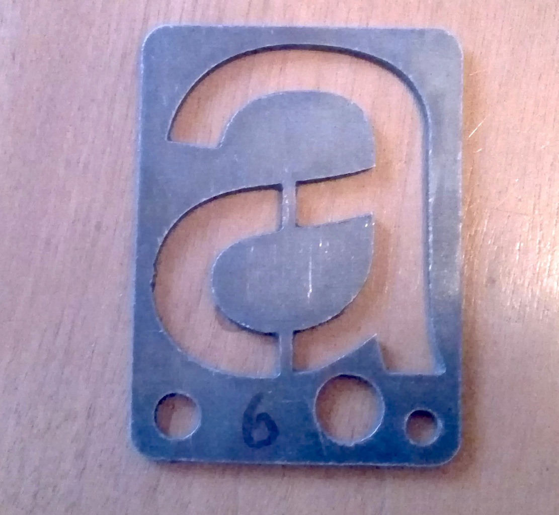

Pleased to report back that after changing the Sheetcam postprocessor from Mach3 plasma with THC and backlash compensation to Mach3 plasma with THC in the Sheetcam options the curve now cuts as a smooth line. Even the 6, 8 10mm holes are better.
Thanks all :)
Attachment 17932
