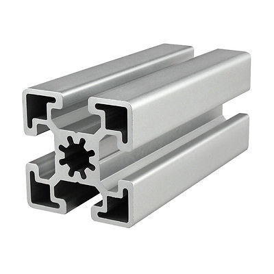

If you're going to use box section I'd go with steel, box section is a lot weaker than T slot extrusion (Less material for a start but also cross bracing, etc.)

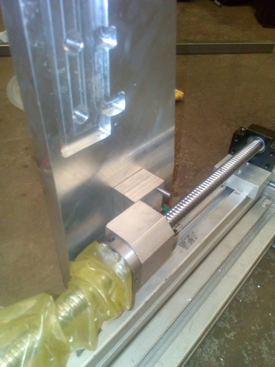

Finally!
Attachment 22423
KJN drilled and counterbored this to my cad model has some minor issues but everything is good and would highly recommend KJN to anyone else who might want to do something similar. For what it cost it was well worth it!

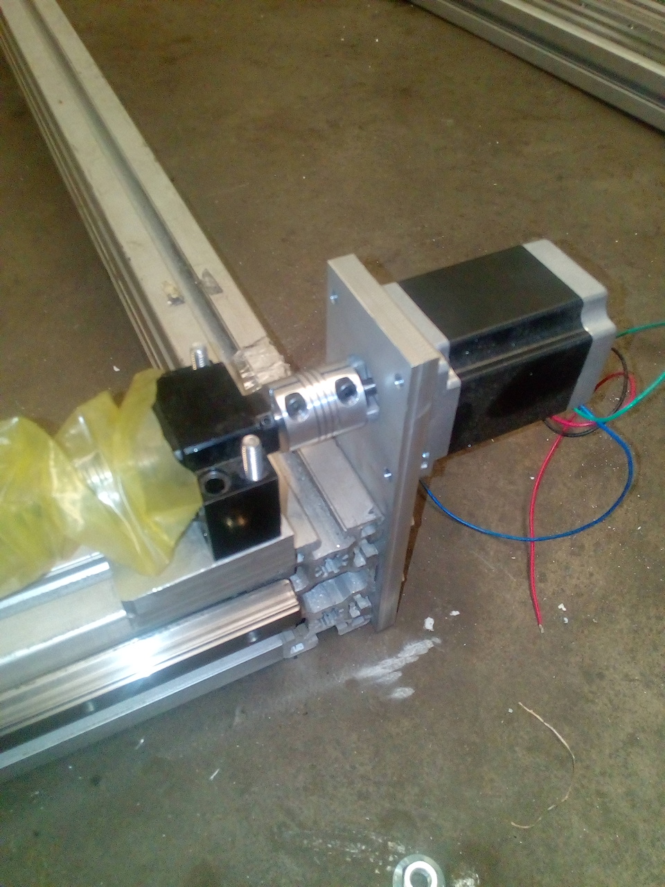

I wonder if my Nema's are underpowered
The Y axis has 2 matched nema 23's 1.8nm, the X axis (Gantry) is unknown nema 23 as I recovered it but is identical size and weight to the 1.8nm's so I assume it is a 1.8nm and the Z axis is a 1.2nm stubby that one is an Italian stepper motor.
The Poulou stepper drivers can only power 2amp at 24v which will limit the motors even more (The bigger ones are 2.8amp) but I will buy 4 AM882 drivers and breakout next month and have a 48v power supply kicking around so should be able to get closer to their potential in the near future.

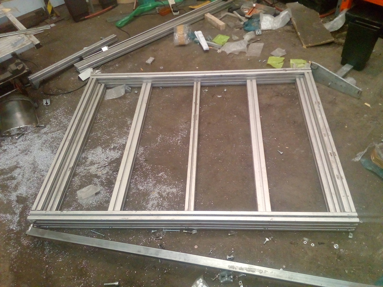

Managed to do 10 bolts without a Tap but hard hard work take note the size of lever lol. Ran out of bolts now when the rest come the tap will be here as well.
Attachment 22465
2 pieces making the bottom frame are 6045 extrusion which makes it look a little odd. I wonder if I spaced them close enough together the gap is less than 30cm between each extrusion will have an 18mm MDF board on top
I'm impressed with KJN's cuts the frame fits together perfectly. I had the outer frame cut from 9045 ages ago then had them cut the 4545 and 6045 that make the bed up the other day. Other places I;ve used they would not fit properly.
Need to have a think about legs I want to have a shelf underneath so I can put vacuum cleaner & cyclone, water cooling, etc on the shelf to keep things neat and under control.

Attachment 22608 The ballscrew will have a mount either end to bolt into just laid it roughly where it's going to go, Hiwin's bolted on finally need to cut them down.
This will be the gantry (Has clone Hiwin's on)
Attachment 22609
3 individual pieces 2 * 4545 and 1*9045 will drill 5 holes through the 4545 and bolt using T nuts to the 9045 to reduce flex.
The Hiwin problem anyone who's used 15mm Hiwin's and a 1605 ballscrew knows this problem lol, it doesn't affect my Y axis because the ballscrews are at right angles to the Hiwin's but the gantry and Z axis both had this problem which I solved with a combination of spacers and recesses.

My custom nema mount and bK12/Bf12 mounts work pefectly
Attachment 22618
BK12/BF12 mount countersunk bolts so the bolts go from underneath the other 2 holes are to bolt into the T nuts.
Attachment 22622
The ballnut & spacer bolt in perfectly although I removed the bolts again as they need to be cut down 5mm.
