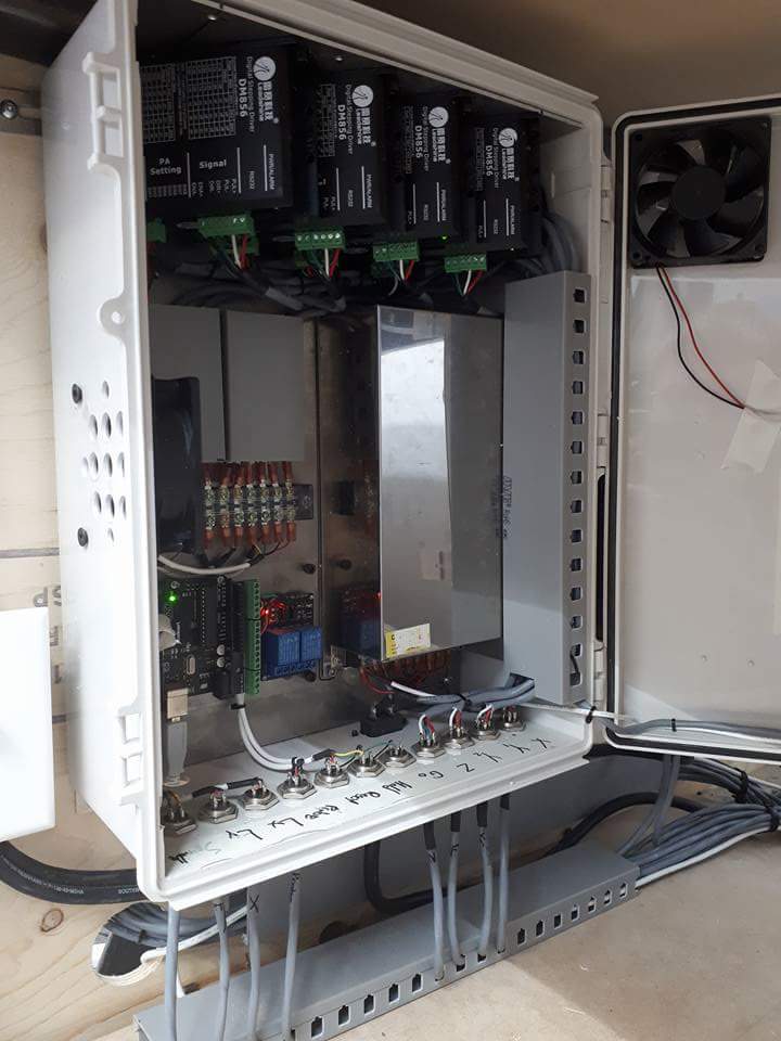

I am about to purchase those shocet connectorst ,since they have 40 days delivery to Greece,are those any good? How many pins per socket to I need?
What do you need them for? ;)
Are you thinking about steppers or maybe switches?
Plan ahead and order with one pin more than you need. I have similar connectors that doesn't have continuity in the shells so I need an extra pin to connect the wire shield. That's assuming that you will use shielded wire?
In theory you could have a big 20-25 connector for plugging everything in with one socket and then route it in connectorboxes on the machine itself.. :D
Hi Robert,thanks for the fast reply!
I am thinking to use them on the housing box to connect the cables that comes and goes from the electronic housing box.
Something like that:
Attachment 23257
Okey.. but do you want one for each motor and separate for switches or do you want only one big cable?
If bundling several signals in the same cable you loose the screen protection between them..
The normal that I see people using is one for limits and a one each for each motor
And of course if you want e-stop on the machine or probe or something like that.
Steppers are usually 4 signals + shield so 5 pins.
A switch depends on type of switch! But could be +, gnd, signal, shield so total 4 pins.
But it could also be + and gnd without shield for a simple mechanical switch with simpler wire for a total of 2 pins. But greater risk of interference.
So it all depends on your equipment :)
Ok that's makes everything clear now,thanks!

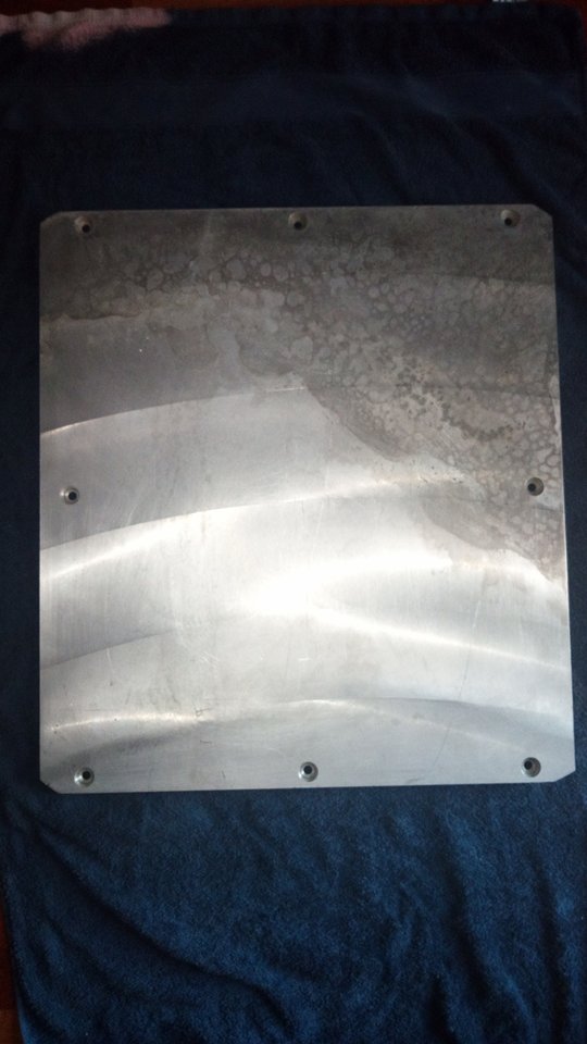

I just score that today for 80 euros, it is 540x600x20 mm,I am planning to cut it and make the z axis plate out of it.I will use my bandsaw and then my router to make the templates out of plywood and after that I will use the same tools to cut this Ali,as Joe Harris has already done very successfully I must say!!!.:applause:
Attachment 23264
Nice Nick!
You are brave to route that with a handheld router :D

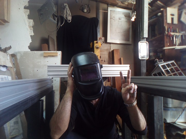

Welding time!
Workshop is so small even with the extension, that I can not take a full photo of the cnc table,lol , behind me you can see the old wall,it is where are the bricks, the extension is behind it where the blue curtain is.
80x80mm square tubes were used, for bracing I am going with 50x50mm.
Attachment 23454
Haha go go weldmaster :D
You will soon have use of all planning!
Lets not have a race.. have a feeling you will be ready before me ;)
No way!!! I have no motors, spindle ,not catted the alu plates etc....So, no way! hahaha!!!

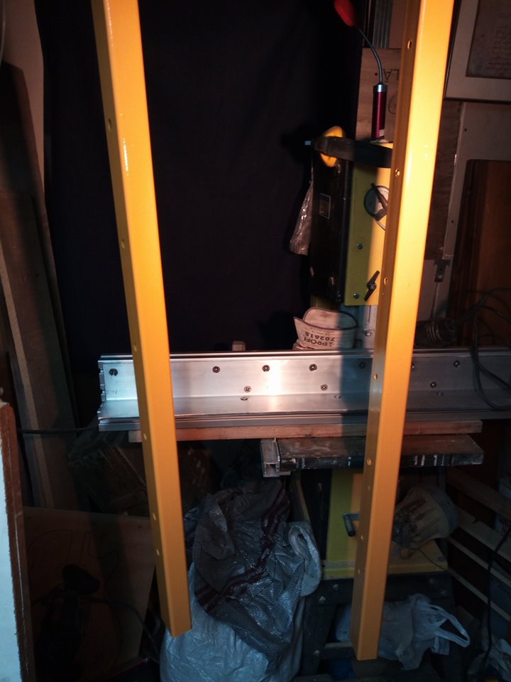

I made some progress today.
Attachment 23494
Attachment 23495
Cut one of the aluminium beams I have and use the piece to add stiffness to the L beam.
Attachment 23496
Attachment 23497
Attachment 23498
Attachment 23499

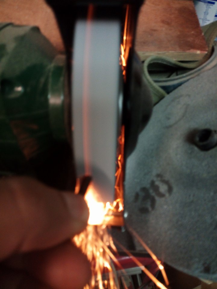

I made a pass from the table router and cut the aluminium angle straight , something that wasn't possible with the cutting grinder.
Aluminium angle is 5mm thick, I believe it is going to add something to the construction,I hope stiffness and not only weight!lol!!!
Attachment 23500
Nice ;)
I use the end mill chamfering with sunk to prepare the holes,then screw the aluminium angle in place, the axis weight now 8.7 kilos.

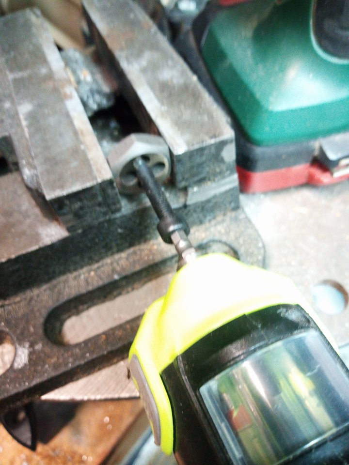

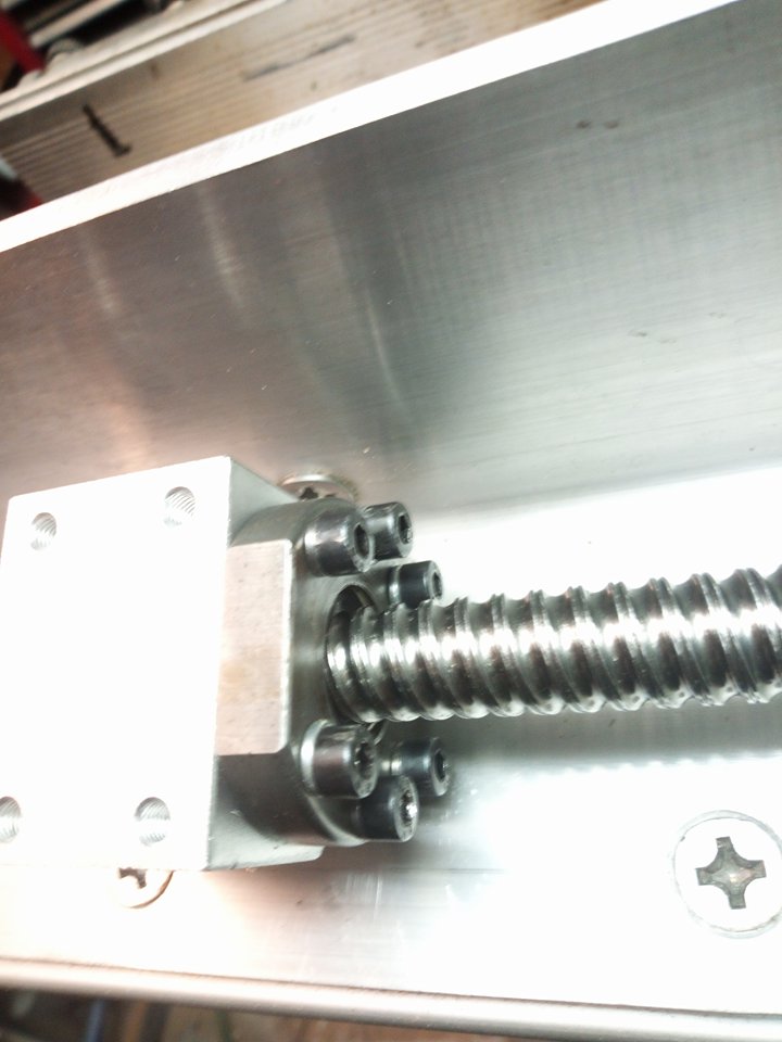

When you measure the depth of nut housing bracket for ordering your screws, remember that the tapering stops 3 to 4 mm before the maximum depth.
I realize that a little bit late but the fix was easy...
Attachment 23563
Attachment 23564
Attachment 23565
And here is a useful article for guys who do not know (me):toot:, how to assembly the ballscrew with the BF and BK bearing blocks!
http://www.hobbycncaustralia.com.au/...1Ballscrew.htm
