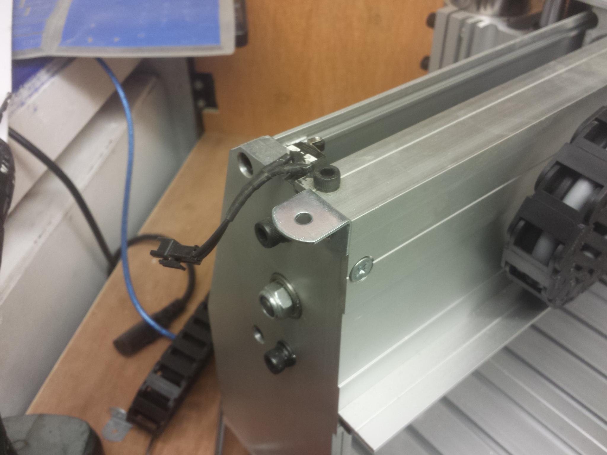

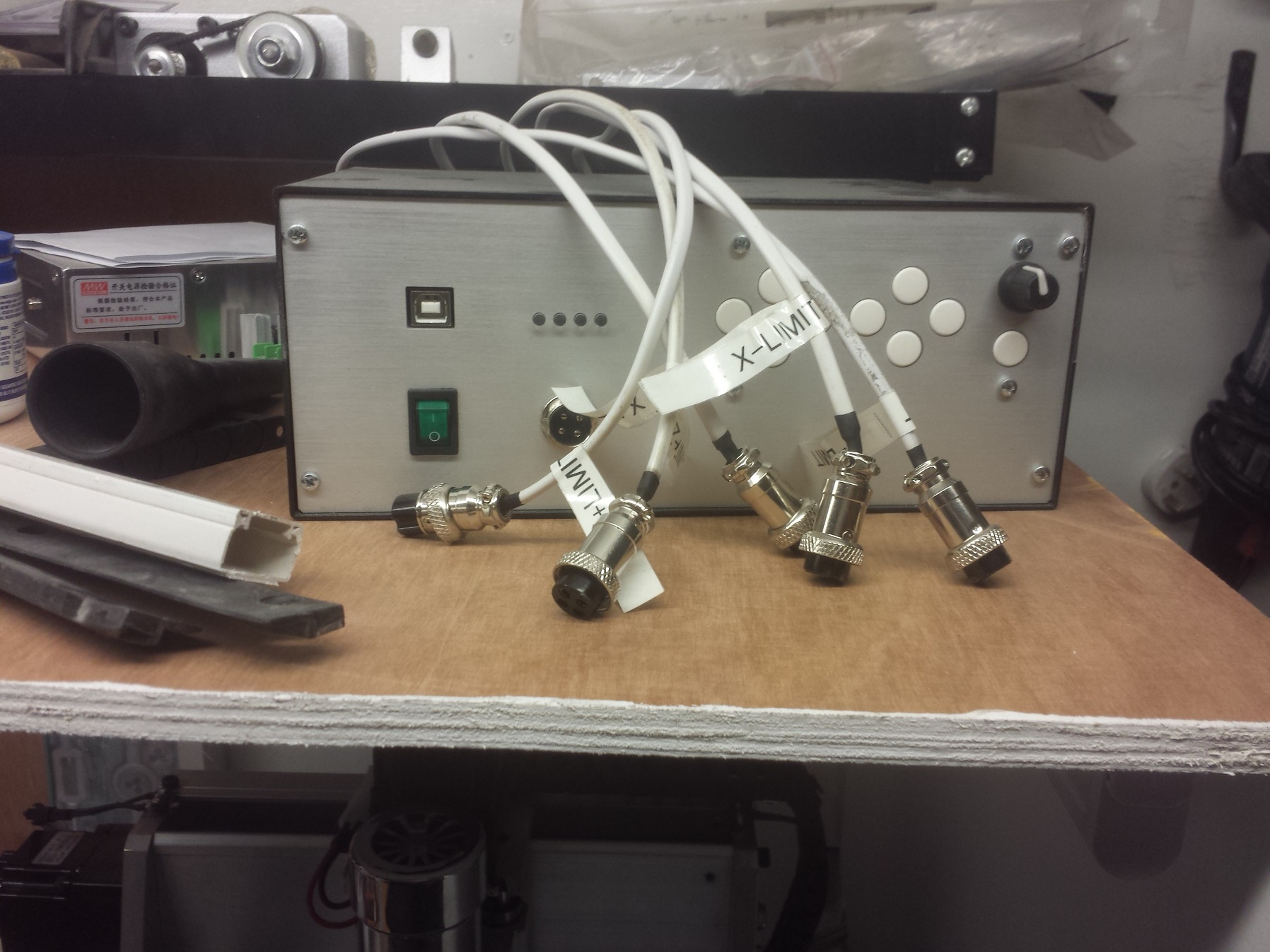

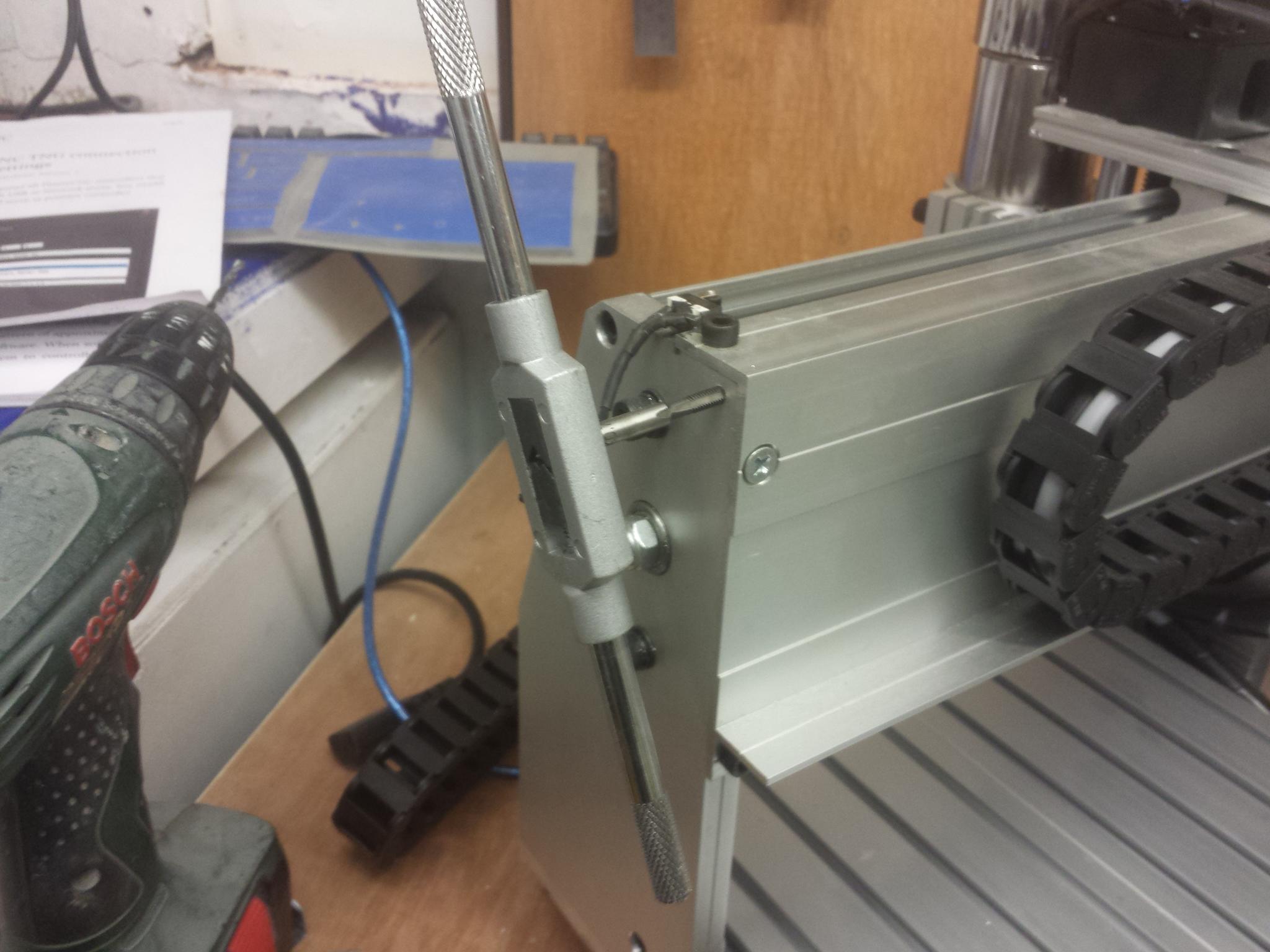

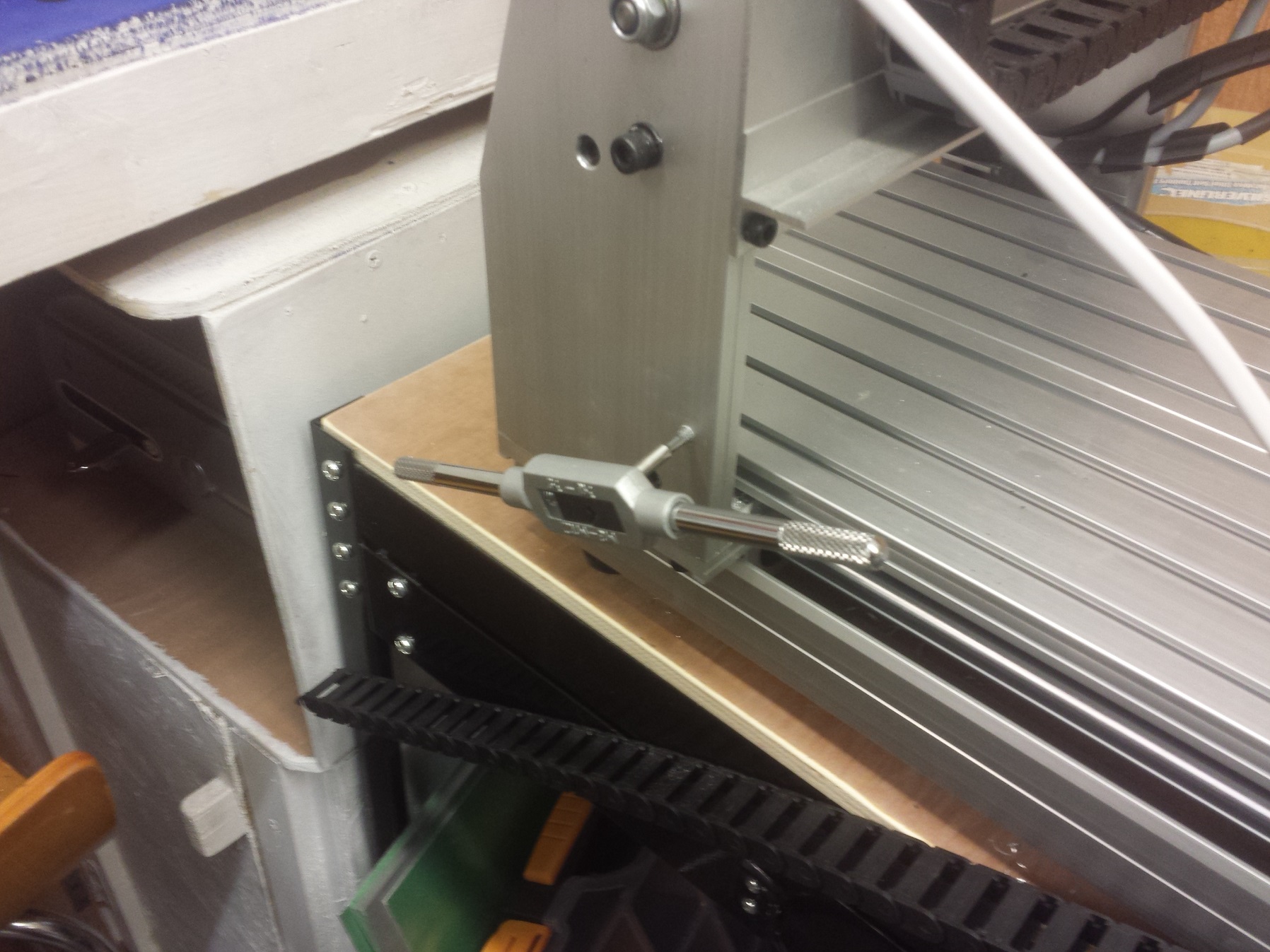

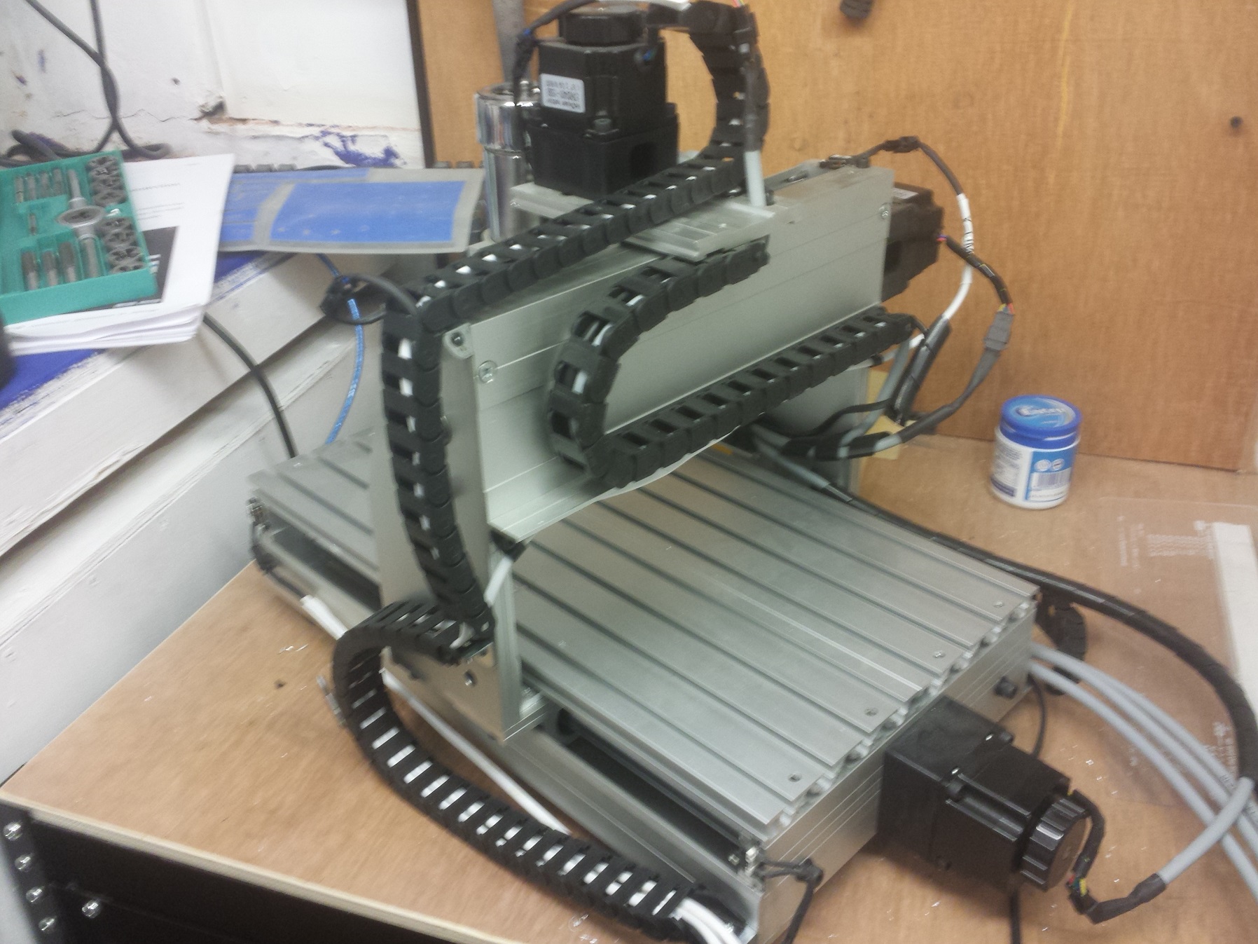

Managed to find a quick hour to do a bit on the machine with not the best results :-(.

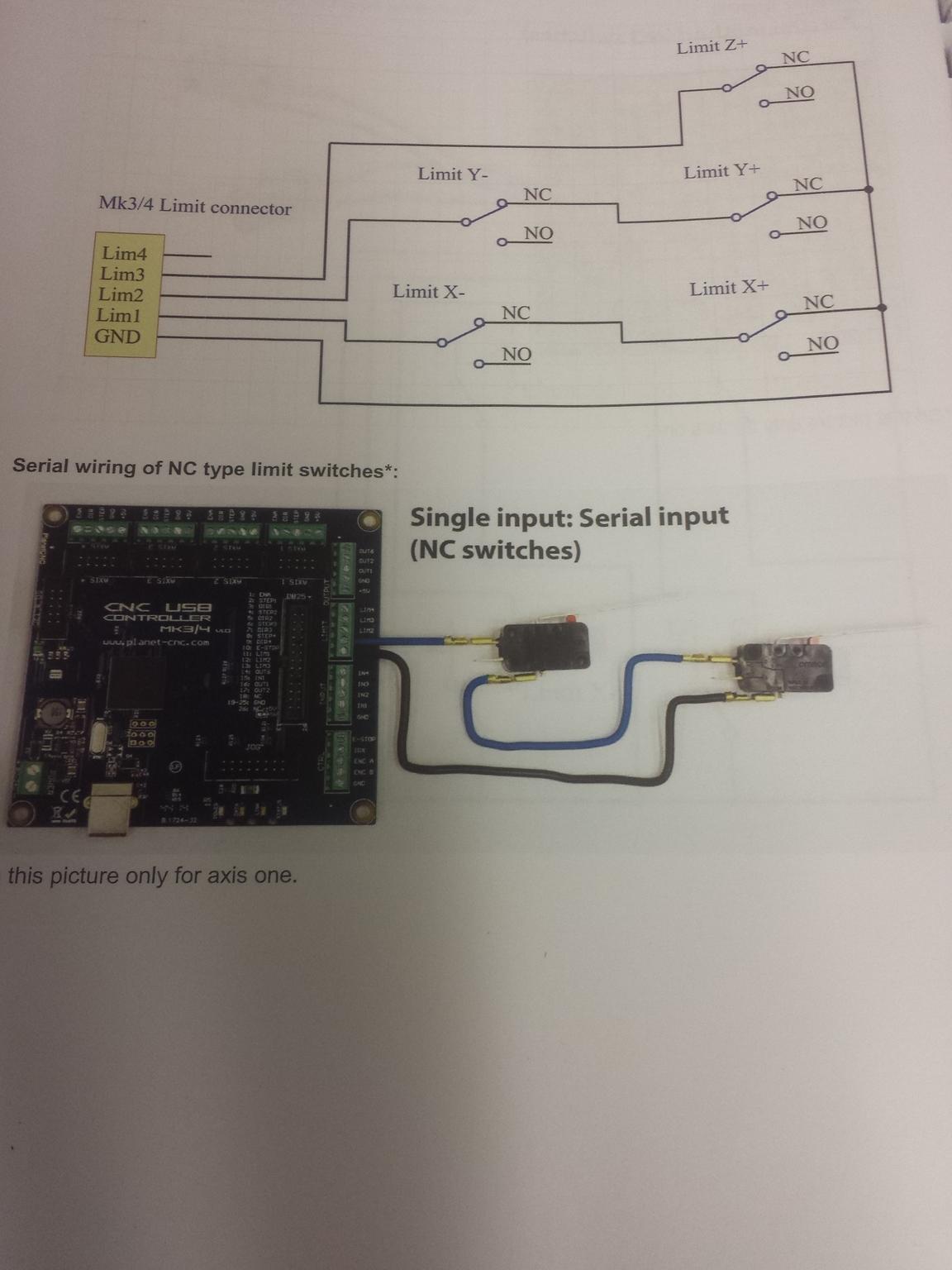

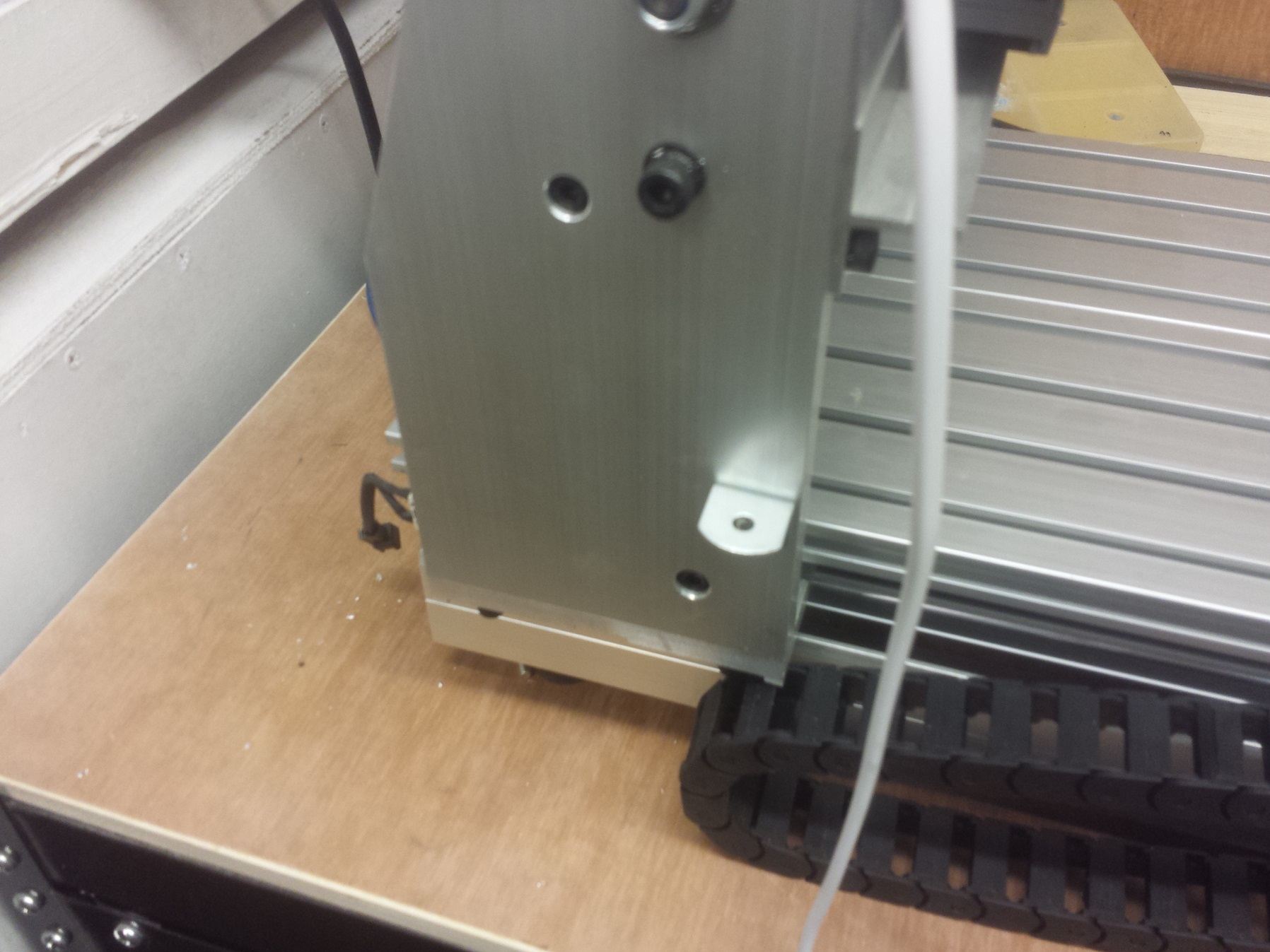

Anyway I have wired up the limit switches and installed a second cable track on the opposite side to the motor cables to try and keep them separate. I have also drilled and tapped some holes to help clip the cables nice and neat
Attachment 22589Attachment 22590Attachment 22591Attachment 22592Attachment 22593Attachment 22594Attachment 22595Attachment 22596Attachment 22597Attachment 22598Attachment 22599Attachment 22600
Re: My Cheapo Chineese 3020t mini CNC Build (more like improvements) leanring all the

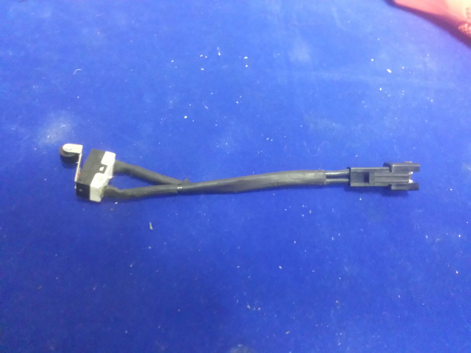

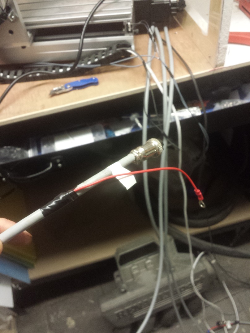

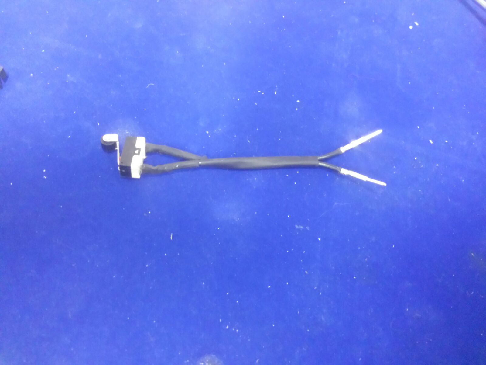

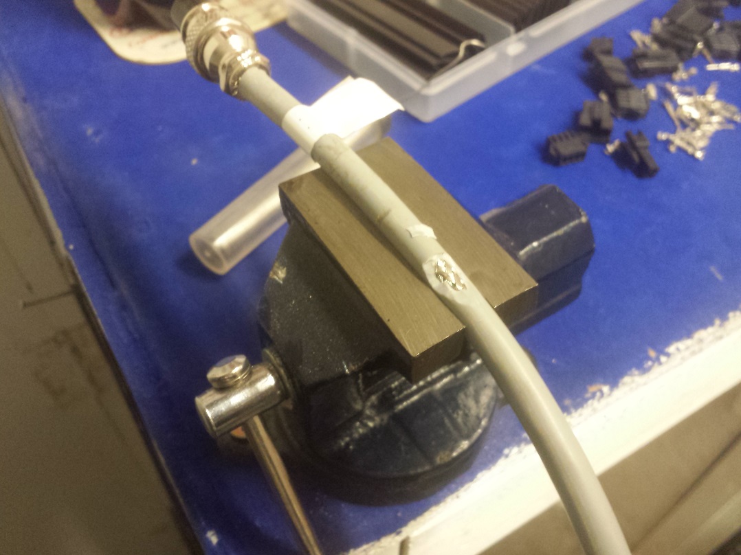

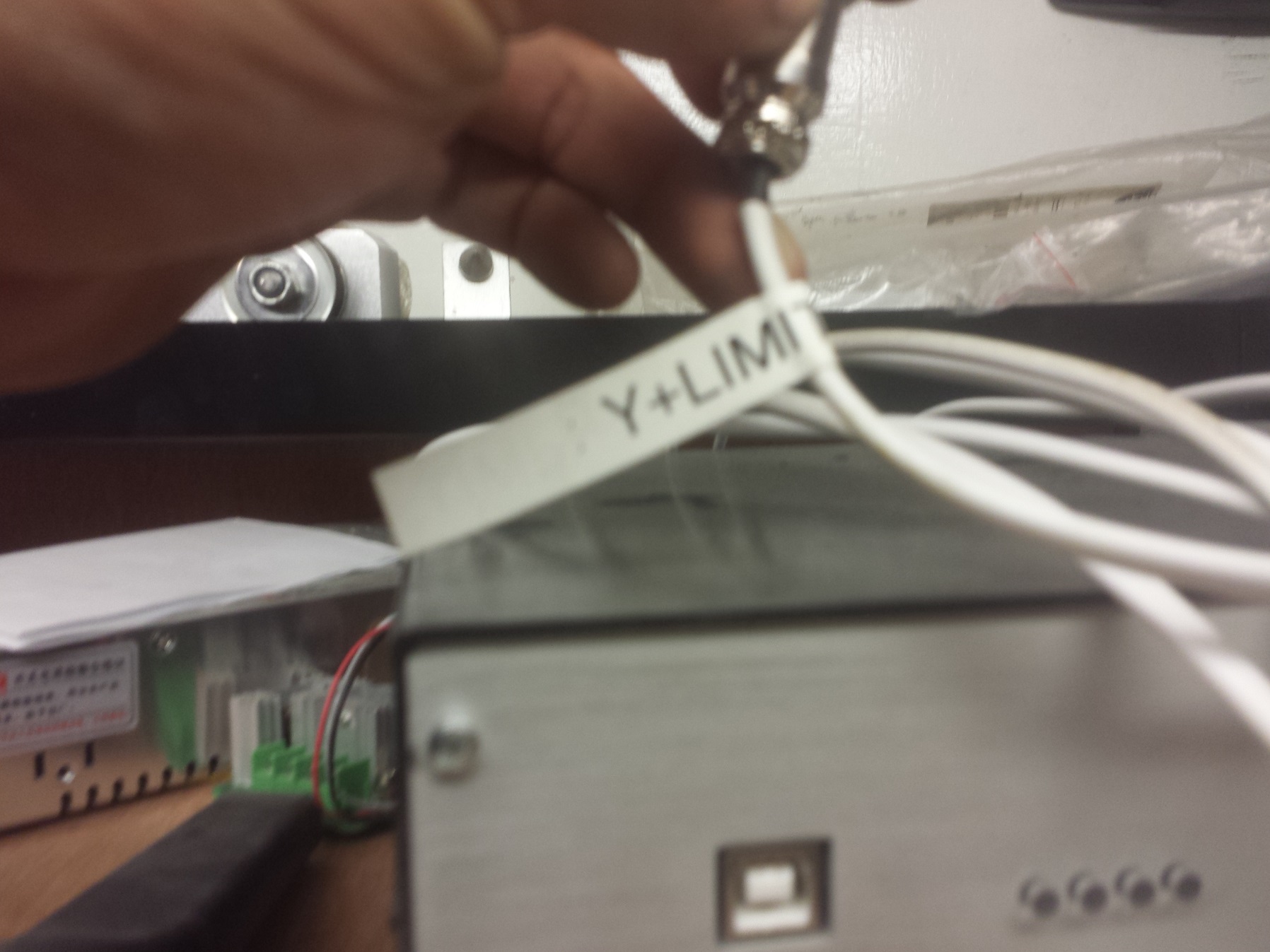

I labelled each of the limit switch cables only to find I did the wrong lol, only need one cable per axis (2 switches)
Plugged it all in but its still not working correctly, motors seem to stop intermittently and something up with the y limit plug socket in the box.
I have not done anything to the settings apart from set the units per step which seem to be working now (when the motors don't stop)
I have sent an email to planet cnc and will do some more investigating tonight. Very frustrating as its starting to look really neat, just got to make sure the hardware has been assembled correctly
All a learning curve , be it a VERY frustrating one lol

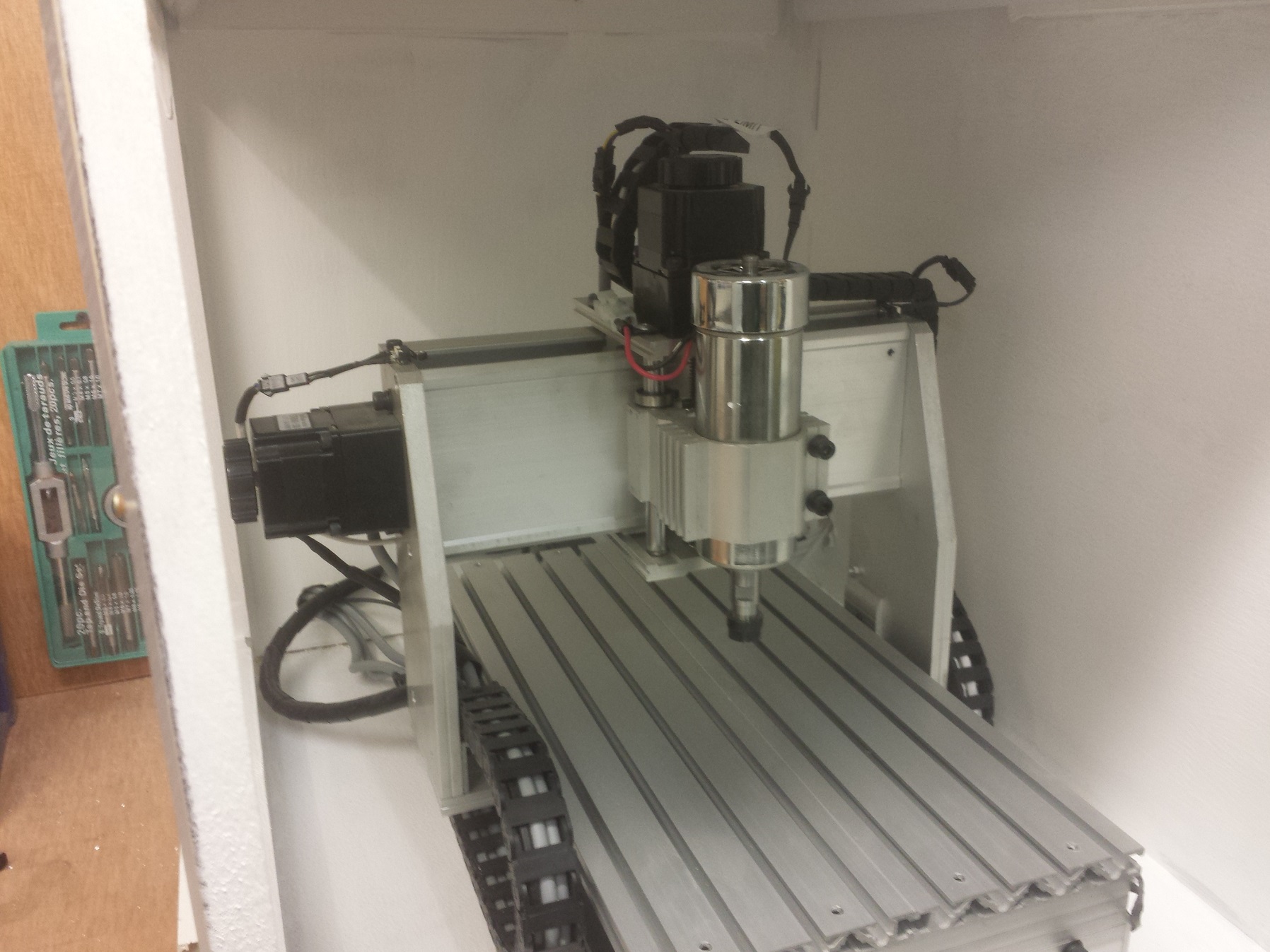

Right chaps, had a bit more time to play with the machine and iron out some faults, it appears my motors seem to stop working off their own accord, if you jog it one way then it move fine until it meets a slight bit of resistance, then it just stop's, but makes a horrible noise and tries to move each way slightly. My motors are anchuan 57hd0401-15sb. Im hoping that this is due to the severe lack of torque? My theory was to buy a new set of motors anyway with my installing the larger spindle, so I may purchase just one new motor to clarify that the low torque is the problem. Anyone had any experince with this type of problem?

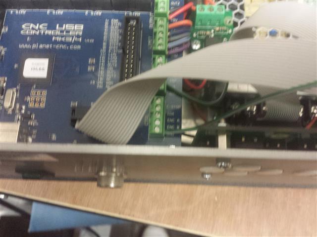

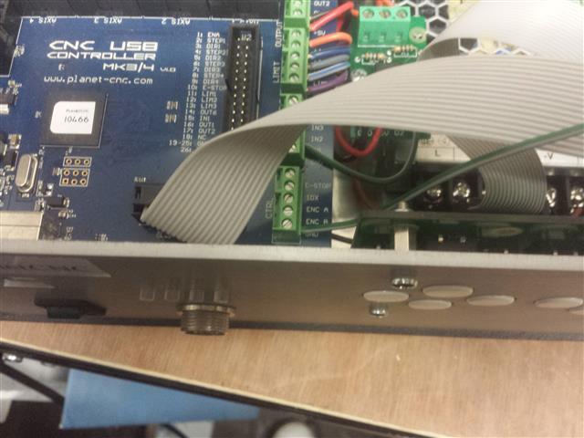

looks like these are the drivers https://planet-cnc.com/product/motordriver-2-5a-32/
says current selectable.... i would say there is a good chance the current is set too low.
hmm, sounds interesting mate. Is this a variable that is changed via the software or manually on the control board?
i would guess a jumper or pot on the board.
looking at the pics, you have a little dip switch to choose the micro stepping setting, so chances are the red jumper is your amperage setting.
edit - infact I think i can make out "Imax" next to the jumper in one pic, so thats almost certainly the puppy. Check what it is set to.
I will go and have a look at my pics now matey
Looks like your motors are 2.0A from a quick google (you may want to verify that yourself) so thats the setting you'd want on the drivers
right I understand exactly what you mean, the 4 little boards are the drivers, and there is a jumper on the 2 pins the other side to the 2 pins labelled imax
I have looked at the pics of my install and the jumper is on the same 2 pins as in the advert on the site ie opposite to imax. Should I put the jumper onto the imax pins?
yeah those are your drivers, what you referred to in an earlier post as your new driver board is actually your motion control board.
Again, only working from educated guesses given the blurry pics on their website an no instructions, but you have two variables you can set on those drivers. micro stepping and amps. the micro stepping looks like it is set by the small dip switch, which leaves the red jumper for amps. one assumes the different jumper positions correspond to 0.5, 1.0, 1.5, 2.0 and 2.5 amps... if that is a correct assumption then you'd want the second from last pins if your motors are indeed 2.0A

your limit switch plugs are 4 pin... I assume that is to allow two switches per axis? sorry to state the obvious but have you definitely wired up to the correct pins in the plug for the Y-axis if that's the only one not working? You could have got the two switches crossed over such that the circuit is never closed and thus you would see no change on the IO.
yes mate pretty sure, the x and y axis have 2 switches wired in series (but I had the wires the wrong way around so I know they wont work. But on the z axis I only had 1 switch at the top of the z axis. When you press the switch the input on the software screen lights up. If you un plug it and place it in the x axis the input for the x axis lights up on the screen so I know the plug is working on the box. When I try it in the y axis nothing happens on the software screen which is making me think something is a miss with the box if that makes any sense mate
ah I get you...
I would double check your soldering on the Y-axis input then and also double check however that inputs/outputs board connects to the motion controller is plugged in fully and all required wires are present and correct.
If you have a multimeter you can check for any shorts on the input side, continuity between any of the pins would show that you have a short in there which would present a permanently closed circuit, thus any opening of the circuit by the switch wouldn't have an effect, giving the result you are getting there. Worth a check. You can also check that you have continuity between the board and the motion controller on that line.
As an aside, while nice to have, limit switches certainly aren't a necessity on a machine this small with weak motors like that - it won't have the power to damage itself and you can just start it up in one corner and set soft limits if you like. My first machine never had any limit switches at all, my second machine only had one set for "home" and soft limits for the end stops. Nothing to stop you from using it "as is" while you figure out your limit switch issues.

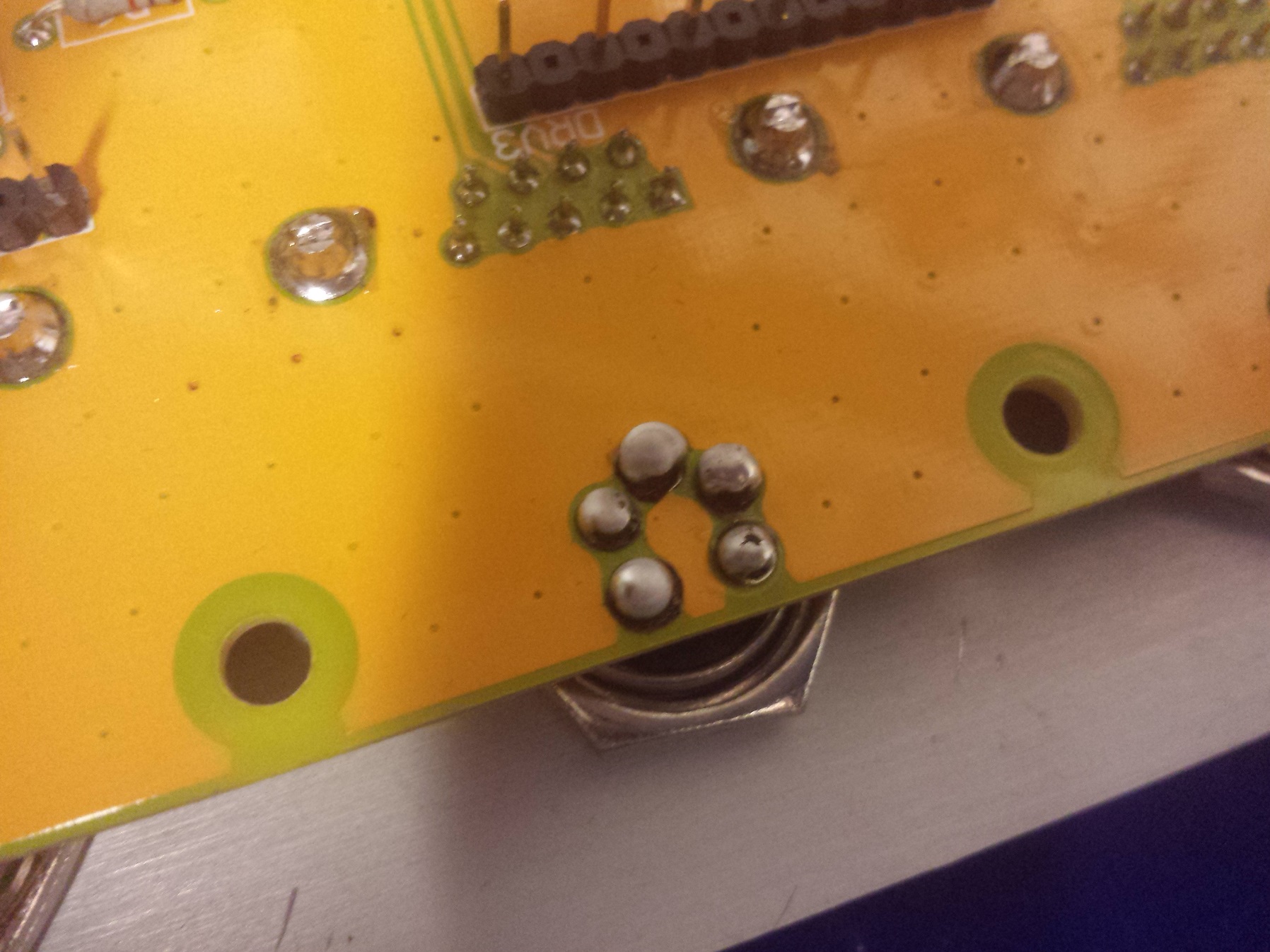

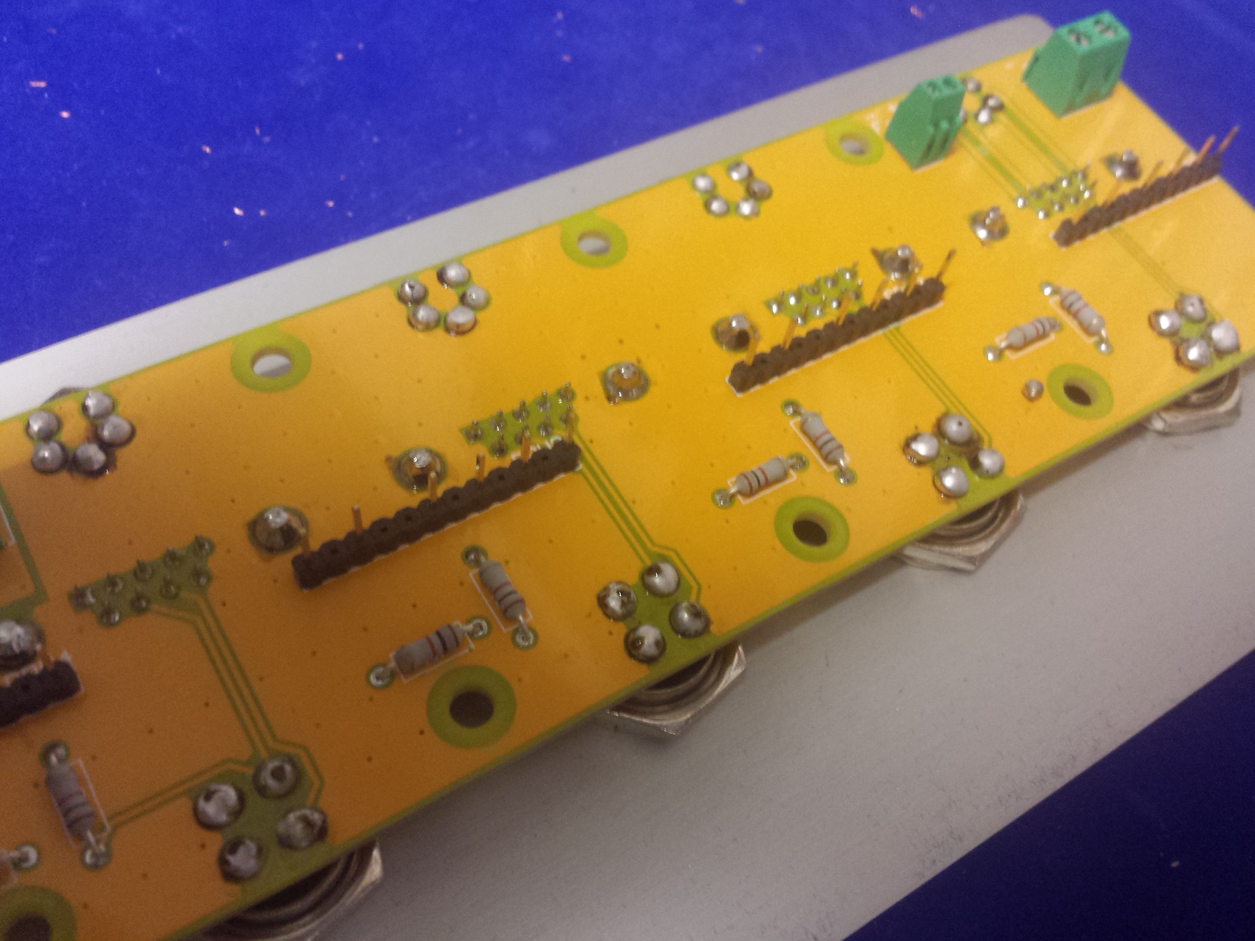

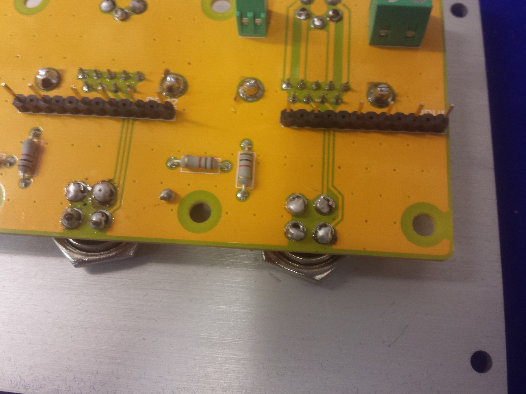

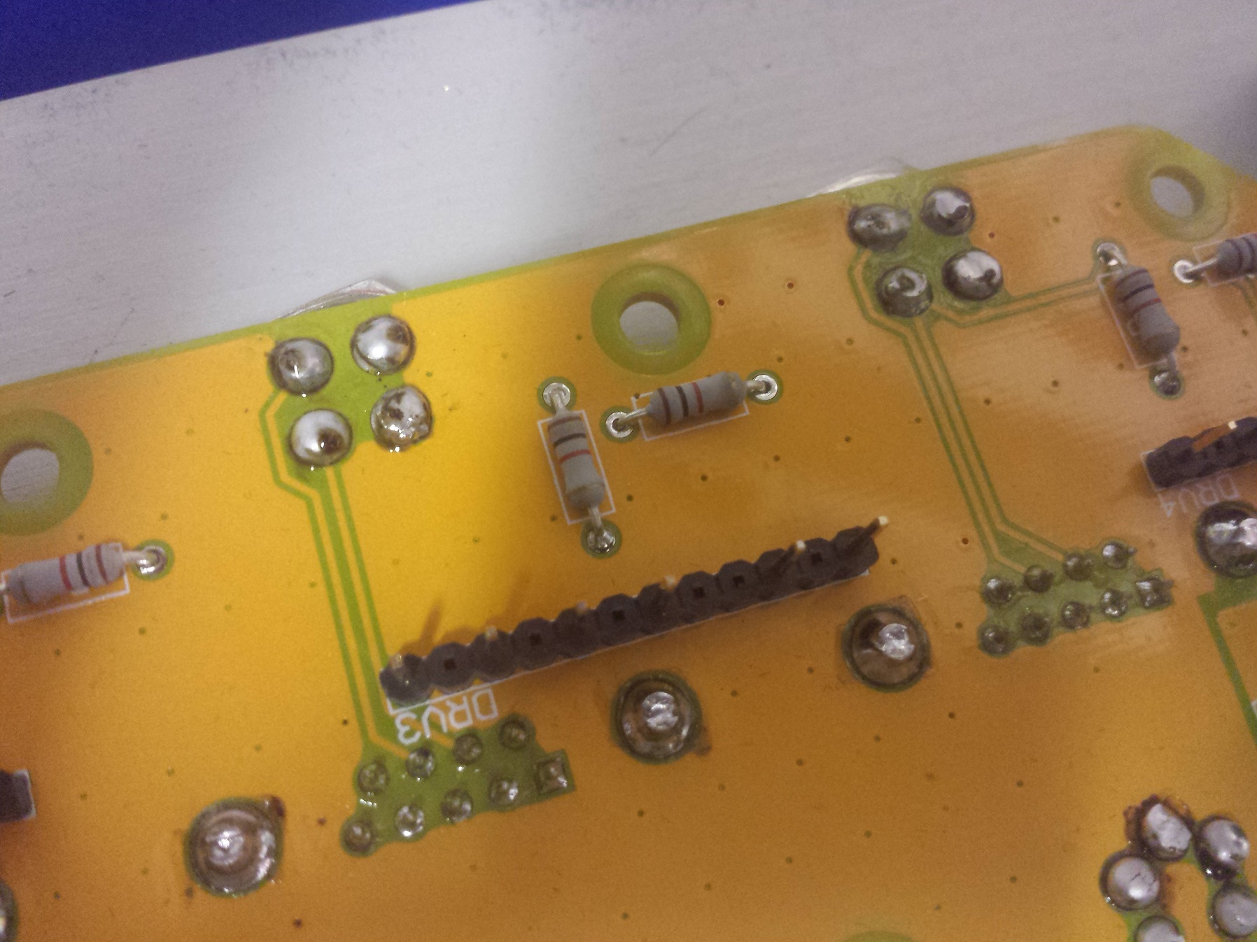

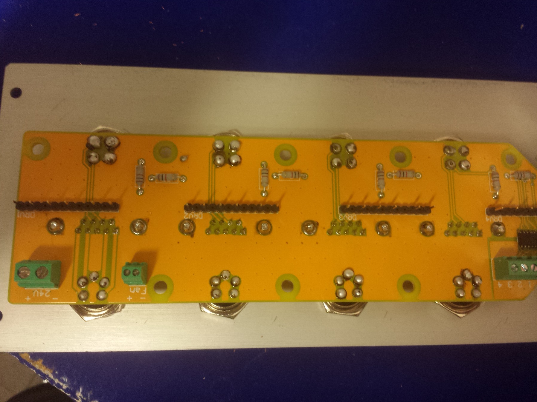

here is a pic of the soldering I did, the limit switch plugs are on the bottom.
Attachment 22662
I cant see anything obviously wrong from the picture, to check the back of it would mean removing all the soldering to allow it to separate. Am I correct in understanding that I could program the end socket to act as the y axis input if it works?

Really the easiest way to check for shorts or a break in continuity between points is using a multimeter... anything else is just guessing. If you don't have one, they are fairly cheap and extremely useful when doing anything remotely involving electronics.
Yes it is probably possible in your software to assign whatever switch input to whatever axis, but I have no experience with the planet-cnc stuff I'm afraid.
The other thing to watch out for when soldering boards like this is the tiny whisker of solder that bridges two connections. Can be difficult to see. Can't tell from the photo, but a scratch between adjacent soldereed pads with a small sharp implement may detect something, if there is anything there.
right then massive update, followed your advice and the motorrs are running sweet. Back to the y axis limit switch I have also followed your advice and found there is a problem with the board, the pins are connected fine, but there is a break in the signal somewhere. Not sure where though. Think im going to gave to remove all the solders and remove it from the metal plate to have a nose ffs
many thanks neale, after all the grief I got about my soldering skills (or lack of) that was my first port of call but they all look fine. I think I have found the problem. I have tested all the pins against each other and found an inconsistency with limit plug no2. All the other tests on the other plugs behave the same but when I do the same test on the no 2 plug nothing happens. There doesnt seem to be a visible circuitry on the pcb so i am guessing this is enclosed within the pcb somehow? uploading a vid now

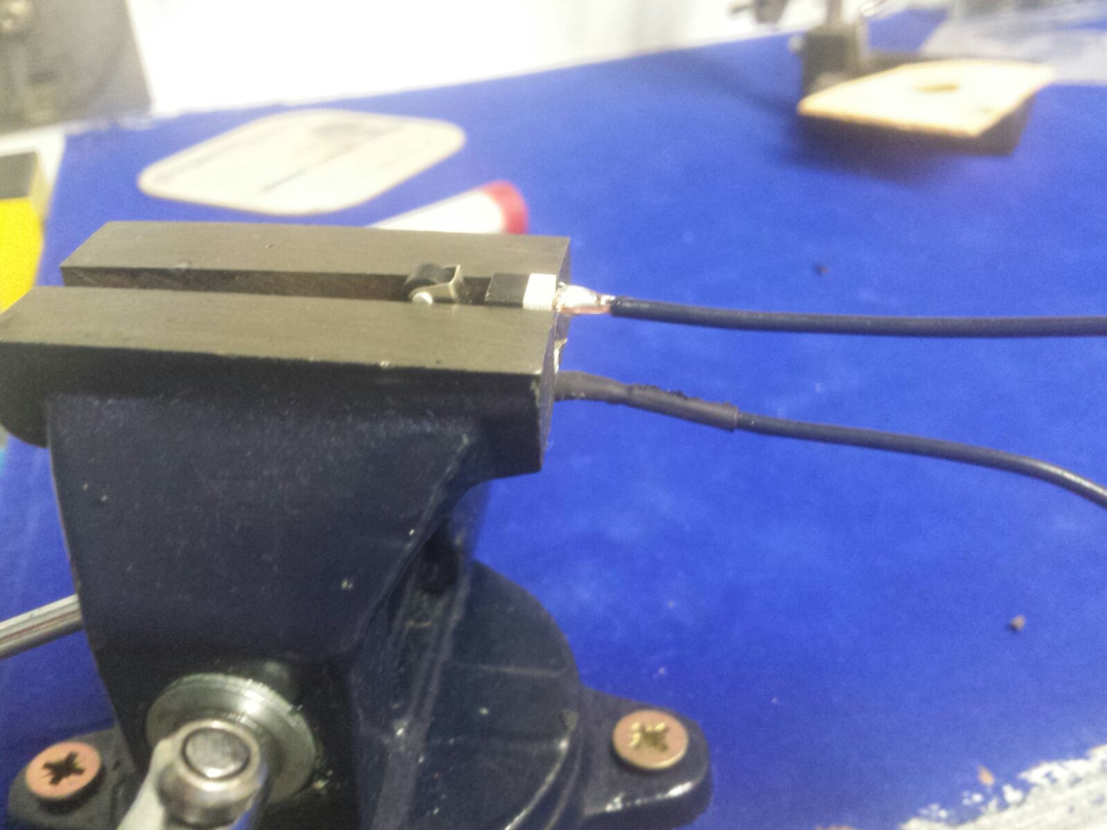

here you go chaps, excuse the crappy diagram but just wanted to show the test
https://youtu.be/ZIXuiPqgiY0
will be sending this info back to planet and hopefully get a new one sent out. This will give me a chance to finalise my wiring and get the earthing sorted. Just really motivated now thanks to you guys, getting the motors to work properly has really cheered me up.
possible when you were removing the solder you pulled up or otherwise damaged the copper trace around the hole... If so you should be able to see the trace in question, just scratch off the surface next to your solder blob and run solder to the trace. Alternatively you could run a small jumper wire or use a pcb repair pen.
Well bit of an update. I sent rhe pcd back to planet nd they emailed me back the day they received it saying there was a faulty bit of soldering on rhe board which they have rectified and tested. It is now back with me and I have re fitted it. This all took 3 days fir play to them foe sorting it quickly. Anyway I have been stripping the old control box to now house the stuff for the spindle motor

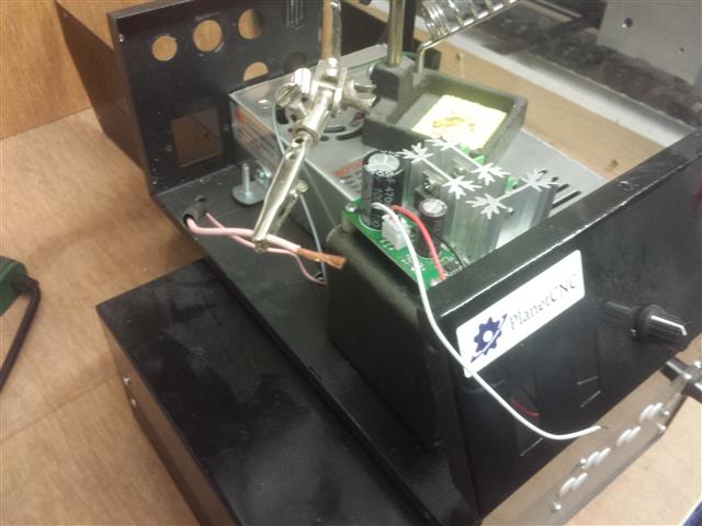

2 Attachment(s)

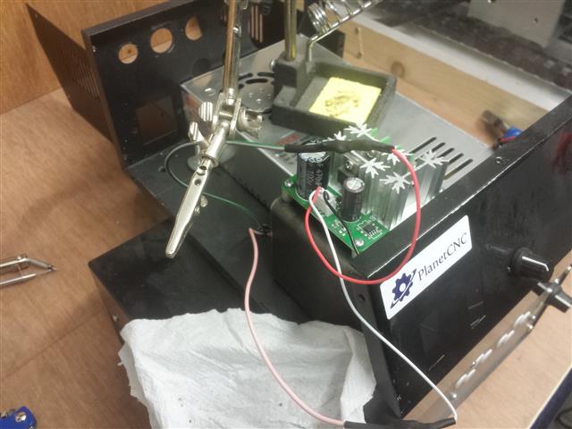

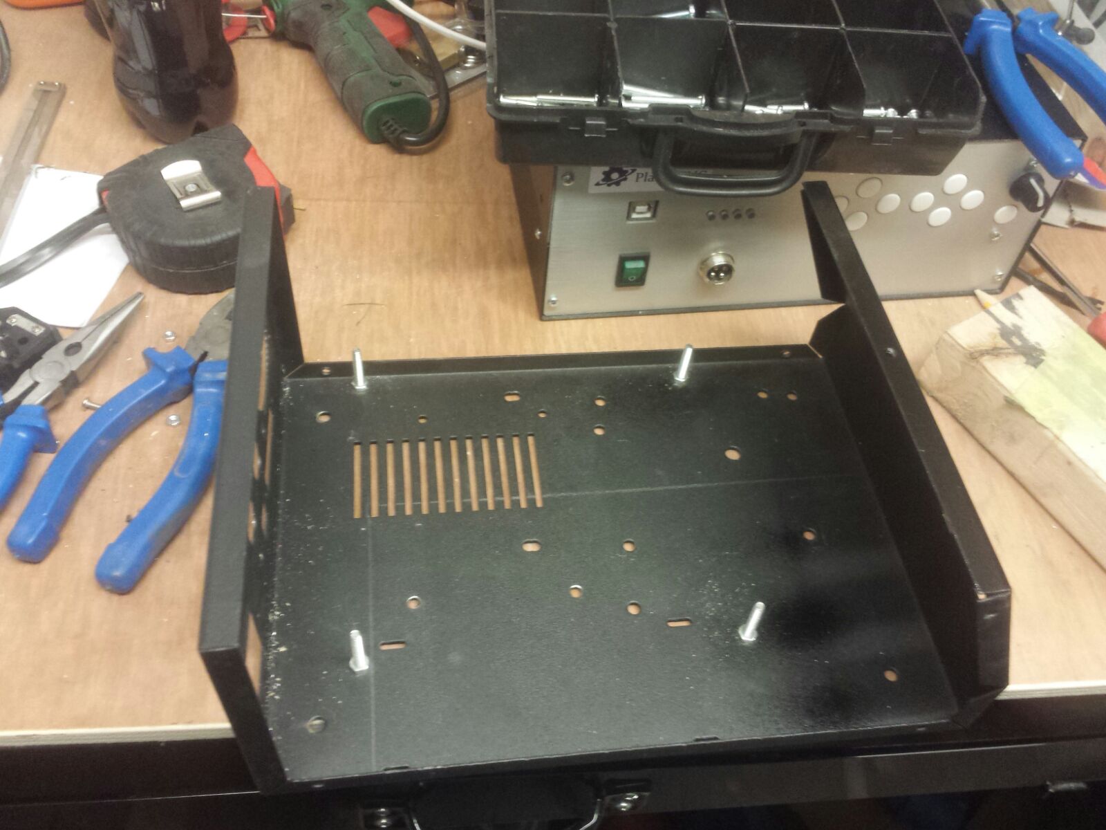

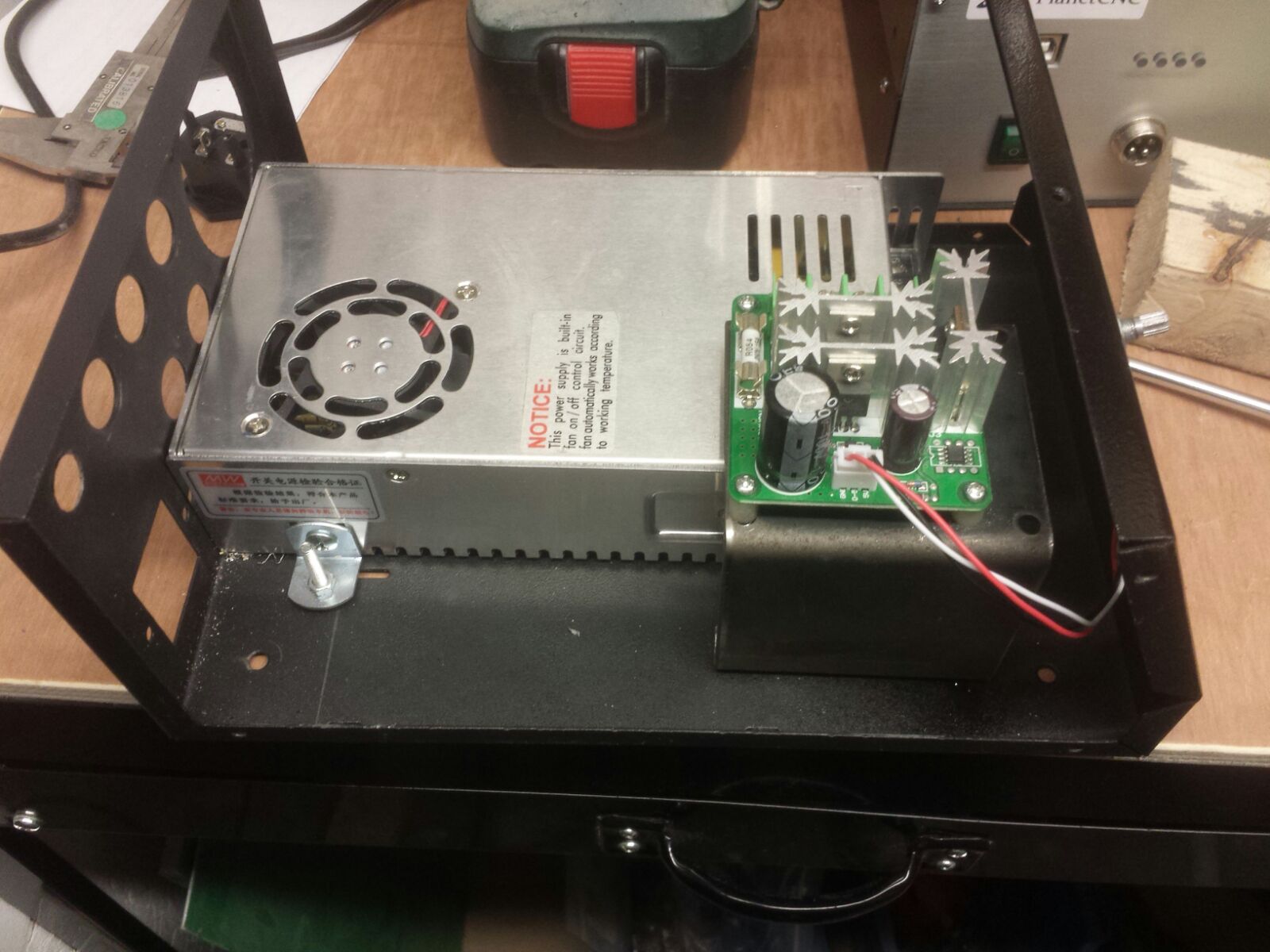

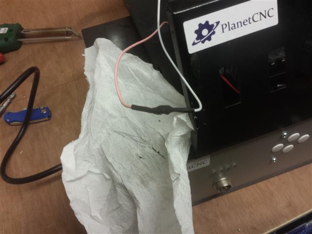

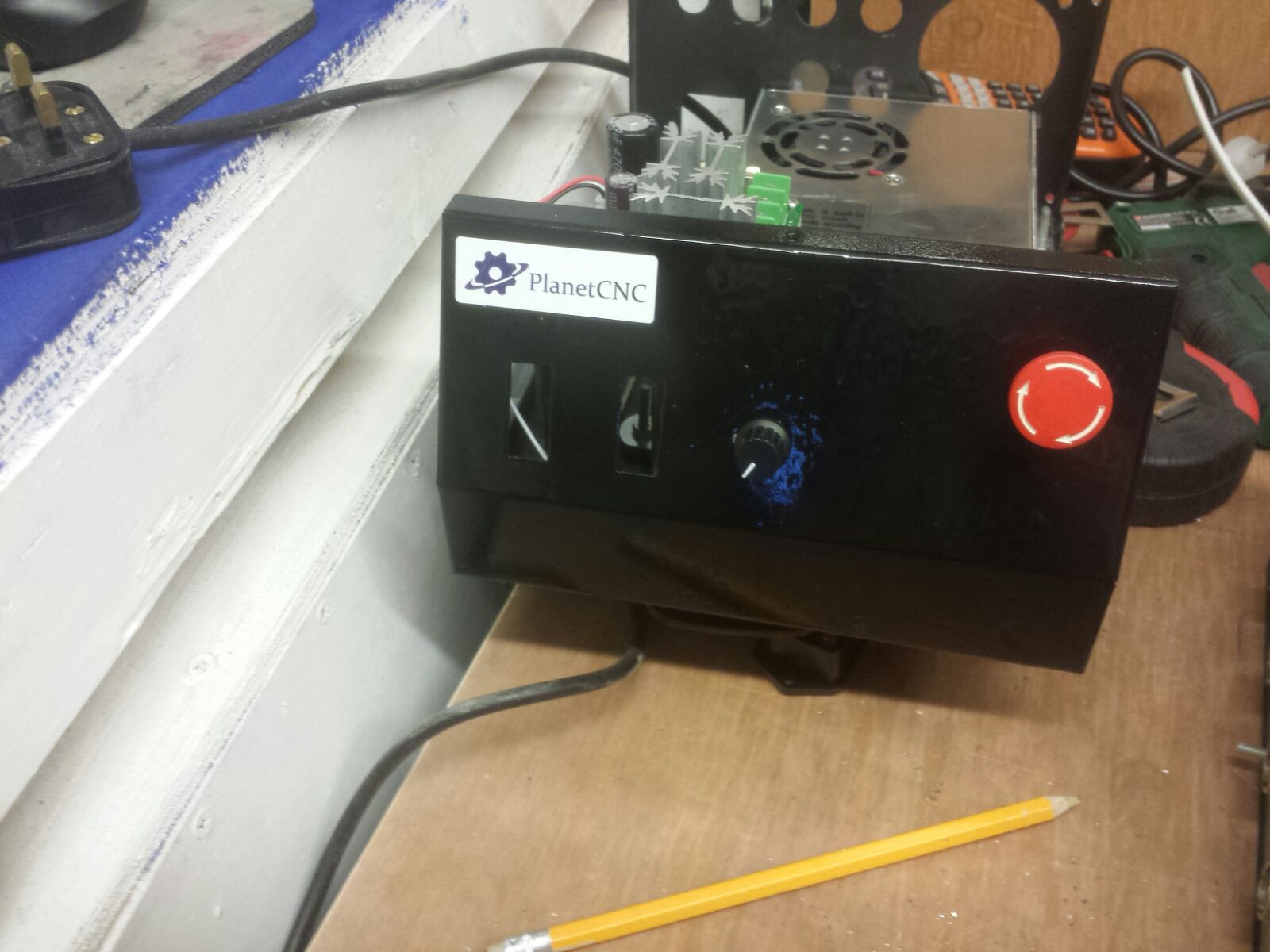

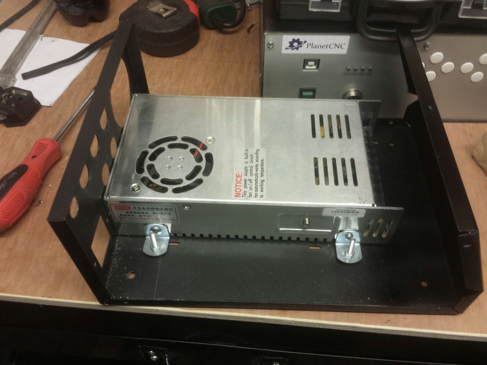

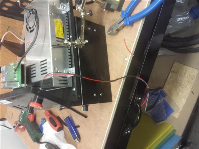

Here is the old box, I stripped it and sprayed it the same as the new control box as I want to mount the 2 together.
Attachment 22767
Now I mounted the power supply thing and bolted it now, I spaced it about 5mm up off the deck to help air flow, not sure if it is needed but though as there are vents on the underside it would make sense.
Attachment 22768

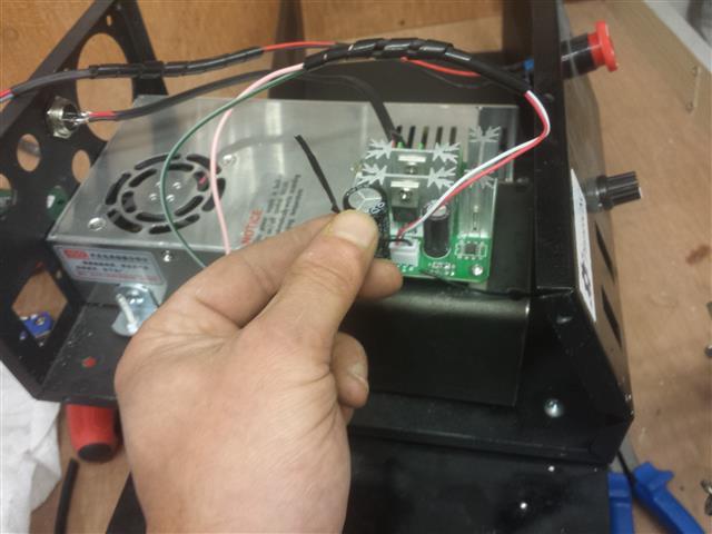

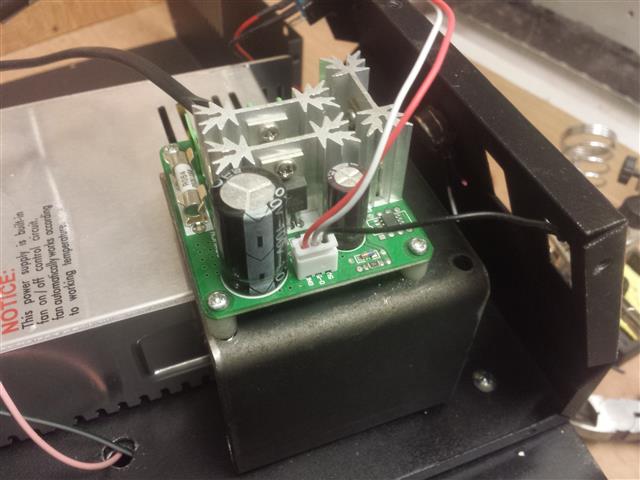

4 Attachment(s)

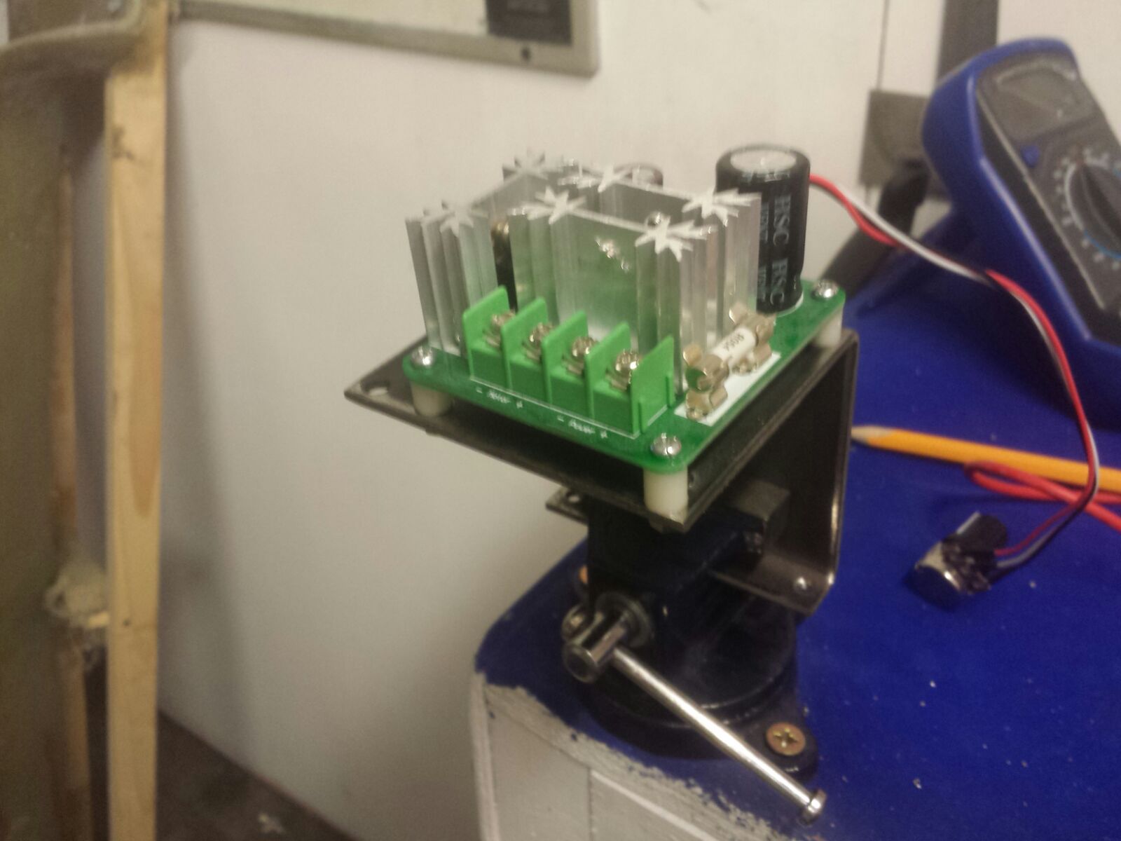

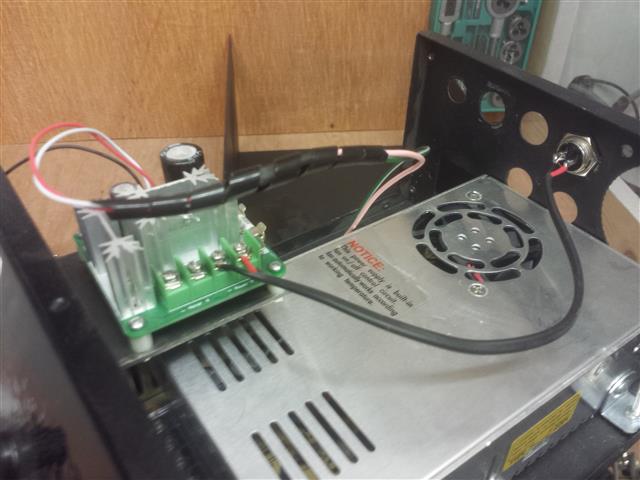

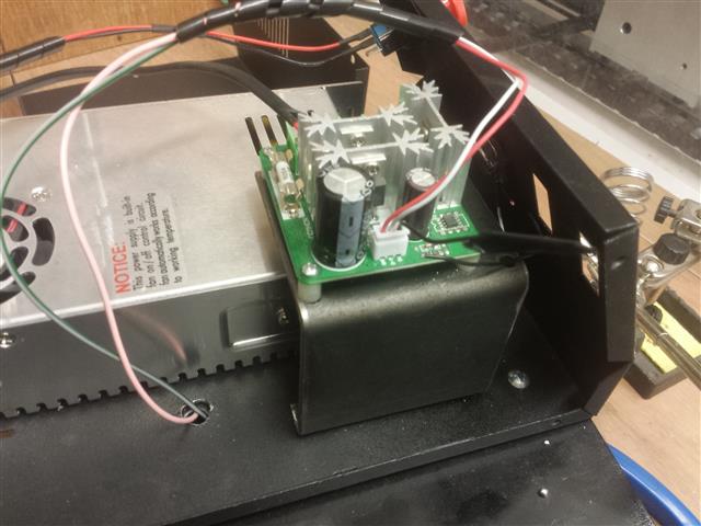

Now I have to find a place to fit the small pcb which has the speed control dial plugged into it
Attachment 22769Attachment 22770Attachment 22771Attachment 22772
Is it ok to mount this box directly ontop of my new box so it is nice and neat? I think the power will go from one box to another so it would be much neater if the cables were kept internal hence linking the boxes?

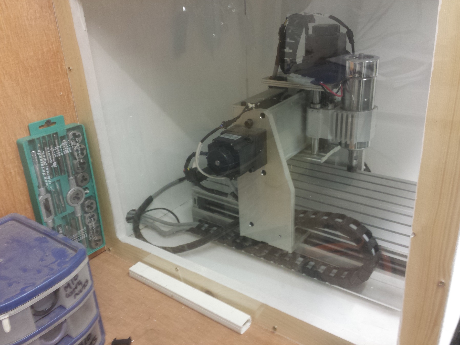

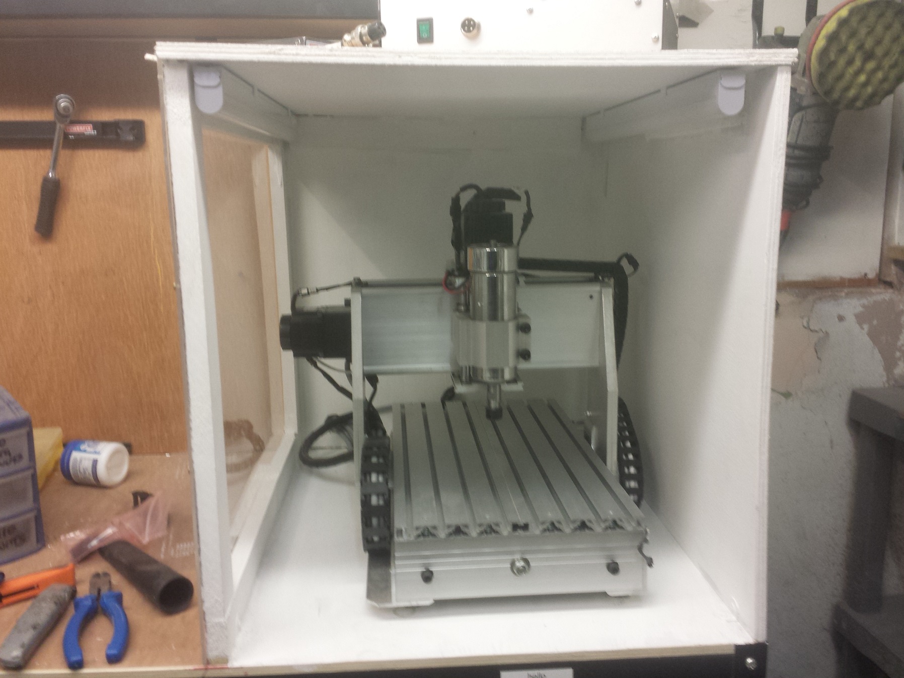

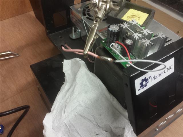

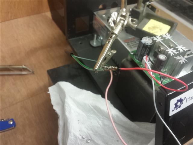

Well another update,
I have rewired the limit switches correctly as I did it wrong the first time, I have also added ground wires to the shielding on the motor wires to connect to the star on the box I made. With the new diy motor power box I have made that is not fitted to the top of the planet box and I have begun wiring it into the planet cnc controller, just waiting on some confirmation off Planet CNC that I have wired it in correctly. I have soldered and heatshrunk the wires. Also installed a e-stopAttachment 22934Attachment 22935Attachment 22936Attachment 22937Attachment 22938Attachment 22939Attachment 22940Attachment 22941Attachment 22942Attachment 22943Attachment 22944Attachment 22945Attachment 22946Attachment 22947Attachment 22948Attachment 22949 button but need to work out how the hell that gets wired in lol. One job at a time
