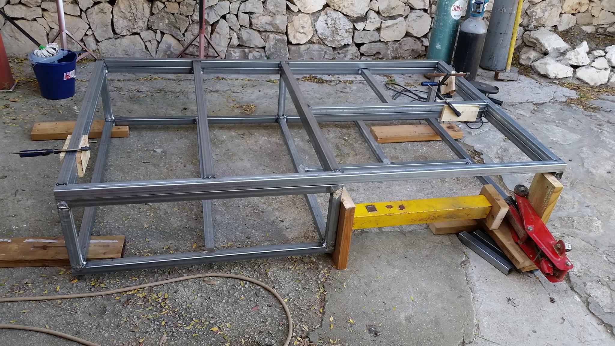

HI, thats how to rectify something, if you mess things up :hysterical: and weld too fast
Attachment 23387
I am joking, just tack all in place, rectify with a mallet and then weld. But things like that happen, when i am in a hurry.

Haha hope it don't come to that lol. i'm pretty confident now after watching tons of video's but i am a sucker for getting inpatient and tend to automatically move a little faster now and again so i really need to keep that in check lol.
