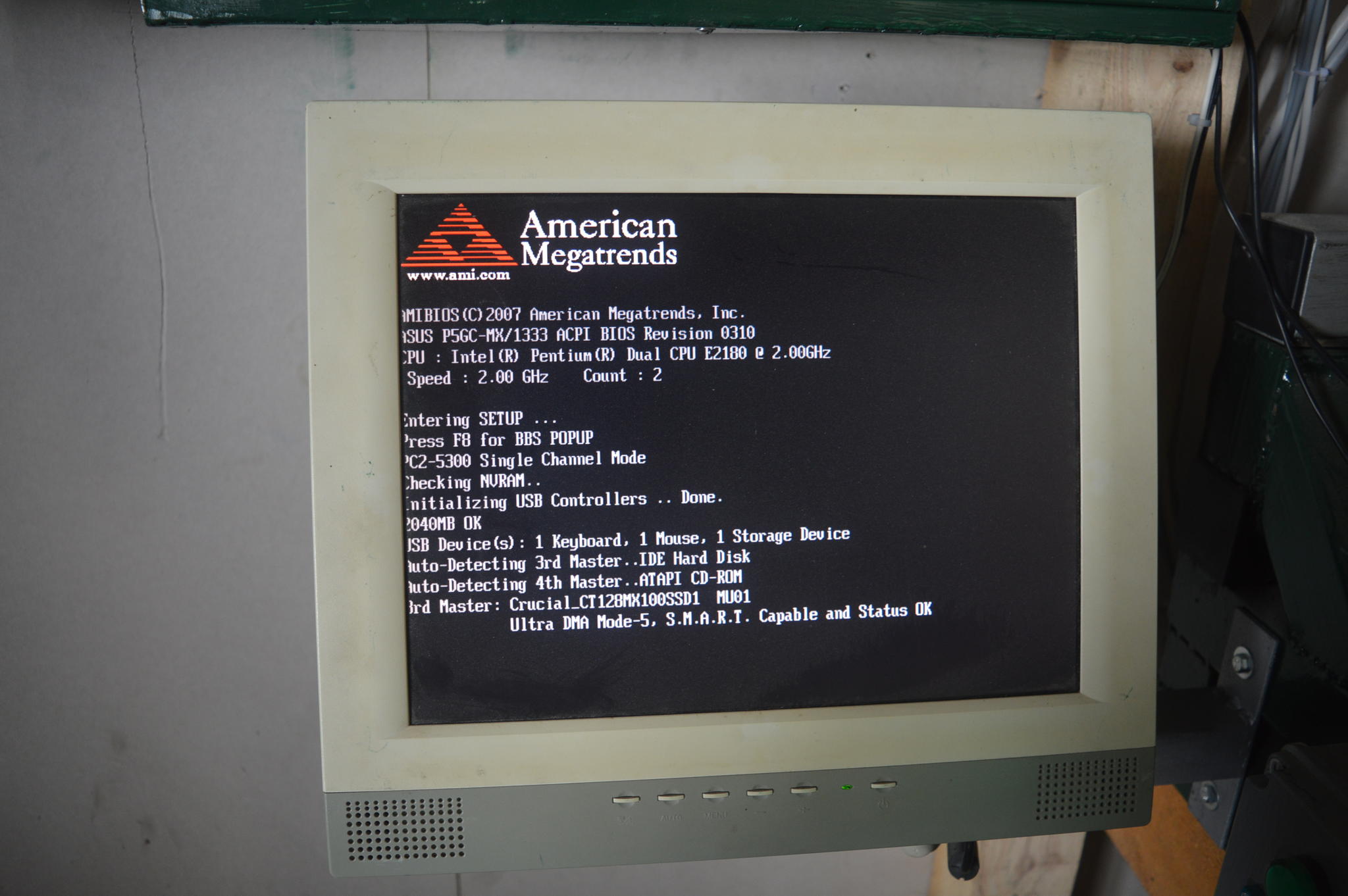

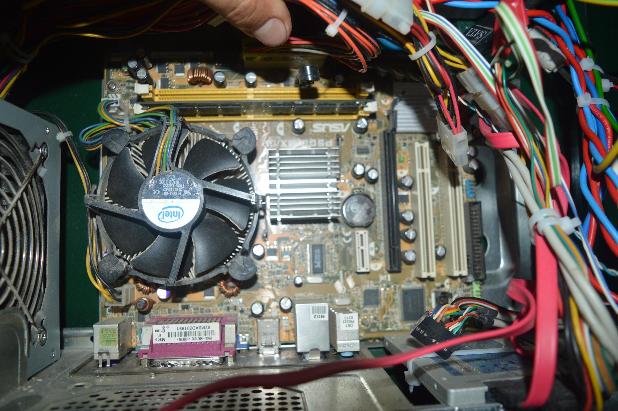

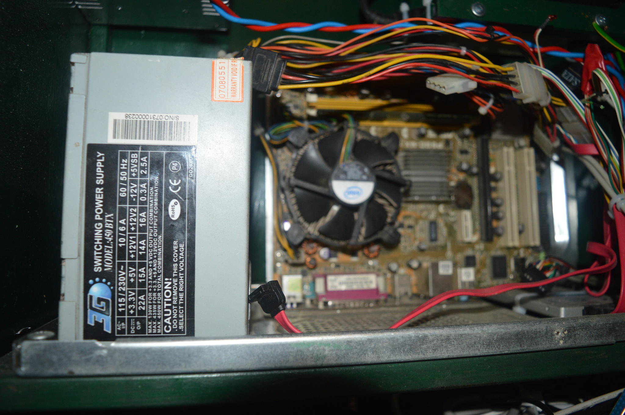

Hi Dasp1976,
I.ve bought some time ago a dell precision m4800 for the future CAD/CAM works.
Running the Cnc, I don have anything special at the moment:
Intel Pentium dual cpu e2180 2.00ghz 2.00ghz
2gb RAM, 32bit operating system
video card intel 829456 express chipset family
128gb SSD, windows 7 home premium with windows 7 basic theme
paralel port built in
in device manager, in Computer, i have only 2 drivers available: ACPIx86 based pc, and Advanced Config and Power Interface (ACPI) PC. I don.t have Standard PC option. Some people say that this can be a fix for steppers missing steps, or making strange noises.
here is a link to someone who is talking about this issue. skip at min 4.30 https://www.youtube.com/watch?v=n18OTfjbFp4
also in device manager, in Mach3 Pulseing Engine, I have Mach3 Driver version 6.1.0.0 (4/20/2011)
I.m mentioning all this because, running DriverTest in Mach3 installation folder, I get all 3, Pulsing to slow/Pulsing to fast/System excellent messages. If I move or drag any window on the desktop, while the DriverTest is running, I get lots of spikes in that otherwise straight line. Some people say that changing the driver mentioned above to Standard PC will fix this issue, but I could not find what to do if this driver is not available in the option list.
But I guess, as this pc units are very cheap, it does not worth spending so much time troubleshooting the one I have.
I.ve read dell 760.s work fine, but this are core2duo.
You mention single core machines, intel celeron and windows xp. Seems a safer and more stable choise. I.ve found a couple online, to my surprise.
I.ll get back when I have one.
Thank you for your reply.

2 Attachment(s)
Re: Help please. Dip switches and mach 3 settings
Hi John,
I.ve changed in Bios the boot drive to be the dvd drive, right before installing.
I.ll try tomorrow what you.ve just said in removing all things and testing.
I don.t know what an IDE drive is or how many ports I have.
Here.s a photo with the motherboard.
Attachment 24721
That Mobo has 4 SATA and 1 IDE port. The IDE port will support two devices and I would recommend you use Cable Select on the IDE drives look at this ---- https://support.hp.com/gb-en/document/bph03792 With Cable select the master is the first drive i.e. on the end cable connector and the slave is on the middle connector
SATA does not have that option and I see that the small drive cable tied to the box is SATA.
If you can set up XP on a separate drive, I would recommend it and don't mess about with dual booting. It looks as though you have a corrupt MBR (Master Boot Record).
The Mobo manual is here if you need it https://www.dropbox.com/s/vmr7ucg4kw..._1333.pdf?dl=0
3 Attachment(s)
this photo lead me to think your PC had IDE drives
connected by a 40 way ribbon cable
Attachment 24722
your later photo of the motherboard shows the newer (red) SATA cable connected to the solid state drive
Attachment 24724
as your mother board is the E3363_P5GC-MX_1333
it only has SATA ports
so you can ignore my comment about only having
a master & a slave device connected to a 40 way ribbon cable
just test the motherboard with no drives
then add one drive at a time to see if you have a faulty drive
stopping the board from booting
John
john swift
Although the photo does not make it clear, that Motherboard has an Ultra DMA IDE port and from the BIOS start-up screen, it looks as though Andrei has an 80way cable with a HDD and a CD-Rom connected, both plugged up on the jumpers as Masters. As I said CS (cable select) is a safer way to go. If XP has been installed on the SSD, then I would unplug the IDE HDD and see if it boots up. Although you may have to alter boot priority in the BIOS settings.
