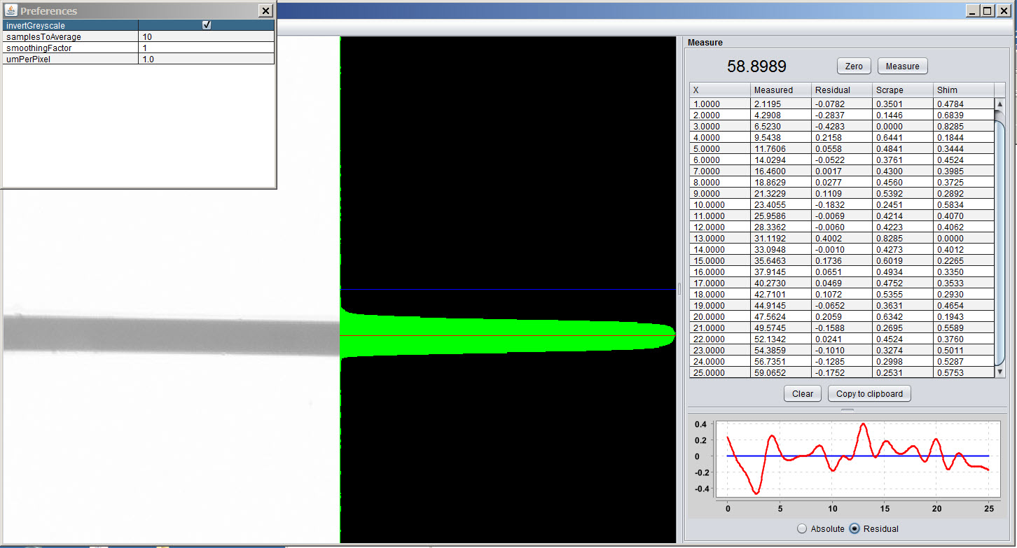

Hi Joe
I ran the tests again this time using a small LED torch as a bright light source.
This gives a very sharp high contrast graph.
Strangely the scaling changed to 119.9 pixel lines with the new light source. I repeated the test a couple of times. the results were the same.
I did not change the gap between the wire and the sensor. it must be caused by the change in light source.
I used the software measure table and recorded every step between zero using 0.05mm steps see image below.
The setup I am using moves the sensor not the wire, Important for a point light source to avoid the shadow elongating like the sun in late afternoon.
This is easy to prove moving the torch by the slightest amount changes the measurement.
I really want to find an evenly dispersed light source.
I have yet to try your smoothing settings, That will be interesting.
Edit just noticed the software has changed a bit more. I will update
John
Attachment 26368
Attachment 26369

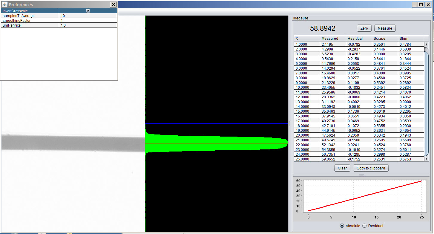

Re: DIY Laser levelling using webcam and laser level
Hi Joe
Hi All
I downloaded the next version that displays a graph of the measured points. And look how nice and linear the graph is! .05mm measurement steps on the dial indicator.
Attachment 26370
I ran it 3 times to check.
While testing I moved the light a tiny bit. I had to start again, The light source will have to be rigidly mounted on the platform or you will get errors.
Will the current software work with higher resolution cameras say 1080P? I realize there would be more number crunching for he processor.
John

Great result, would be interested to see what it looks like in 0.01mm steps. What does the residual chart look like? I can see your residuals are all less than one pixel which means your step size was very consistent. Also if you put in a scaling factor in the umPerPixel preference you will get your results in um, or tenths or whatever. I need to make these preference persist between runs.
At the moment the software asks the cam for a vga image, so it doesn't matter what the cam resolution is, I can make this more configurable.

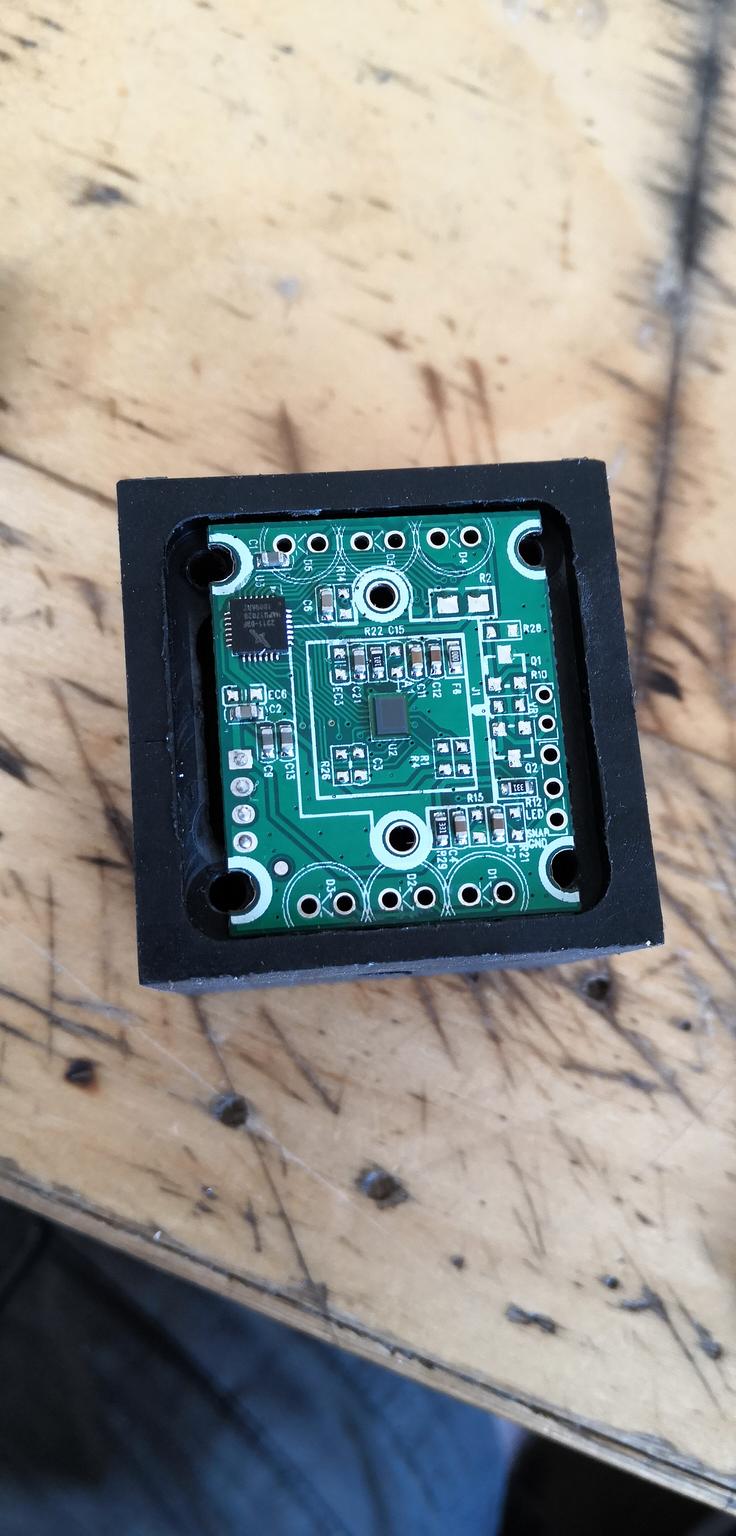

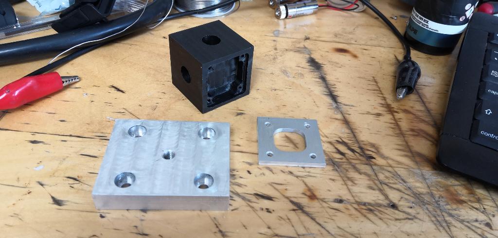

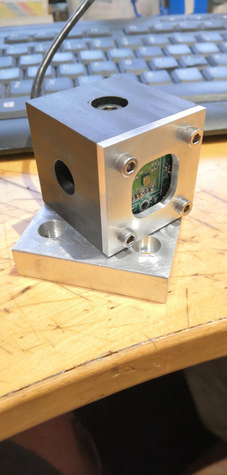

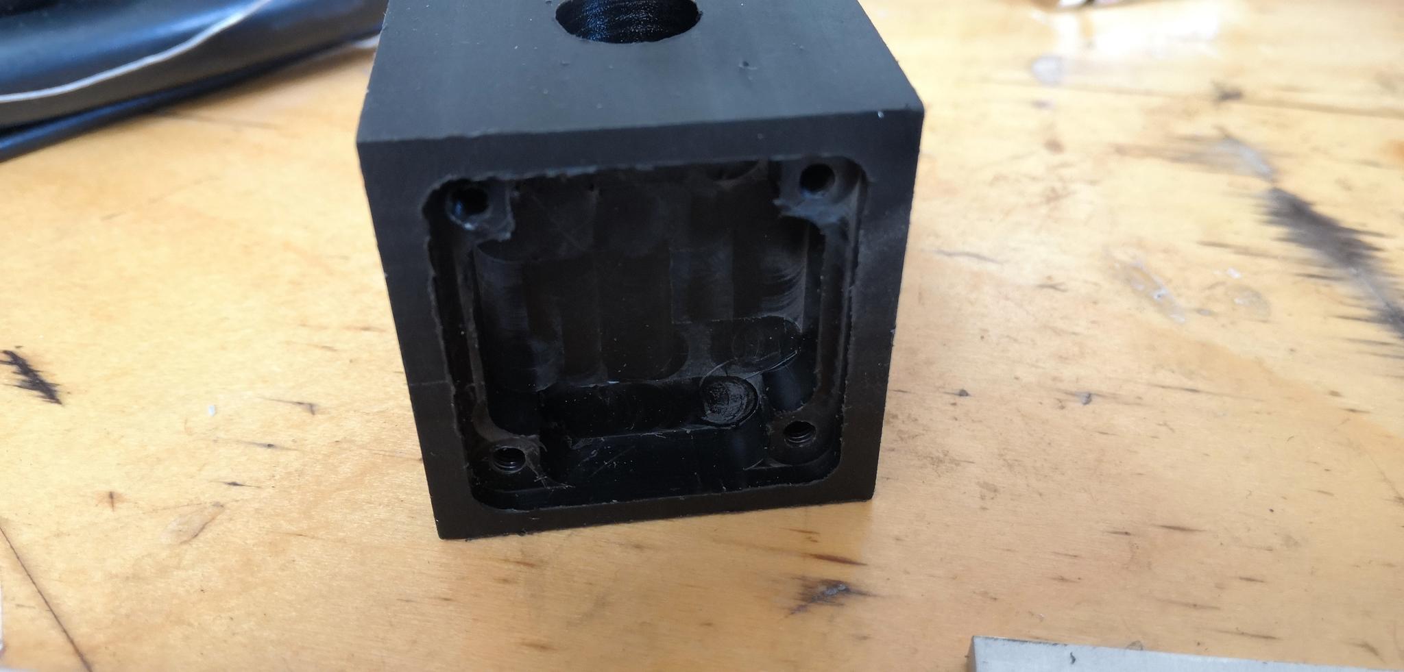

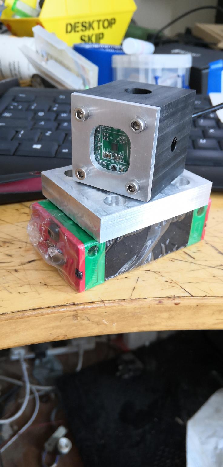

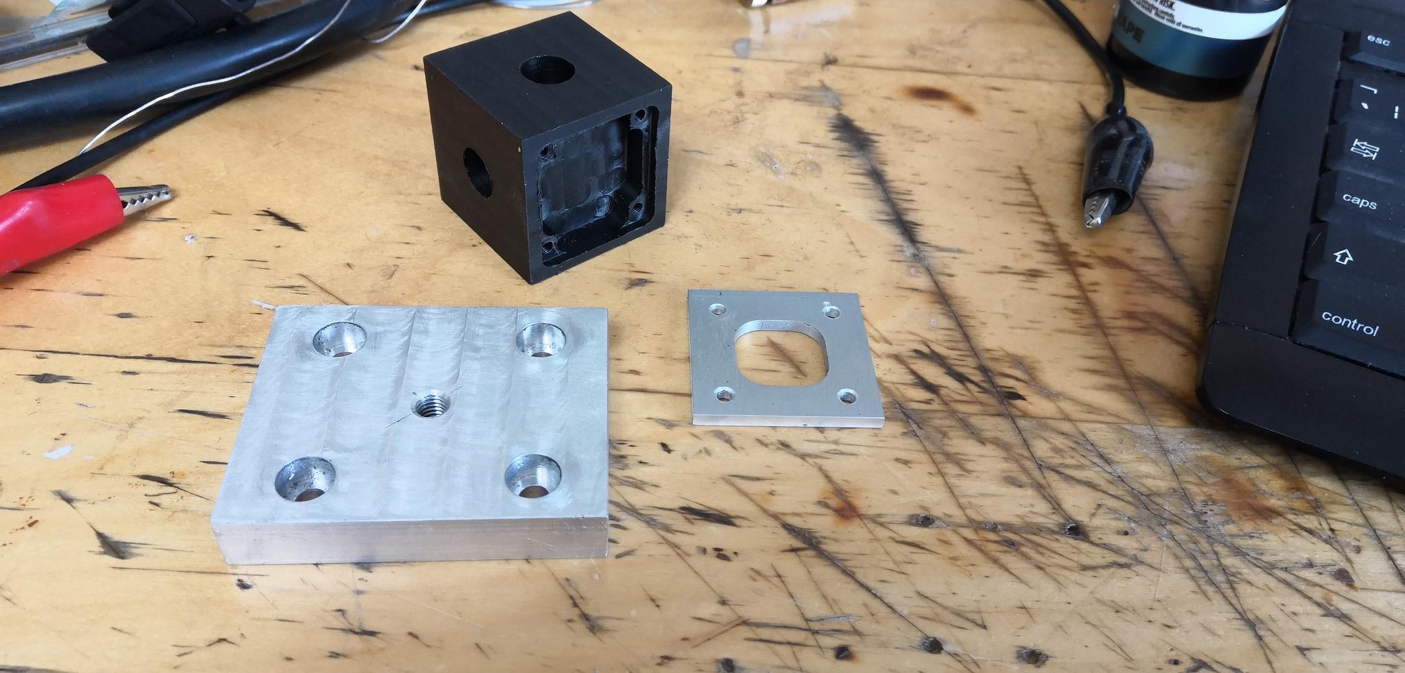

Hi Bert,
No I just use the bare sensor in a milled fixture, see:
Attachment 26375

Hi John,
Let me just sanity check your methodology. You have the sensor or wire on a precision positioning system. You move the system in steps based based on your dial indicator and click measure at each step? Is that correct? Just wanted to check you aren't moving the system until the measure value increases by one step then clicking measure as this would always produce a straight line, I don't think you are doing this but just want to be 100% sure.
You have the umPerPixel set to 1 therefore the numbers you are recording are in the units of pixels, this means anything to the right of the decimal point is to a sub-pixel accuracy. This ok to an extent (say 1 decimal place) but will soon deteriorate into noise. The gaussian fit will be afffected by a single intensity point change of a single pixel that is why you get jitter at extreme sub-pixel resolution. To remove all jitter you would probably have to perform the test under lab conditions in a vacuum to avoid dust particles and with a lab quality camera with high precision pixel exposure times. The exposure times (and therefore the intensity readouts) of these cheap sensors with rolling shutters are not perfect, when a pixel/row is exposed for slightly longer its intensity values will naturally be higher. Couple this with the onboard image processing pipeline that is probably trying to do all sorts or AGC and white balance adjustment and noise is inevitable.The image is then compressed onboard to a jpeg adding all sorts of artifacts before being shipped to the PC.
All that said your 0.01mm test run shows your residuals are within +/- 0.4 pixels or 0.0016mm (think you sensor is ~4um per pixel) of a straight line, this is pretty good isn't it? Shimming or scraping in the 1 micron range is most likely impossible for us and probably completely overwhelmed by the thermal movement of the frame.
The 0.0016mm could as you say be down to trying to position the sensor using a 0.01mm dial indicator, quite difficult to judge 1/10th of one division...and outside the tolerance of the indicator.
I can add warping for the catenary sag if you have the equations?

Hi All
Today I ran a test on a webcam generously sent to me as a gift from a forum member. A wonderful gesture.
I do not know much about the sensor apart from the fact that it appears to be dated 2012.
The test was made using the sensor and .008" piano wire as done before.
When I tested it with Joe's software it counted 93.7 pixel lines to measure 0.2mm
My previous tests with a Microsoft webcam over the same distance of 0.2mm counted 47.56 lines.
The new tests prove the camera given to me has almost twice the resolution of the Microsoft unit.
0.0021mm or 0.00008 inches. per pixel line.
The new camera also displayed less noise and was less sensitive to stray light. All in all a better unit. I will try to find out more about it.
The latest results have really inspired me to to press on with improving the mounting of the camera and better light control. I will report back here with my results. Maybe the Webcam driver software can be used to adjust the sensitivity. That would be useful.
There may even be higher resolution webcam sensors available.... technology marches on.
The accuracy now already achieved will enable the unit to be used to easily test large precision machine tables for flatness if the catenary equation sag corrections can be applied to the measurements.
All this started with Joe's software, Thanks Joe.
John
Three images below
Attachment 26468
Attachment 26466
Attachment 26467

My laser finally arrived, and...judge yourself.
camera fitted in precision vice riding on grade 00 18"x 24" granite.
Running across the beam i'm getting 0.04mm deviation from straight line on ~500mm distance
Running away from laser I'm getting 0.02mm deviation on ~500mm distance.
Beam is changing width and apparently this change is not symmetrical.
I was getting same results with pointer laser(runnig away from it), but assumed that irregular dot with surrounding artefacts was to blame.
It's still viable way of checking linearity, but as shadow camera and wire. Cheap(£25, glass lens, 80 MW) lasers are not precise enough. maybe £500 line laser could be used, but for such money there's plenty other options.
Do you have any pics of your laser and sensor? I think there is something strange going on with your setup if you see errors moving the sensor along the laser axis. Is the laser spreading? Have you removed all optics and filters from the sensor and bolted the pcb to something solid? We do know that the laser beam is not bending in the air so something else is wrong.
Bare sensor, unless there is anti aliasing filter glued to silicon, but AFAIK it's DSLR's area.
Stripping further is not really an option, not usable as shadow camera as there are modular PCB's perpendicular to the sensor sticking above it's surface. Webcam incoming.
http://sasquatchv.eu/images/2019/11/06/DSC_0048.md.jpg
http://sasquatchv.eu/images/2019/11/06/DSC_0049.md.jpg
Cable is clamped, moving laptop around has no impact on measurements when camera is stationary.
