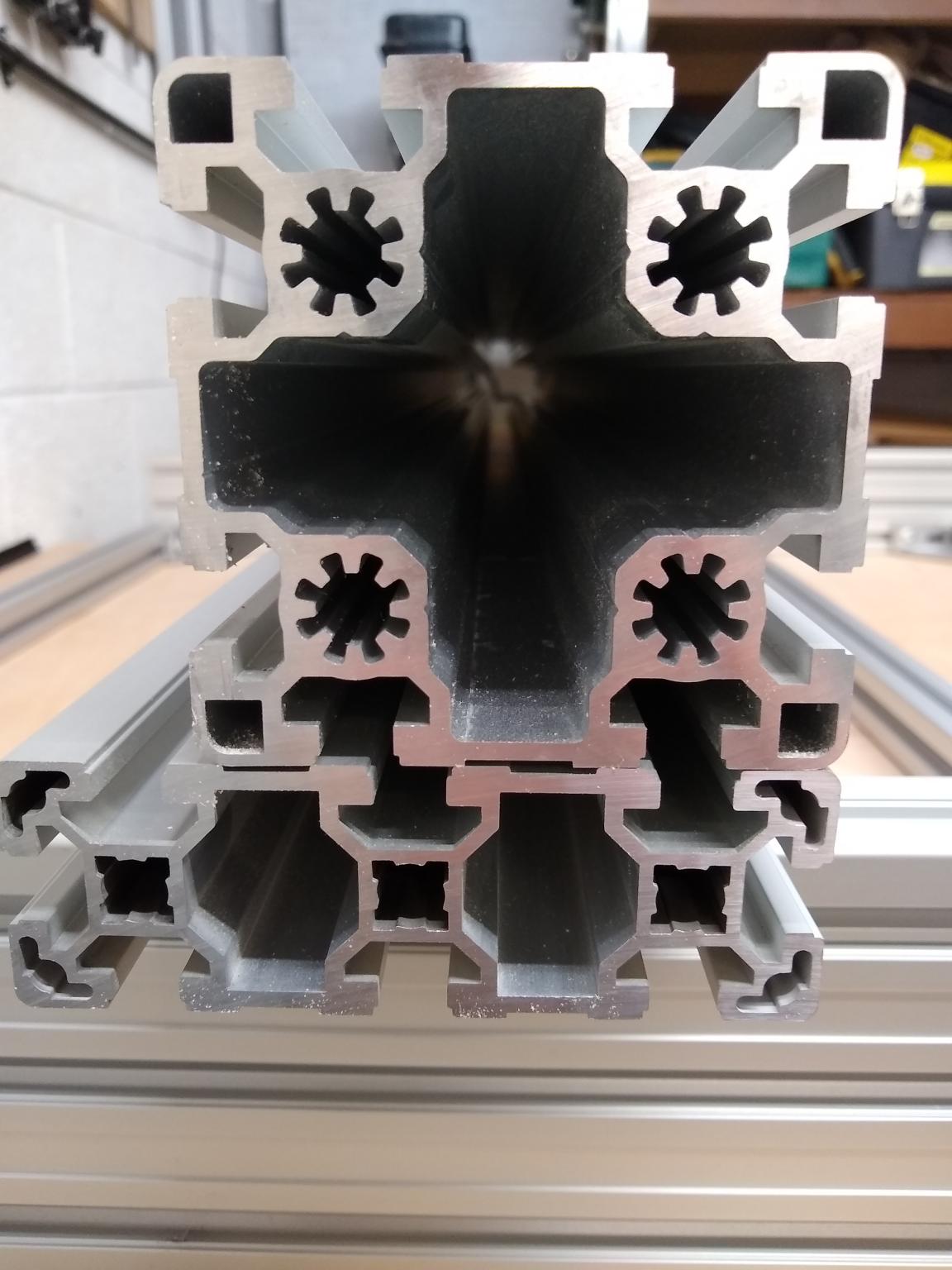

On the dual plate, to be honest I did think of it earlier on, but at the time I was going in circles with the design and if I could physically make it so opted for a simple single plate. Jazz - I see what you are saying, essentially the ballscrew is fixed square with the frame, but the gantry may need slight squaring.
Yes and no.
What you are doing when squaring the gantry is setting it perpendicular to the MASTER RAIL and NOT the frame. Infact forget the frame because unless you have built it perfectly square and aligned the Master rail perfectly parallel to it then you CANNOT measure from it. The MASTER rail is the ONLY reference point you work from.
So the ball-screw must also be perfectly parallel to the MASTER rail. Likewise, the Ball-NUT is set parallel to the gantry side.
So if you have set your ball-screws perfectly parallel to the MASTER rail, which you should have done. Then any angular adjustment on the gantry in respect to the MASTER rail means there must be an angular twist between the Ball-NUT and Ball-SCREW and this will cause excess wear and binding.
The goal is to get the gantry perpendicular in respect to the MASTER RAIL and the ball-SCREW perfectly parallel to the MASTER rail. This will then put the Ball-NUT perfectly parallel to the ball-SCREW.
When all this is done then this will show you how much Shimming and spacing is needed at various places around the machine in relation to the Frame. If you have built a perfectly square frame then it should be easy.!!
You may find the best place to shim to get square without impacting the screws/nut relationship too much is between the Gantry plates and profile at each side.
This is where building in lots of adjustment points comes into play and helps with setup and fine tuning, don't be surprised if this takes you many weeks to get right with lots of strip downs.

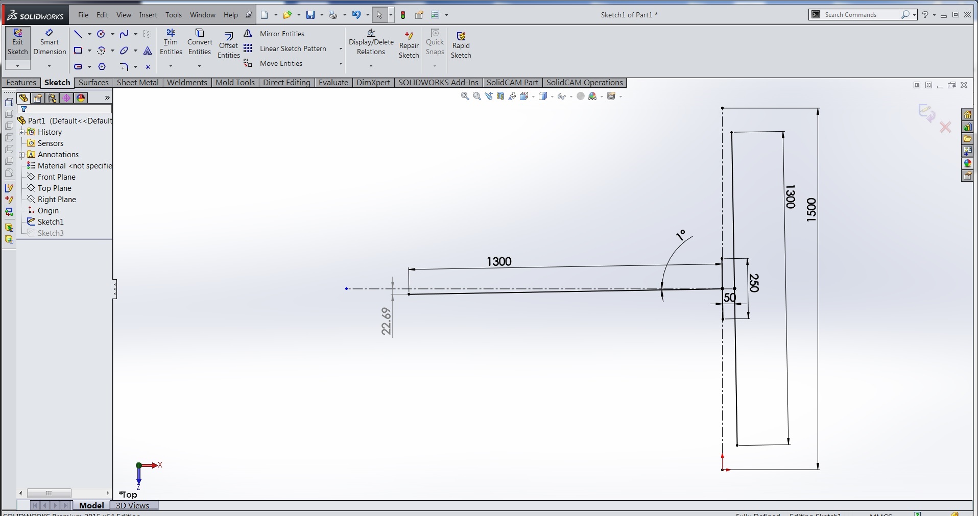

Edit: I've just done a quick sketch in SW to show how much just 1deg of misalignment translates across the length of a gantry or machine.
The measurement show the numbers except one and that is the twist of the ballnut in relation to the ball screw but the number is 0.70mm of twist which would wear a ballnut out in no time and cause lots of binding.

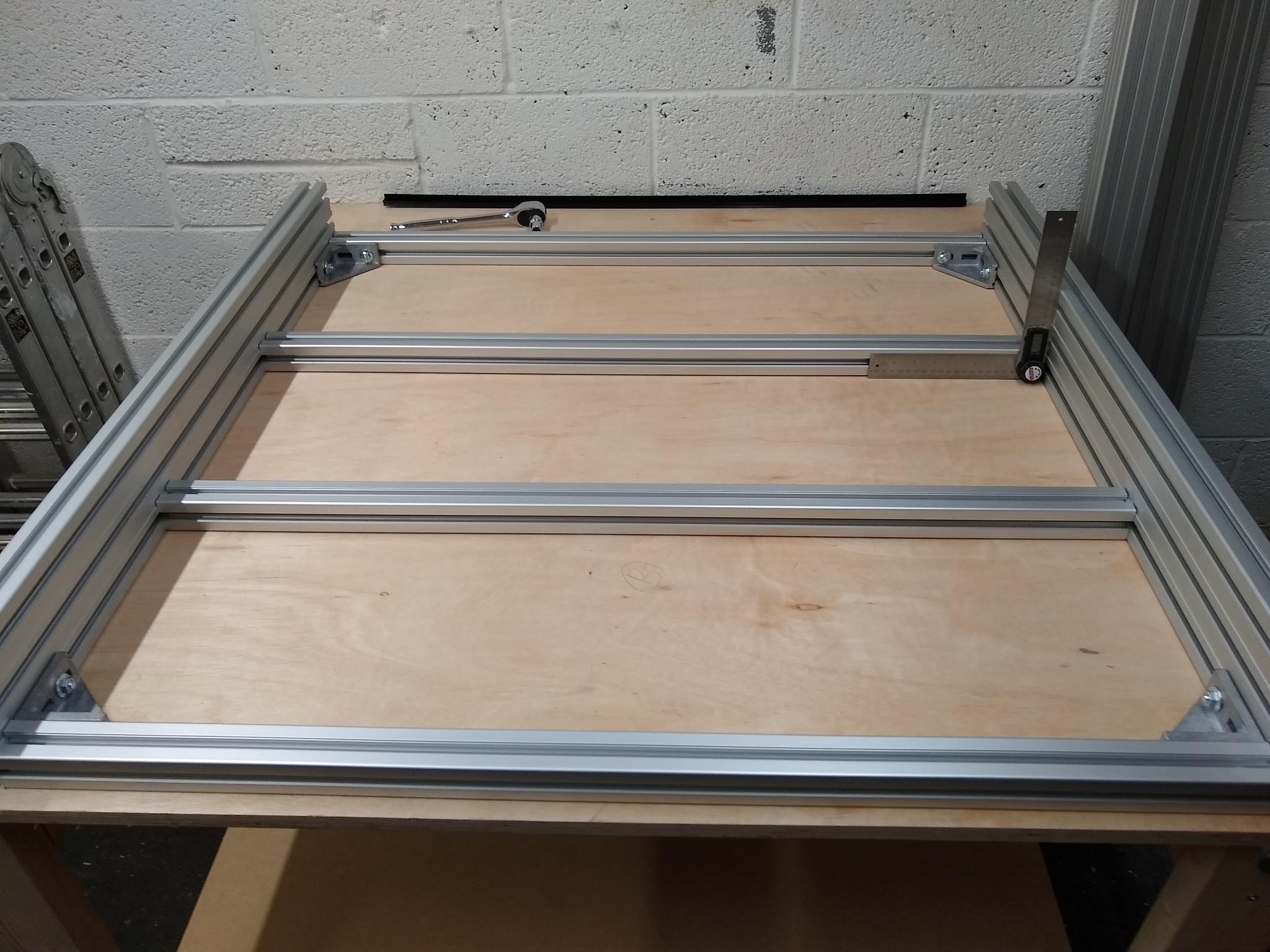

Very mixed day of results - finished most of the Z axis strengthen plates and connected the 2 Y motors up.
I ran each motor individually first with the ballnut uncoupled to check how it runs. The good part
The gantry motion on rails is very smooth and all good, and one ballscrew is running true (until squaring anyway!)
Using a digital square the gantry seems good enough to progress to cutting a square to determine further.
The bad bit - the other ballscrew is definitely bent, not 100% if it arrived that way but much more likely it's a result of drill testing or something else I did! Some swearing involved and am waiting to find out if Fred can amend my spindle order...

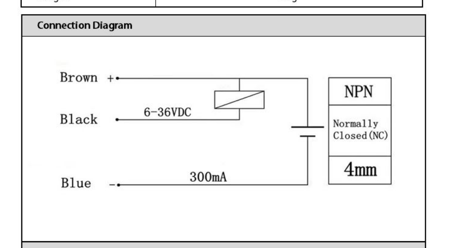

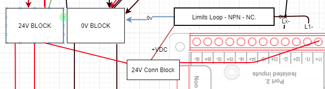

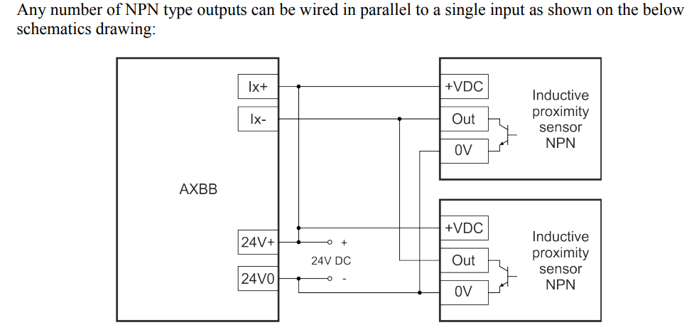

Can someone tell me is this right? I thought I understood it until I see the black cable on the switch diagram shows 6-36V while "out" on the AXXB manual shows it at 0v?
AXXB manual image, switch diagram and my understanding of it.

The black wire is the output of the sensor. It is pulled up to the supply voltage by an internal 10k Ohm resistor until the output transistor conducts and pulls it to near zero volts. 'Normally Open' (NO) means the transistor is not conducting (output pulled high by the resistor) until the sensor is triggered. 'Normally Closed' (NC) means the opposite. Only NO types can be connected in parallel as shown in your diagram, any single output pulled low will pull the others with it and the input to the controller. NC types (which you have according to the diagram) must be connected in series since, if in parallel, all the outputs will be normally low and the ONE that tries to go high will be held low by the others. Unfortunately your AXXB manual image does not explain that but the text should.
EDIT: Your controller software should include a configuration for selecting whether your sensors are NC or NO. If you get continuous limit alarms then that my need to be changed.

Ok so they are NC type to cover the issue of broken wires etc.
So the black wire will normally be at supply voltage until limits are hit.
I'm planning on wiring each to its own limit input on axbbe as there are 6 available, leaving a couple for probes and future use.
So imagining just one switch in my diagram above , l1+ will always be 24v and l1- would be at 24v normally unless switch triggered.
Is that right ?
Thanks !
Re: Aluminium Profile Type Router - Initial questions
Other way round! NC will normally be at ground voltage (Normally Closed to ground) until triggered. "Normal' means you have NOT driven the machine to it's limit and it is continuing to cut material as intended. This gives you protection against broken wires as an open wire shows up as a high voltage if your controller has it's own pull-up resistors and the machine stops. Failure of a NO connection only shows up when the limit switch fails to make the ground connection required and your gantry crashes through both the limit switch and the end wall of your shed.
My personal preference is for one switch per input as you are planning. NC is best as explained above but NO is more commonly available, presumably because of the ease of parallel connection.

Will post some progress photos soon, but have now pretty much completed the wiring and physical build.
Cable chain finally arrived from China so the (crazy) amount of wiring is now running back into the control box and 4 separate limits wired in.
I setup the limit and tested jogging into them and all good there. Machine is running at 4m/min currently as Jazz suggested, until I tune it further.
I ended up straightening the ballscrew mostly, using the advanced method of compressing between some hardwood and rotating it. But now it's back in the mount it seems to be running pretty well at 100% jog speed. I think my drill test made it seem a lot worse plus there was some slight misalignment of the motor coupler. I do notice the X axis is very smooth even compared to the dual Y.
My next test after jogging was homing.
So X and Z - moved along, hit the limit stopped and backed off - great.
Dual Y - both axis moved towards limit, one side hit limit switch fractionally before the other, then the one which hit the limit seems to keep going and the other side never hits the limit, so the gantry starts to go off square and hit the ESTOP before it breaks the gantry!
I have both axis set to have homing to the negative limit and 2 separate limit pins set so not sure what is going on here.
When I jog the axis slowly into limit it hit both pins and stopped, both flag up in UCCNC as hit.
Before I post on UCCNC forum am I missing something obvious here in the homing sequence for dual axis?
Attachment 28292
Sorted - the limit switches for each side of the Y axis did not match the drivers, so when one switch triggered it stopped the opposing side motor. Fine while I was testing limits, not so much for homing operations!
