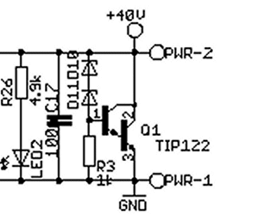

Hi all,
I recently got this TB6560 board from eBay as well. Are there any schematics of this board available?
Greetings,
Hermann

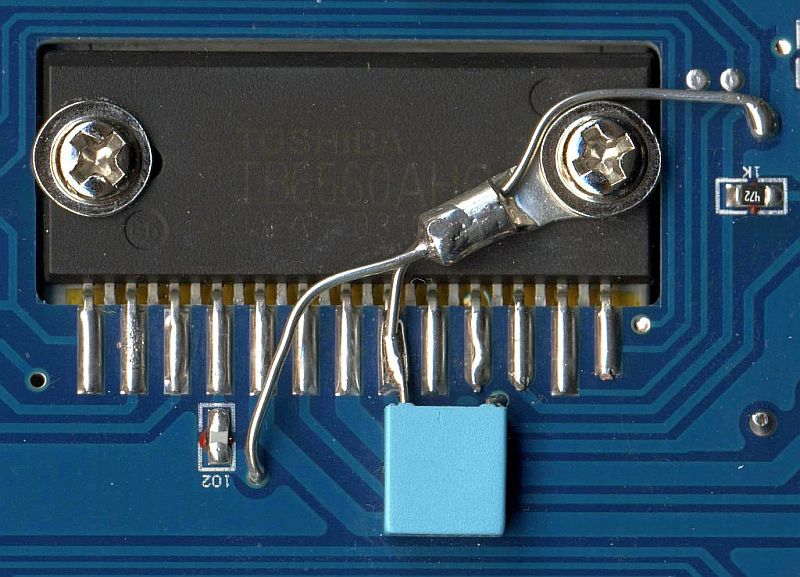

Maybe someone could be interested about the way i modified ground path around TB6560s in my 3 axis board, blue PCB.
Here is the link to italian forum where i published same photos : http://www.cncitalia.net/forum/viewt...26754&start=10
I also changed Fosc capacitor (pin 7 to ground) from 1nF to 100pF and, in conjuntion to step lines optocouplers bypass, now the board works flawlessy with Fstep of 50Khz.
Yes, i know, datasheet reports 15Khz max ...
But i don't mind about that.
Marco.
Interesting Marco... did I understand you bypassed the optocouplers? That would increase the step rates, the optocouplers they use are fairly low-spec. Personally I would have looked at replacing them with higher spec devices and retained the isolation.
Hi Irving,
the power section of these cards is not galvanically insulated from parallel port connection, both share same ground.
Here, optocoupling gives only a partial safety gain, because a lot of current could flow through PC ground.
So we have a "half way" protection, capable only to break direct reflow of high voltage supply on parallel port lines.
Placing high speed optocouplers, like 6N137, is not simple because they do not have same pinout.
So i simply bypassed step lines optocouplers with 270 ohms res., in future i will place zener diodes (or transzorbs) on HC14 side and i will change resistors with higher value ones, to eliminate the high voltage reflow risk.
I have to say that the full modded board behaves good, but the fix was a sort of personal challenge :smile:
Marco.

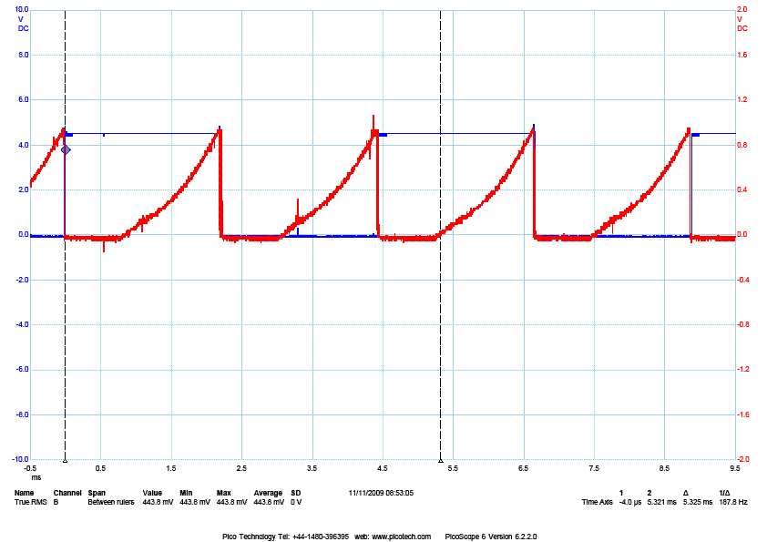

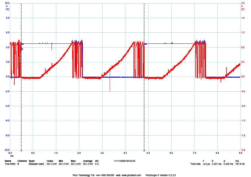

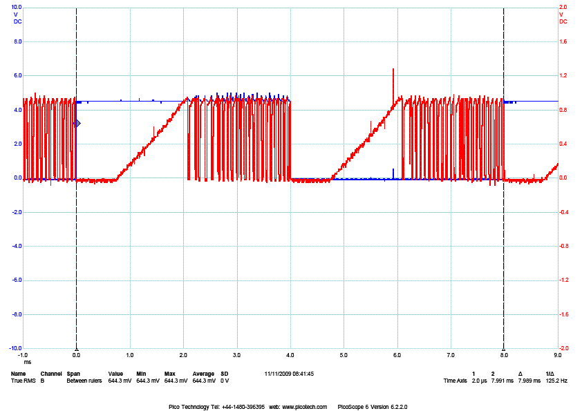

I've got one of these boards running my CNC3040.
I'm curious because it is running on 24V and gets nothing like hot, but it sounds like most here find they get rather warm. I think I could even run mine without the fan!
It also doesn't go very fast - I can get a reliable 1200mm/min from it. I did run it at 1900mm/min but found it occasionally skipped steps.
Is this normal? Have I got something set-up wrong?
The stepper motor shows about 2 Ohms across each of the connections to the board. I don't know if this means it is in parallel or series as the connections at the motor end are covered by heat-shrink.
The big resistors near the output (I assume current sense) are 0.4 Ohms.
Measuring across one of these I get 200mV on idle and 280mV at full speed. That is about 0.7A, so does this means the motor is drawing 1.4A because it is each phase? You can see the measurements below.
This is at idle. The time base is 50us/Div
http://i608.photobucket.com/albums/t...on_uk/idle.jpg
This is at full speed, but please note the time base is now 10ms/Div
http://i608.photobucket.com/albums/t.../FullSpeed.jpg
On the 'idle' graph I make it 12% duty cycle. So since current is 0.5A peak, that makes it:
0.5*0.12=60mA average
0.5*0.12^0.5=173mA RMS.
Can't really find anything useful from the other graph - it just shows how at that speed the current is limited by the inductance of the motor. I guess we could calculate the motor inductance ... T=2.07ms, change in current is 700mA, so dI/dt=700/2.07=1.449A/s (linear approximation).. applied voltage is 24V minus a bit for losses so call it 23V, so the inductance L=24/1.449=15.9mH (roughly, oversimplifying a bit there). That's either a pathetic motor or I've done something wrong! Unless it's wired in bipolar series, that would be reasonable since the same motor in bipolar parallel would be about 3mH which is not bad.
Either way these numbers seem a bit fishy.. please could you link to the motors you are using (datasheet?) and confirm that the resistor you're measuring across is definately 0.4ohms, not two 0.4 ohm resistors in parallel or something like that.

Your waveforms look strange to me. The voltage across the current sense resistors should go between 0.5 V and - 0.5 V at 100% torque or 0.375 V at your 75% setting. Is the earth on your oscilloscope properly isolated from the board? If I remember rightly the isolators on these boards only isolate the signal lines not the earth. Are all three outputs the same?
Russell.
Doh - I think I must have had a senior moment last night! I was assuming that the current sense resistors were in series with the motor but of course they are the other side of the output bridge so the current is unidirectional there thus it should be going from 0 to 0.375 V.
Still the waveforms don't look right to me. I can't check on my board as I no longer have access to an oscilloscope but according to the data sheet the motor current waveforms should look like this:
Attachment 6135
The waveform across the current sense resistors will of course be rectified.
Hope that helps.
