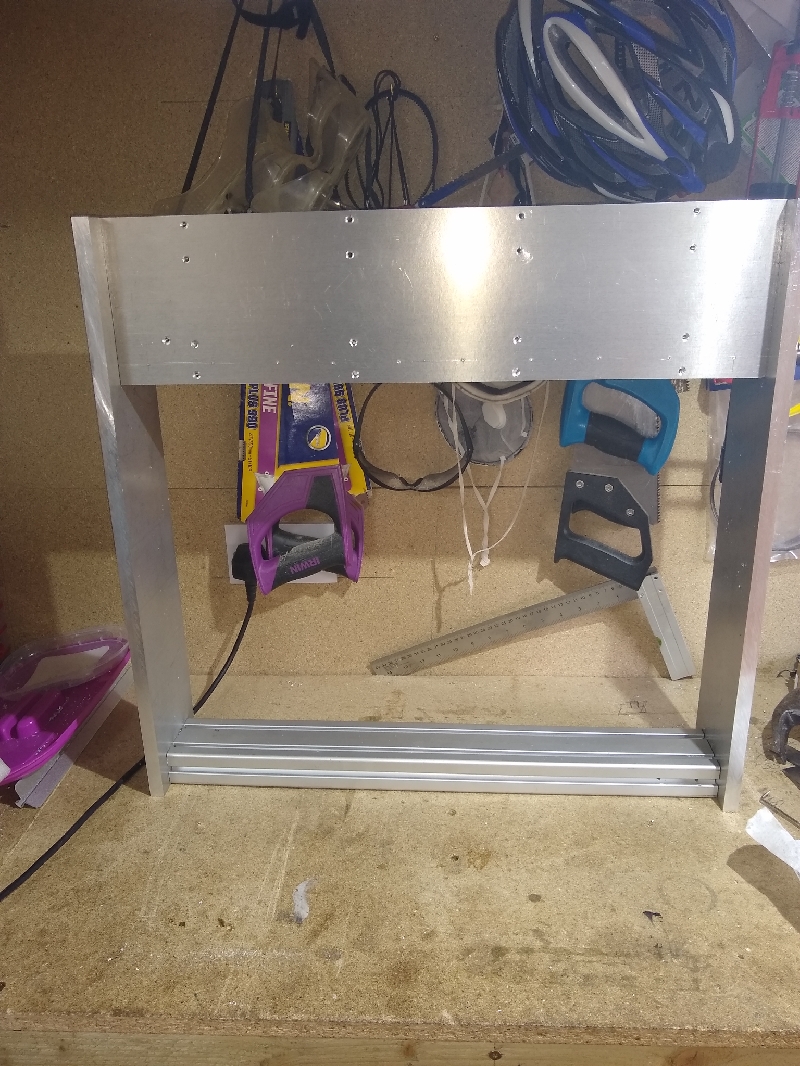

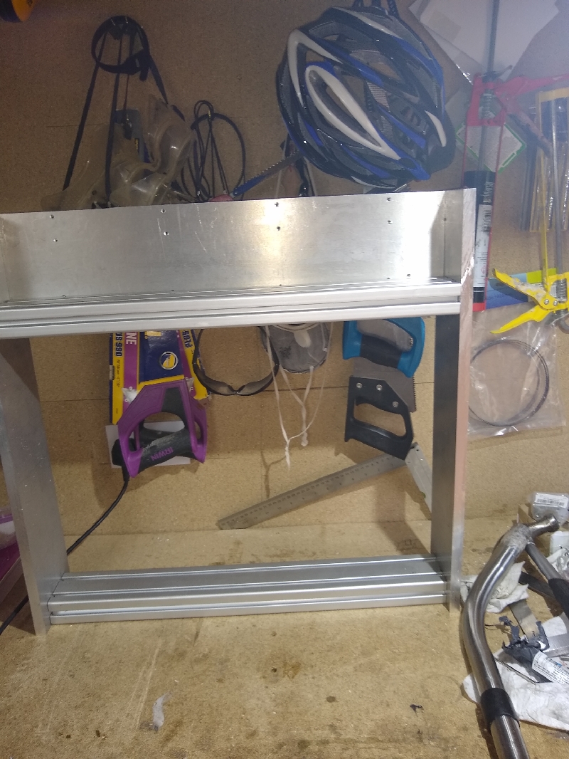

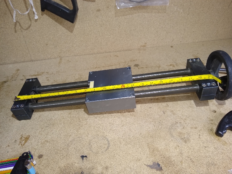

Re: Please help with this build Albert
Hi all
Here are a few progress pictures to show what I have done so far.
Albert
